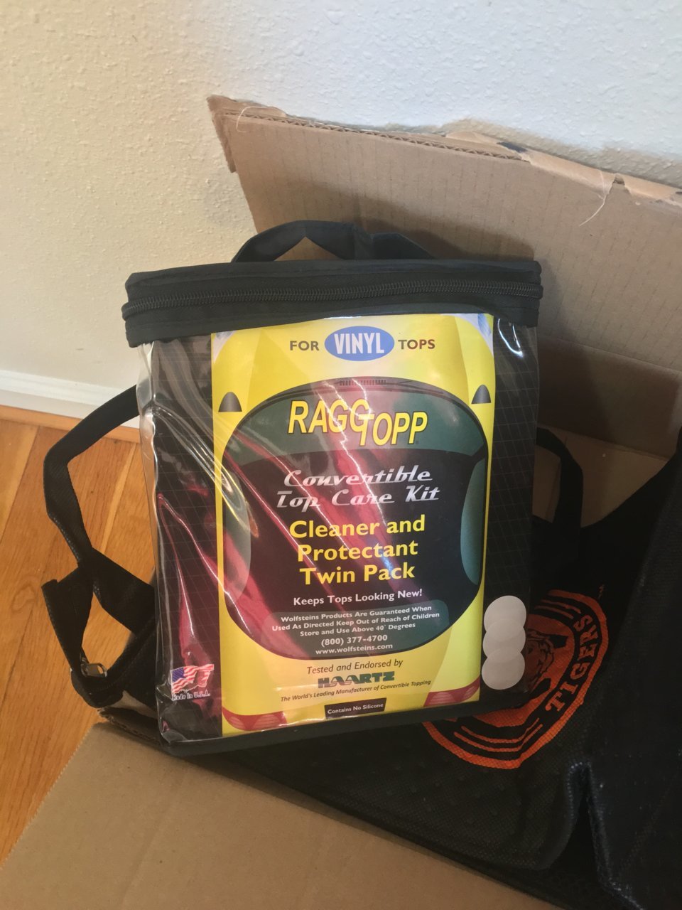

    I was hella proactive in the cleaning and upkeep of the Softopper when I first got it. I went with this stuff recommended by Softopper. These days I just hit it with the pressure washer and give it a good brush.

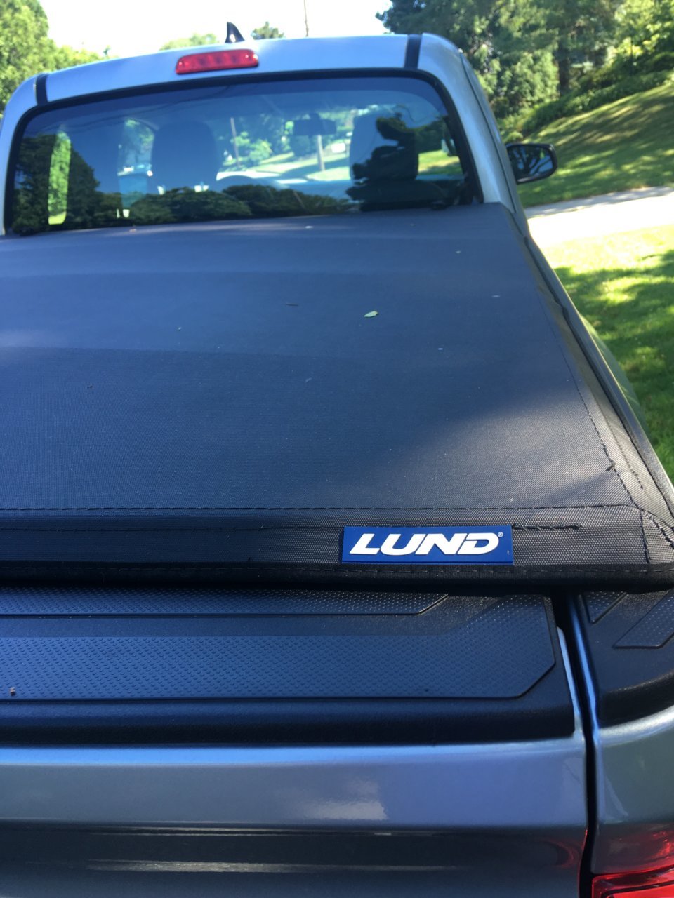

    That product is awesome. I use it on my tonneau, which is constructed of Haartz woven fabric material. A9041DC8-2EE2-4B87-8081-46A81A3A2595.jpg

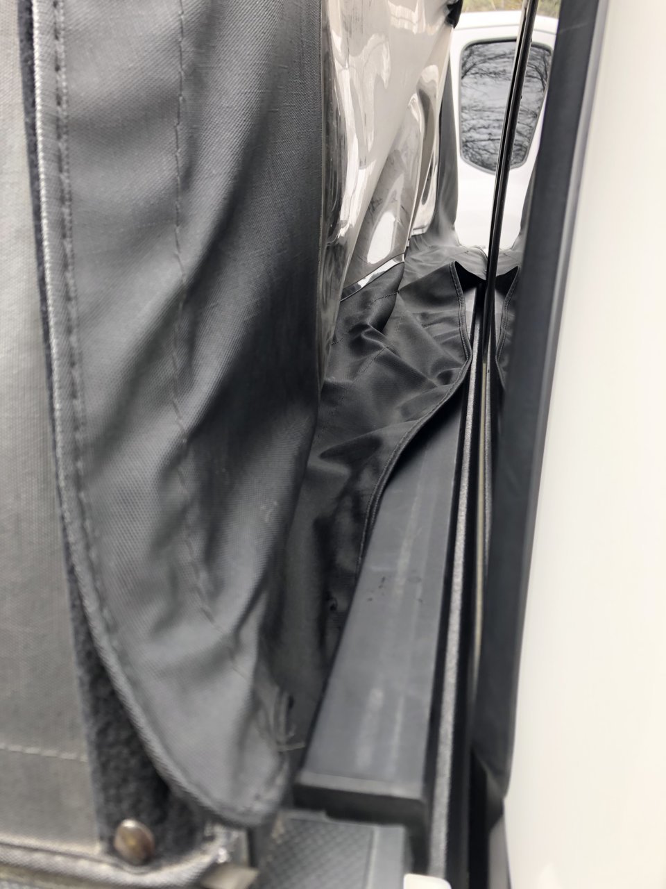

    I am curious how some of you keep the front from looking like the photo below...? I installed velcro on the inside of the bed to keep the INNER flap of the front panel of the topper in place, but I can never keep the OUTER flap in the tiny space between the bed and cab. Sometimes I can jam it in there and it stays but most of the time it looks like this. Magnets? Velcro?

    Hmm, mine just sorta stays there. Maybe you need to shift the rails closer towards the cab a hair?

    @EatSleepTacos is probably right. It looks like the top of the front bar has enough of a gap to direct air down towards the front flap. You could always put some velcro on the top of that header rail to try and keep the window a little tighter.

    Problem solved. Thanks guys!

    haha... just slid the rails approximately 0.534279 inches towards the cab, shoved the outer flap into the slot between the bed and cab. Drove her on the highway and........
    Voila!

    This, and since the front straps down a little more (loosen rear straps first).
