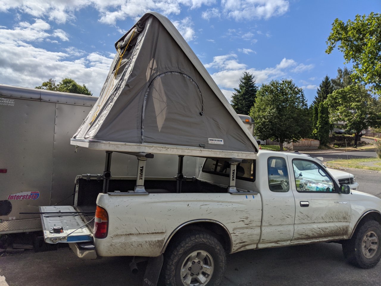

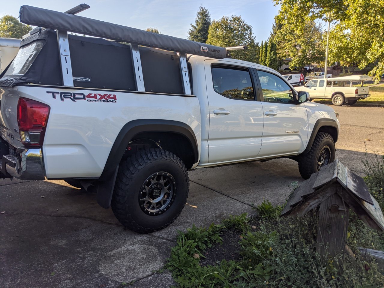

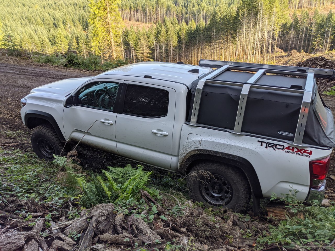

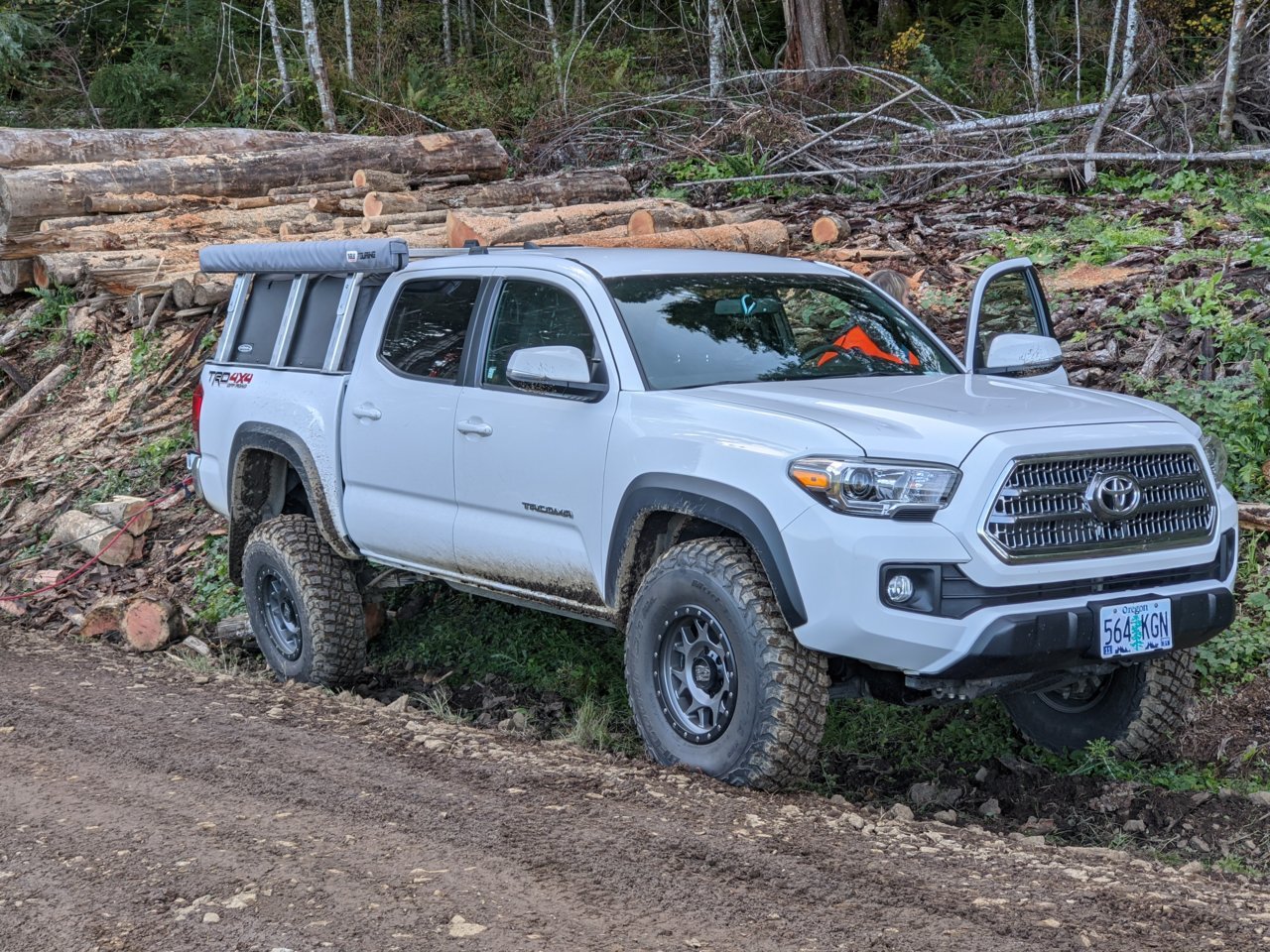

    Didn't like the options available, so I designed and built one out of aluminum for mine. I've posted pics in the past, but thought I'd upload newer pics with my lift on the truck now.
    I originally built it for hauling kayaks and such. However, I picked up a older model Autohome Columbus in great shape for $500 to put up there. Currently it is mounted on my son's Taco until I plan to use it.

    Rack looks great! It's times like this that I wish I knew how to TIG weld and not just stick...

    What direct mount roof rack are you using?

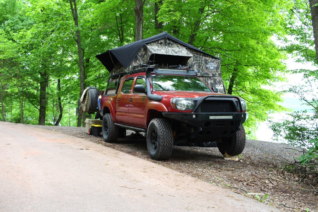

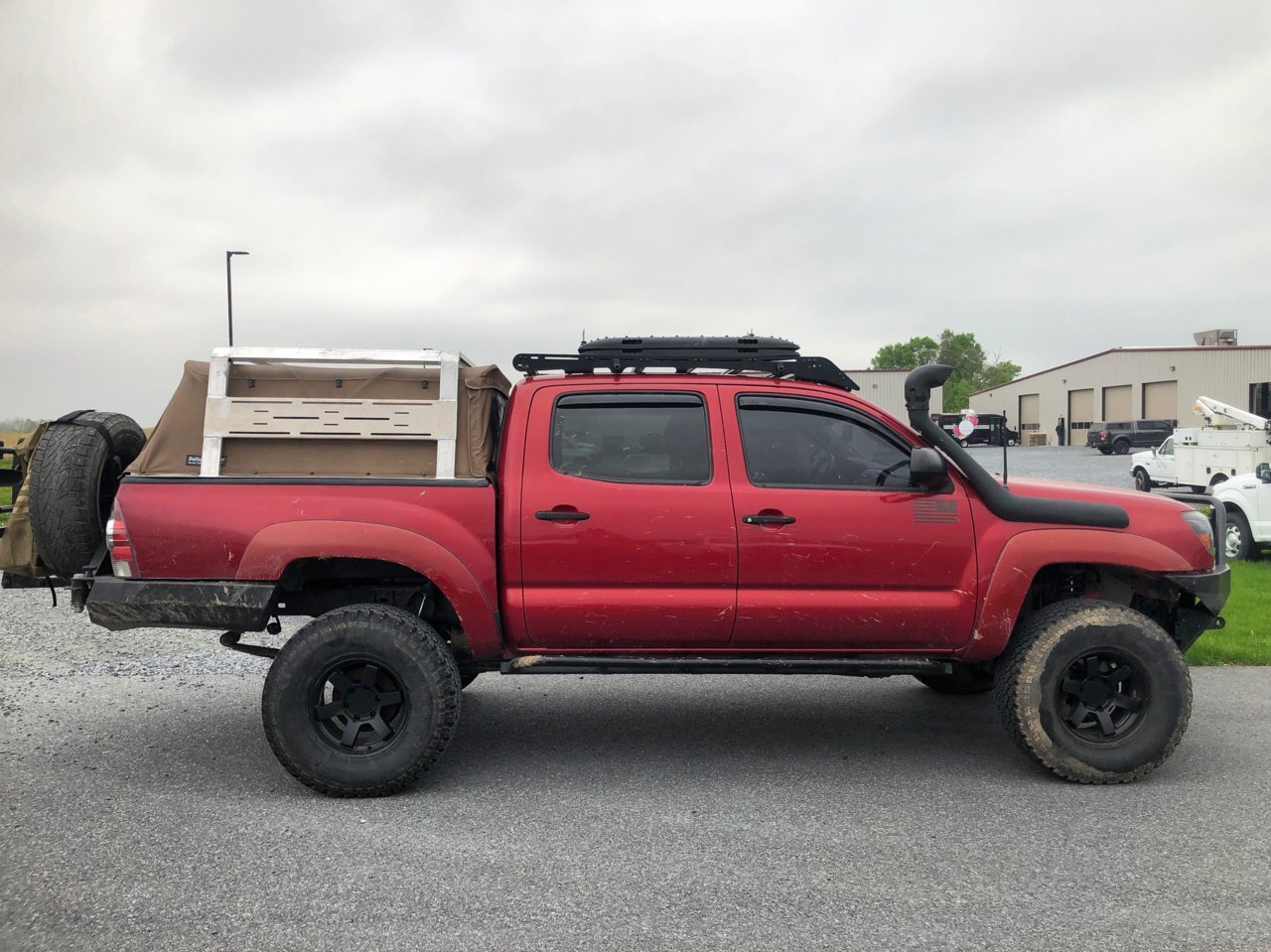

    Nice Job!
    I did the same a few years ago:

    Not sure exactly what you are referring too.
    The cross bars? Those are Rhino Aero something something racks.
    The front cab channels? Those are Rhino-Rack Ditch RTS channels for the 3rd Gen.
    The rack channels along the top of the aluminiminumnum rack? Those are generic Yakima Tracks (48" I believe).
    The stupid flat slot nuts are two different dimensions between the front Rhino brand and the rear Yakima brand. Neither company bother to give actual dimensions to their "proprietary" fancy pants nuts so I could maybe make my own. They want like $12 for 4 of them suckers! Soooooo, I one uped them and waited until I had both racks in hand and a set of 4 flat nuts for each brand. From there my laser cutter guy did me a solid and flamed me out 30 of them with Yakima dimensions in one direction, and Rhino-Rack on the other in 1/8" stainless as well as shot a 3mm hole in the center of each. Instead of square, they are slightly rectangular. From there, I just had to upsize the holes and tap them to take the proper bolt that actually fits both brands. These were all made with some scrap material on my buddy's end, so it only cost me a drill bit, tap and bolts. Now I can mount a crap load of stuff on either set of tracks and be on my way.

    What length is that ARB awning? 8 footer?

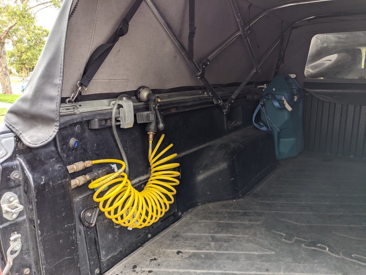

    my water pressure system rigged up ready to go under the softopper. sea-flo pump mounted in the bed cubby. love this thing. easy to refill that water container i have in the corner of the bed just unbutton the corner. ready for more beach days and camping trips this year.

    That's awesome! I might have to raid our copper scrap bin and go overboard recreating that. Would be awesome to have that after fishing/surfing

    it's been great for camping/fishing/beach days for us.

    How did you mount the quick connects to the bed?
