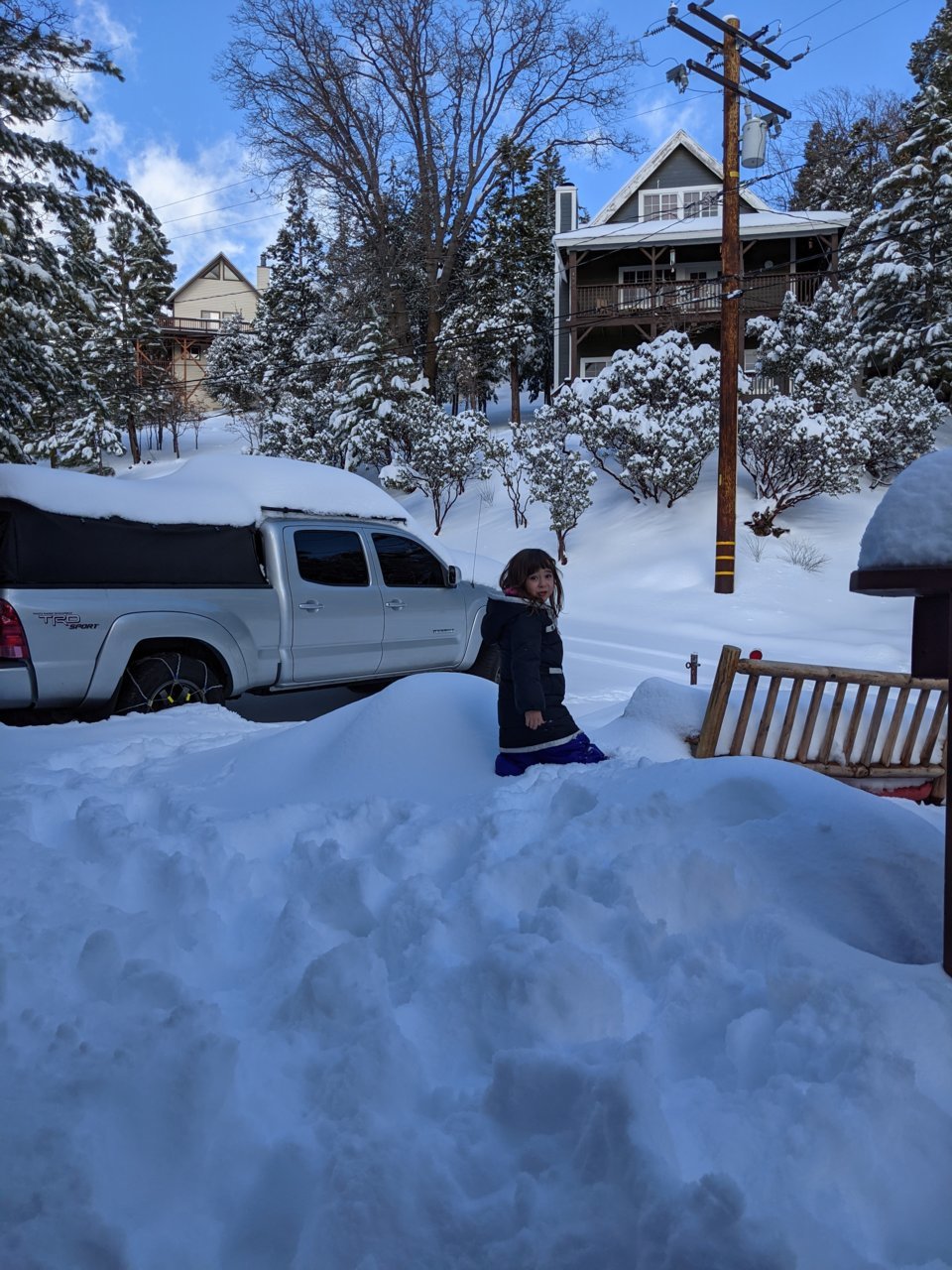

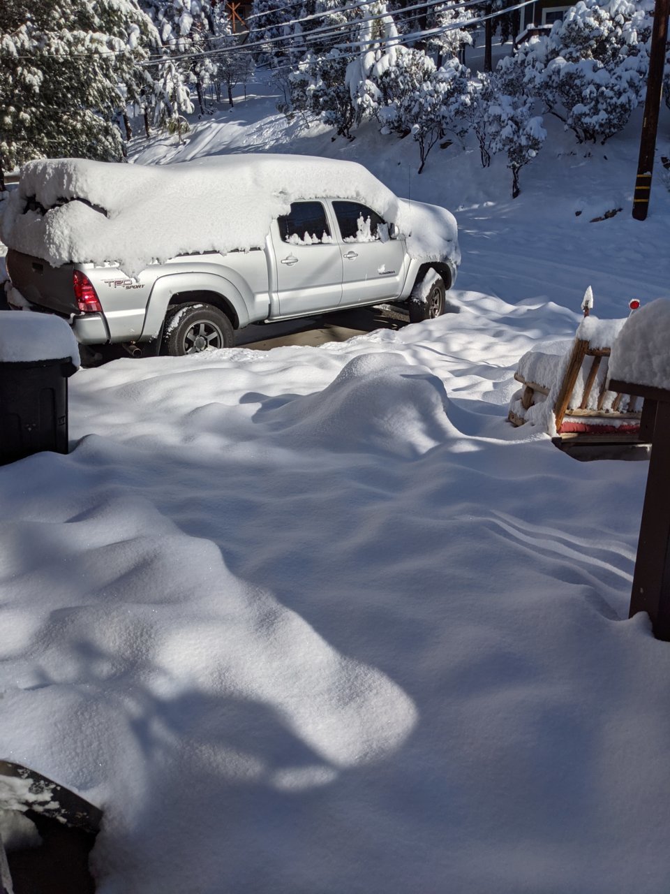

    Snow was not a problem for my softopper. But it was a huge problem for my useless prerunner

    yeah probably looking to sell this truck and get a 4wd after this trip. it was a battle just getting out of the driveway with chains on. 4wds were cruising around like nothing happened.

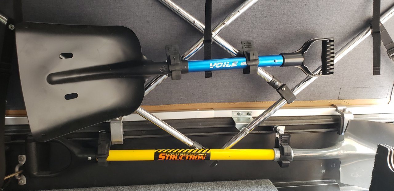

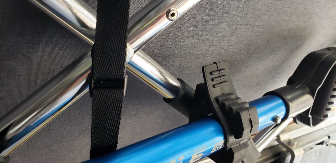

    I cant be the first to come up with this, but have yet to see it on this forum, so here' goes.

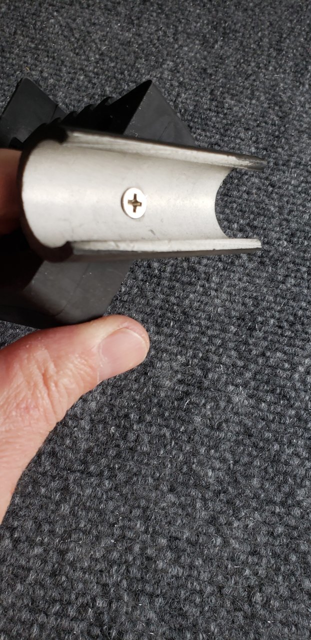

    I made these little clamp on mounts for lightweight stuff (the shovel pictured is all aluminum and insanely light). Cut a couple pieces of PVC LENGTHWISE, drilled a hole and countersunk the inside to accept the screw head. Mounted the quick fist, and snapped onto the softopper frame. Frame won't fold while installed but they just pop off with some force.

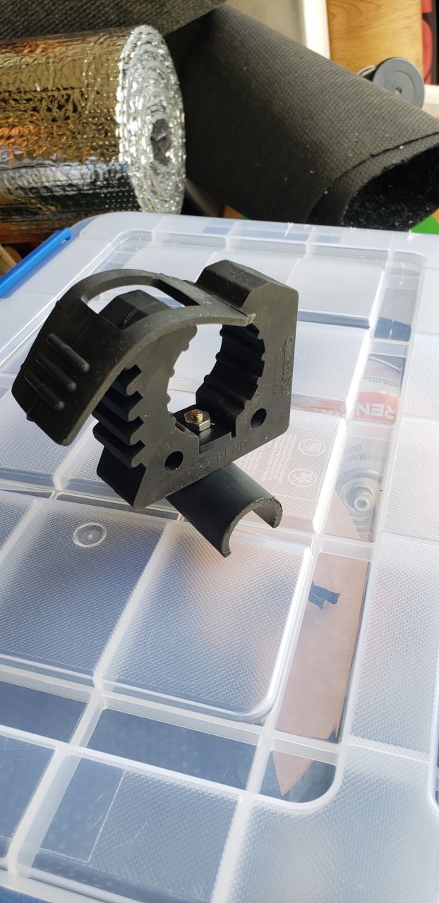

    That's a really cool idea! What size is the PVC? Any pictures of the screw head side?

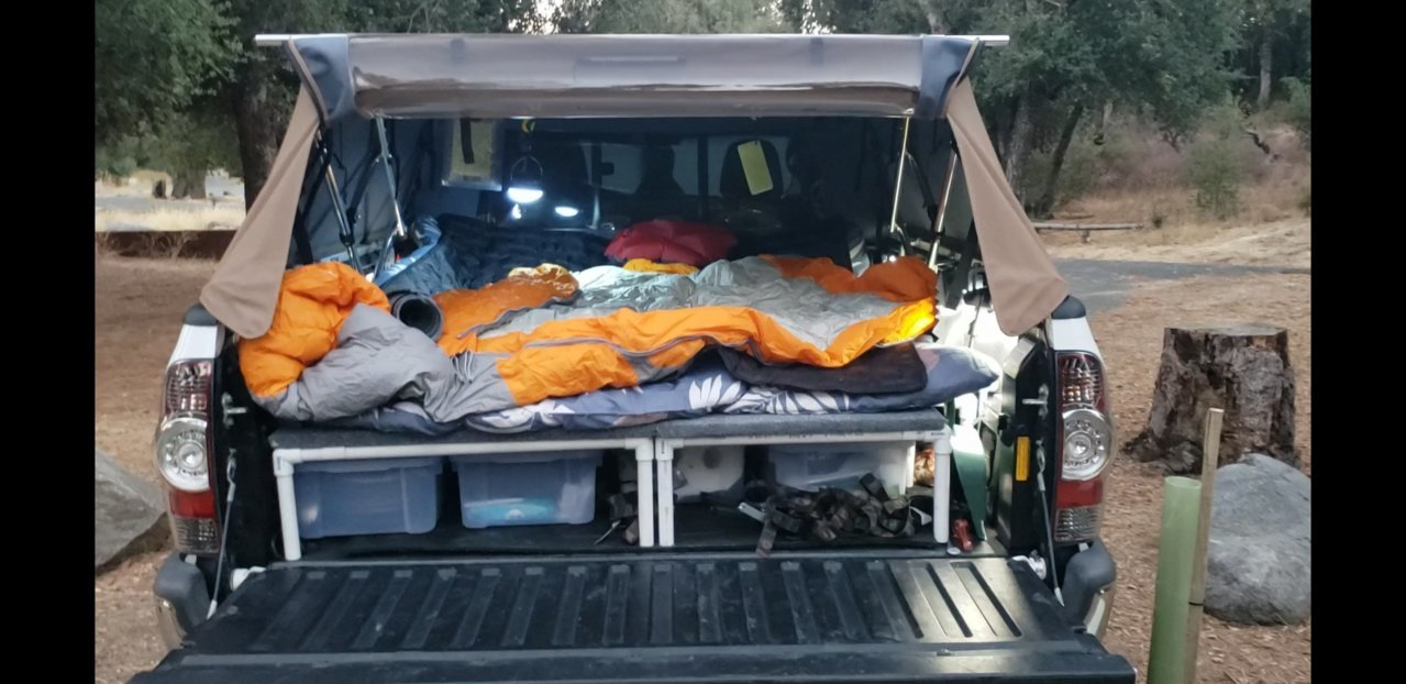

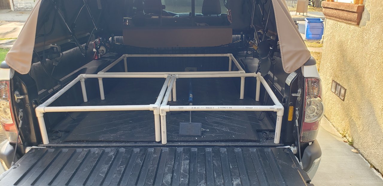

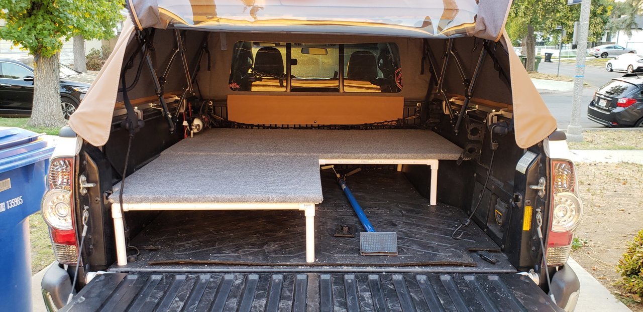

    It's 3/4" schedule 40 pipe. I also used it as the frame for my sleeping platform with 1" pipe used in the same fashion to secure the wood top to the PVC base. Just snaps on.

    Awesome, thanks. I thought it was actual black PVC or ABS pipe.

    That would have been nice, but I just used PVC I happened to already have. Quick coat of flat black and bobs your uncle.
