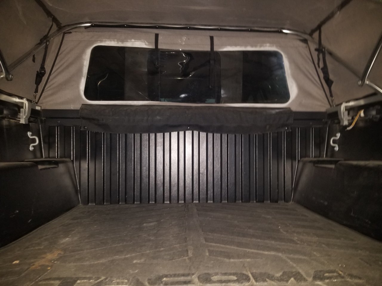

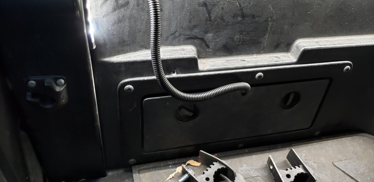

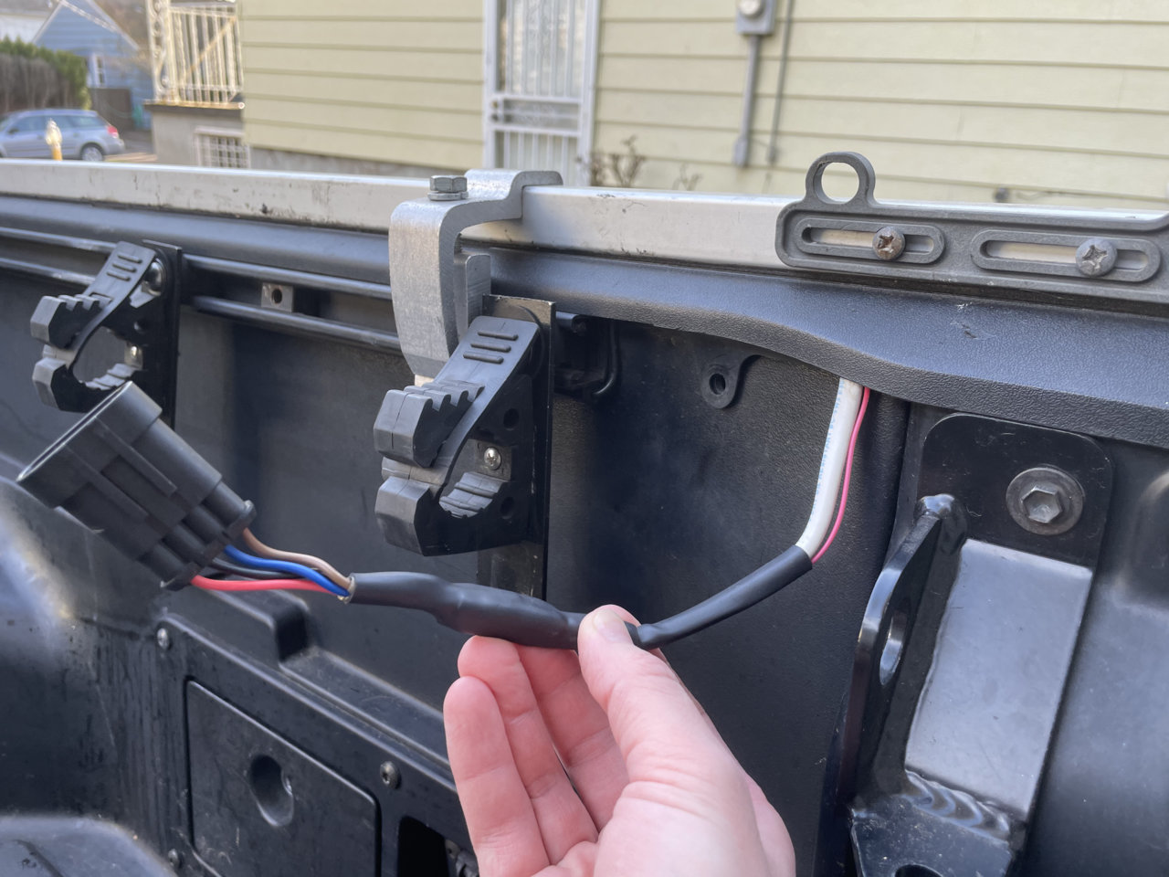

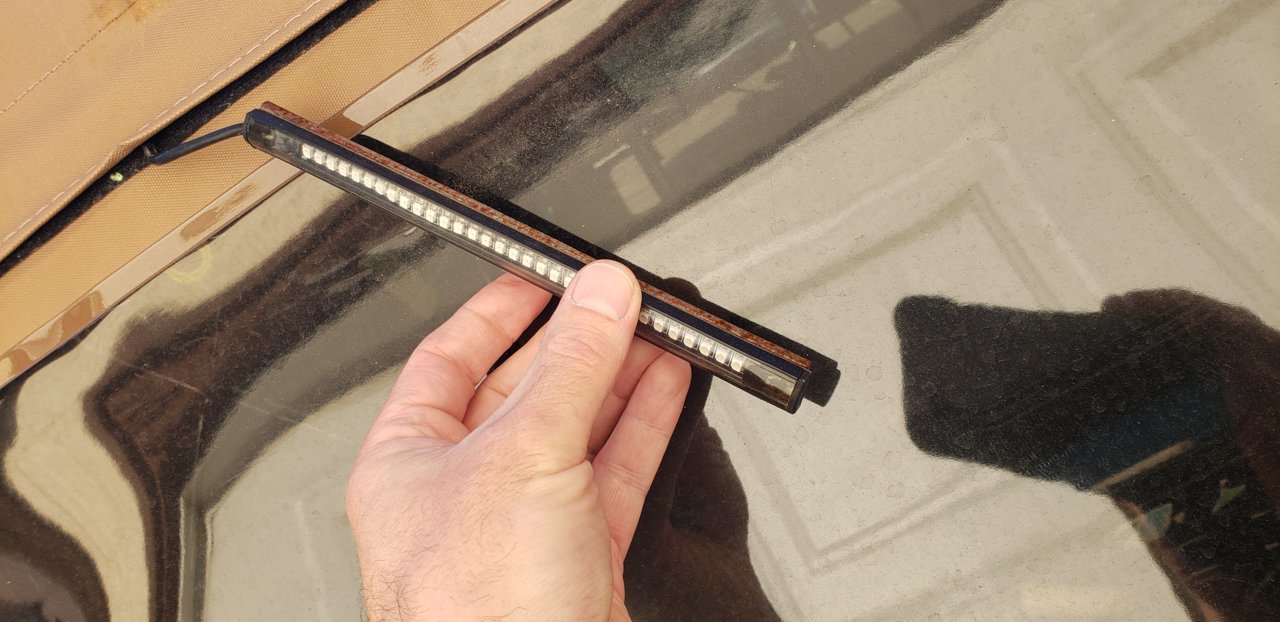

    Alright here we go, lotta pictures. Topper is currently off of the truck to enjoy the rare PNW sun, so sorry if the photos aren’t super helpful.
    Also, if you want photos of how I did the wiring I can dig around for them. But I didn’t want to take my tail light off right when I got home from work.

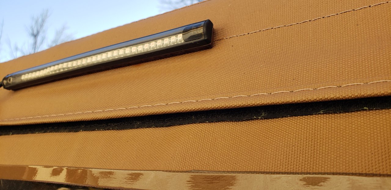

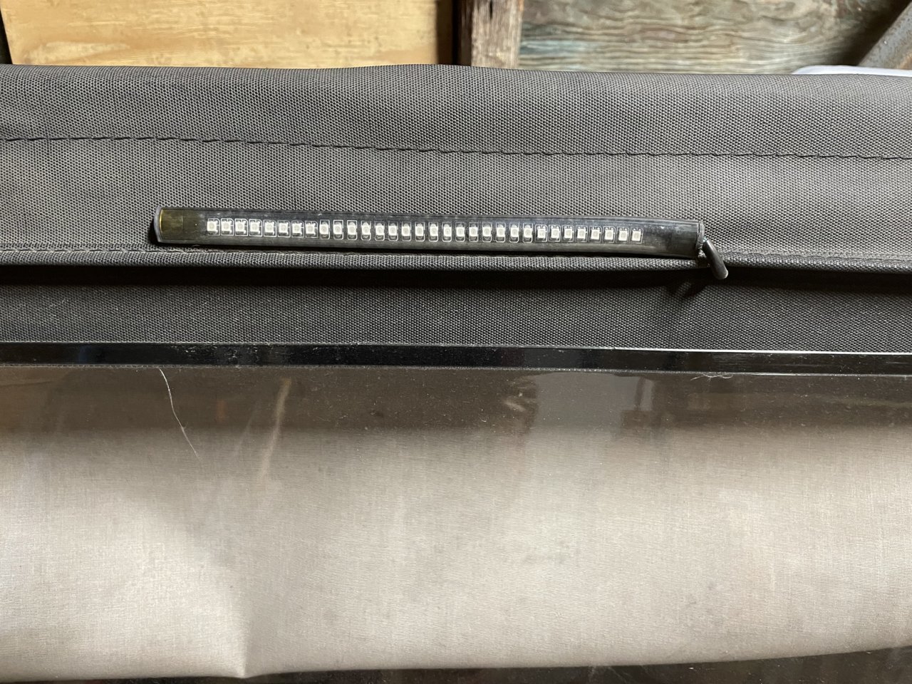

    First up is where it sits on the topper.

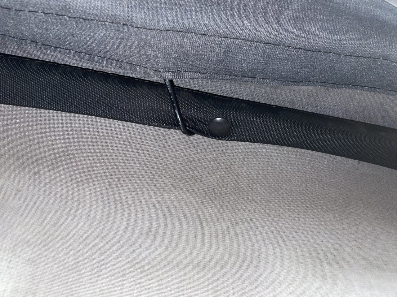

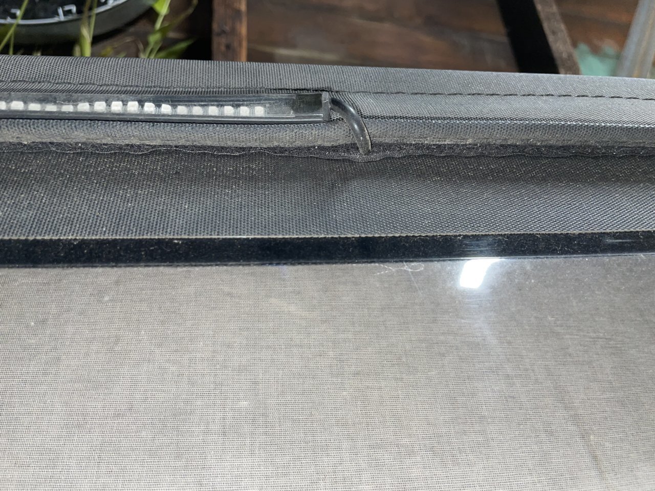

    Second is how I ran the wire. It is just sandwiched between the Velcro, and i have not noticed any leaking from this spot.
    Next is the backside of the wire running through the “Velcro sandwich”.

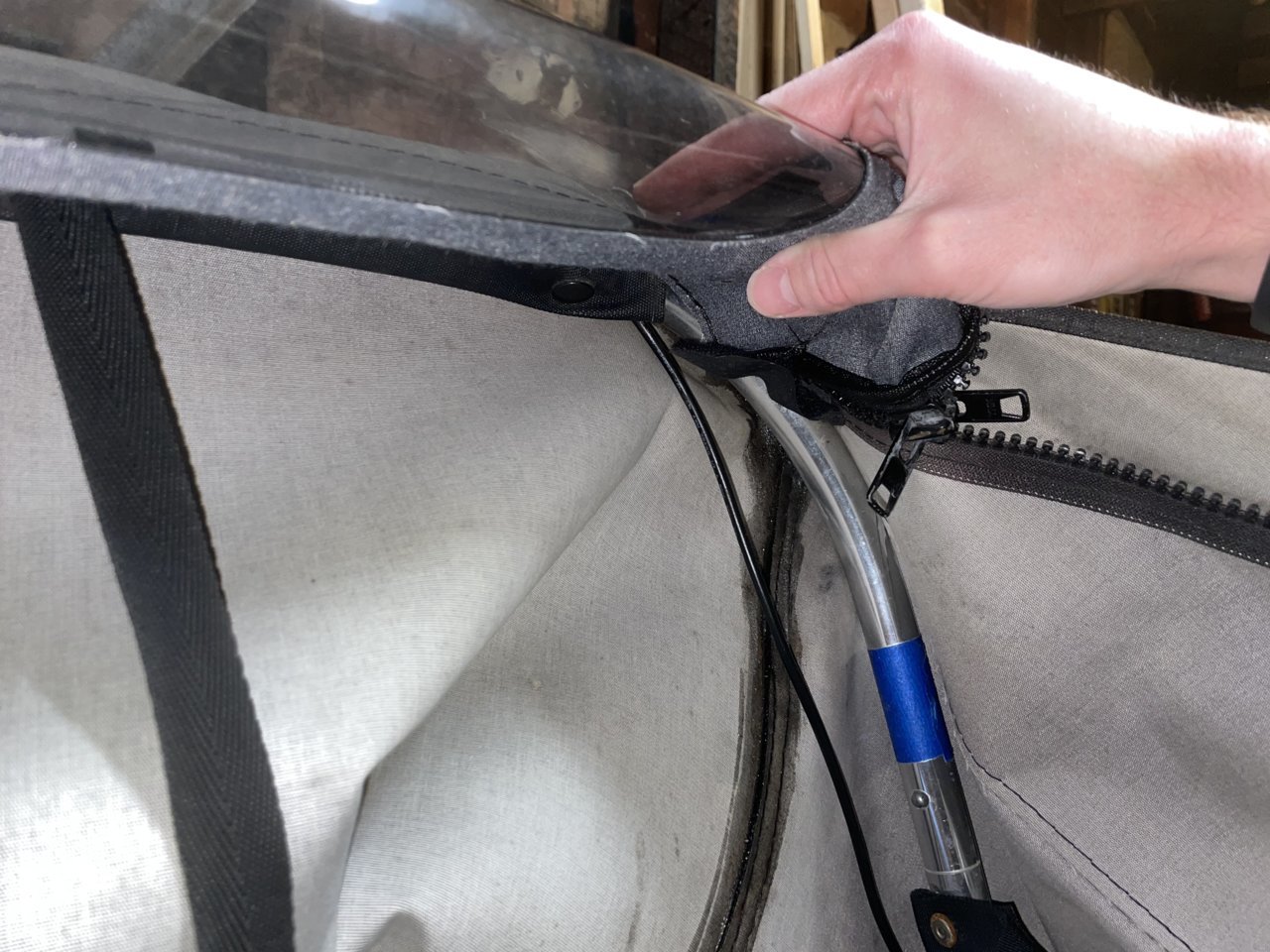

    Hard to show this part, but I ran the wire along the top in between the topper and the frame.
    Then wire down the frame, and ends in a waterproof disconnect (essential for PNW if you want to take your topper on&off).
    Now the wire in the truck bed. It’s the other end of the waterproof connector.
    I ran the wire between the metal and the bedside cap. Super easy to pop the cap off, and there are some large rectangular holes under the bed cap. I ran the wire through one of those, and between the bed composite&fender metal. There’s an opening behind the tail light, and I ran the wire through the opening and tapped into the passenger brake light for power.

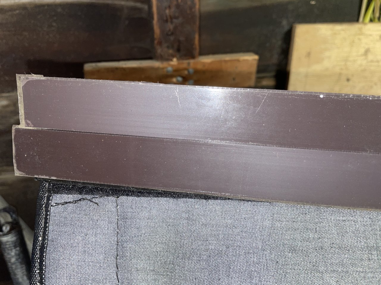

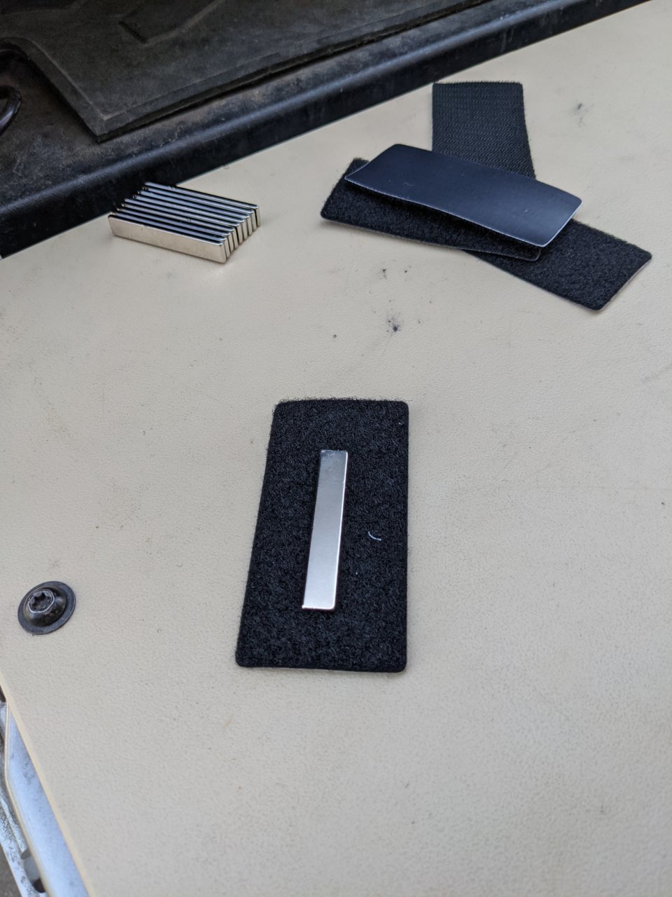

    Now for the magnets. This is the finished product obviously. I used what Velcro I had laying around, a roll of magnet strip (that had 3m tape on the backside of it), and then covered it in clear vinyl. The point of the clear vinyl was to hopefully prevent scratches. So far no scratches.
    The magnet/Velcro combo works great, keeps the window taught even at highway speeds, and is incredibly easy to open/close.
