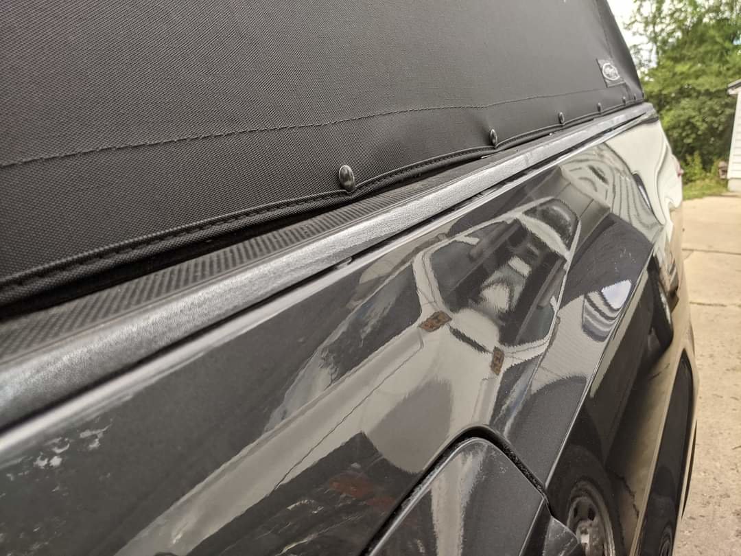

    sounds about right. I think it's torqueing inward, there's a gap on the outside of the bed. I'll get a picture and post it after work.
    Edit. here's a pic I took before.

    Has to be the clamping right? Definitely seems many different variables people have run into with the clamping. Between placement, angle and how much its torque'd down, i can see where you can have some discrepancies between our diff't installations. But, Im gonna check on mine again, who knows, I just might not have noticed it. --- But def check and look up in the channel, that clamp fitting is supposed to get all the way up into and sit flush to the top of the top inside in the channel. If it stop short, it will still tighten down but it will grab the edge and start pulling in toward the middle of the bed. At least I noticed that when installing mine.

    How much torque should we be looking at for the clamps? I likely was overzealous with mine because I have the same problem. The topper base is pulled inwards which has lifted the black bedsides up.

    Yes thats exactly what I'm talking about. I only had my soft topper about a week and I took it off to see if the black plastic would flatten back out and it doesnt..
    Not a huge deal, just curious if anyone had a solution.

    I never really cared when I had my softopper on. The trim pieces will go back normal once you remove the softopper though. Though, you may try removing the trim pieces, cleaning them with isopropyl and applying some 3M two-sided tape the underside of the trim near the outside edge. It may be strong enough to hold it place.

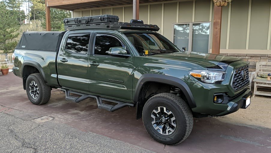

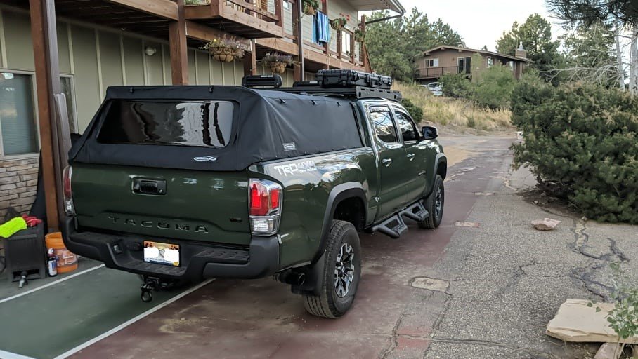

    Two month wait and it's finally here!

    Wow! I haven't noticed mine doing that. You didn't over-torque the fasteners did you? I ran the same topper on my second gen for years without that happening and I have it on my '19 now. I wonder if they changed the frame in recent years.
    Also, have you checked the aluminum blocks to make sure they're sitting flush in your rail? If they're slightly bound it can cause aluminum base to roll inward.

    Well, I'd loosen that pig back up until my bed rail caps sit back flush and start from there. You may just need to loosen that kung fu grip.

    Well, I did a reinstall. it's all good until I get it set up and have the topper set up. it's like the downward pressure where the canopy attaches to the mount is torqueing it over
