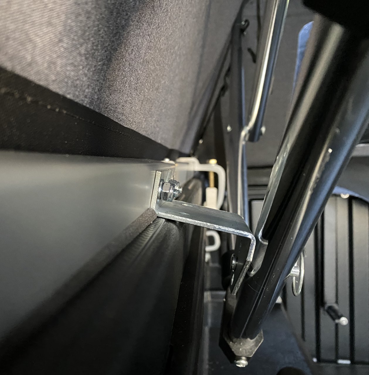

    After having the Softopper for a couple weeks, I decided to post a review on Softopper's site telling them how I like it and the one thing I've noticed that I don't like.
    "I love the versatility it offers me, it looks amazing on my Tacoma (Cement with a black Softopper) and the installation was a breeze. I knew I would be waiting a while when I ordered it, but I wasn't in a rush. Ordered on November 24 and received it on January 12. With all the issues the pandemic has caused, I'm happy to wait for a quality product.

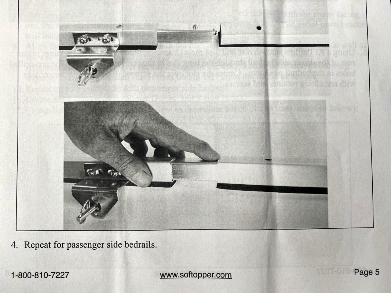

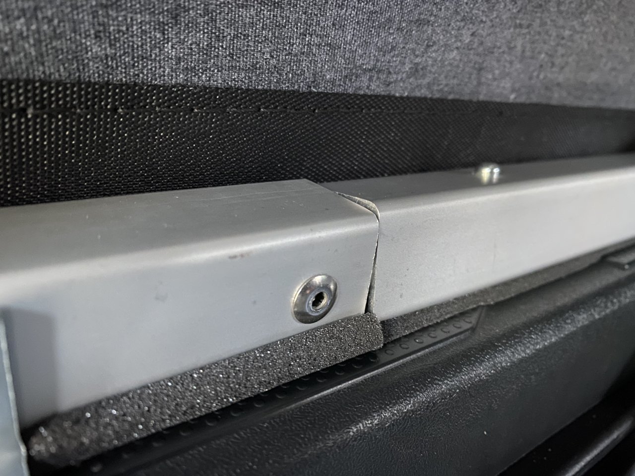

    Now for the one negative thing I've noticed about my Softopper. On page 5 of the included instructions, they show connecting the two halves of the bedrails together. The pic shows a square tube inside the square bedrail that connects them together. The inner tubes on my bedrails are round not square. This allows the rear half of the bedrail to twist inward from the weight of the topper and the stress of the stretched material.
    I've heard of people having these tops for years with no issues, but I'm curious how long they have been using the round tubing inside the bedrails. I'll probably buy an extra set of the rail clamps to attach close to where the two pieces of bedrail connect. If you have the long bed tacoma, they come with a third set of clamps and you should be all good. Seeing the bedrails roll inward on the short bed like I have, these should come with three sets of clamps too. For or a product that costs $800, I shouldn't have to order anything else to make sure it's mounted correctly.
    Overall, I'm still very happy with it and I hope it lasts for years to come."
    Can anyone else on TW that has a Softopper, tell me if the inner tube that connects the bedrails is round or square on yours? And if it's doing the same thing as mine? Anyone running a third clamp close to where the two pieces connect and does it help?

    Mine is square. Does not twist. And it sits level with bed rail (NO lean inwards). I bought in 2017.
    You made a good observation and I hope Softopper remedies it.
    Will try for a better photo after sunrise...

    Interesting. My guess is supply chain issue. Mine has square tubes. Purchased 2-3 years ago. Short box.
