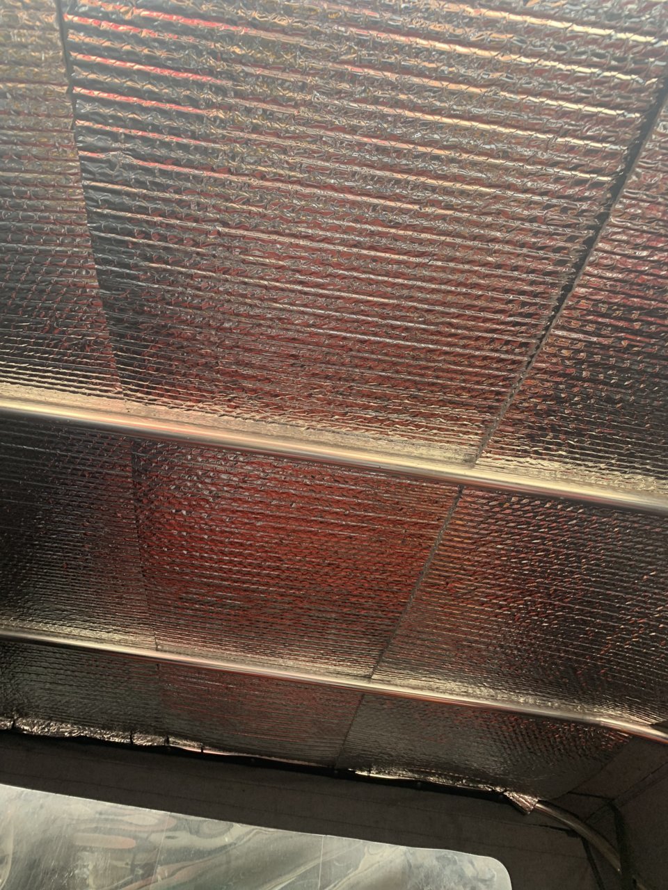

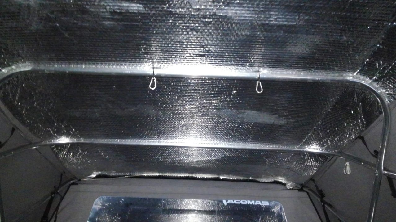

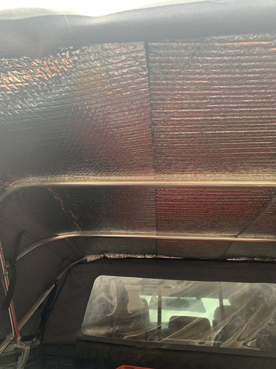

    My reflective insulation droops and folds down and hangs. Struggling to keep it up there. Really helps with the heat so I wanna make this work. Also I fold the topper forward often so I don't want anything too permanent. Any ideas?

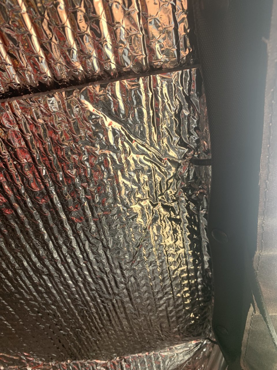

    Ok so I just did mine and I poked two holes on each corner and wrapped a zip tie around the front and rear bars that has the snaps for the canvas to snap onto. The zip ties are totally hidden and it seems like it’ll work great. I pulled them tight

    Here are a few pictures AEAC71D3-7F94-43C8-B109-1EA6D912AE3E.jpgC1458C18-C197-4ECC-9A1C-5923E70DD9F4.jpg 5103047B-4337-4A62-A069-57914F7523F3.jpg

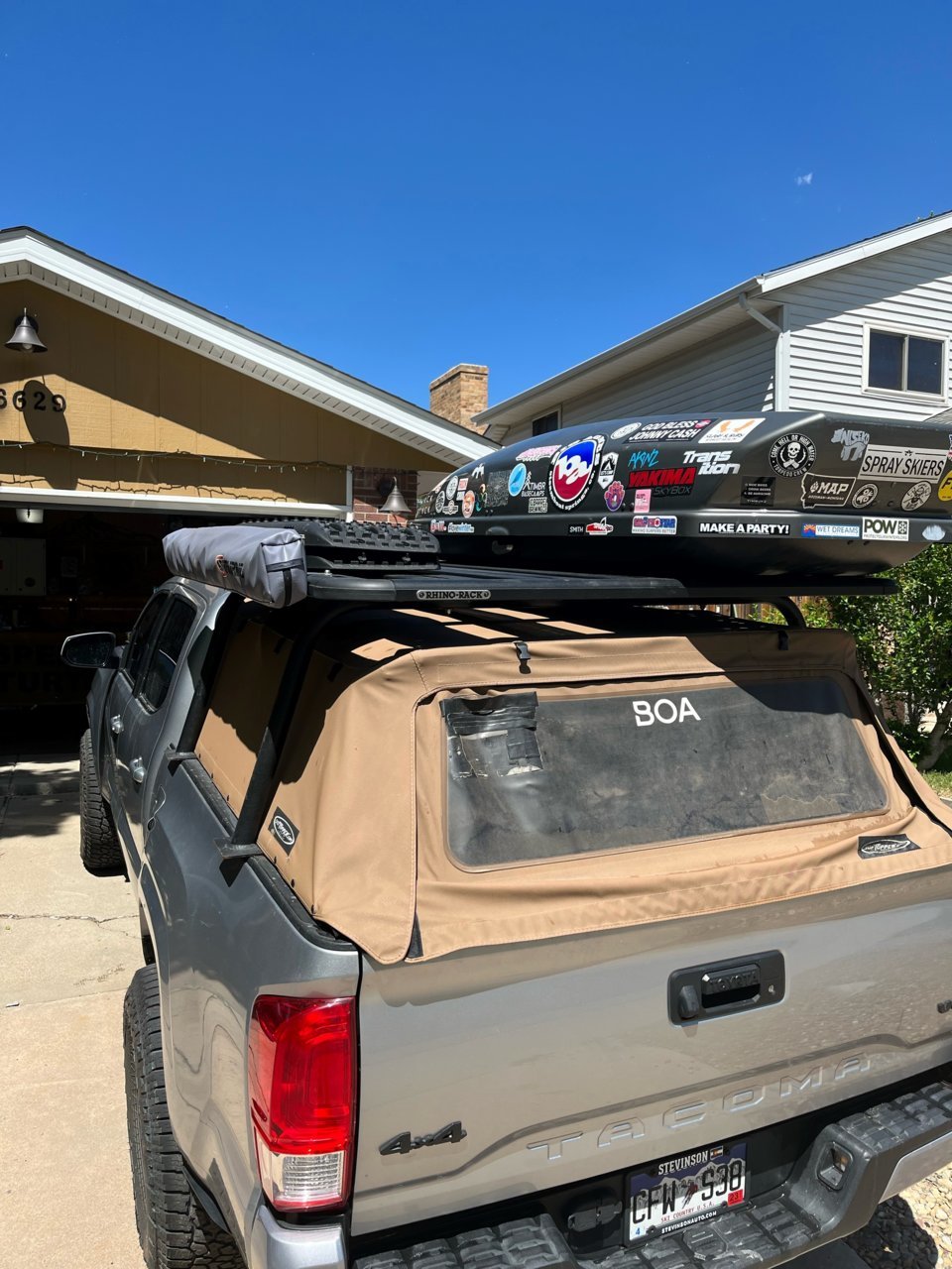

    got the yakima installed above the soft top this morning

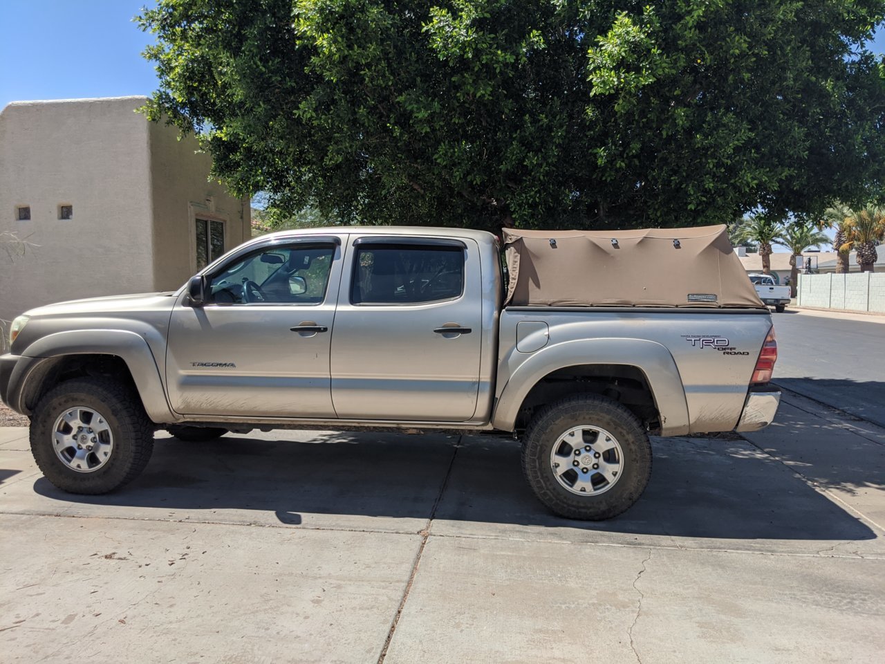

    I was just taking some measurements to get a replacement rear window. I'm the 3rd owner of this soft topper, I'd have to guess this one is ~10 years old. Some of the stitching is starting to come apart, and it's getting some holes in the roof. Any idea how long these last? Thinking maybe I should just order a new one to go with the Heavy Metal bars I just got.

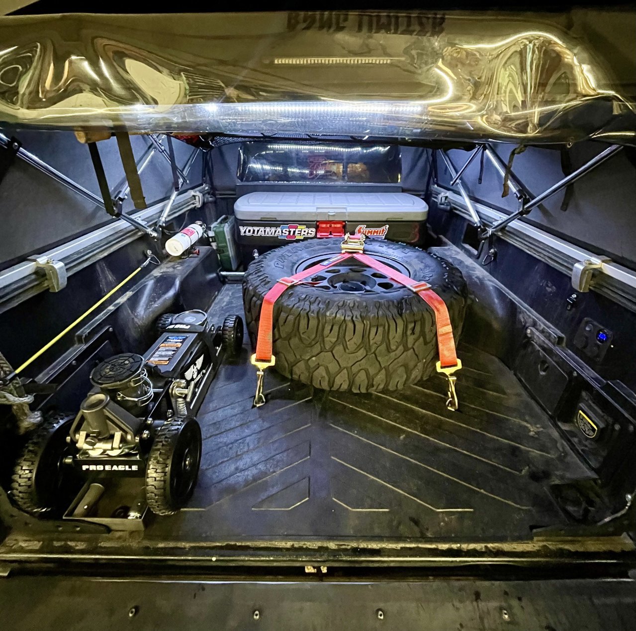

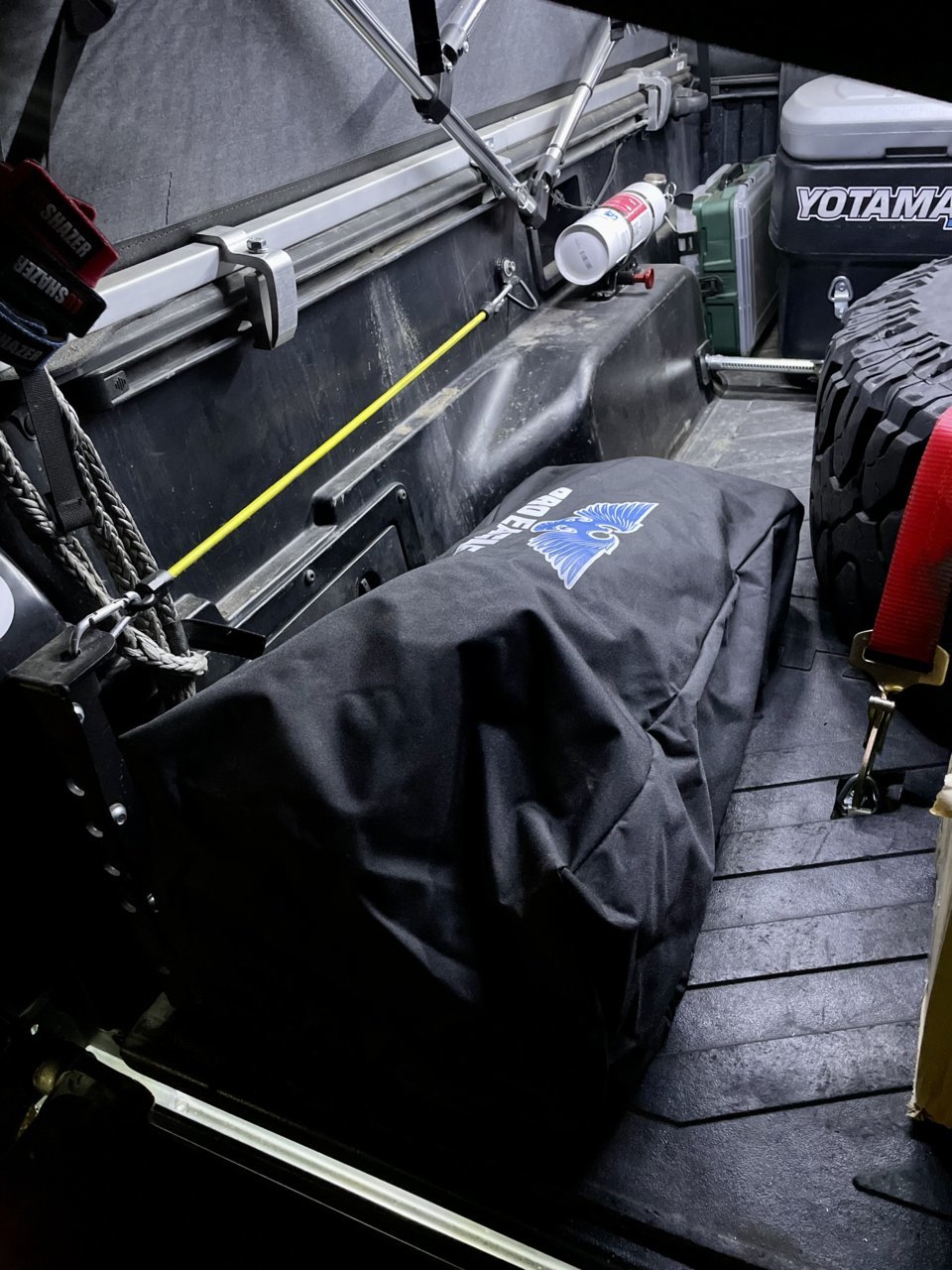

    Finalized the bed setup in the soft topper for now.

    Is that a Matt gecko light kit or did you roll your own? Curious as to how the wiring is done up and routed as I'm working my own solution with chinesium cuttable strips and DIY wiring.
    How do you secure the jack? Is it also secured from theft?
  18. Jun 11, 2022 at 11:21 PM
    #7218
    T.Barn
    T.Barn Well-Known Member
    Sep 1, 2020
    #339422
    695
    Todd
    Hampton Roads, Virginia
    2010 AC 4x4 6MT
    It is the Matt gecko kit. I routed the wiring to the cab in order to have the switch in there that was I can pop it on and check the bed while driving if need be.
    I used the pro eagle 2 ton big wheel jack mount which has a bar that runs through the top and a pad lock on it. As far as mounting it I marked the two bed bolts on that side and drilled the mount to be able to use the existing bed bolts to mount it down. Nice and solid and didn’t have to use any new holes in the composite bed.
    The jack mount also came with a cover which I thought was pretty nice.

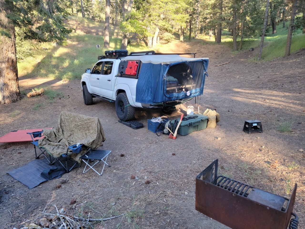

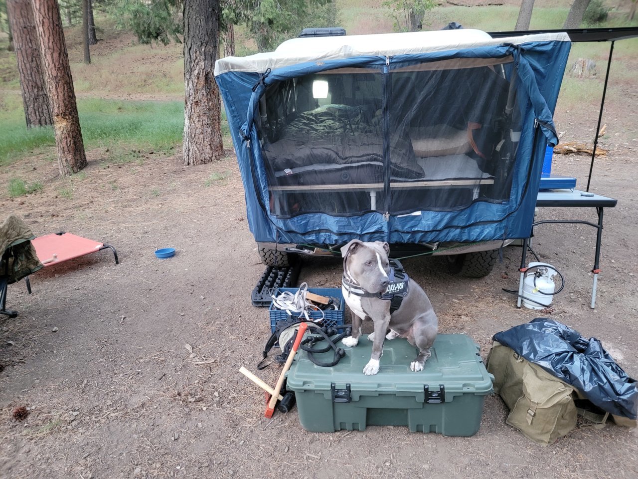

    For sale, Softopper camper top tent. I used it once and decided I didn't need it. It is a nice set up, but I enjoy ground tent camping whenever possible. Perfect condition. New on Softoppers site it is $199 + shipping. Asking $175+ shipping.20220531_185942.jpg 20220531_200220.jpg
