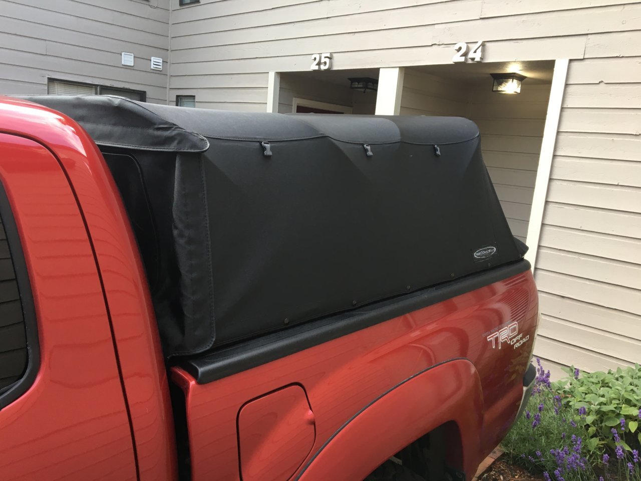

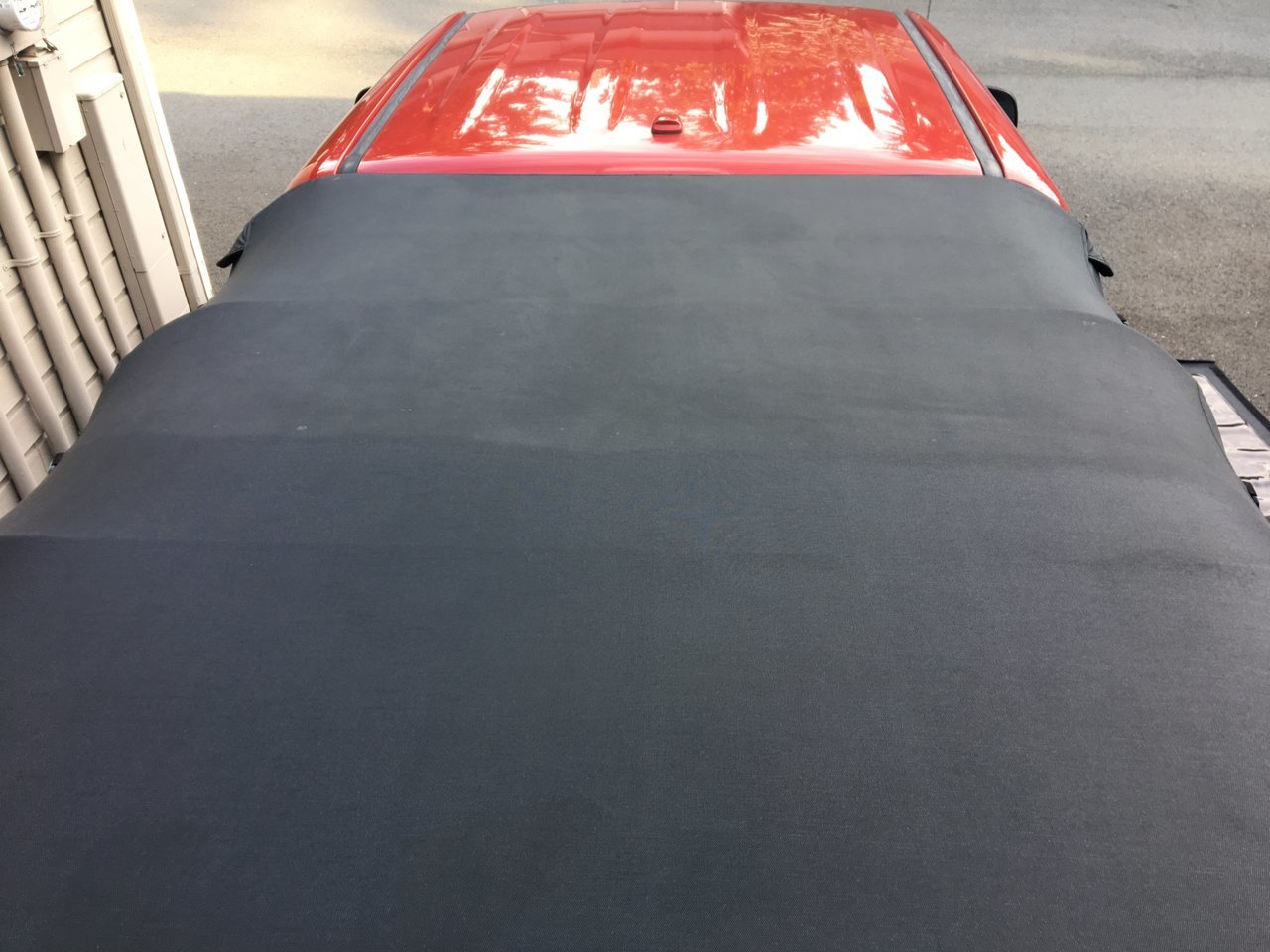

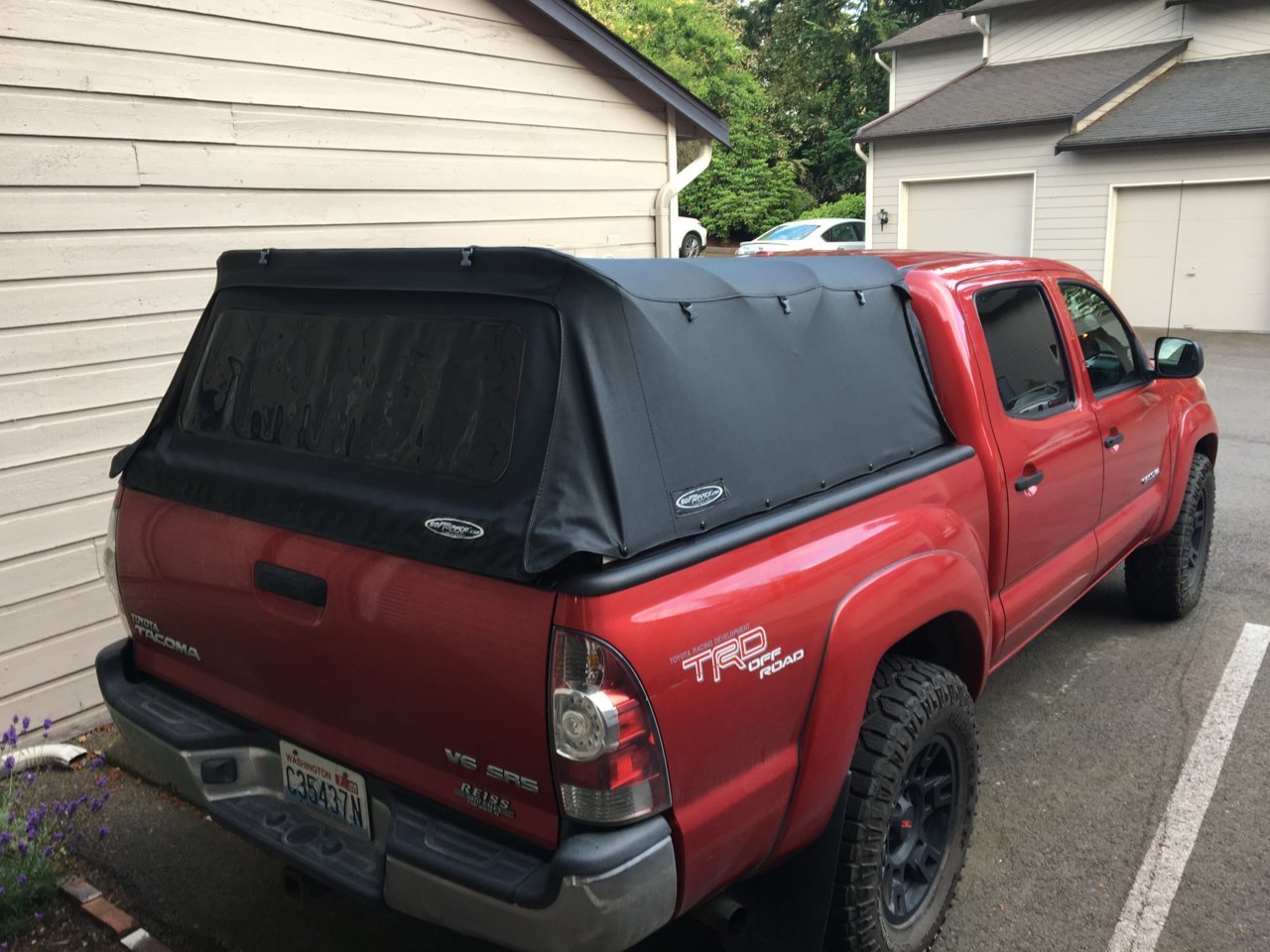

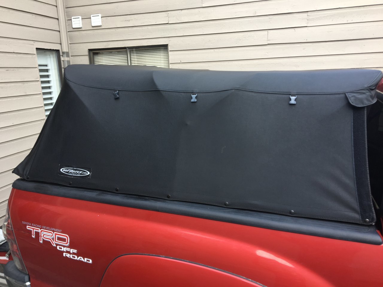

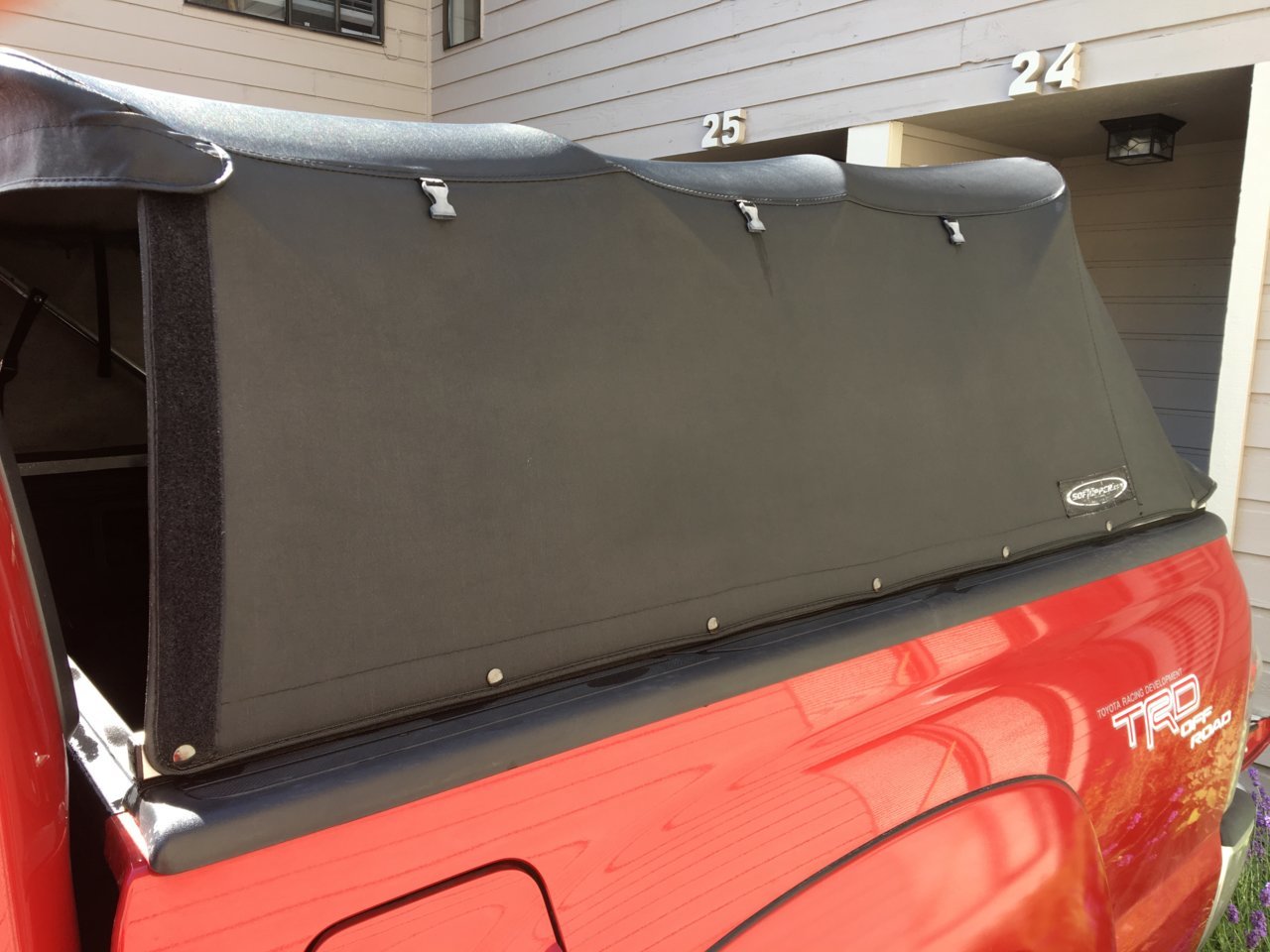

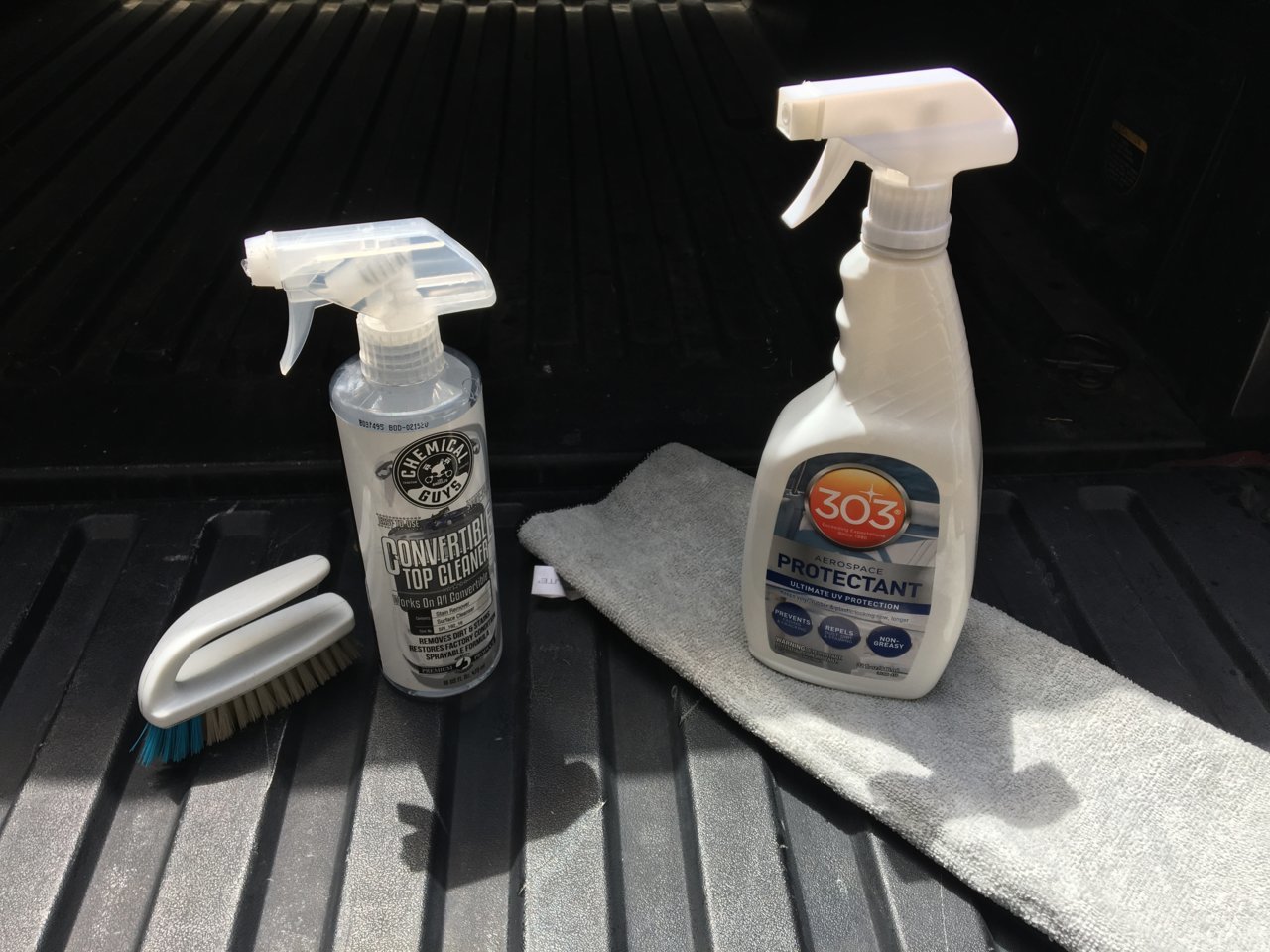

    Afternoon everyone! Yesterday I cleaned up the softopper as the 4th is the unofficial start to the summer in the PNW. Figured I would throw together an unsolicited recap on how to clean these as many have asked about it. I’m also curious on any extra tips and tricks from others, so please be sure to give me a critique as well!
    For starters the biggest question is, what products do you use? I have been using the Chemical Guys Convertible Top Cleaner with a small utility scrub brush to get the caked on mud, dirt, and grime out of the softopper. Once the topper is clean I spray on 303 Aerospace Protectant and use a generic microfiber cloth towel to rub it into the topper fabric. I also pull out my ladder to help reach some of the top portions.
    To be honest I have only used these products so I cannot provide you any practical expertise on why these products are superior to others, if they are. What I can provide is the reasoning. I went with the Chemical Guys cleaner, over the Meguiar’s, since the ingredient list seemed simpler and didn’t appear to have a lot of additives. It is a little pricier, but I typically go with the mantra, “simpler is better”.
    For the protectant, 303 is a well known product that a lot of people trust, especially on TW. I was looking between the Marine/Aerospace and the Automotive Tonneau Cover & Convertible Top protectants. I ultimately settled on the Aerospace product as it was a simpler process to perform, spray on and buff in, and had a wider range of materials you could apply it to, such as leather, plastics, PVC, fabrics and more. The Tonneau Cover & Convertible Top protectant required you to have a damp surface to spray the protectant onto and then rinse off after application, and seemed to be strictly used for vinyl and fabric materials.

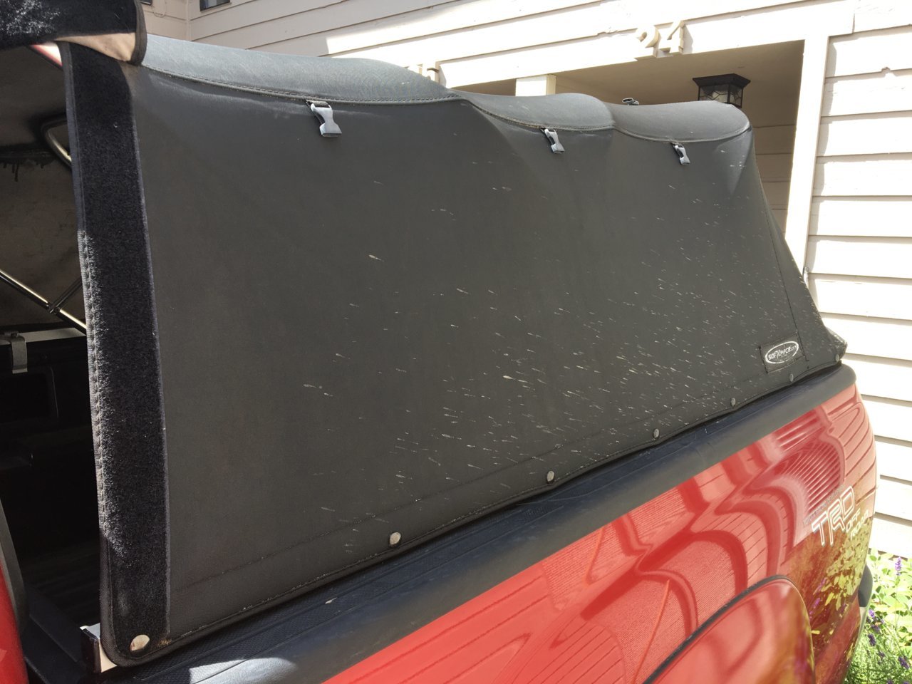

    For a base line, the photos below are the starting point. The protectant had faded and the topper had dirt and mud on it from making several trips out to the local National Forests.
    A0BE969B-442A-49C1-99AC-234BFE1393E7.jpg 8CBC0493-697E-4691-B43E-05F8476A90D9.jpg
    My typical process is to leave the main panel on the truck and pull the front and rear panels off. From there I start spraying a small area with the Chemical Guys cleaner and scrub the area similar to waxing a car until the suds subside. If you have a dirt spot that didn’t come out all the way, then revisit it. My topper is second hand and there are a couple spots that won’t come out. At this point this is how the topper looks:
    BF7C4AC6-0583-424F-935C-8894B6685ECC.jpg 12F91DA0-6D5E-4EC2-AF0A-ADB243DC7CF8.jpg
    Not too shabby at this point. After scrubbing the topper I will take it to the local car wash and rinse out the soap. This isn’t typically talked about, but I feel that it is important as it pulls out the dirt and cleaning agents. For the front and back panels I will use the floor mat clips at the wash to hold them so they are not flapping everywhere and to keep them up off the ground.
    Once the topper has dried out I will pullout the 303 and start spraying it directly onto the topper and using the microfiber cloth towel to buff the protectant in, again similar to waxing a car. The hardest areas to buff in the protectant, for me, are around the plastic Velcro strips. The Velcro latches onto the micro fiber towel so you have to use some caution. For reference, below is a few pics showing the difference between the topper only being cleaned versus the topper with protectant on it.
    Here you can see the top of the topper. The 303 treated part is the portion closest to the camera with the untreated portion on the side with the truck cab.
    From the side, again the treated part is on the tailgate side with the untreated part on the cab side.
    The directions for the 303 state to apply the protectant out of direct sunlight. So I would suggest doing this outside on a cloudy day, or underneath some shade. The 4th was fairly cloudy and it was late enough my parking spot had just enough shade that it would be out of any direct sunlight even if the sun popped out.
    Once everything is coated with 303, you’re done! Time to put the front and back panels on and clean up.

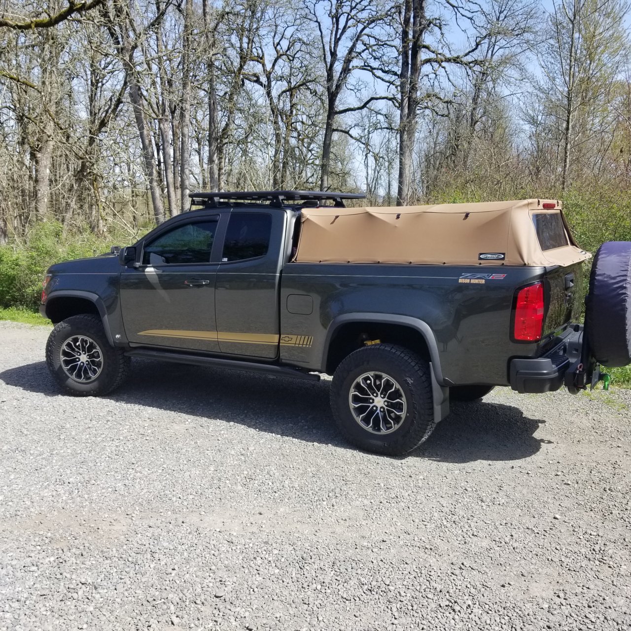

    I'm impressed on how nice my softopper cleans up after 3 years of dirt and sun.
