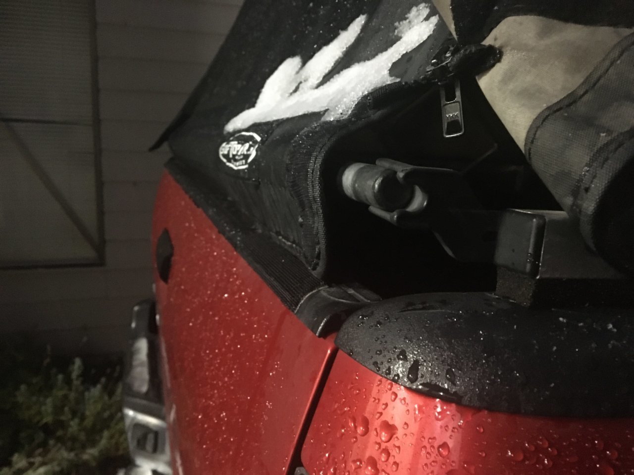

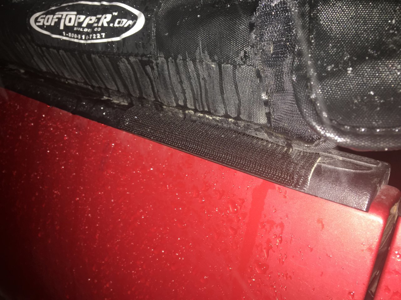

    Apologies for the delayed response, been working crazy hours with snow all week. I have the straight bar in the back, and believe the curved is typically reserved for the 3rd gens. I will find my flap tucked inside of the tailgate or wedged on top similar to the photo below. You can also see the Velcro strips I placed on top of the tail gate was well.
    As for the inside panel, next to the cab, I learned the hard way that it needs to be secured. The first time I didn’t secure it, and hit highway speed, I thought the truck was coming apart with the panel beating against the rear window. I used the same Velcro strips to secure the inside panel as I did for the tailgate, but those have started to fail as well. I did buy the screw in buttons, but 2 of the 3 locations to screw them in are on the ridges of the bed box. I drilled one button in and figured it would at least help prevent the panel from getting loose.

    Yours looks to sit quite a bit higher up than mine. First pic, the end of the side rail, where the bracket for the bar is... I'm seeing what looks like 1/2" of foam between the rail and plastic bedside. That foam should be squished down completely. I'd try refitting the side rails and make sure they're clamped down tight and parallel to the bedsides. You can order extra clamps if needed or move the clamps you have now. You may have them placed too far inboard - IIRC they are supposed to be within 10" of the end of the rails.
    I'm also wondering if your entire frame assembly is up too high. How old is your topper? Has it seen lots of sun and weather? The frame is adjustable where it secures to the side rails. There are 3 settings and I'm wondering if yours is set so that the frame and canopy are at the highest possible position. You should be able to lower it by 1/4" or 1/2" depending on where it's currently set.
    As for the front panel, that's a bummer. Mine worked great and all lined up well. That said, when I sold my first topper and replaced it with another one it didn't line up with the snaps for the first one. It's close but not quite close enough to snap in. For your situation, you can pretty easily just replace the snaps. Softopper sells replacement parts for just about everything and if you don't see it on their site you can call and ask.
    https://softopper.com/products/snap-replacement-kit/

    Trying to figure out how your velcro is on top of your tailgate. I'm pretty sure it should be at least two inches further down onto the actual skin of the tailgate to match up to where the velcro on the rear window panel would line up.

    I will have to look up how to do the adjustments for the canopy frame, I was unaware of that. I am not sure how old the topper is, as I am the third owner of this particular unit. When I brought it home, I removed the old foam seal and, admittedly, I replaced it with a cheap adhesive foam strip from the local ACE hardware store. I settled for the cheapest foam seal I could find, which ended up being a 1”x1” strip. I think the original Softopper foam seal was either 1/8” or 1/4” thick, a that is why my rails sit a little higher than they should.
    As for the front panel, I have it figured out now. It’s secure enough and hasn’t caused any major issues since I added the one screw snap. I did buy the snaps and the replacement buckles straight from Softopper. Despite some minor complications, I still really like my topper.

    Being that high gives you one heck of a gap in the corners. Notice how mine are flush against the sides? Even like that I still get plenty of dust in the bed.

    The Velcro placement worked, at least for a time. I really did not want to add the adhesive strip directly to the paint… Worst case I’ll add the clear protector and let the back panel flap. I know it’s superficial but I really wouldn’t like having a Velcro strip on the red paint.

    I skipped the Velcro strip, but did put a 2 inch clear vinyl strip across my tailgate where the back panel rubs. No issues after doing that.

    Good point with the corner gaps, at some point I’ll change out the foam. When I do that, I’ll look at adding the vinyl. Appreciate all the comments!

    I’m not familiar with the 3rd Gen model, but pull your adjustment straps tighter in the corners and it should sink your height down and give you more coverage over the tailgate.

    No shame in having to replace the foam, I've done it on mine too but I think I used maybe 1/4-1/2" thick or something. No issues except it didn't last as long as the stuff from Softopper.
    The thick foam can't be helping but I'd wager a bet that it isn't the problem. That foam should squish down plenty. In your pic it's not the foam that's pushing the rail up and away from the bedside. It's the rail not being secured properly and then the foam just taking up the gap.
    If your topper is that old then I'd imagine the fabric has shrunk a little - which is normal and I believe that's why the frame adjustments exist.
    The pics jackn75 took look just like mine. The fabric should go well below the top black plastic part that sits on top of the tailgate. I think if you can make the adjustments to get it down where it should be then you can probably skip the velcro. Hasn't ever been a problem for me. Perhaps not as dust proof as it could be otherwise but should still be a lot better than what you're dealing with now.
