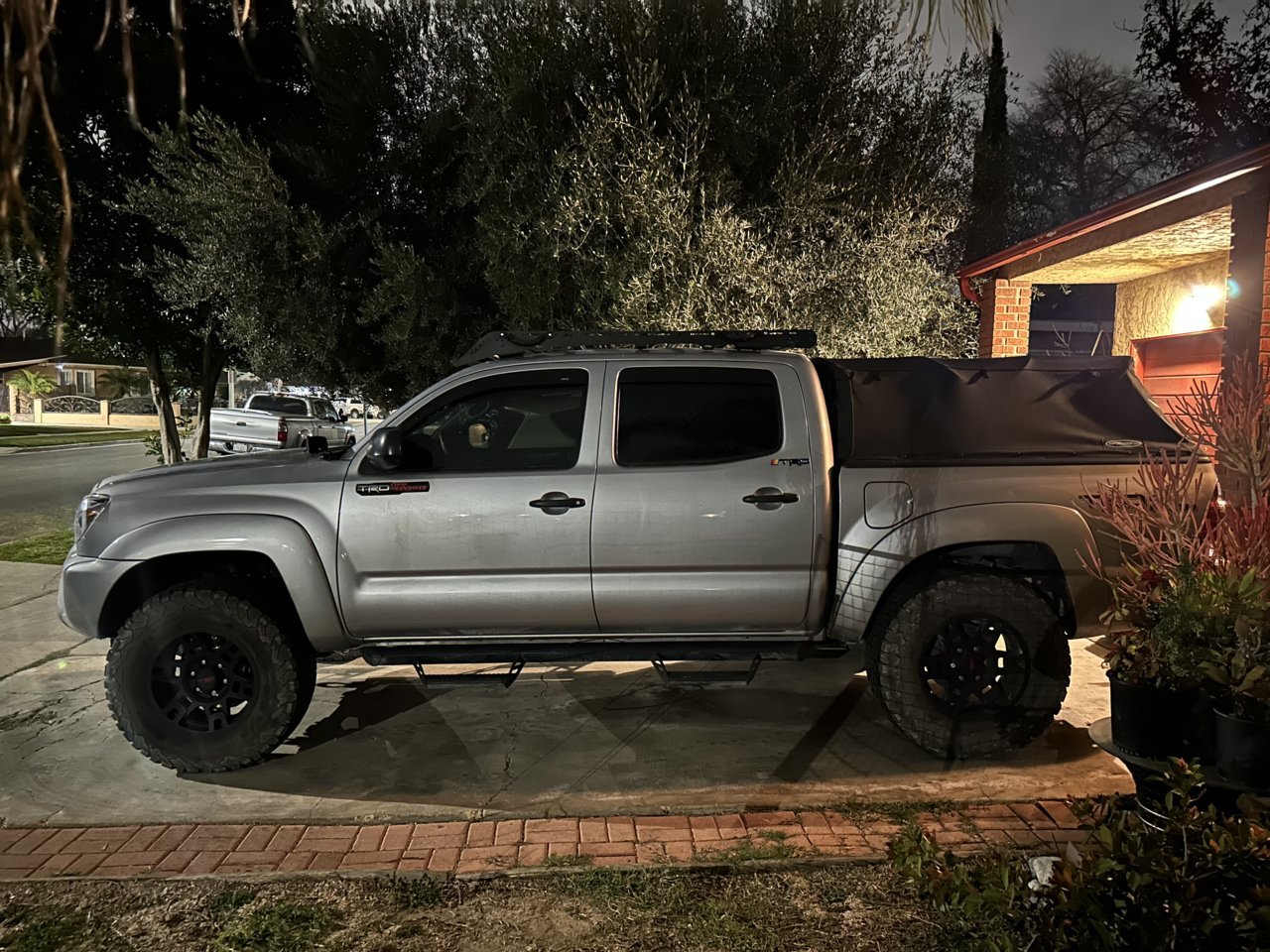

    Just got my new 2nd gen soft topper installed on my truck

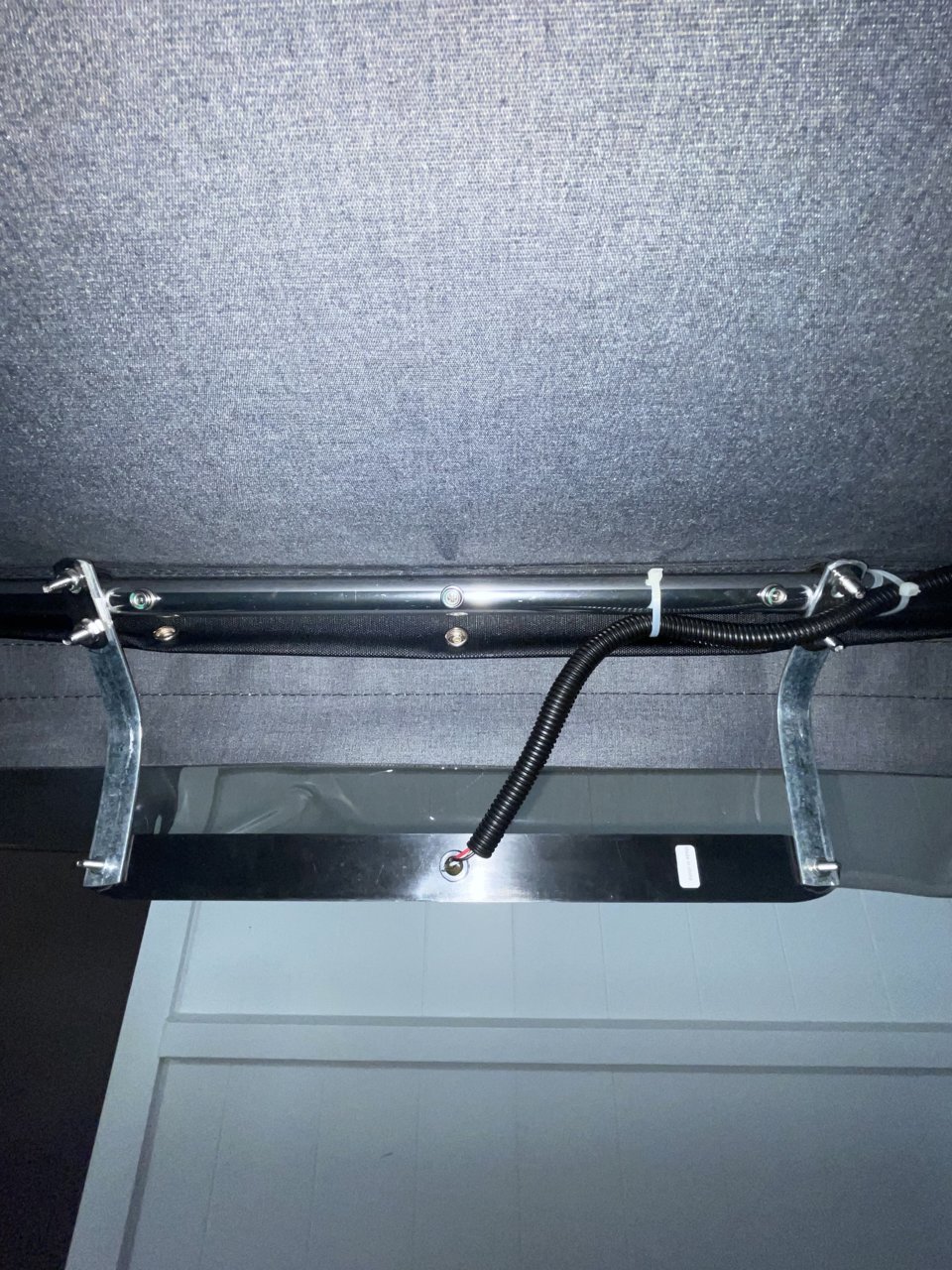

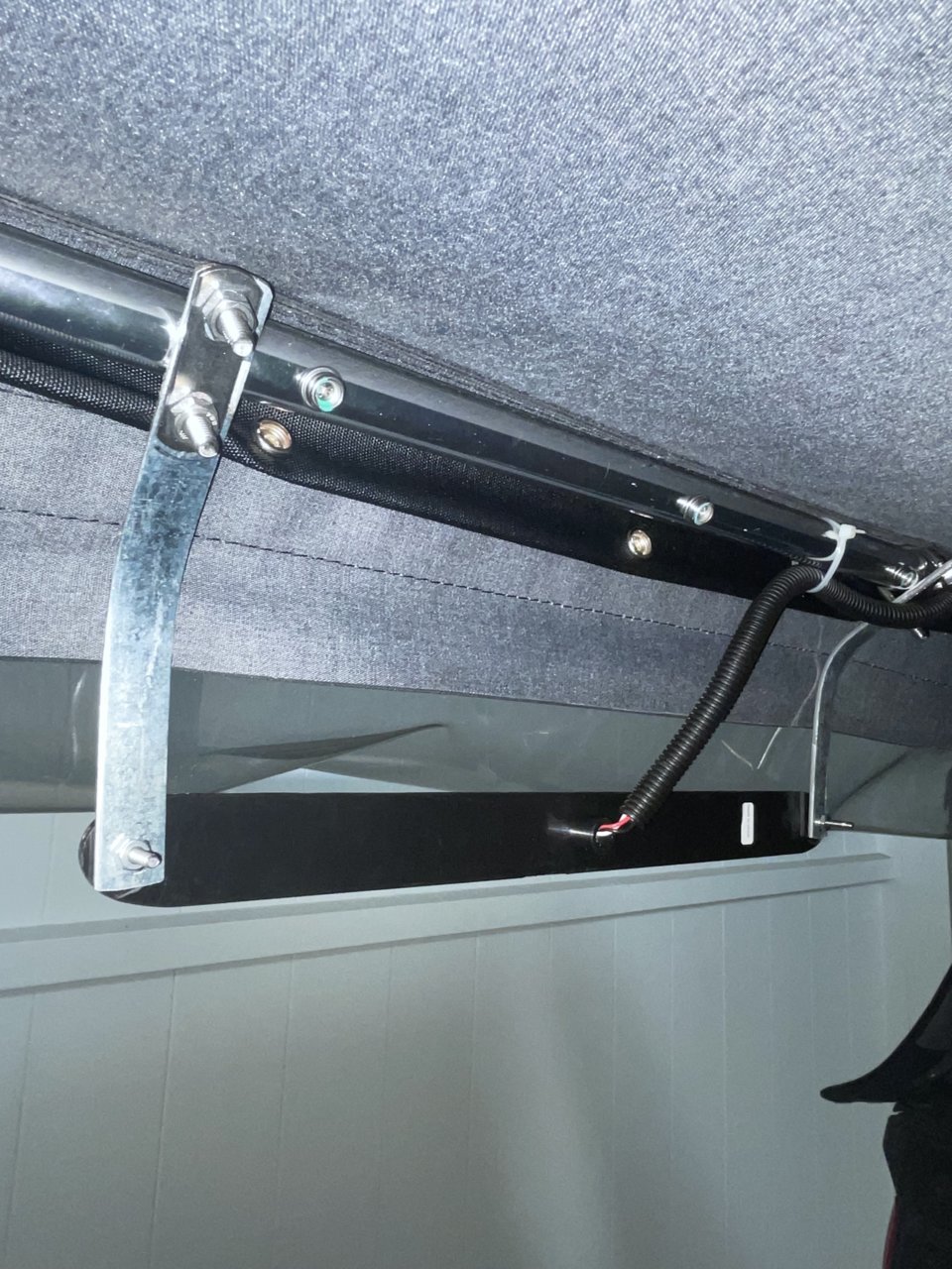

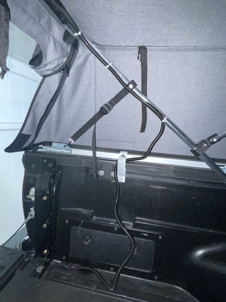

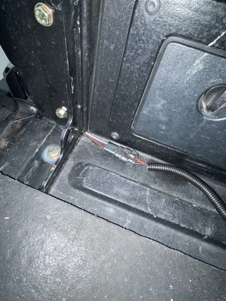

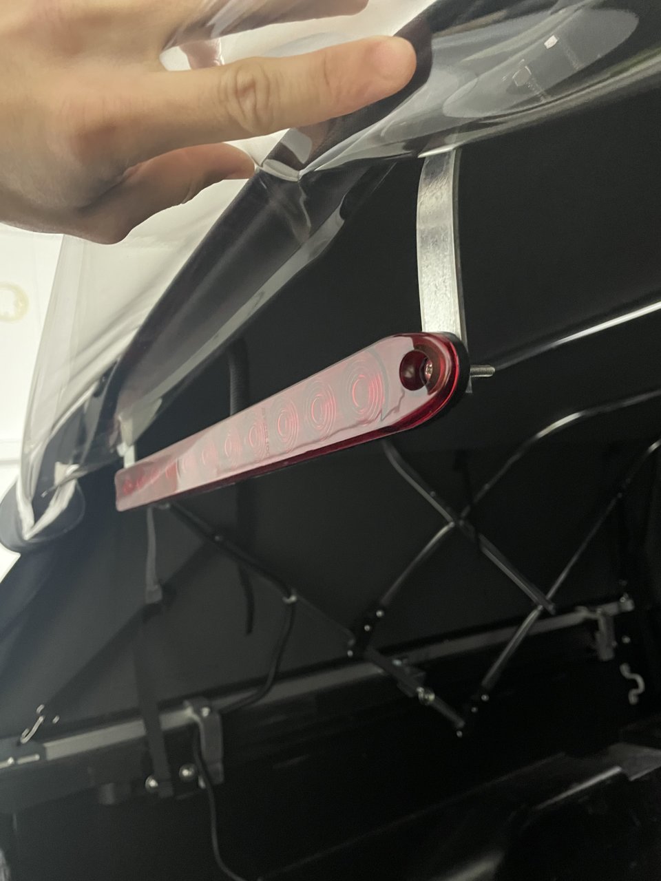

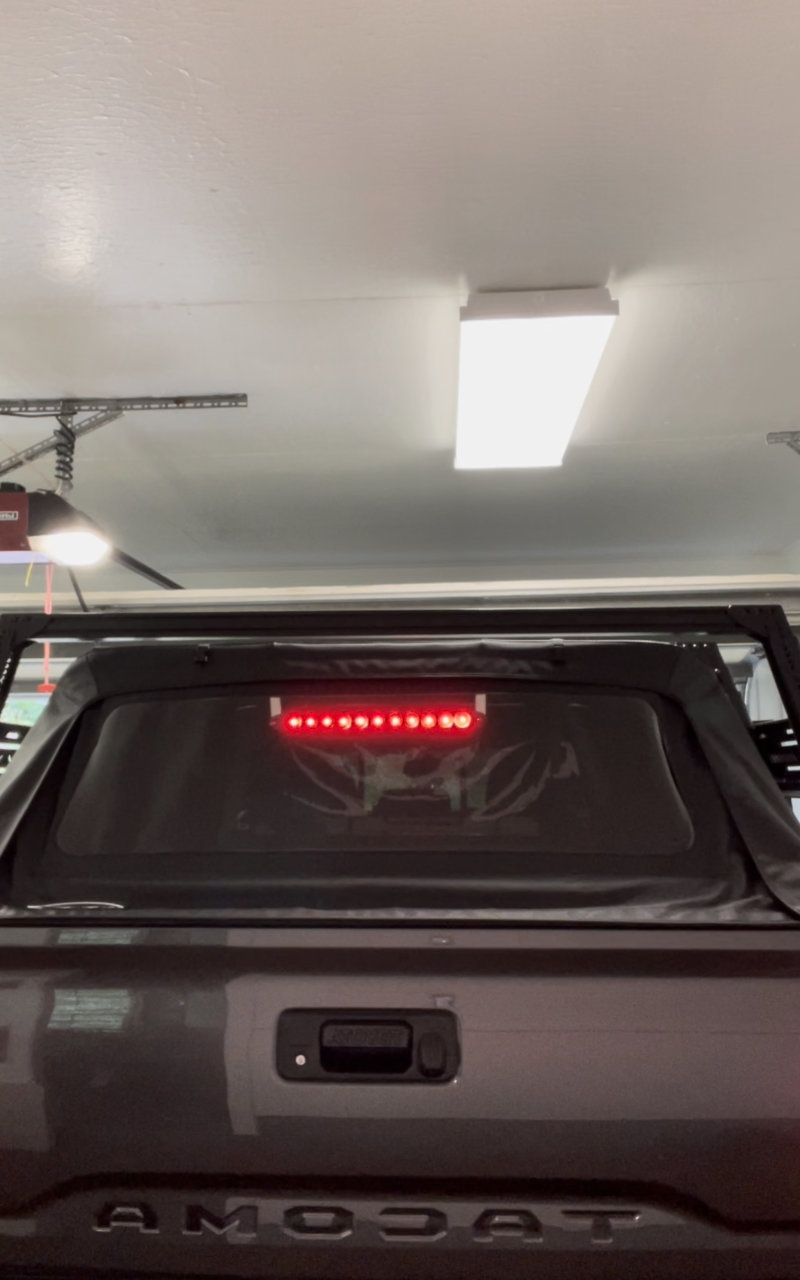

    Added a 3rd brake light - mounted to the last bar of the topper. Wire loomed it and used some extra waterproof plugs from all my projector retrofits in the past

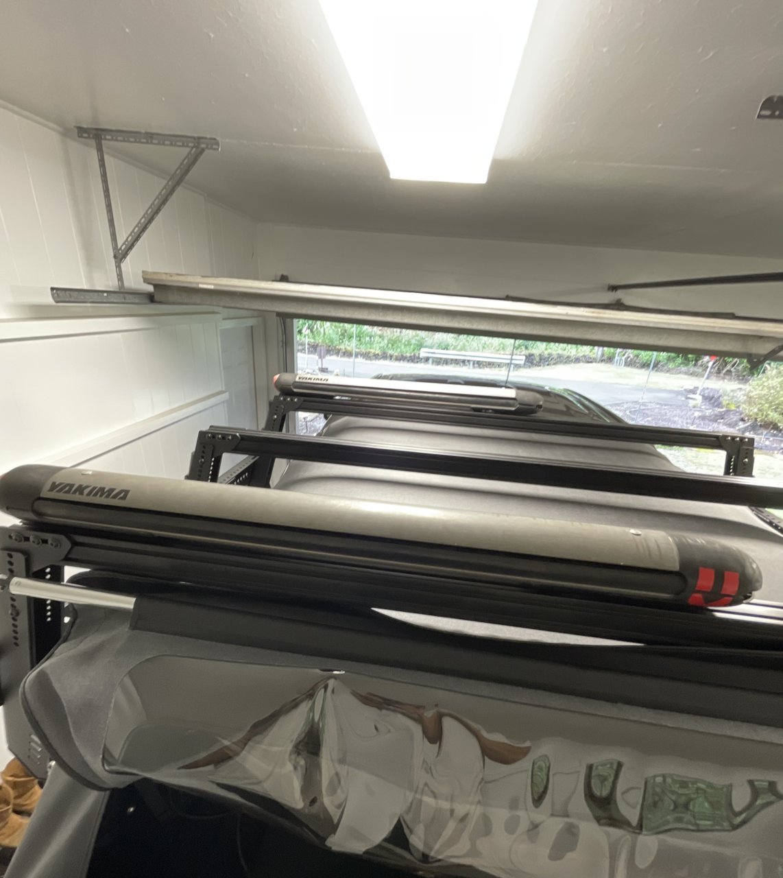

    Also mounted my Yakima’s.

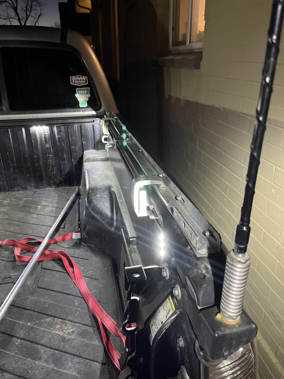

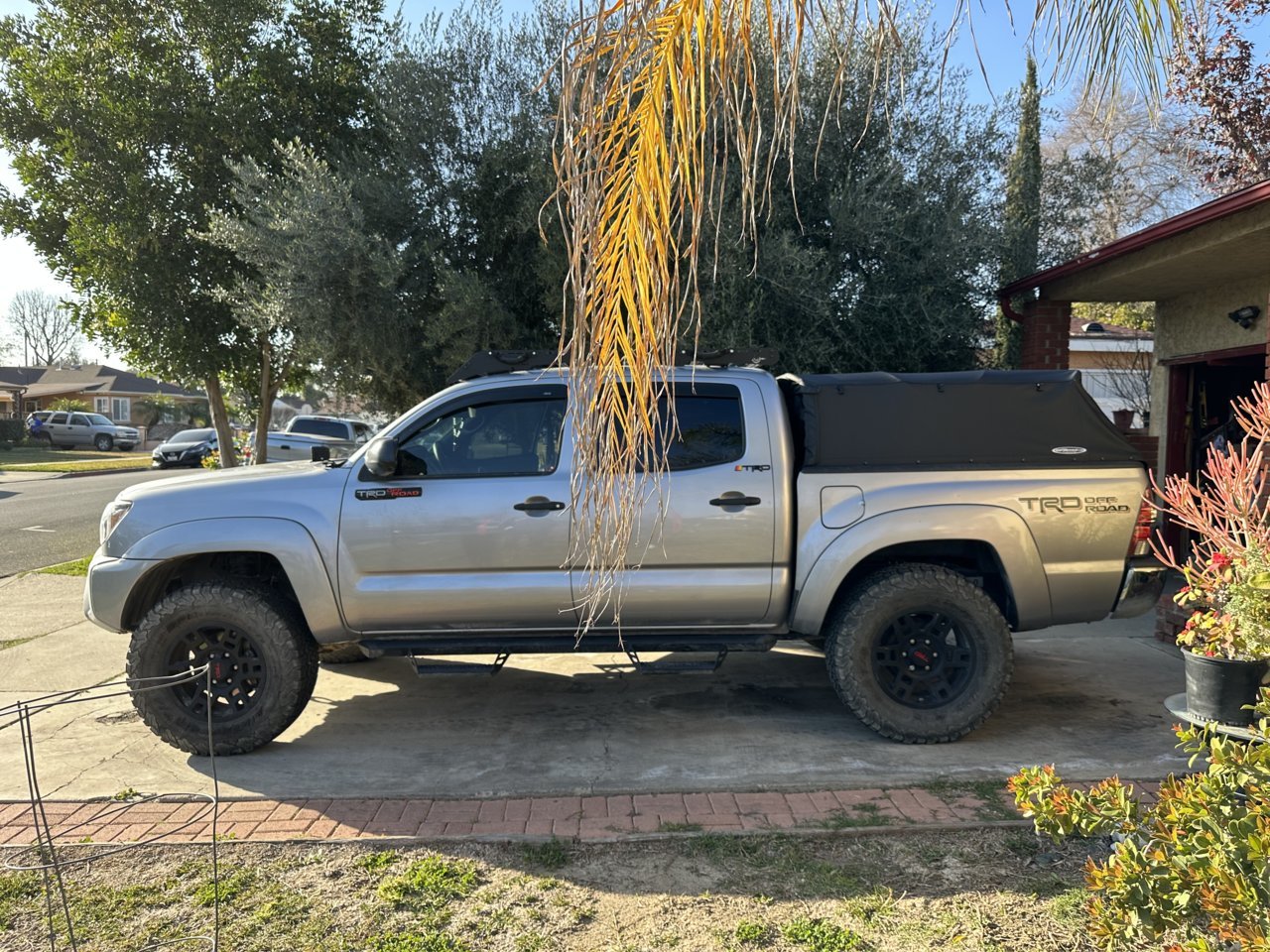

    I've been hunting for a used topper for a while and finally pulled the trigger. Super stoked! I'm not sure when mine was manufactured, but it's got the more recent logo stitched on to it. I did notice that the bed rails seem to be different?
    I haven't seen any on here that are angle aluminum instead of the full square tube. Even going back to the first posts in this thread. Can anyone shine some light on this? I'm thinking I'll just re-engineer them out of steel square tube once the weather warms up, I've got some pretty serious bending going on with the topper on.

    Any chance you could post a few more pics or a few more details? Need to do something like this for mine but have been putting it off. Thanks in advance if you can!

    I haven’t seen that either, and my guess is that a previous owner must have retrofitted the topper with that. You also look like you’re missing the rear bar brackets. Do you have them but just haven’t added them to the rails? You may be able to reach out to Softopper and see if they would sell you the parts.

    I have the plastic brackets, they just weren’t attached yet. I don’t know if it’s retrofitted.. it’s got all the right cutouts and various mounts for the softtopper parts and was clearly professionally machined. Even the bracket with the pins is clearly produced for this shape. Strange.

    What light and brackets did you use for this?

    The light I ordered:
    Partsam 1PC Red 15" 11 LED Light Bar Stop Turn Tail 3rd Brake Light Truck Trailer Identification ID Bar Waterproof https://www.amazon.com/dp/B013SLZDDQ
    Brackets were made with 1” u bolts, and an aluminum bar that I bent, and drilled to fit. I decided to do it this way so the LED light lasts longer (says waterproof but come on…it’s cheap lol), and so when I swap from vinyl backing to the mesh screen it’s still an easy swap. I’ve seen guys mount the light to the back window and didn’t want to deal with
    a) adhesive backing and hoping it holds
    b) siliconing/screw the cheap light that god knows how long will last and
    c) adding holes into the back window
    The pics are pretty self explanatory. I pulled the waterproofing plug out from the taillight cavity for the pic - but it usually resides in there. I can always disconnect it whenever I need to remove the topper.
    Hope this helps and was worthy enough
    Edit: I tapped into the taillight harness - didn’t use those cheap T-taps either

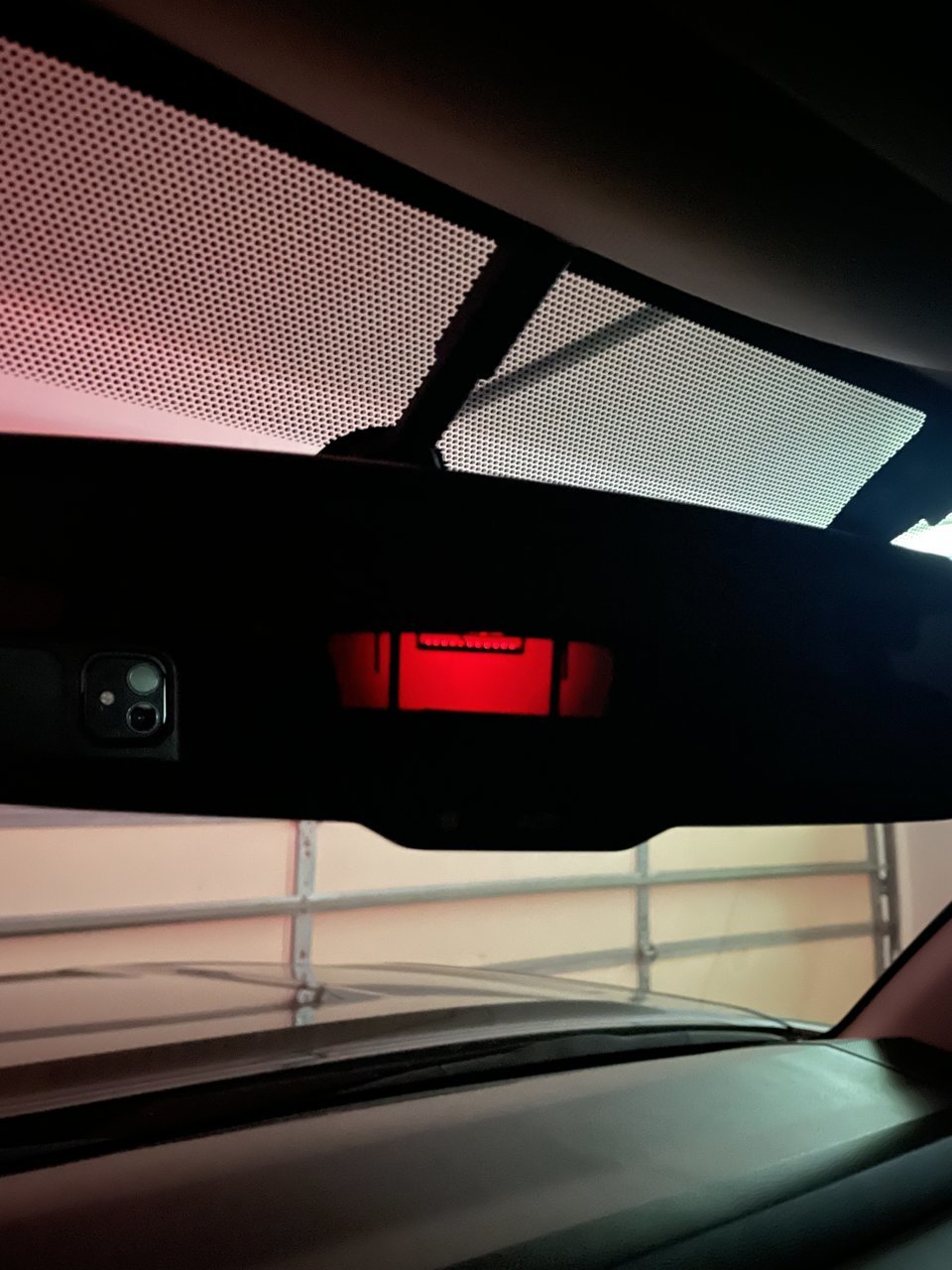

    Does this still allow for the topper to fold up?

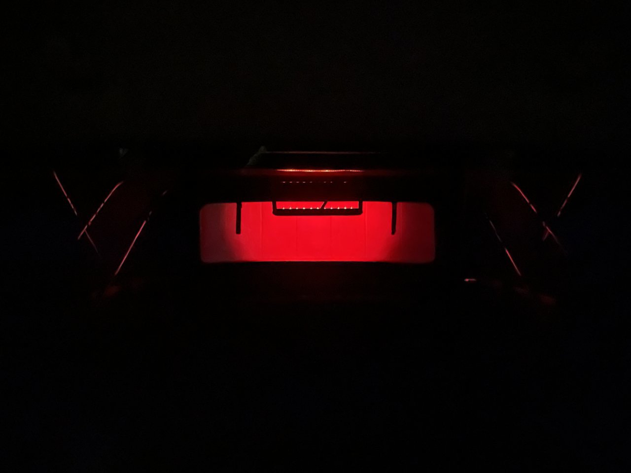

    Does the brake light, when lit up, limit the view through the back? Such as reflect off the plastic or light up the bed area in a way that you can’t see through the back window pane in your rear view mirror?

    Not sure. Haven’t drove my truck at night since the install

    My rear window is 5% over the factory stuff. But it’s still clear for me
    As for the folding - you’ll prolly have to remove the ubolts and unplug the harness (which is fast).
    For my application, I either have the softtopper in, or out. Never folded. So this application just suits what I needed.
    If you need it to fold I’m sure you can come up with a different clamping method so it’s easy to unplug and remove - then just fold the topper…maybe something with a wingnut? That’s super fast

    Shoot I forgot to mention, I’m reversed right up, like seriously right up to my garage wall. So it’s also reflecting back quite a bit lol
