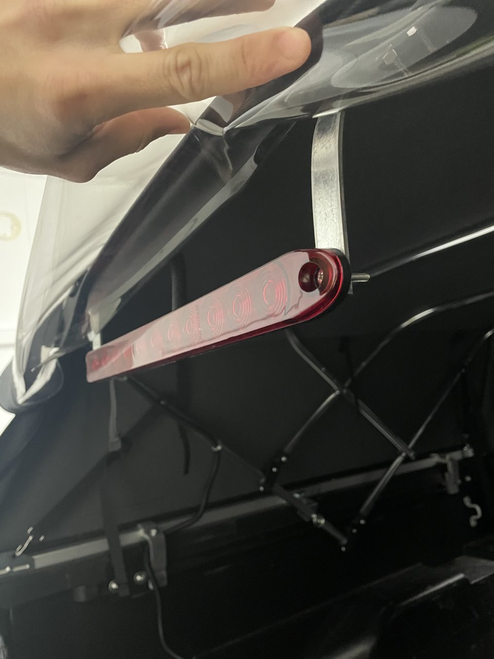

    With the softtopper, I have my upTOP rack pretty much cab height. I drop the topper off the pins and into the bed (lowering it more than a few inches) and then collapse it
    I added pics of my brake light - but if you look at the first pic you can see where the pivot mount is and how much the topper can drop into the bed so I can gain clearance to collapse it. Hope this helps. Im at work for a while more

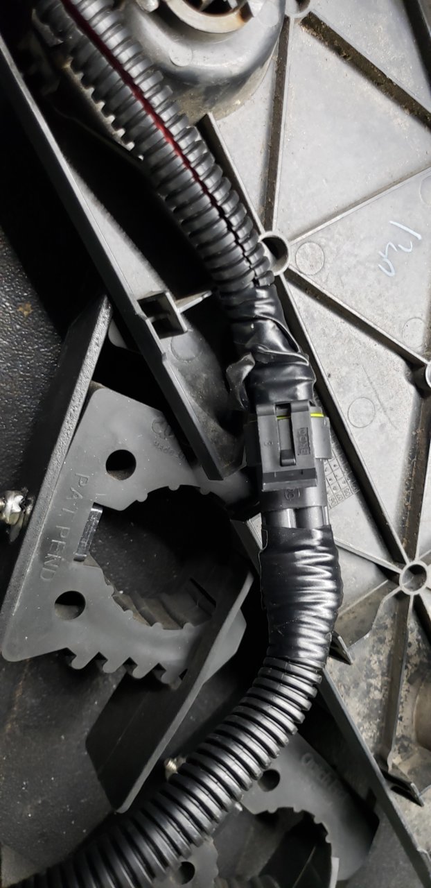

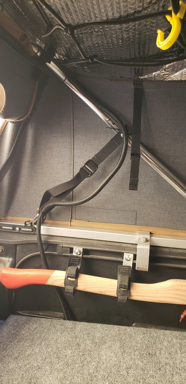

    Did you run the wires from the light through the Velcro up top? I think I am going to go this route. I want to avoid making any holes on my topper.

    Exactly. The wire is tapped off my driver's side tail light, exiting the bed cubby. It follows the most rearward bar of the topper exiting the velcro for the rear flap. I attached the light to a strip of stainless steel bar, and use neodymium magnets on the inside of the topper to hold it in place. No holes or damage of any kind. It has never moved and I do a fair amount of wheeling.

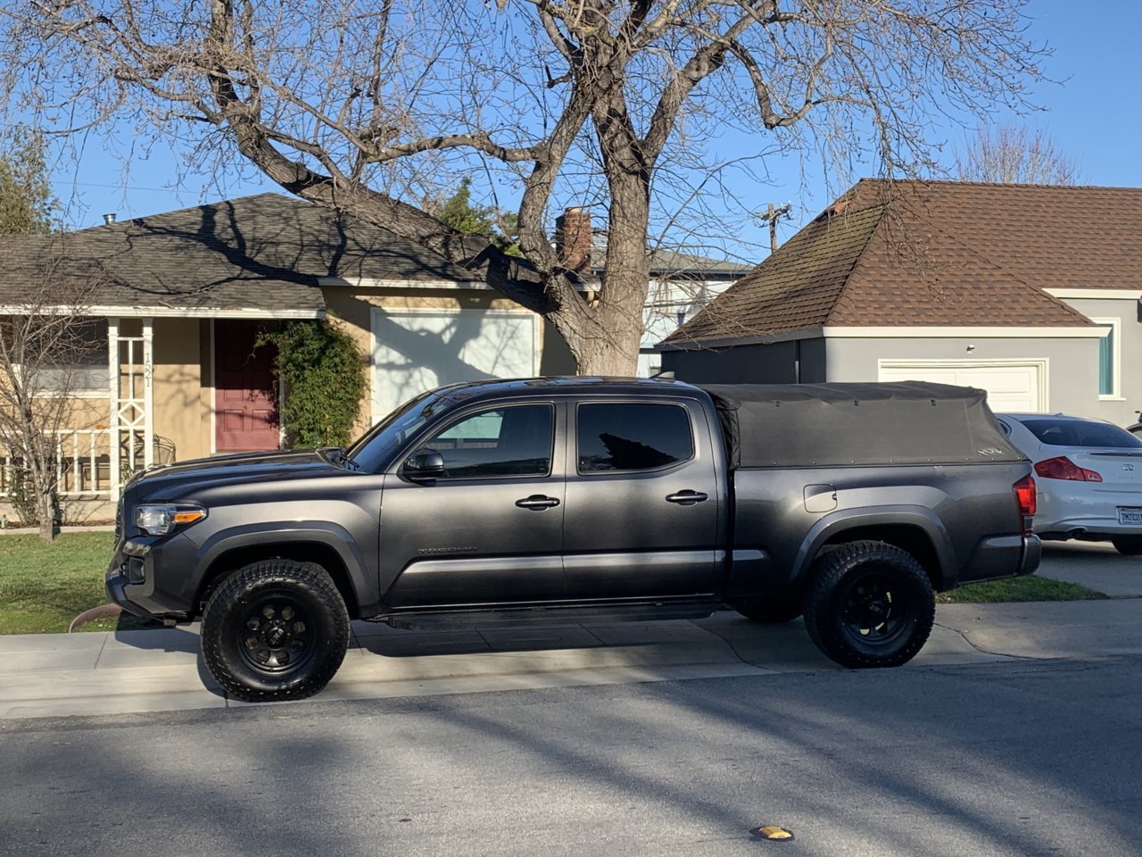

    Installed mine this weekend!

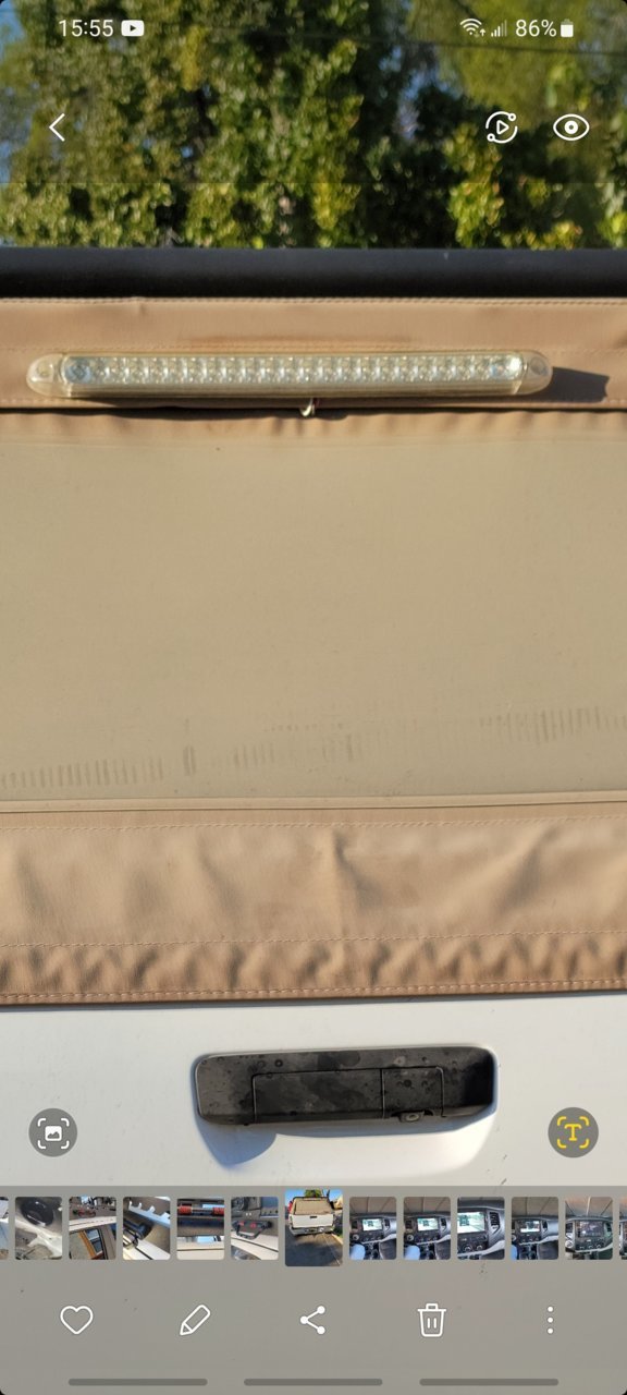

    Previously ran velcro on the tailgate but decided to try magnets instead after my tailgate got stolen. Placed some 3M clear vinyl on the edge of the tailgate to protect the paint and used 1.5” velcro to hold 3 3” x 1/2” x 1/4” magnets. Does the job well and is a lot cleaner compared to having the velcro on the tailgate!

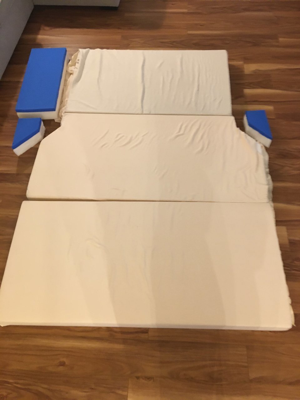

    Just finished making a foam bed for my truck. One of the big reasons I picked up my Softopper was to be able to camp out of my truck. However I didn’t want to build a fixed sleeping position in the back of the truck like a lot of the hard shell campers do. I really enjoy being able to use my truck bed at anytime, maintaining the versatility of the truck. Because of this I settled on modifying a tri-fold foam mattress that would be easy and quick to set up and tear down. More specifically I bought the 4” thick waterproof Milliard full sized mattress off of Amazon:
    https://www.amazon.com/Milliard-Premium-Mattress-Waterproof-Washable/dp/B09SGPPCL9?th=1
    A little side note, the site says “memory foam” but it is 1” memory foam laid over 3” of foam.
    After it arrived, I removed 2 of the foam pads from the water proof cover. For both of these pads I removed the end seam so I could pull the foam out of their protective covers. From there I measured out my wheel wells and marked these measurements out on the foam pads. I was able to use a utility knife to cut the foam pads down to the correct size.
    To test the fitment after my alteration, I slid the foam pads back into their protective covers, and then into their respective pockets within the waterproof cover.
    I was initially concerned with the excess waterproof cover around the altered pads. After I set the mattress in the bed, I was able to tuck the excess cover between the mattress and the truck bed without any major bunching.
    913A29FF-5398-4B38-8EBC-BC554D8BB1CE.jpg 97CFFCB2-7379-415A-BD05-B8790375CD05.jpg 99C845F8-18FB-4755-8F65-684A98D5F62E.jpg
    I’m pretty excited with how this turned out, and can’t wait to try it out. In addition to having a bed to sleep on in the truck, I also saved the foam I cut off and can still use the full mattress pad in the house for guests or my kid.
