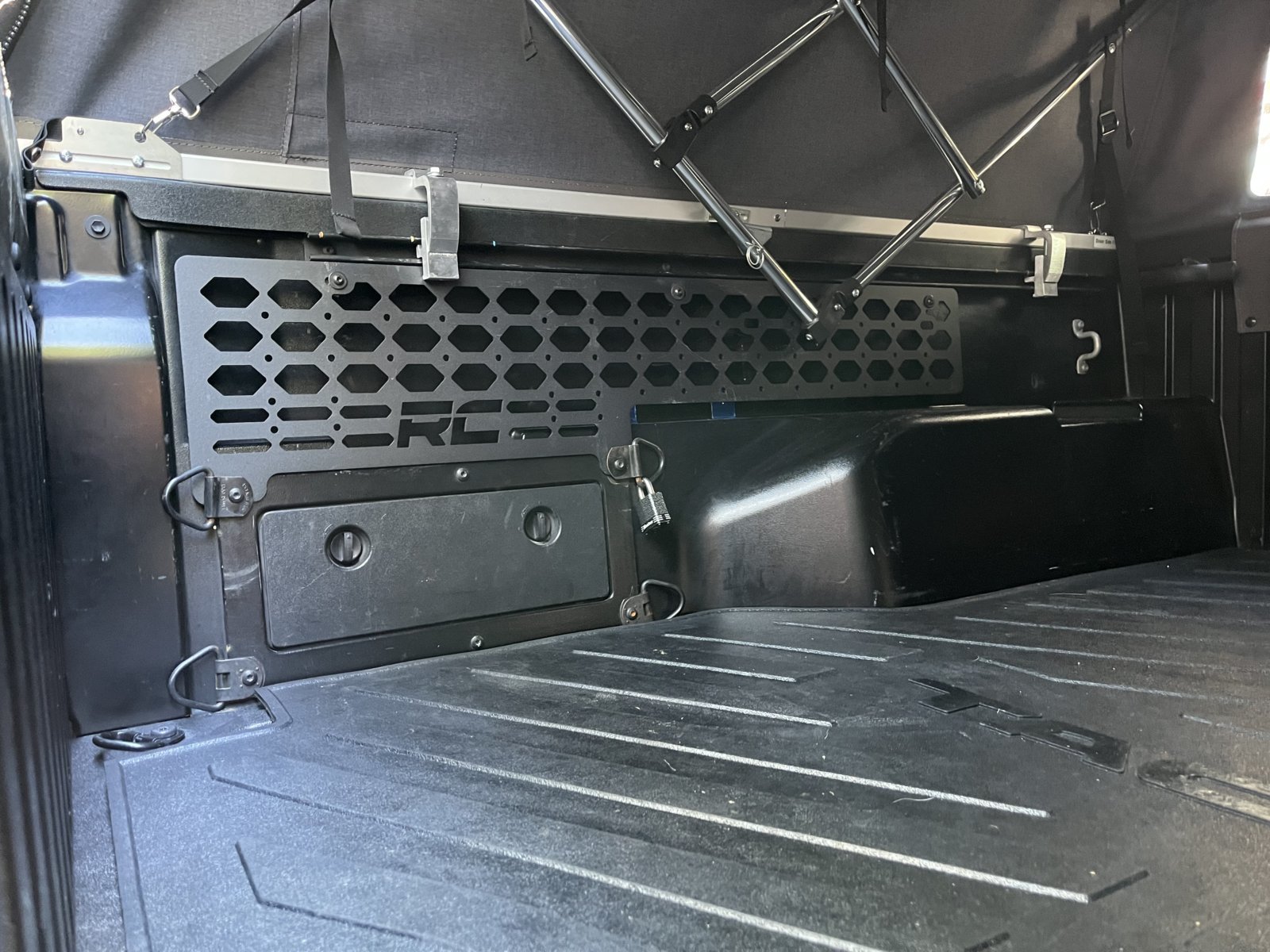

    Answering my own question, for the benefit of anyone else looking for info that the Rough Country bedside molle panels work with the Softtopper supports:

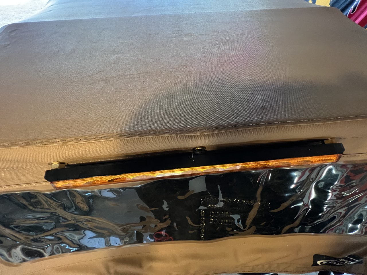

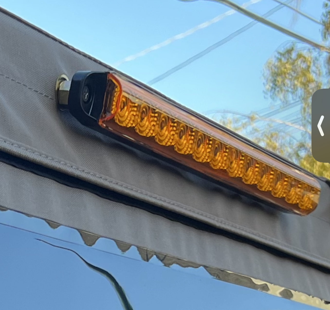

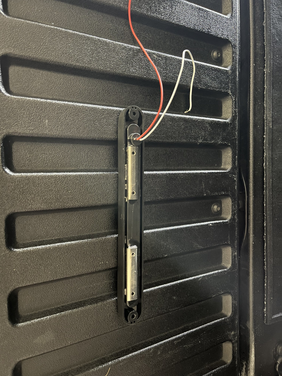

    @loyaltothetaco I am attempting this same thing. Is the brake light attached to the canvas on the topper with bolts and nuts or did you attach it to the support bar? Thanks.

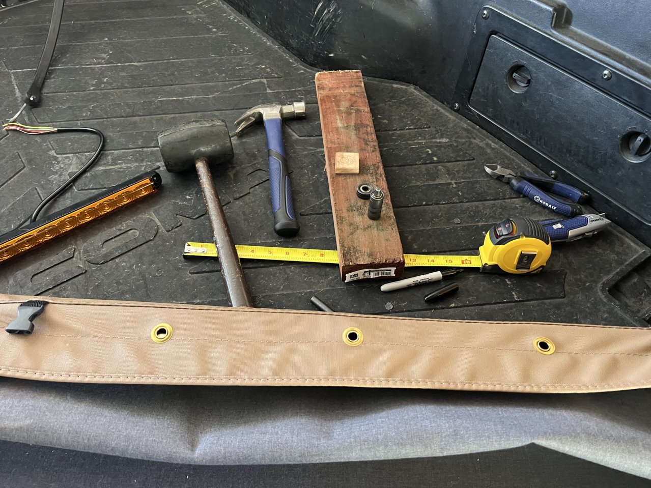

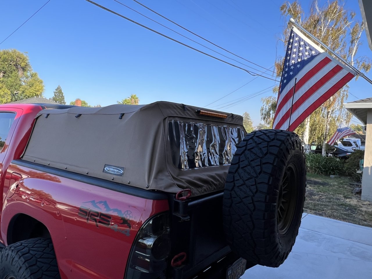

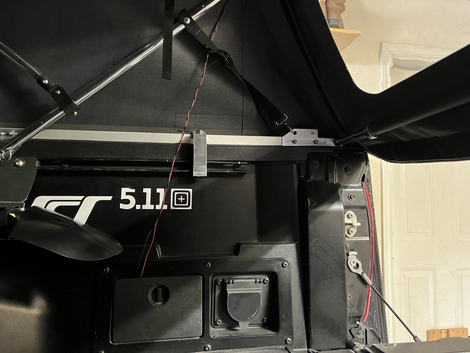

    It’s attached to the canvas, bolts going through the openings on the light bar and through the grommets I installed on the canvas, washer and nut on the backside. Since the wiring going into the back of the light bar made it stick out from the canvas a little bit I used some bigger nuts as spacers between the bar and the grommet.
    Here’s a closeup from the side, I can take a few more pics if you want.

    Perfect. Exactly what I needed. Thanks.

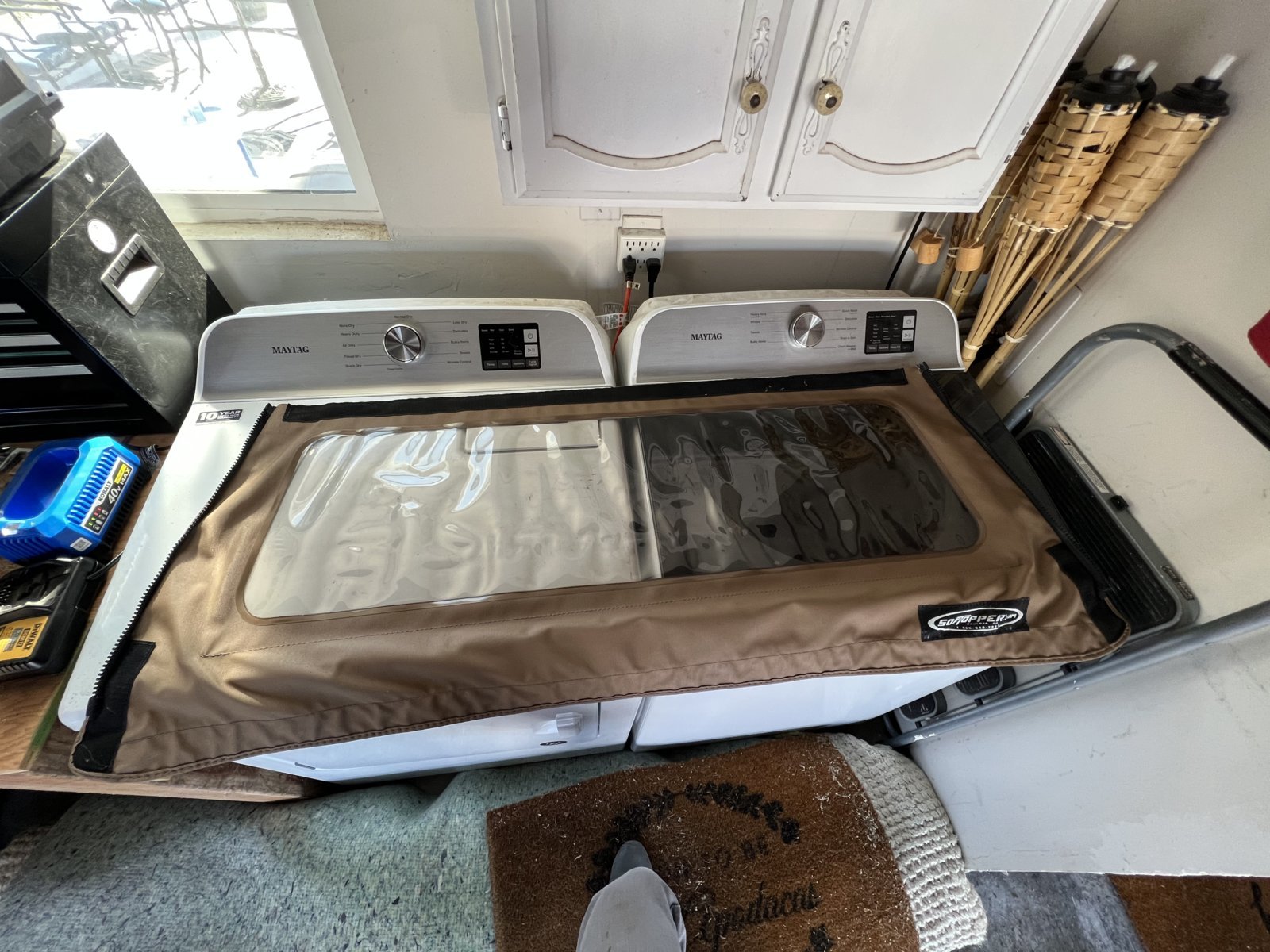

    Forgot to post this after I got my new tinted window. This is a standard clear rear panel off a third gen Softopper that I’m gonna post for sale, just need to find the Softopper sale thread and I’ll post it there too. Thinking $50 plus shipping. Not sure if that’s a fair price.

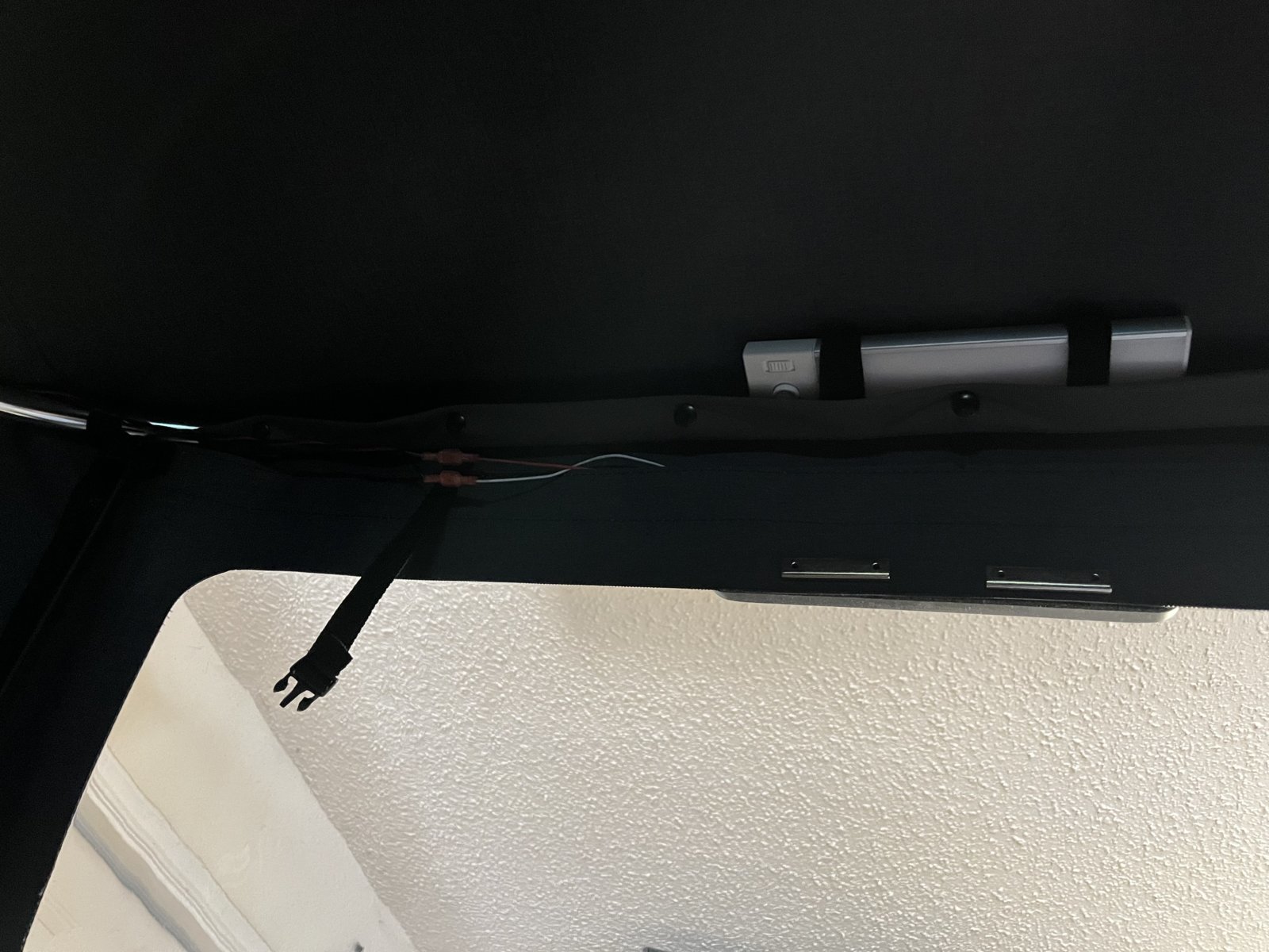

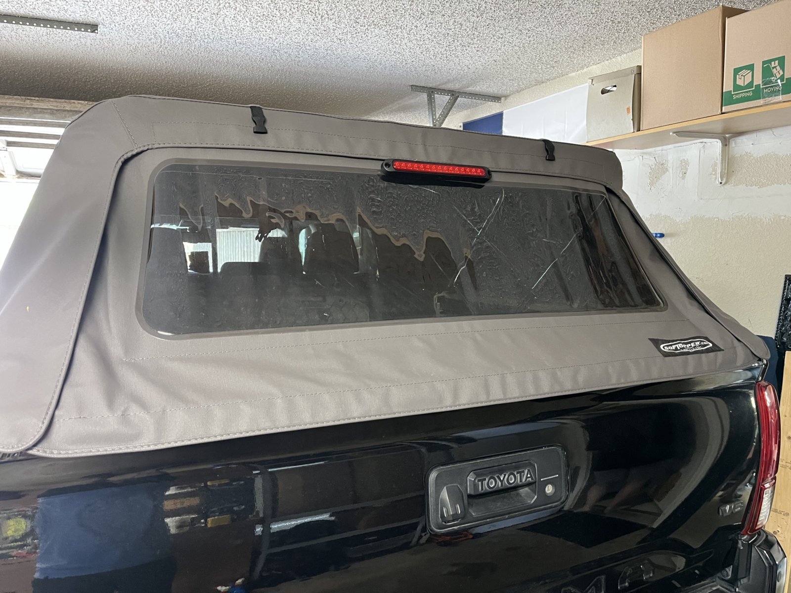

    I did my 3rd brake light addition with magnets glued to the back of the light, and quick disconnect terminals so that I can remove and disconnect the light easily. Some pics if anyone's interested:
    Tap from passenger brake into bed cubbie:
    Magnets super glued to light:
    Inside view of magnets and quick disconnects:
    Wire run to cubby (I've since covered the lower part with a molle panel):
    Outside view:

    Like you I had my light on the window but I would take the rear panel off so often for various reasons I moved it to the actual topper lip. So much easier than constantly unplugging it to remove the back panel

    I mainly stuck it there so that the wire is cleanly hidden, but I do roll it up sometimes, which hides the light.

    Are those connectors up top removable or just plain old crimps? I'm curious how you'd remove the rear panel without messing with wiring. Or do you never remove the window?
  20. Oct 25, 2023 at 11:47 AM
    #7900
    dangeroso
    dangeroso Just float along and fill your lungs
    Apr 4, 2018
    #249394
    1,853
    Jon
    Dallas, TX
    2018 Tacoma TRD Sport 4x4
    They are quick disconnects like these:
    https://www.amazon.com/Spade-Disconnect-Connectors-Female-Terminal/dp/B09HB3YTKG?th=1
    I just disconnect, pull off the back 2 magnets and stow the light somewhere. Then I coil up the remaining wire and stow it in the cubby.
