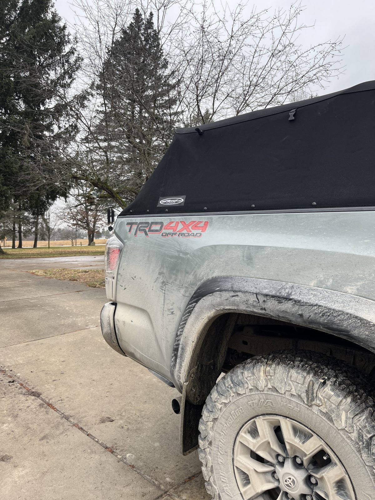

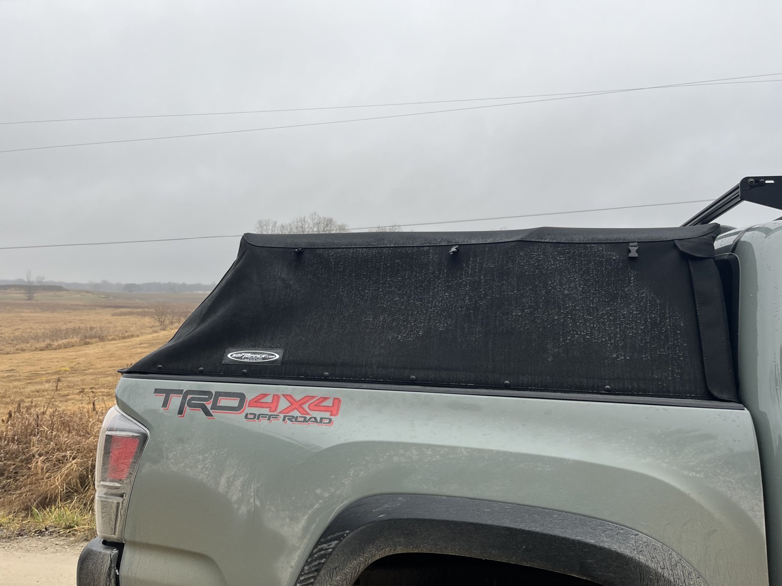

    I don’t know why I can’t edit this photo into the last post. Any advice would be appreciated. Do I have the rear straps pulled too snug? I only pulled them taut

    Compared to mine that does look a bit loose on the sides. Mine's older and not twill obviously so there may be comparison differences between materials. But I think it's probably worth some adjustments to snug it up a bit.

    The frame pivot (on mine) has a pin with a high and low mount. Mine's in the high position. Brings the entire frame up just a bit and snugs everything up if that helps.

    I will try that. I’m on the middle pin. It is as difficult to snap on but the twill has definitely stretched since. Will report back thanks

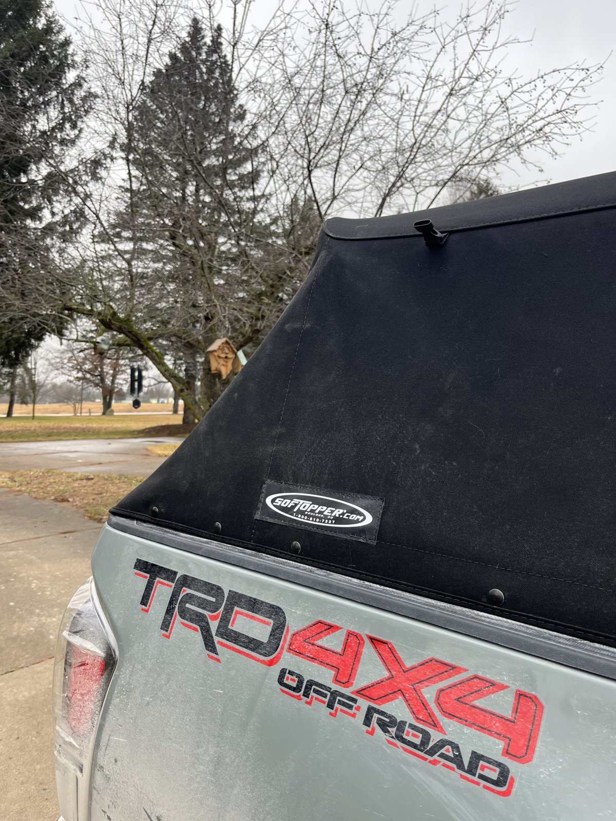

    Realigned the rails, adjusted clamps and got them tightened down the same all around, and went up to the top pin. Seems to have fixed the issue for now. Fingers crossed the twill doesn’t stretch out too much on the top pin. It looked great the first few days I put it on then started getting saggy at the rear end on middle pin. Not a huge difference in height, but I actually can notice it being a little taller using the top pin too, looks great. Thanks for the help fellas. Any pic requests of the twill material topper I’m more than happy to accommodate

    Glad it tightened up for you. From the pics, that twill looks like a solid material.

    I like the flat black look, did you clean it at all between any of your photos? Close up you can tell it has some dirt on it but the photos from further away look pretty clean. How’s the back window? The Softopper website says they “upgraded” it, and am curious as to what the upgrade actually is. Either way it looks great on your truck!

    Thanks! I did not clean it in between photos, however I took a couple trips down my road. It’s dirt and been raining the past few days so every trip adds a decent layer right now. The topper has some dirt on it in both pics. Not sure of the old window quality as it’s my first topper but no complaints here. Rolled it up a few times and no scratches. There was a dimple or two in the window when I pulled it out of the box but no creasing or anything serious like that. Hardly noticeable once I put it on the truck. Tint is better than I thought, you can see out of the rear view mirror pretty good but can’t see in up close. It’s covered in dirt right now but I can take another pic of the back window when I rinse it off tomorrow or the next day

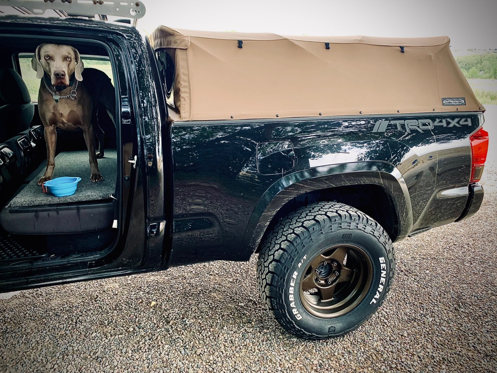

    Interesting, I can't say i feel they are more noisy than my last set of AT's, only one I can hear/feel is the feathered tire. I love the look and how few people have them, so I will continue to purchase this tire.
    Are you sure it's a balance issue?? Thought the same with mine, it's balanced but feathered, giving it an off balance feel and sound.
    Now back on track. Topper, Grabbers and a dog.
    As for the topic of HWY use, I have found getting your side rails, and skeleton rails all in the optimal position really helps with flapping at speed. I Can just barely snap canvas in place for the tight fit and finish.

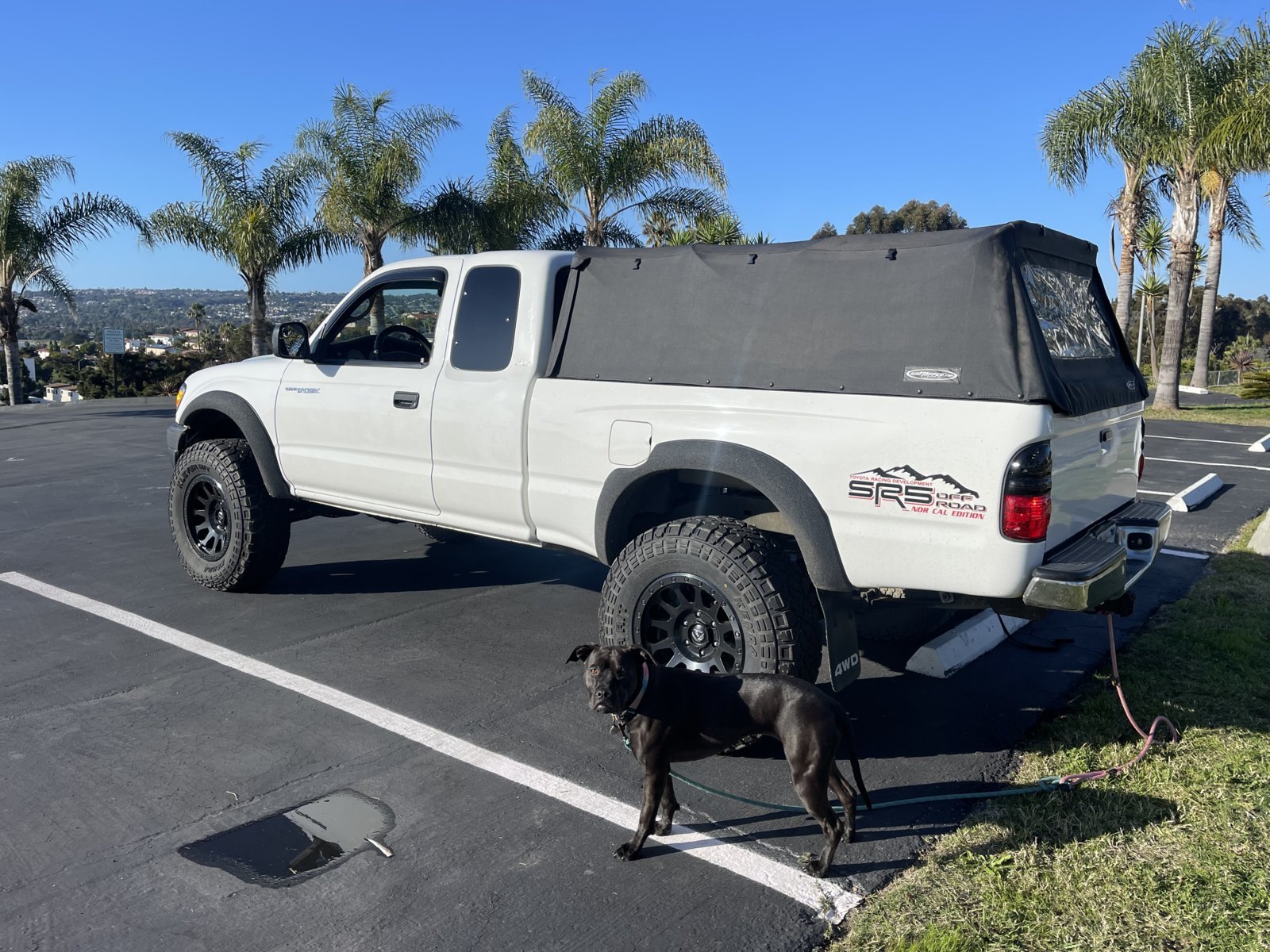

    Picked one up few days ago. Been researching what to clean it with and 303 seems pretty popular.
