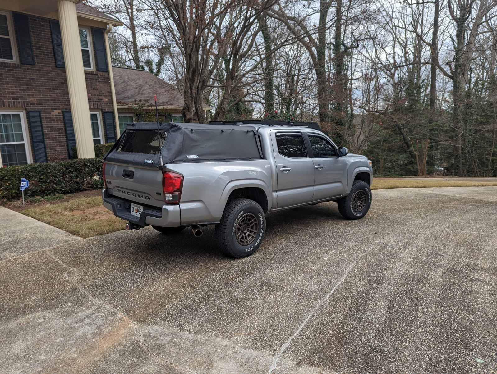

    Finally remembered to get a shot in full light.
    jackn7 and hxp05560 like this.

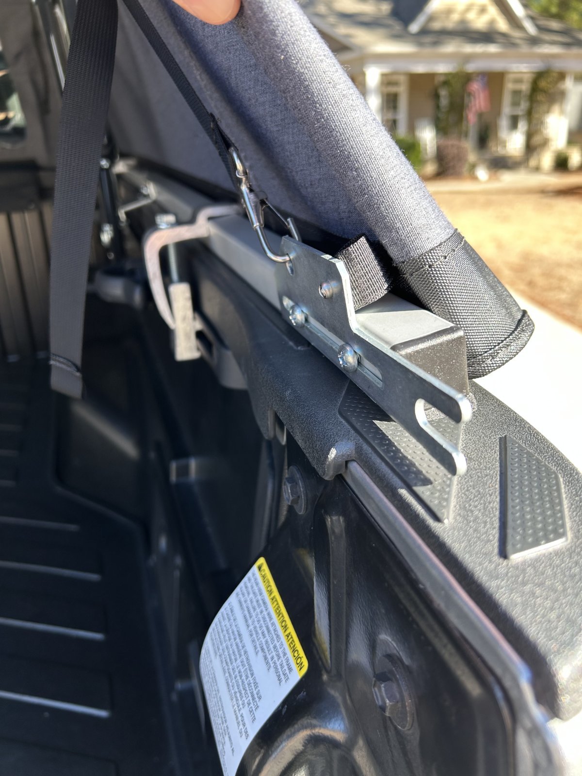

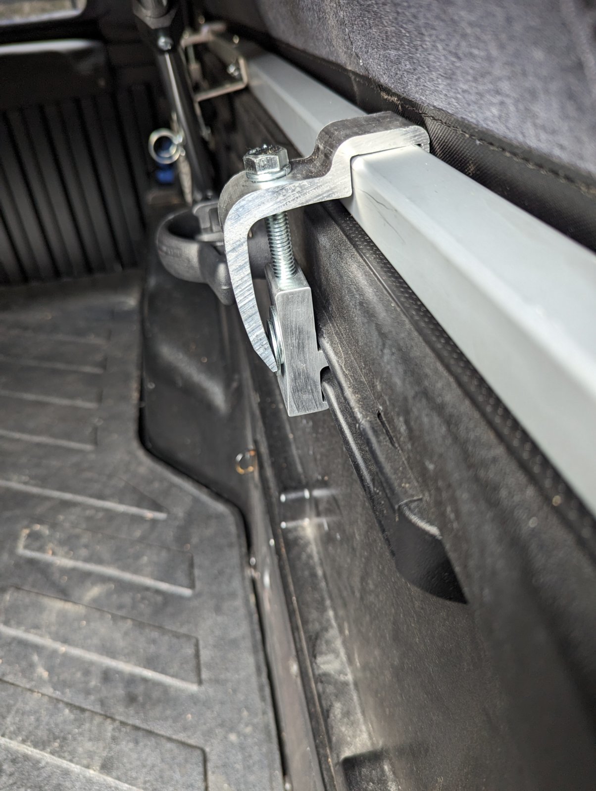

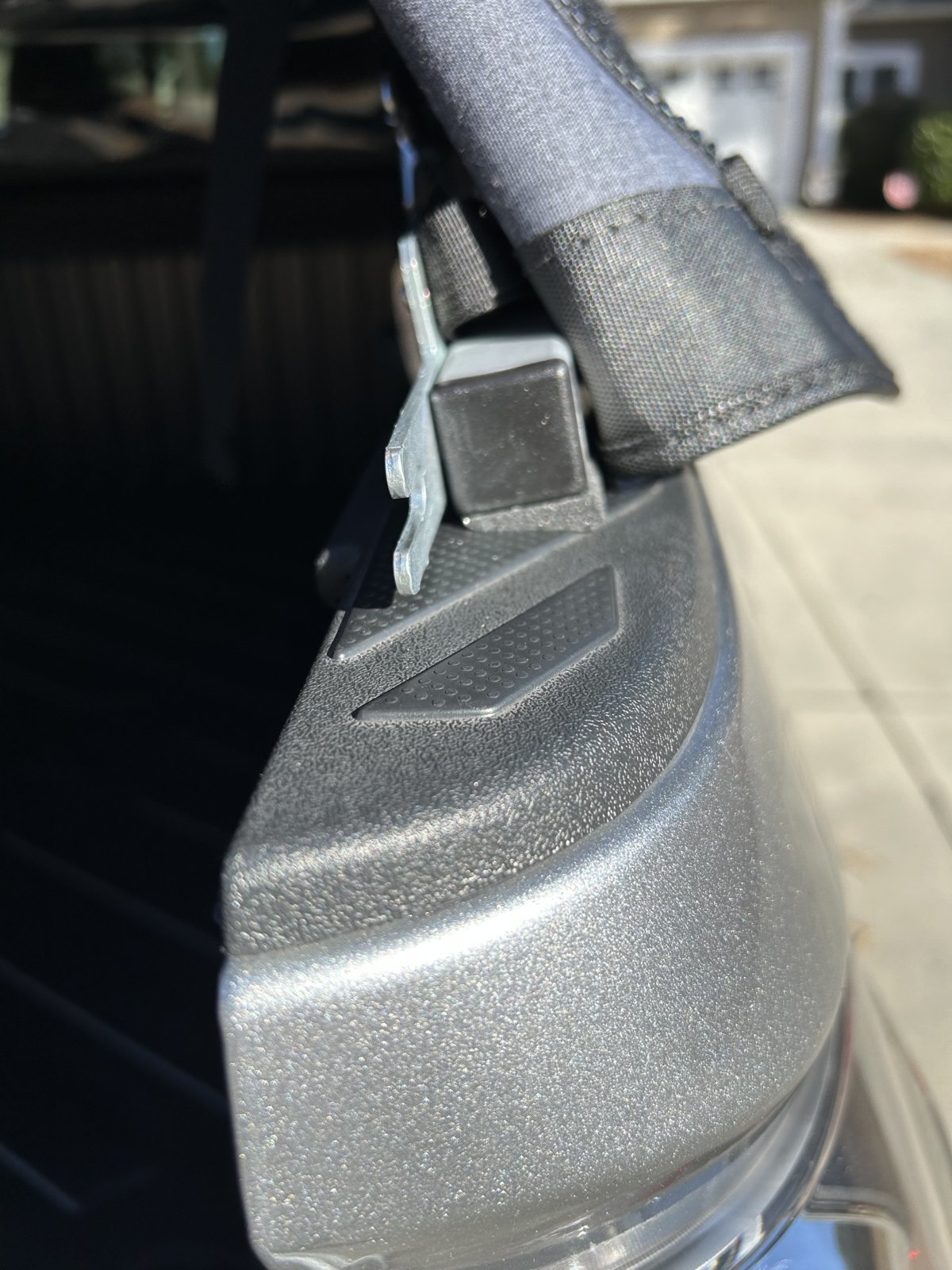

    Hey everyone, long time lurker and I’ve learned a lot from all of you. First post here though and looking for opinions. Installed my Softopper yesterday and the rails are bent in on both sides. This is something that I’ve seen as pretty common after reading through most of the almost 400 pages on here. I have not seen any consensus on if it is ok to leave it like this, or if there is something I can do to fix. Anyone have this problem and just left it as is? Anyone with re-install options that seem to clean this up? Thanks in advance!

    Tighten the clamps and I put 2 washers to tilt the clamps down with more force on the outside vs inside.

    did you just add the two washers to under the bolt? Or use them as shims to get that outward pressure on the rail bars?

    So simple, yet genius. Thank you, im going to do exactly that

    I had this issue too. I loosened everything up and aligned the clamps up on the track where there’s the little cut outs are. If you look in there you’ll see they’re bout where the clamps are shown on the instructions. take turns slowly tightening the clamps up a little bit each until they’re all pretty snug but not over tight at the same amount. I used a tape measure cuz that’s me but eye balling is fine. Everything seemed to be much straighter after I did this. Best of luck

    I did exactly this, as I wanted to try it before running to the store to buy some washers or shims. Finally was able to get the clamps completely seated around the rails and the ‘inward lean’ of the rails is much less pronounced now. Thank you, much appreciated!

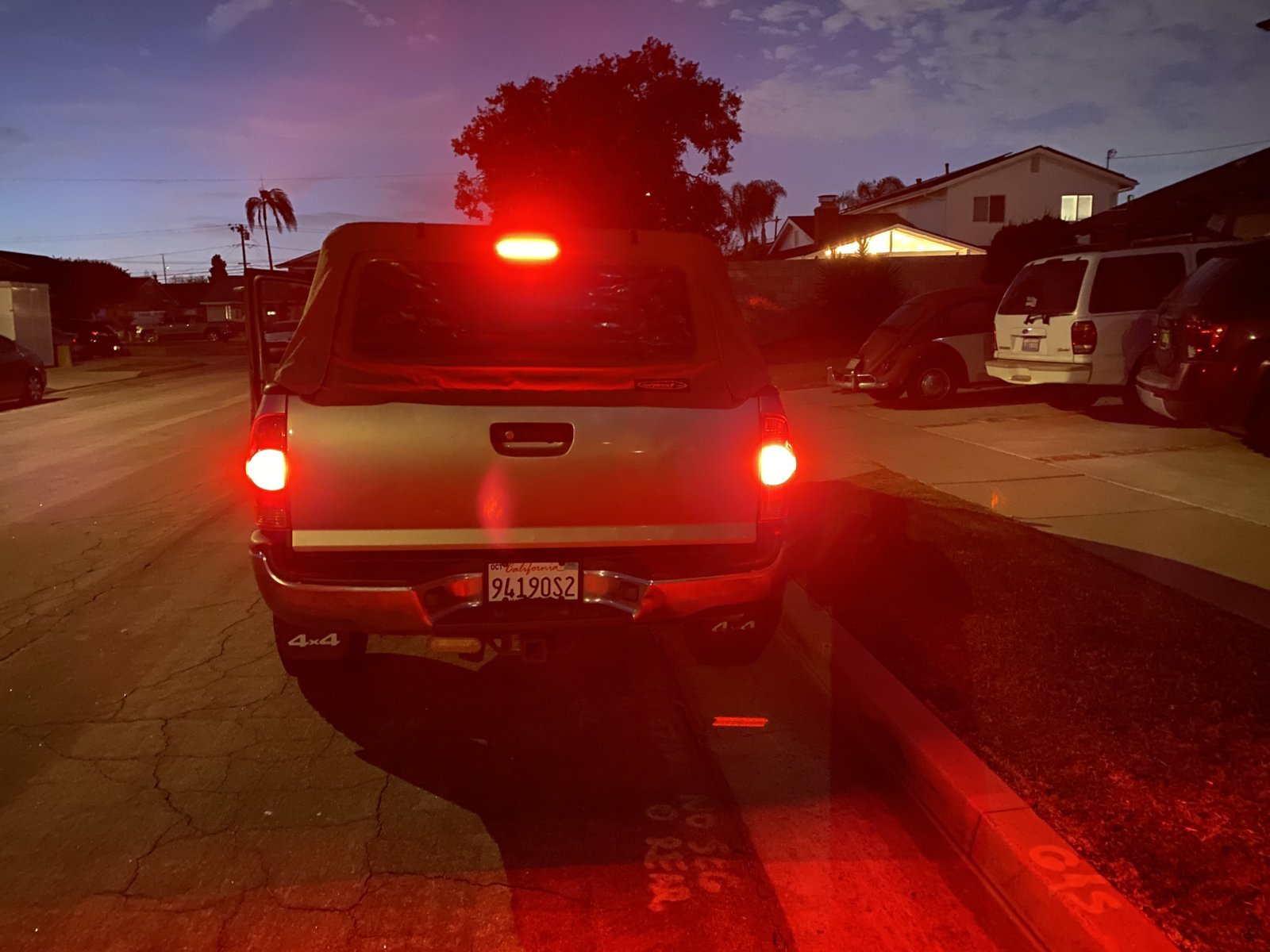

    Just some stuff...
    Quite a few actually. Pretty easy after getting the brake tap. Just make sure to use a male/female plug so you can unplug it before folding back the softopper.

    How did you attach the light to the canvas?

    A little bit of two part epoxy. It’s there forever!

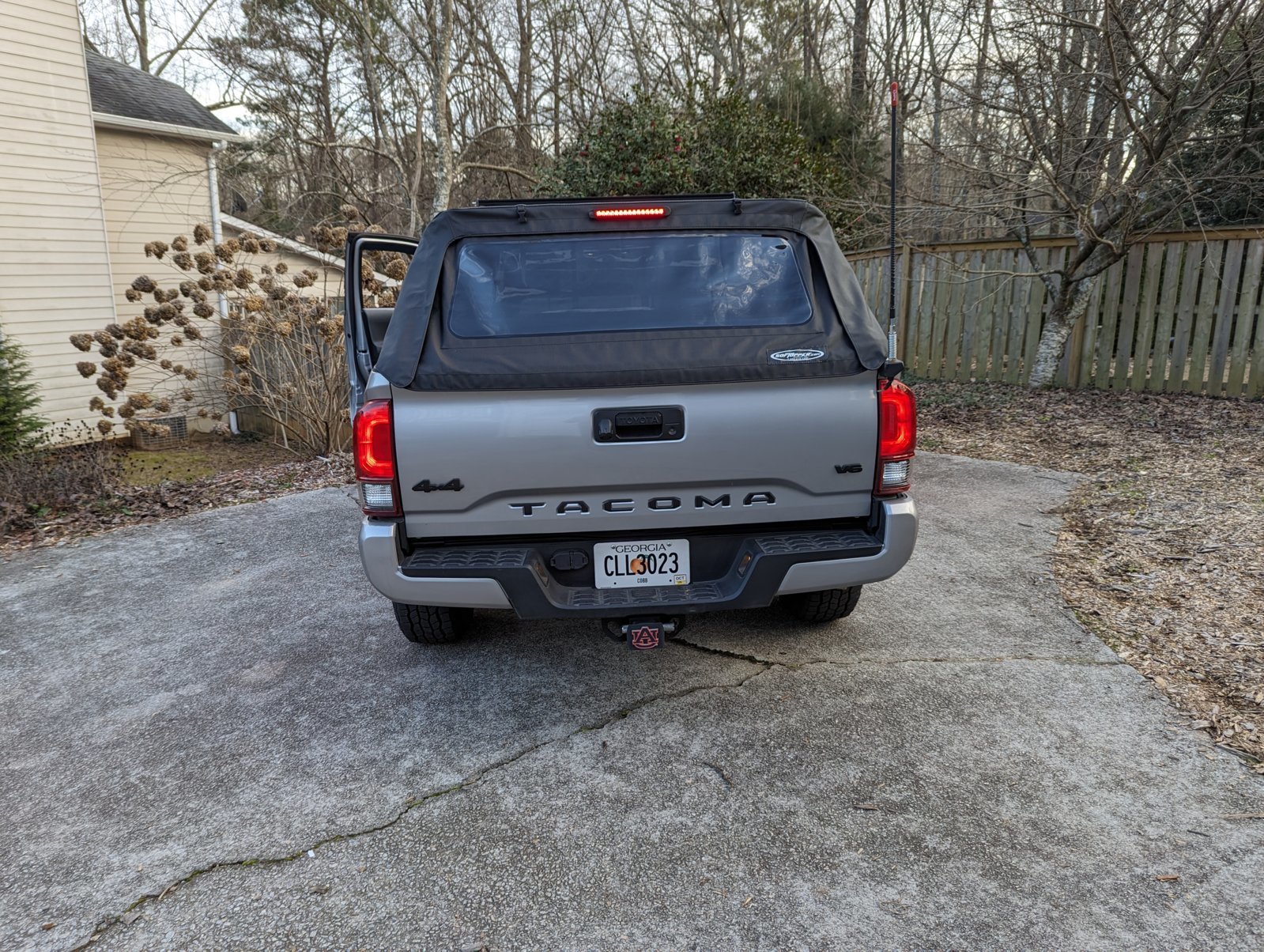

    Added a 3rd brake light. What a pain in the ass when the Chinese light doesn't come with wiring instructions and the people in reviews have it wrong also. I had to just swap the wiring until I found the right combo.
