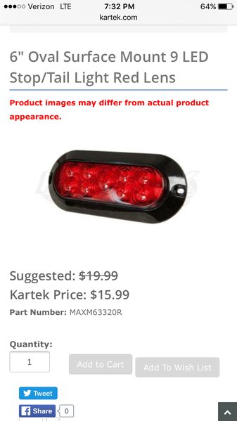

    Anyone done a 3rd brake light on their topper? I don't NEED one but I would like one for the extra measure

    I was looking at getting something like this and using standard tube mounts for it and having it behind the rear windowimage.jpg

    I want mine to be completely out of the way and so found a way to mount it above the window without poking any holes. I bought one of these...
    https://www.amazon.com/gp/product/B00029X0JC/
    ...and two rare earth magnets with around 75lbs pull each. I have already attached a piece of 1/16 mild steel (painted with chassis black) to the back of the light that matches the shape and is notched for the wires. I also used black silicone caulk to seal all the edges and the wire notch. The two magnets do a great job holding the light in place and I don't think there is any way for it to ever vibrate loose no matter how bad the washboards get.. Eventually I will tap the trailer plug and run wires to a cubby near where the Softopper pivot pin is located and install quick disconnect plugs. From there I will run the wire along the Softopper bars to above the rear window and install another pair of disconnects. Then stick the light on (steel backed light outside the canvas, magnets inside the canvas), run the wires through the velcro, and plug em in.

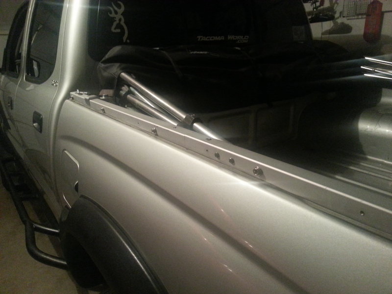

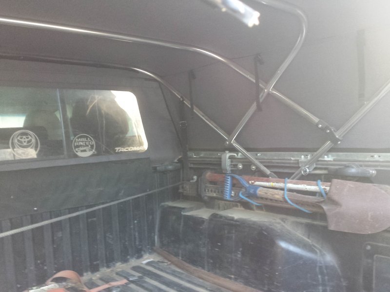

    Scrolling through but I'm just going to ask as well
    Can someone post some pics of the rails that the soft topper or bestop use.
    Also curious if you can fold it up while it's not attached to the rails. Trying to figure out if it would work with my bed rack but if I had to close it, i imagine it would go up to high

    Best I have. Softopper:

    This is the best photo of my Softtopper rails I have on my computer right now
