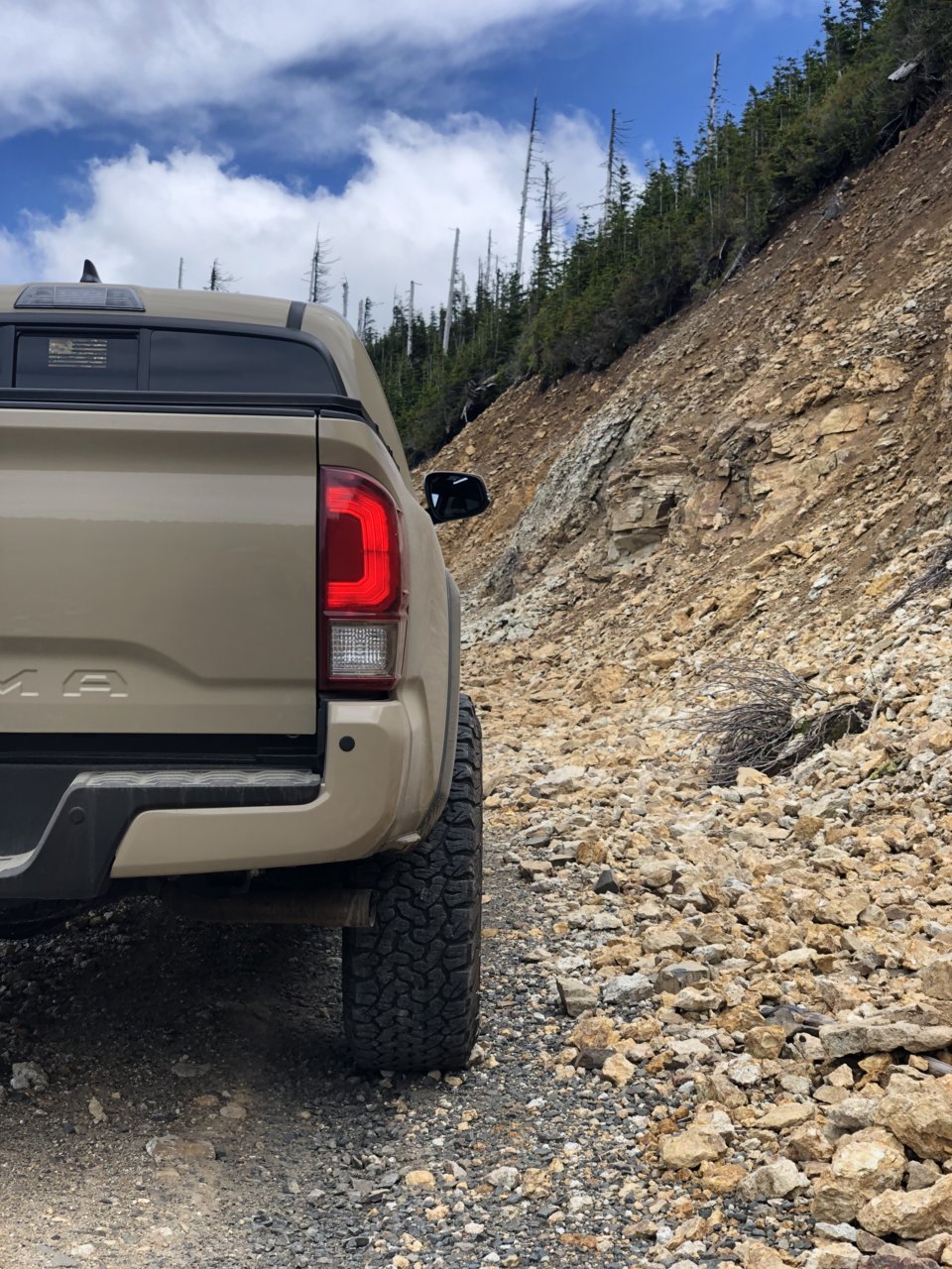

    Just the tip. 285/70R17, 17x8.5, ET0, 1.25” Spidertrax spacers.
    AA61B6C5-2ABA-4304-BA69-571C92BAFB69.jpg B16C5347-758D-45AD-BE0E-79F51201DEE1.jpg

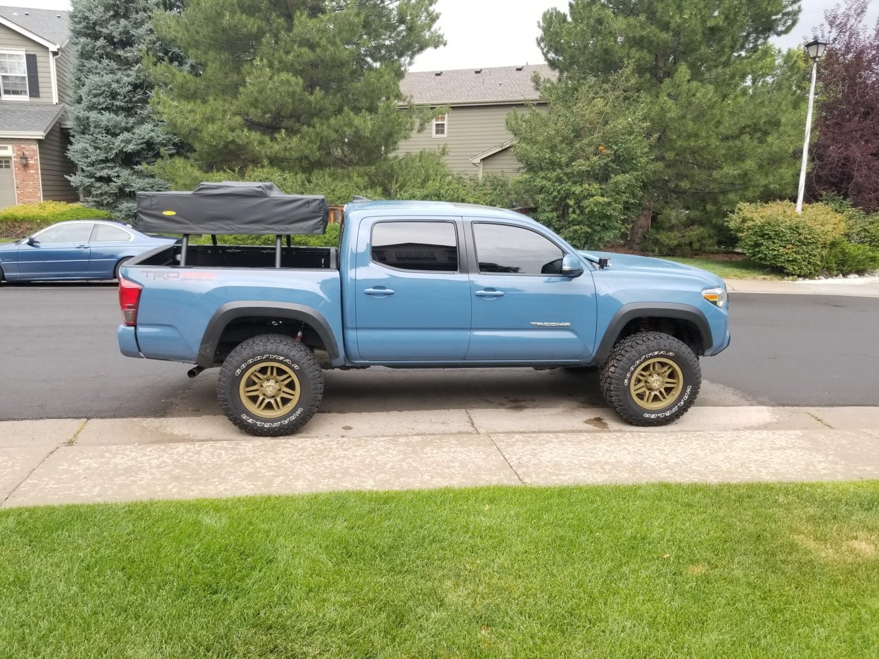

    17x9
    -12 offset
    295/70/17
    Nitto Ridge Grappler
    BobcatSR and 44-16 Taco like this.

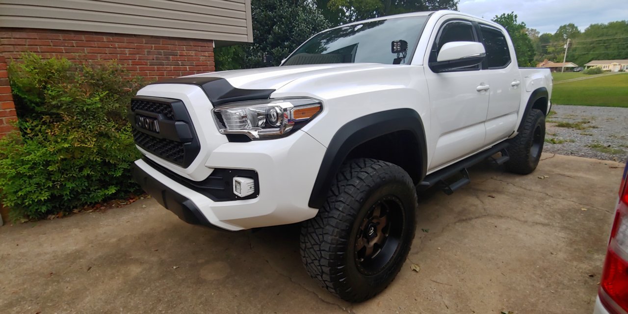

    49F85F05-2335-4D7A-A0F3-A24B6C9811AA.jpg I think I have decided to go with the duratrac just because of the snow rating and all the positive reviews I have read with winter driving.. my questions is they have two sizes available.
    295/70/17
    315/70/17
    I really don’t want to have a bunch of rubbing issues. I am having the Lil B’s cab mount relocation done next week and will be running 17x9 -12mm RRW wheels. I have the Icon stage 9 with the RXT rear in option 2.
    As you can tell I normally run with Wranglers on 35s and 37s, these 265s 31.5” Just aren’t cutting it anymore.

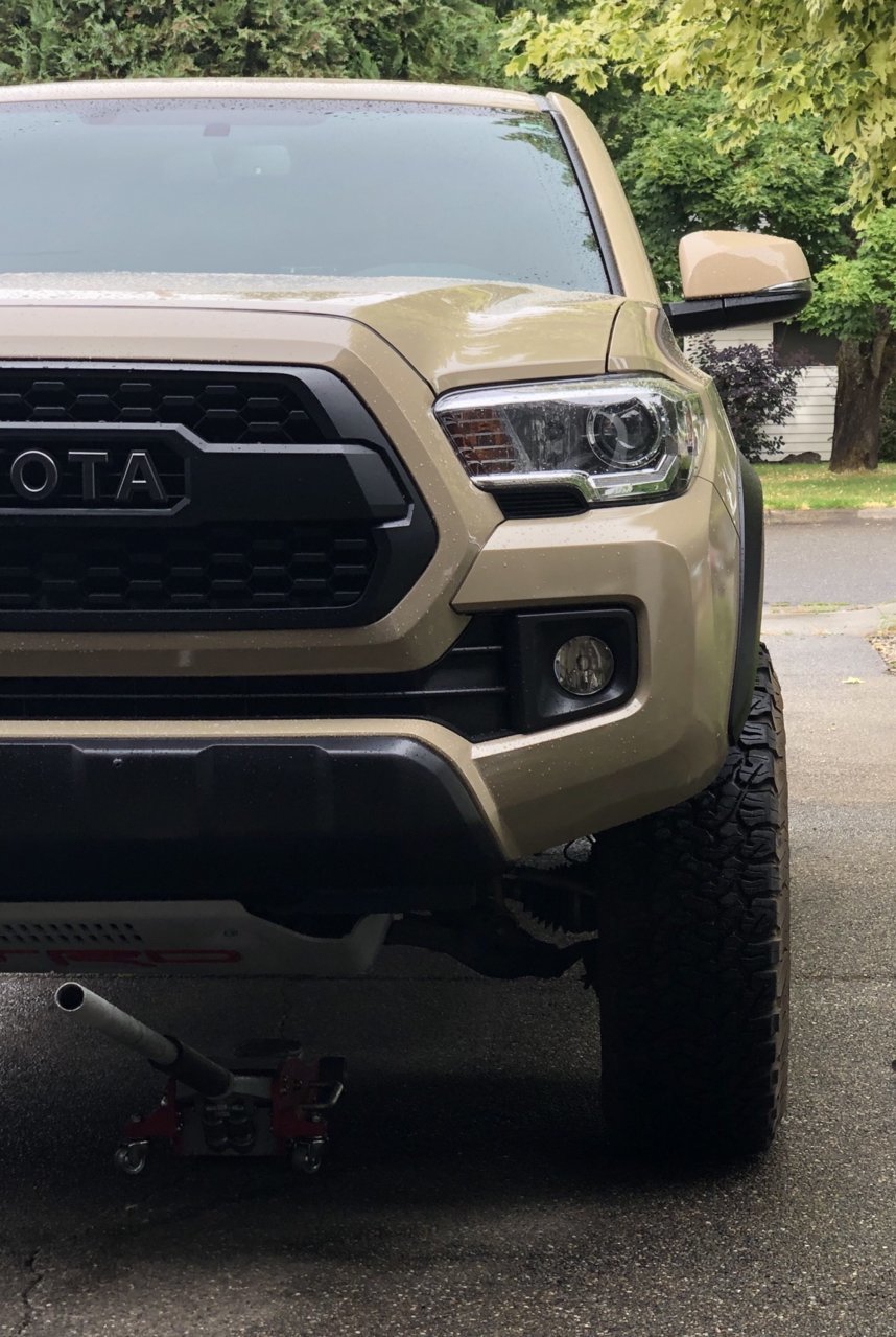

    17x8.5 et-6 285/70/17

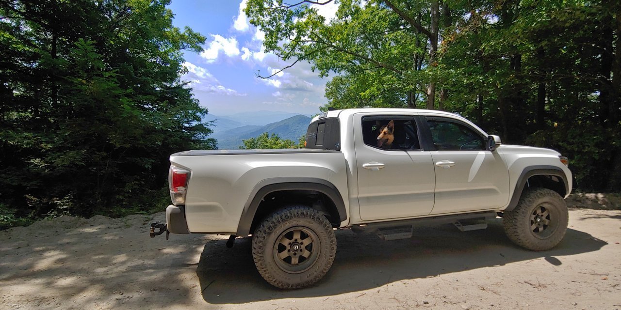

    20190905_185837.jpg 20190903_122707.jpg My girl rocking 17x9 -12mm fuel podiums. Clean and oh so dirty versions!
    Konagrn and su.b.rat like this.

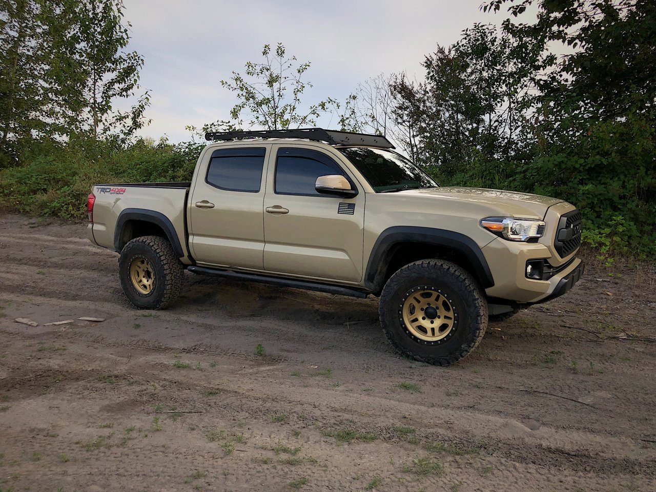

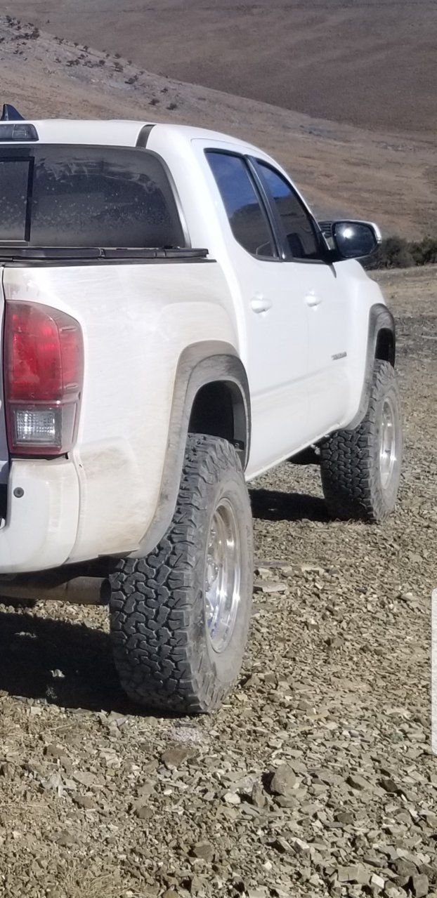

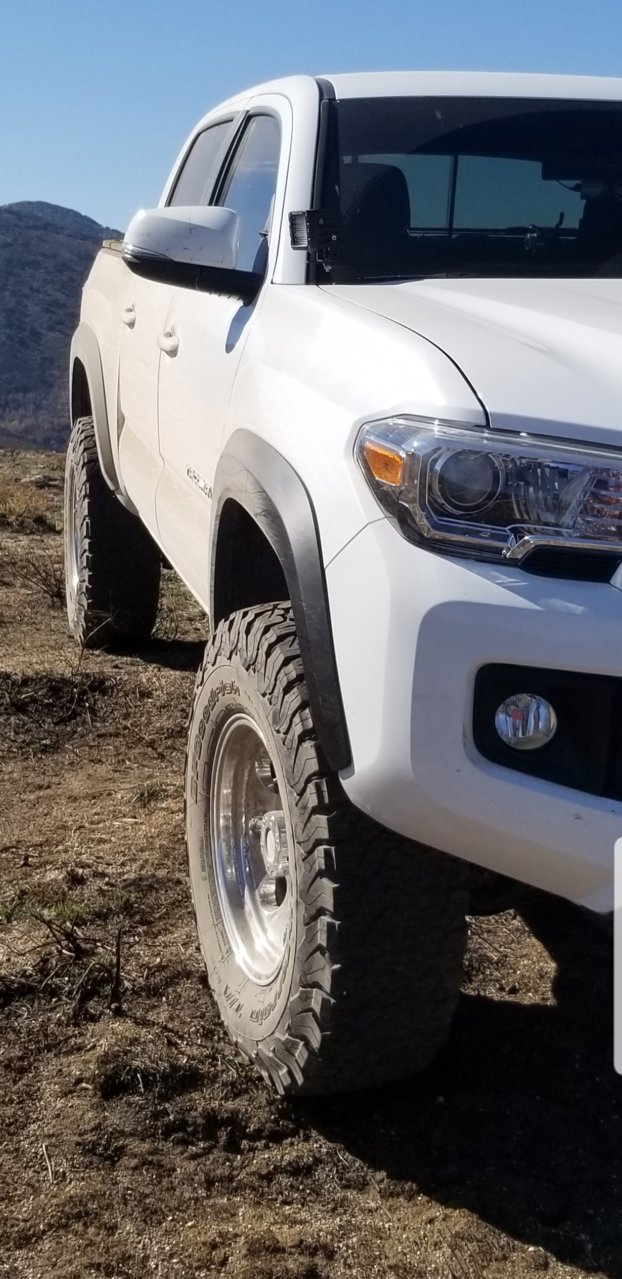

    1.5" Eibach springs, 1.5" Icon add a leaf, Bilstein 5100 shocks, 1" rear blocks.
    16x8 pro comps with -12mm offset
    265/75-16 bfg ko2
    Screenshot_20191106-135318_Gallery.jpg Screenshot_20191106-135407_Gallery.jpg

    What lift are you running? Any rubbing when the truck is flexed or any kind of noise from the front end?
    No rubbing on normal driving even full lock, but when rough off roading full lock it rubbed a couple times when I hit big rocks while turned. Really minor rub though. I have 1.5" eibachs, icon 1.5" leaf pack with 1" blocks and bilstein 5100s all around. Lowest clip setting. Overload leaf removed. 1/4" spacer on driver's side. I should have left the overload spring in but I didn't like the level rake so I added the 1" blocks afterwards. The icon ubolts were long enough for the blocks. Rake is 1.25-1.5" now. 1" rake loaded up. No noises at all. It's solid.
