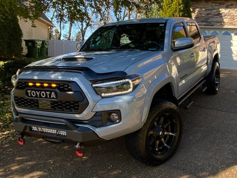

    3,279
    SE
    2018 Tacoma Sport ACC CB Inferno
    17X9 -12

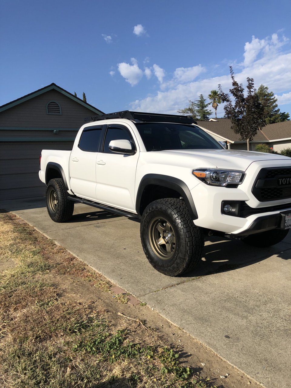

    Kane50
    Kane50 Well-Known Member
    May 11, 2016
    #186700
    187
    2016 TRD Sport

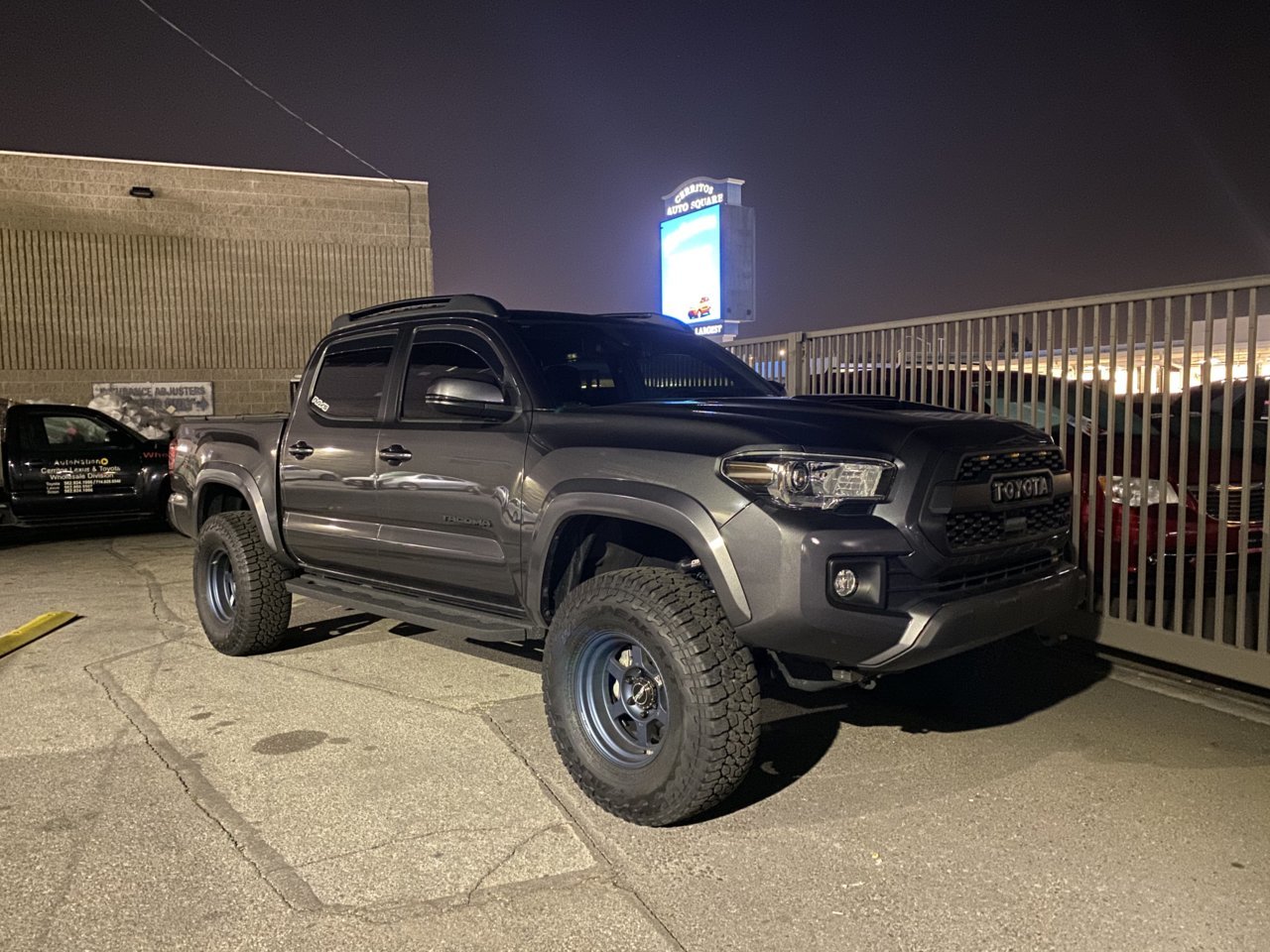

    _mbarr
    _mbarr Active Member
    Apr 10, 2018
    #250103
    36
    16x8 -20

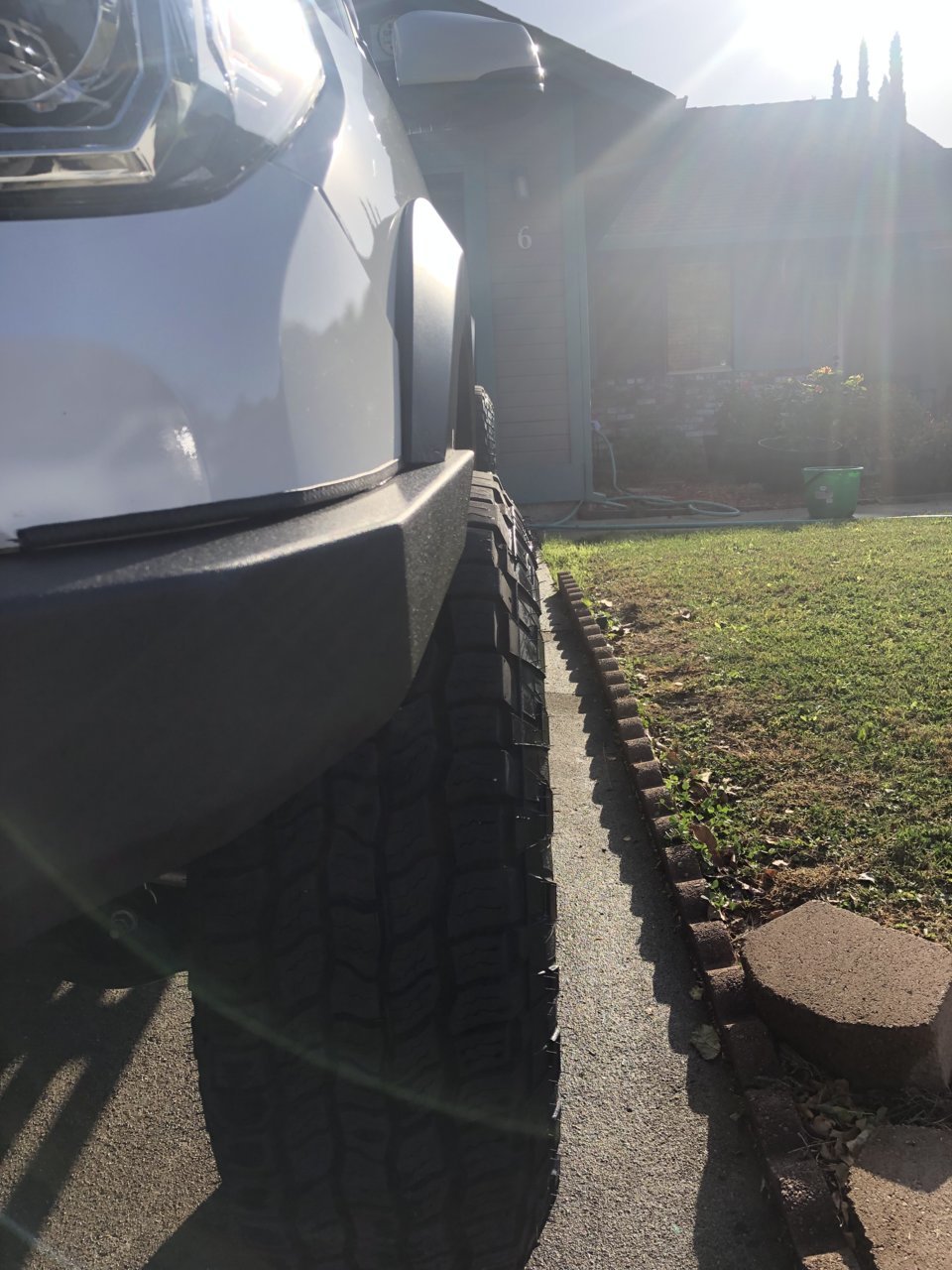

    Do you have a straight on or behind shot?

    Scott
    East Tennessee
    2018 Taco Sport (Cement)
    3in leveling lift (Coilovers and AAL) 285/65R18 tires 18" Fuel wheel/tire package Pro Grill, Morimoto XB LED Headlights, DD SS3 Pro Fogs Body Armor Front and Rear Bumpers Pioneer WC6600 head unit w/ OEM Audio + Reference 500 System with dedicated sub amp Meso signal lights, gas hole, led interior lights, ECT relocate, Chrome delete kits Meso Overhead Molle Rack, Seat Risers, Katzkin Leather seats (self installed...it was a fucking bitch) VFTuned .....KDMax Pro!
    3in leveling lift. 285-60R18 Neg 12 Offset. Very light rub on front wheels at steering lock. If I pulled the rekgens there is no rub.

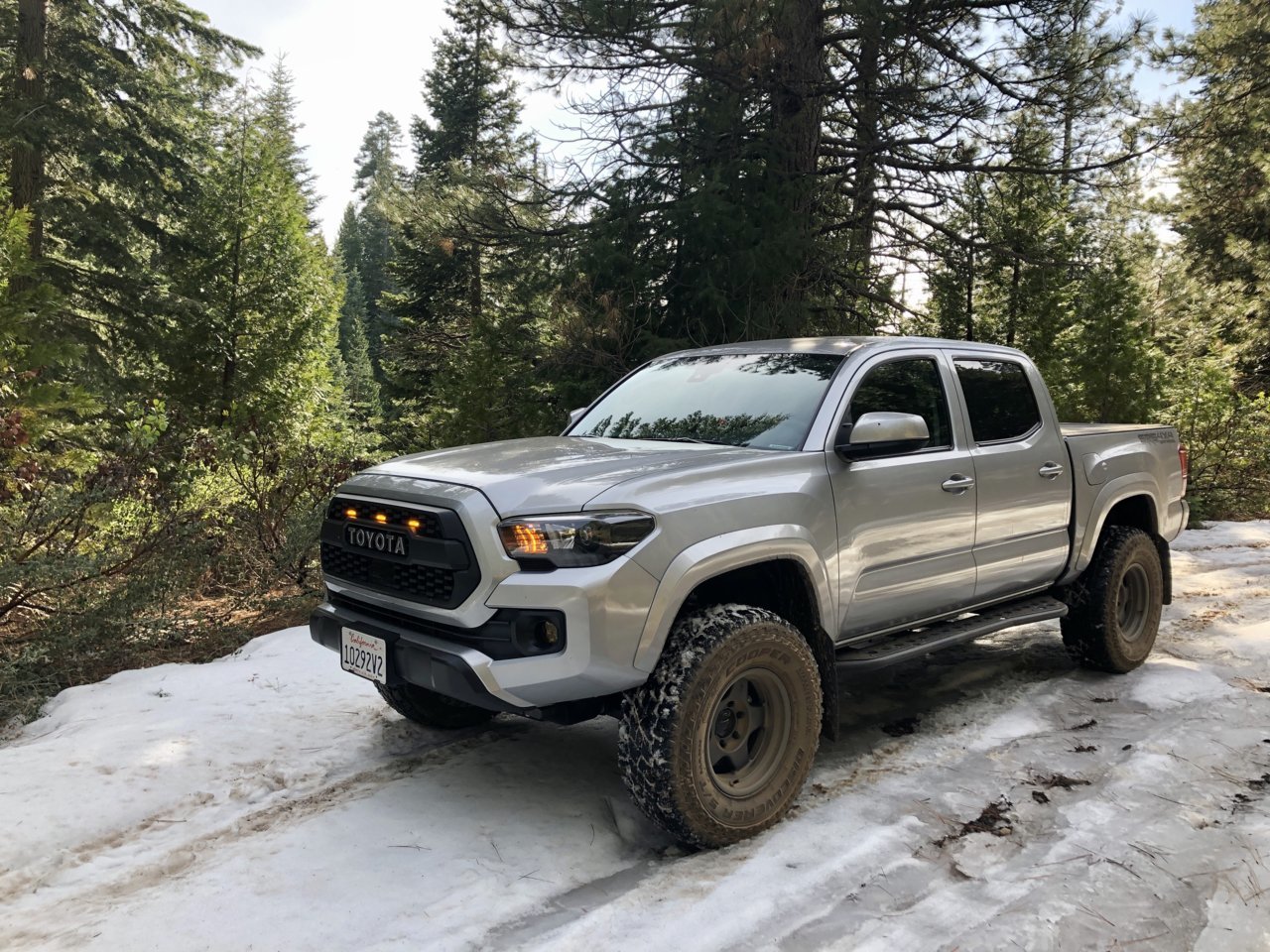

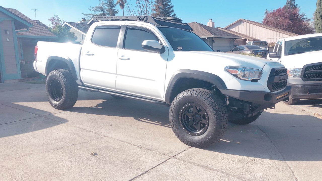

    blitzkrieg3002
    blitzkrieg3002 Well-Known Member
    May 30, 2016
    #188296
    1,217
    Rick
    California
    2019 Tacoma SR5 4x4
    SCS F5 -25mm 16x8, 285/75/16
    E31B8B07-0874-4EE1-A89B-2971EE1B1701.jpg 15EE8E09-E242-4DB8-8618-3AB2EC5648B5.jpg AA3783E9-823F-4FA5-B9C3-8863511576ED.jpg
