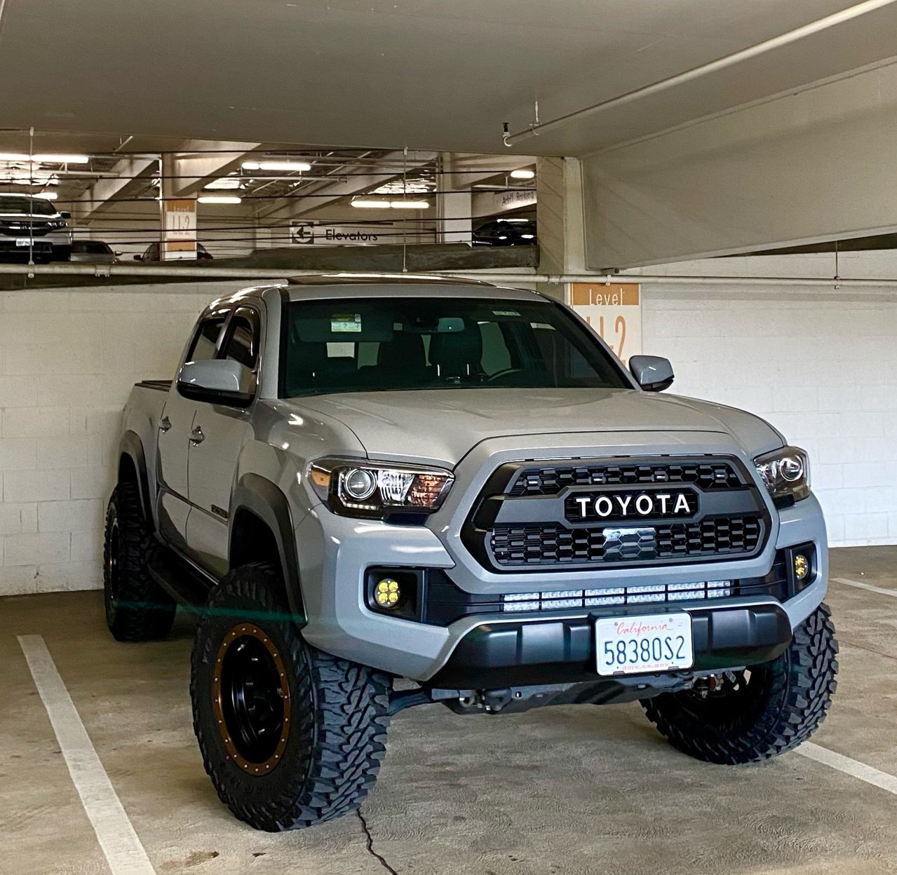

    -38, its been almost a month I am still trimming my wheel well plastics.

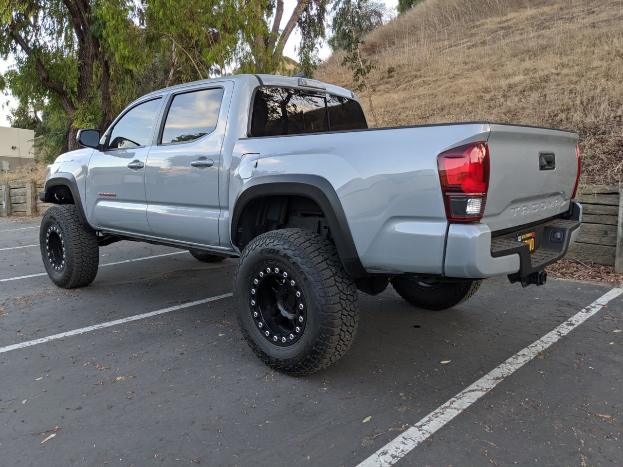

    16x8 SCS F5 -25mm/3.5" BS
    265/75/16's on a 2.5/1.5 lift, haven't flexed it out offroad but no rubbing so far. Should have added ~2" of width to each side. Slings shit all up the side of the truck, but so worth it for the look!

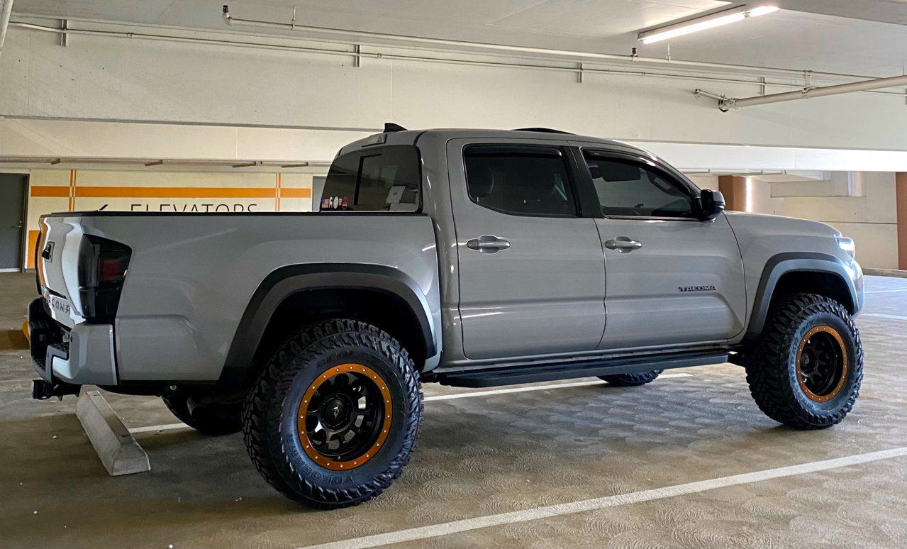

    Negative 18 offset on 275/70/R17 BFG KO2's, 2.5" lift in the front and 2" in the rear. Wheels are Black Rhino Barstow's, 9.5" width. No issues with rubbing after lift.
