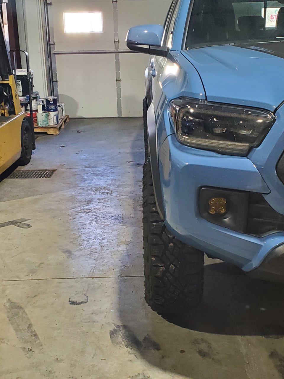

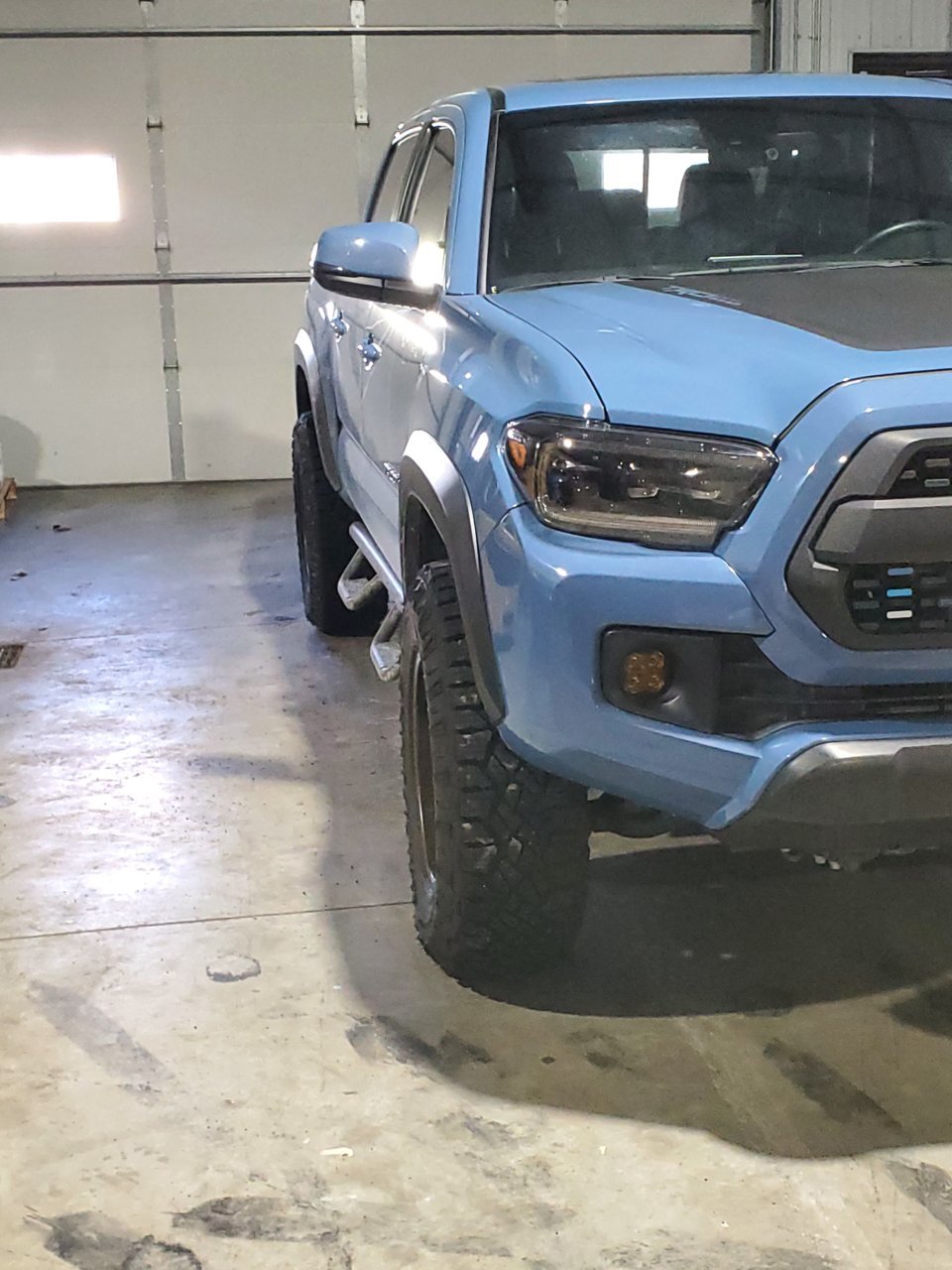

    I rubbed hard core with -10 mm wheels with 265/70/17 tires.
    Here's two quick pics to show the bit of poke I get though.

    I got the SCS Stealth 6, 17" wheel with -10 and drove it for a day before I had to do some heat gunning the liners and trimming. Every turn it was a bad rub, in reverse even more so, took a few days of heat gunning to get it where I don't rub anymore in forward or reverse. He may have to CMC to even get around town with the -38, I know I was starting to consider it if I couldn't fix it myself.

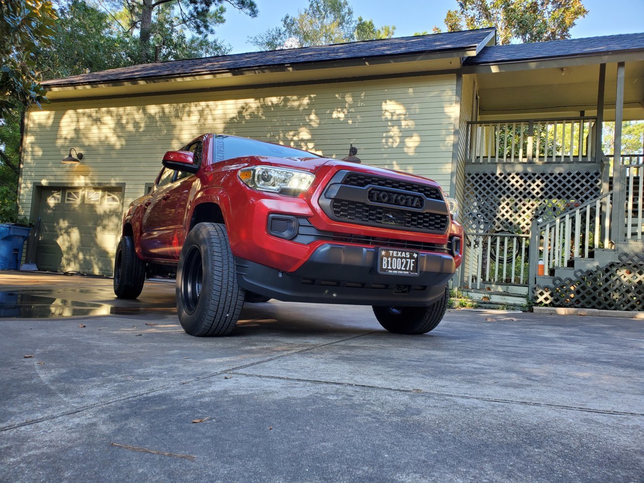

    did you have to do any cutting or chopping to fit those tires and wheel offset? i dig it!

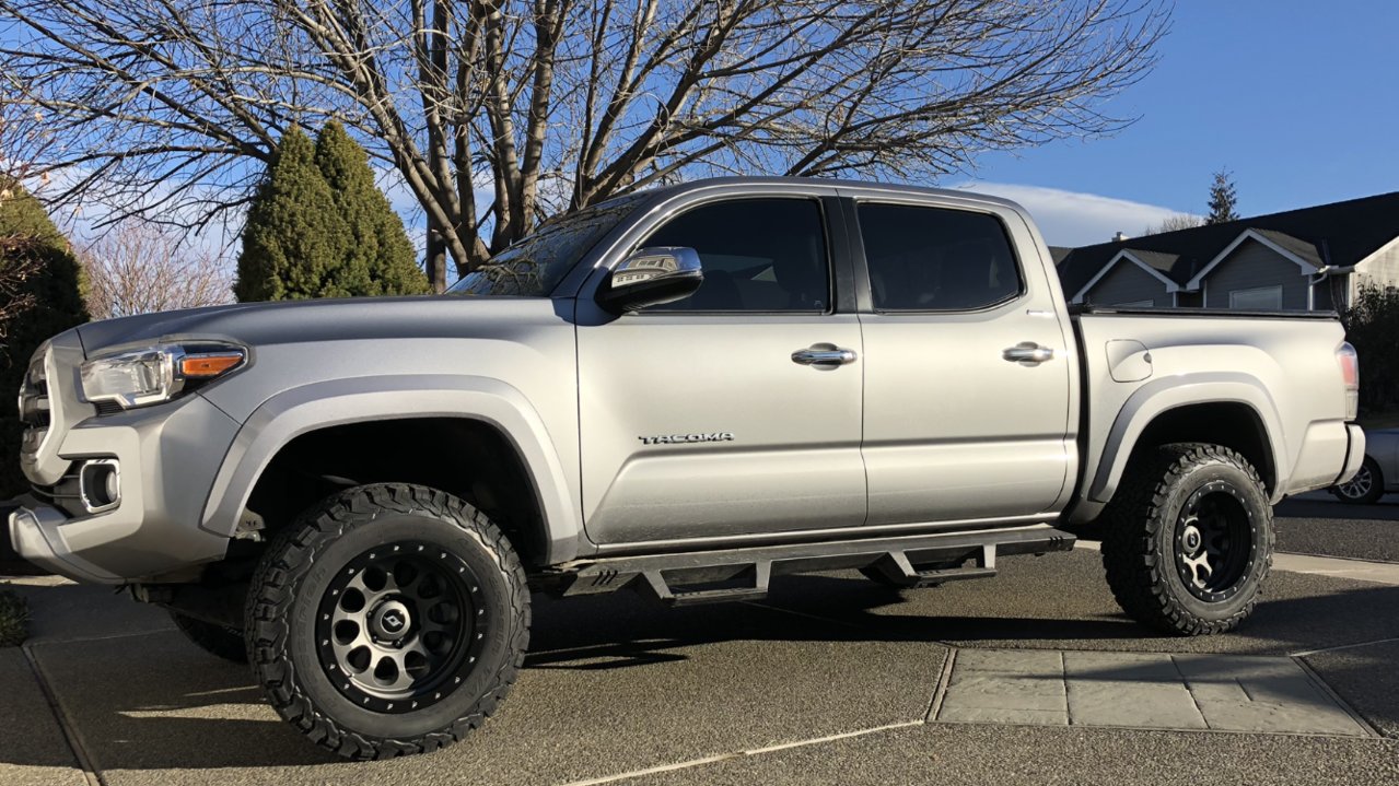

    I relocated the front of the fender liner and trimmed the fender at an angle. In the rear of the fender liner near the body mount there is a bump that sticks out. I heat gunned it and pushed it in. No hardcore modification necessary.20200609_180846.jpg
    Lol, as you can see my wheels WERE bronze. Had them powder coated black after an unfortunate carwash experience.

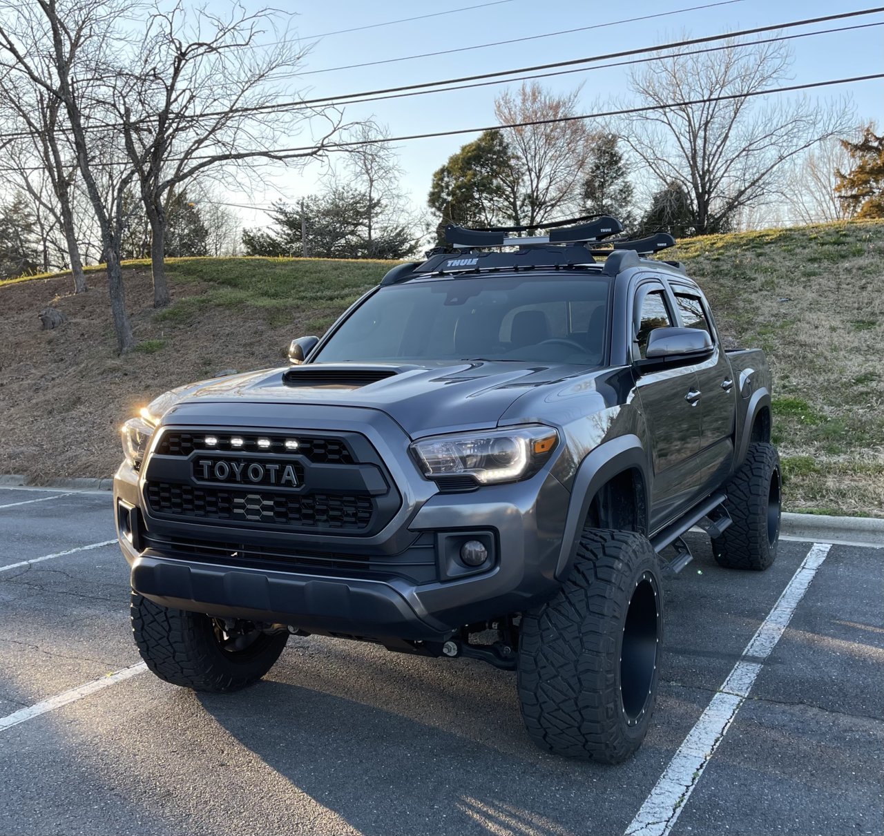

    6” RC lift with coilovers. 33x12.5 tires on 20x12 wheels with a -44 offset. Some plastic trimming and a cab mount chop. No rubbing whatsoever even at full lock. I don’t off road, so I’m not sure if anything would rub when articulating.
    Might have been able to clear without the cab mount chop if I upgraded the UCA’s.
