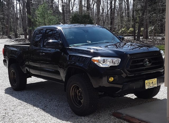

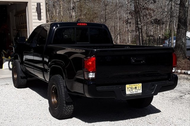

    2k2
    2k2 Flareless
    Jan 30, 2020
    #317785
    1,398
    Zak
    Gen 3 SR 4x4 4cyl AC
    See Build Thread
    SCS F5 16x8 -25mm offset 18ish lbs
    265/75/16 Falken wildpeak atw3 116t 44ish lbs
    Bone stock 2020 SR suspension. Had minor scrub radius rubbing at full lock in reverse on inner fender plastic near the cab mount and near the front bumper (worse on driver side due to me being in the cab). Heat gun and some massaging took care of that.
    37 psi in the front
    35 psi in the rear
    I average about 22mpg sometimes more sometimes less. Seems to be worse in cold weather and better in warm. If your concerned about keeping mpg then rotational weight is something to consider. If your looking for performance off pavement, well mpg isn't really a factor.
    Drives really nice and tracks straight. Poke is nice but not obnoxious (at least for me). I'm flareless so it looks pretty aggressive. I had to put some small THIN mud flaps on to keep my paint intact (had to modify the fronts quite a bit to keep em out of the way of the tires while turned. If I had flares I would have probably been ok. My son has 16x8 -12 with the same tires and his peek out just beyond the flares by half an inch.

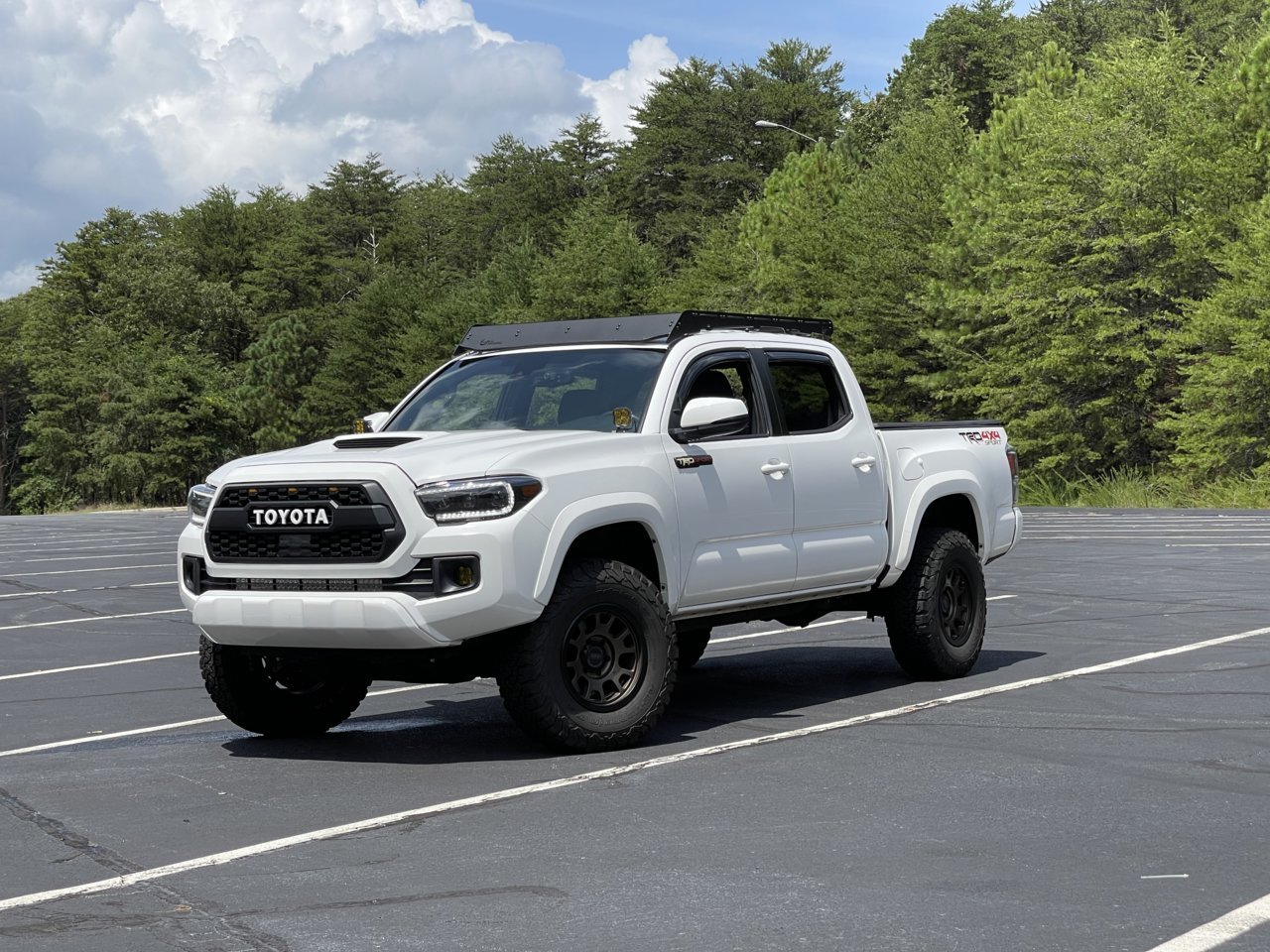

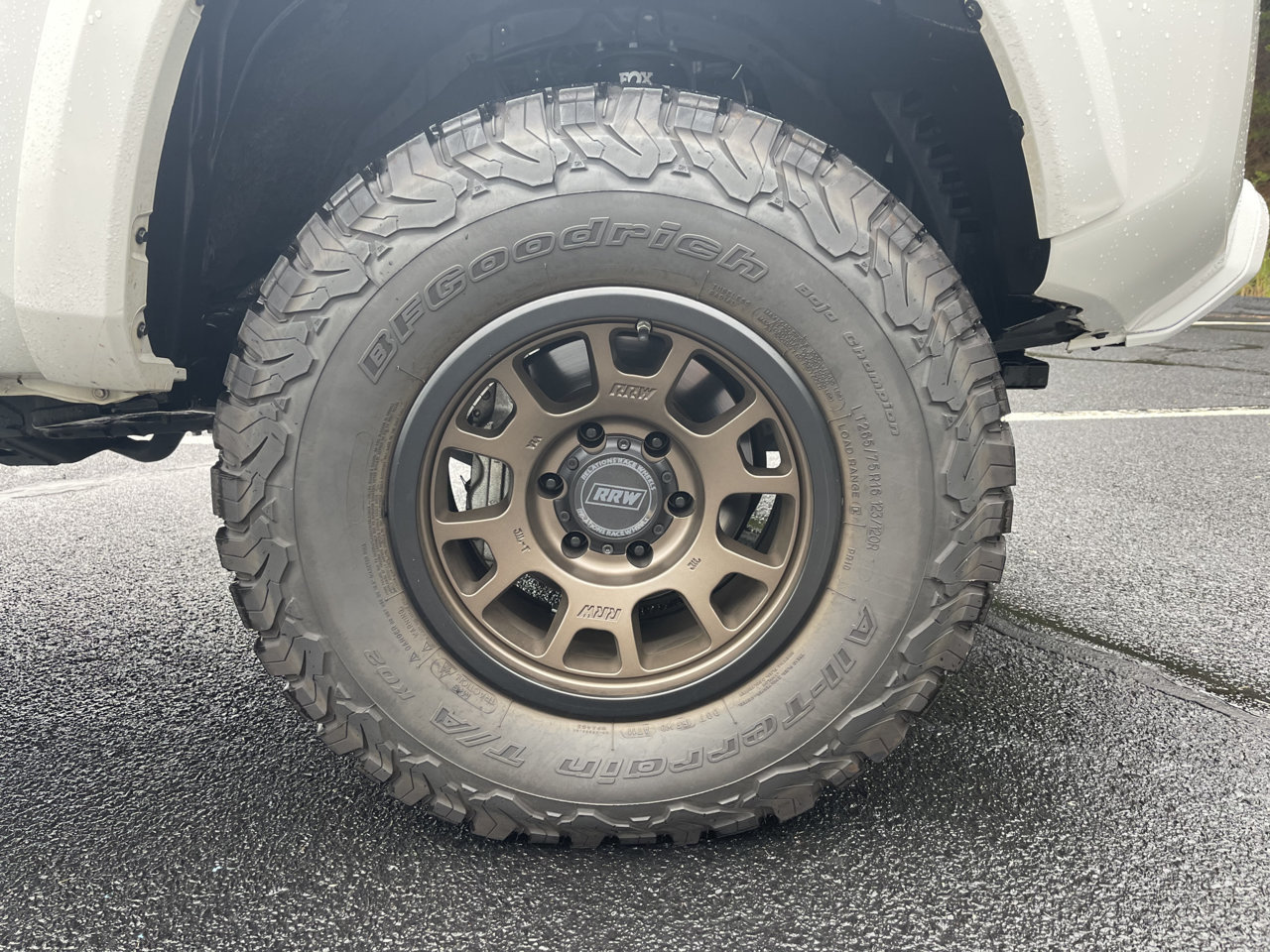

  15. Sep 11, 2021 at 5:18 PM
    #335
    brandon78lusch
    brandon78lusch Well-Known Member
    Oct 22, 2019
    #308678
    4,025
    Brandon
    East Carolina University
    2019 TRD Sport DCSB, 1978 Pontiac Firebird Trans Am
    RRW RR5-S 16x8 | -12 offset | Matte Bronze
    BFGoodrich KO2 265/75/16
    Fox 2.0 Performance Suspension (~1.5 inch lift)
    ~1.5 inch poke from fender flares
    trl1990561 and tacomakid96 like this.
