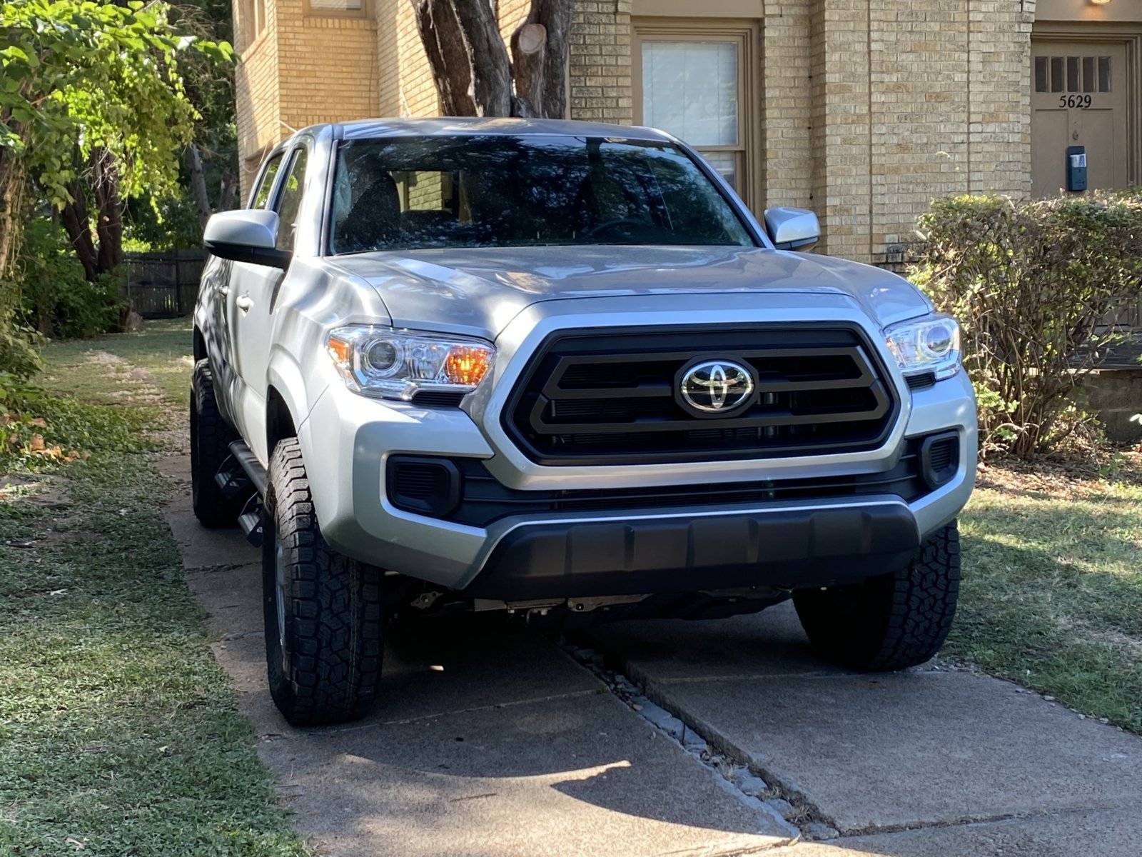

    Jonathan
    Dallas
    2023 Tacoma SR V6 4x4
    -Toyo open country 265/75r16 on stock steelies -Spidertrax 1.25inch wheel spacers -Black tailgate letter inserts
    Controversial post? I put 265/75’s on my stock steelies, then added some spidertrax spacers. Torqued em to spec with loctite then checked again 50 miles later, still solid. Have done plenty of off-roading in Colorado and New Mexico since then and they’re holding up great. Did I cheat? Maybe. But I love that she has some shoulders now, even if it does sling mud all over the god dang place. And yes these tires rub the mud flaps here and there. IMG_7829.jpg

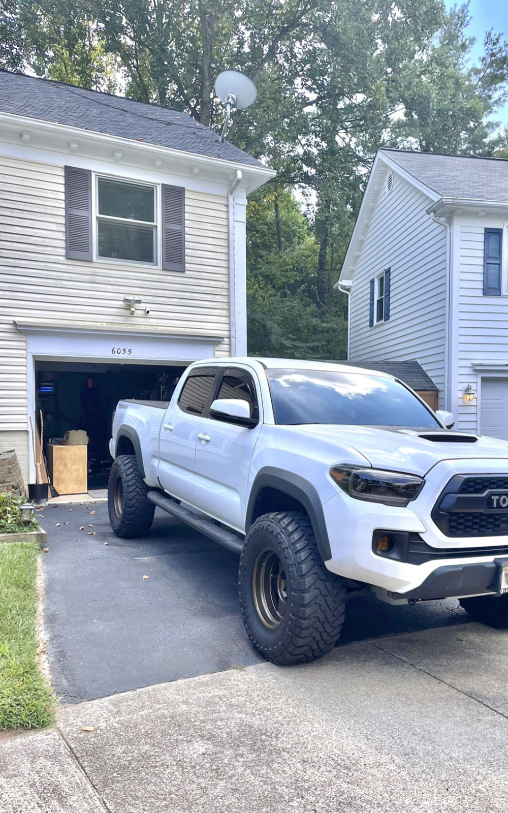

    #509
    kas2828
    kas2828 Well-Known Member
    Jul 4, 2020
    #333434
    429
    Austin
    Arizona
    2020 TRD Off-road 4x4 DCLB
    Man, that looks great. How much do it take to run the -38 with 35s. Doesn’t look like you needed to trim fenders.

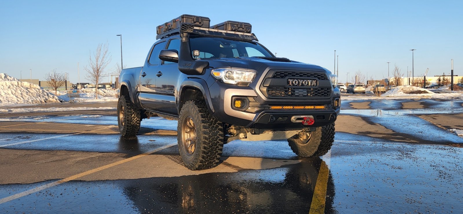

    Bart
    2017 Tacoma Sport 4x4
    Work in progress...

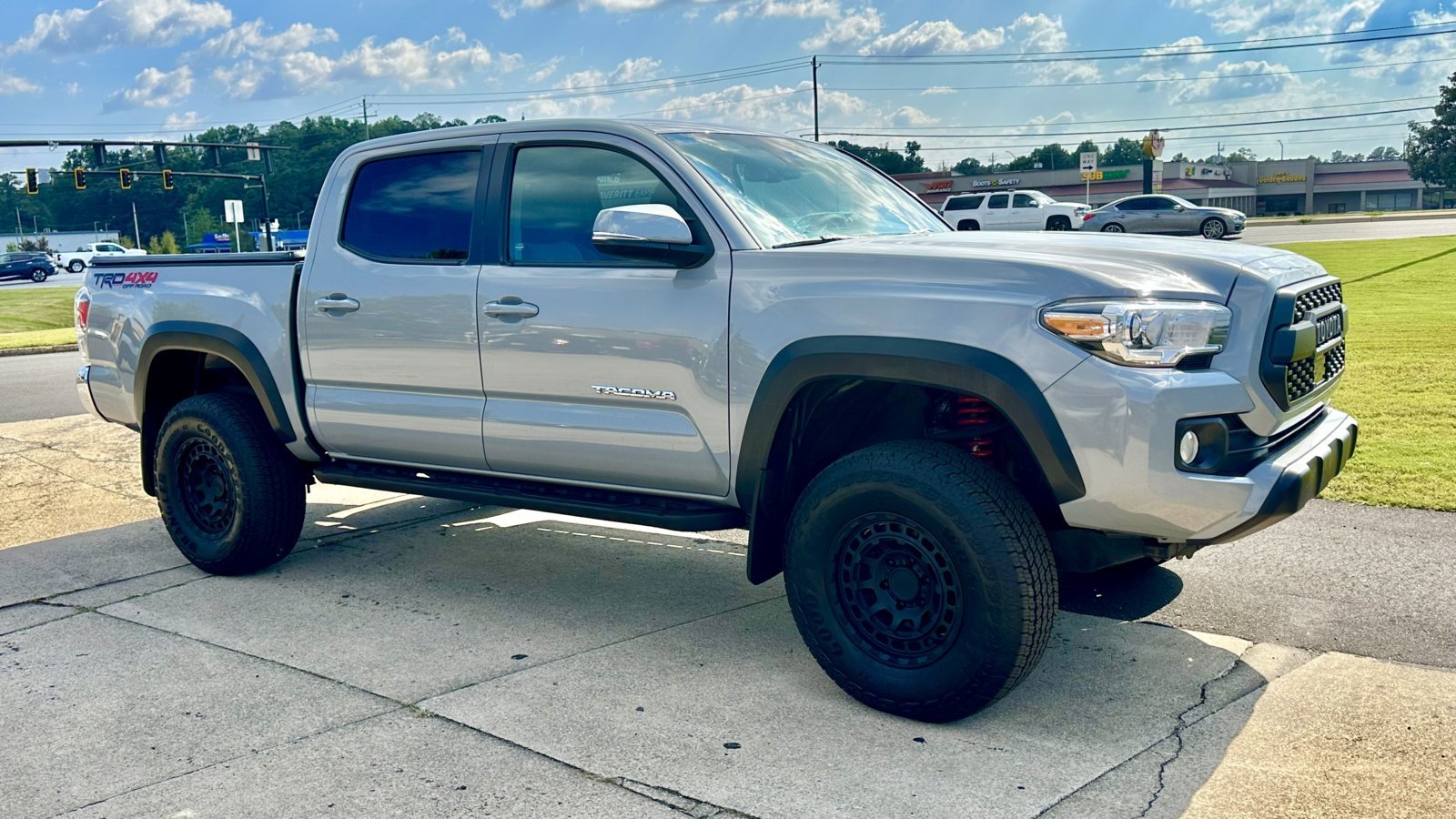

    -10 on the cheap. Honestly I saved up for new wheels, money not a concern, I really can't find any better looking wheels in my opinion. These the Lone Star what ever the Discount/America tire sells. Easy to clean and lasted 5 or so years on/off road so far at about a buck15 each.
    Yota_MGM likes this.
  11. Nov 14, 2023 at 9:54 PM
    #511
    Veet-88
    Veet-88 Well-Known Member
    May 21, 2015
    #155792
    1,756
    18 Tacoma DCLB sport
    Alot if you want yo do it right. Street use you can get away with a cmc and a good alignment maybe extended bump stops to save your flares. But to do it right if you use your suspension CMR fender trim and an agressive front bumper/liner trim.
    I say this as my 295's already try to eat my fender flares on occasion.

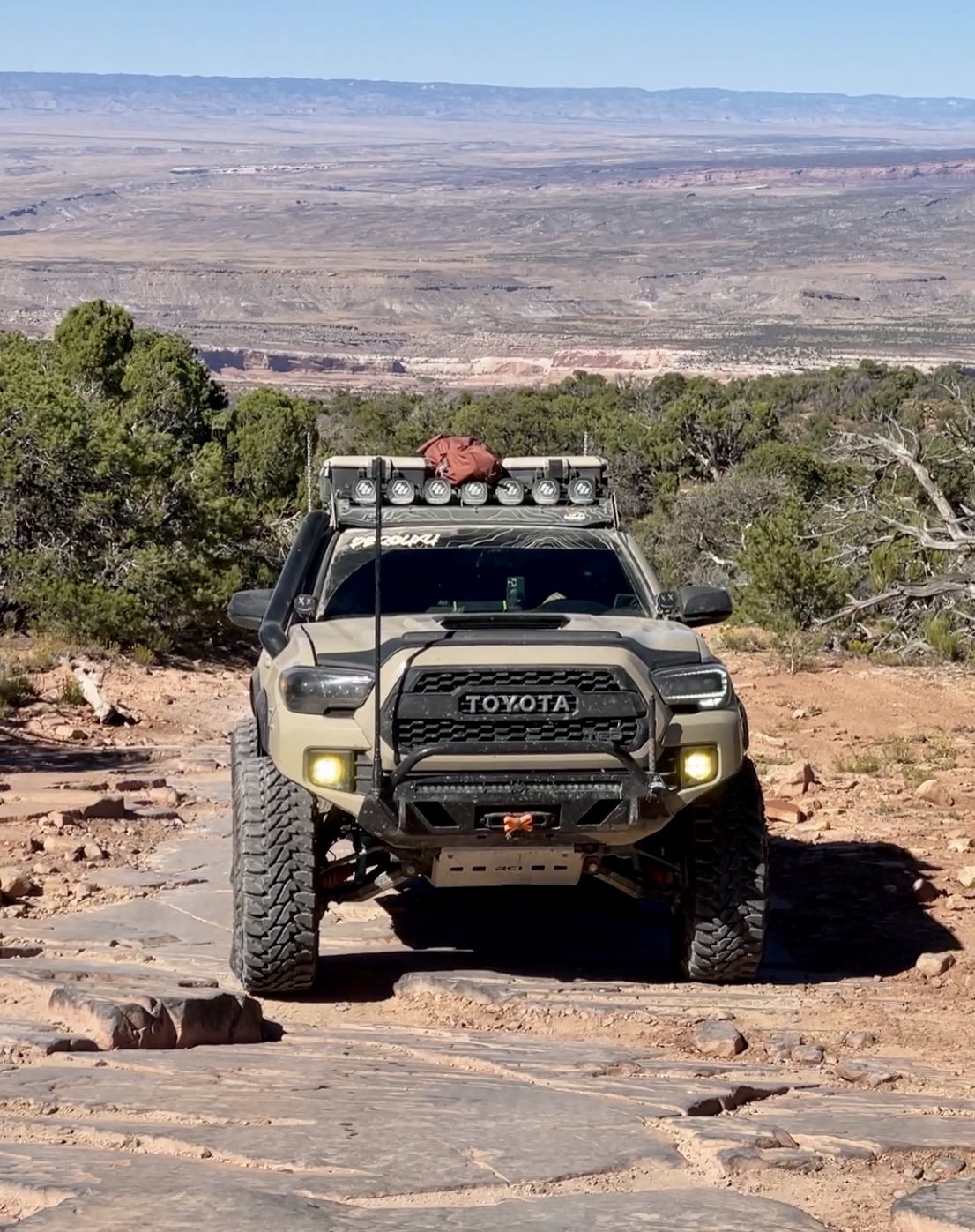

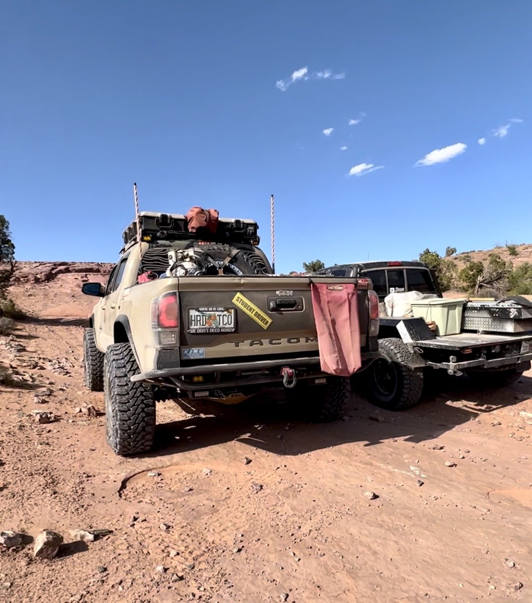

    RRW Bead locks -25 and a 1 1/4 inch spacer - I'm terrible with these photos don't really have any straight front or rear.

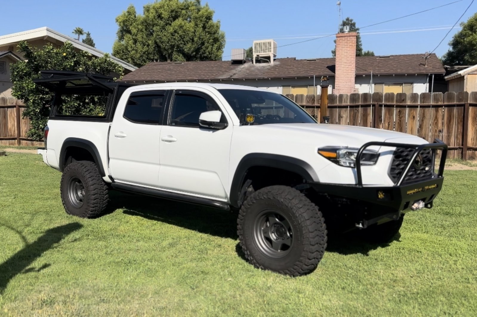

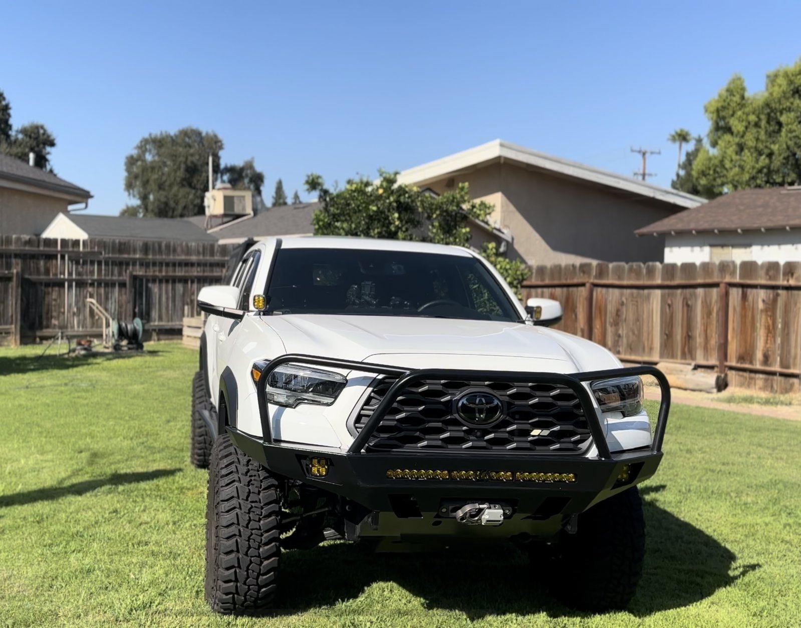

    Armor: RCI Plated 20 Degree Sliders RCI Full Skid Plates Steel RCI Fuel Skid RCI Rear Diff Skid SNS Designs ABS Guards Front Bumper: C4 Overlander with Full Hoops C4 Front Bumper Frame Support Brackets Bed: Total Chaos Bed Stiffeners Cali Raised Bed Light Kit Toyota Bed Mat Alu-Cab Contour Canopy Blue Sea 5025ST Fuse Block Blue Sea 4363 Switch Panel Victory 4x4 Front Bed Molle Panel Mountain Hatch Tailgate Table 3.0 Fire Extinguisher Shovel Axe Fatmax Extreme Lighting and Electrical: PowerTrays Essentially BantamX Spod Bantam X w/ Touchscreen Baja Designs 30” S8 Light Bar Driving Combo Baja Design Squadron Sport Diving Combo Baja Design Squadron SAE Fleece All Lights On Engine: K&N Drop In Air Filter Mishimoto Intake Hose Toyota Air Accelerator Toyota TRD Oil Cap Toyota TRD Radiator Cap ECGS Bushing SDHQ Terminal Kit Fumoto Engine Oil Drain Valve AC Drain Mod Exterior: De-Badged Black Tacoma Tailgate Letters Heritage Badge In Black/Grey/White AVS Rain Guards AVS Aeroskin Hood Protector Lftd Customs Taco Sauce Gas Cap Holder Tacoma License Plate Frame Black Sylvania License Plate LED Lights R4T Bumper Caps Meso Customs Headlight Trim Plate Meso Customs V5 Ultimate Turn Signals SDHQ Ditch Light Mount Rago Fab Antenna Mount Interior: Desert Does It Seat Jackers & MMP K&N In Cabin Air Filter Matte Black Steering Wheel Emblem Meso Customs Red Push To Start Meso Customs Vent Rings SW Meso Customs Climate Control Rings SW Meso Customs Interior Chrome Delete SW Meso Custom Minimalist Key Fob V2 SW Meso Customs Extended Fuse Cover AJT Designs Door Handle Covers Z Precisions Cup Holder Midland MXT275VP4 Yodaverse Interior LED Kit Yodaverse Center Console Organizer TacoMods Radio Knobs w/ Backlighting Headrest Paracord Grab Handles SOG Rapid Rescue Dongar Technology Mirror Adapter Garmin Dash Cam Mini 2 Baby Toyoda Square Center Console Insert WeatherTech FloorLiner HP Grey Expedition Essentials 3TPAM Ram Mount Accessories GoGettaGrip Shifter Knob Magnetic Mic Patches Suspension Lift: DuroBumps Front Bump Stops Icon Billet UCA’s Delta Joint All-Pro Sway Bar End Links Marlin Crawler HD LCA Frame Brace Bison Offroad Cam Stop Kit Total Chaos Cam Tab Gussets Total Chaos Cab Mount Chop Plates Total Chaos Spindle Gussets W/ Sway Bar Accutune Fox 2.5 DSC Front Shocks Accutune Fox Tundra 2.5 DSC Rear Shocks Accutune 2.5” Bump Stop & U Bolt Flip Deavers U402 Stage 1 Yota Mafia Rear Extended Brake Lines 24” ARB Carrier Bearing Drop Kit FK29 Archive Garage Hammer Hangers Archive Garage 3.6 Shackles Archive Garage High Clearance Cross Tube Wheels and Tires: SCS F5 16x8 -25 Offset 3.5 BS Gunmetal Mickey Thompson Baja Boss M/T 285/75R16 Gorilla M12x1.5 Lug Nuts ET Liftd Customs Leashed Valve Stem Caps Winch: Warn VR Evo 10-S Warn Wireless Hub Factor 55 1” Fairlead Factor 55 Rope Guard Factor 55 UltraHook Gray Tandem Offroad Control Box Mount LambTek Innovation Switch Bracket Kit Blue Sea Switch Recovery: Factory 55 HitchLink 2.0 Warn Epic Shackle x2 ARB Tree Saver 16’ Special Thanks to: Sibi Built for the lift installation. Tiny Rig Co for the Alu-Cab and installation. Accutune for the Fox Shocks with Adventure Tune. Baja Designs for lighting. C4 Fab for the front bumper. RCI for sliders and skids.
    F5 -25 285/75R16

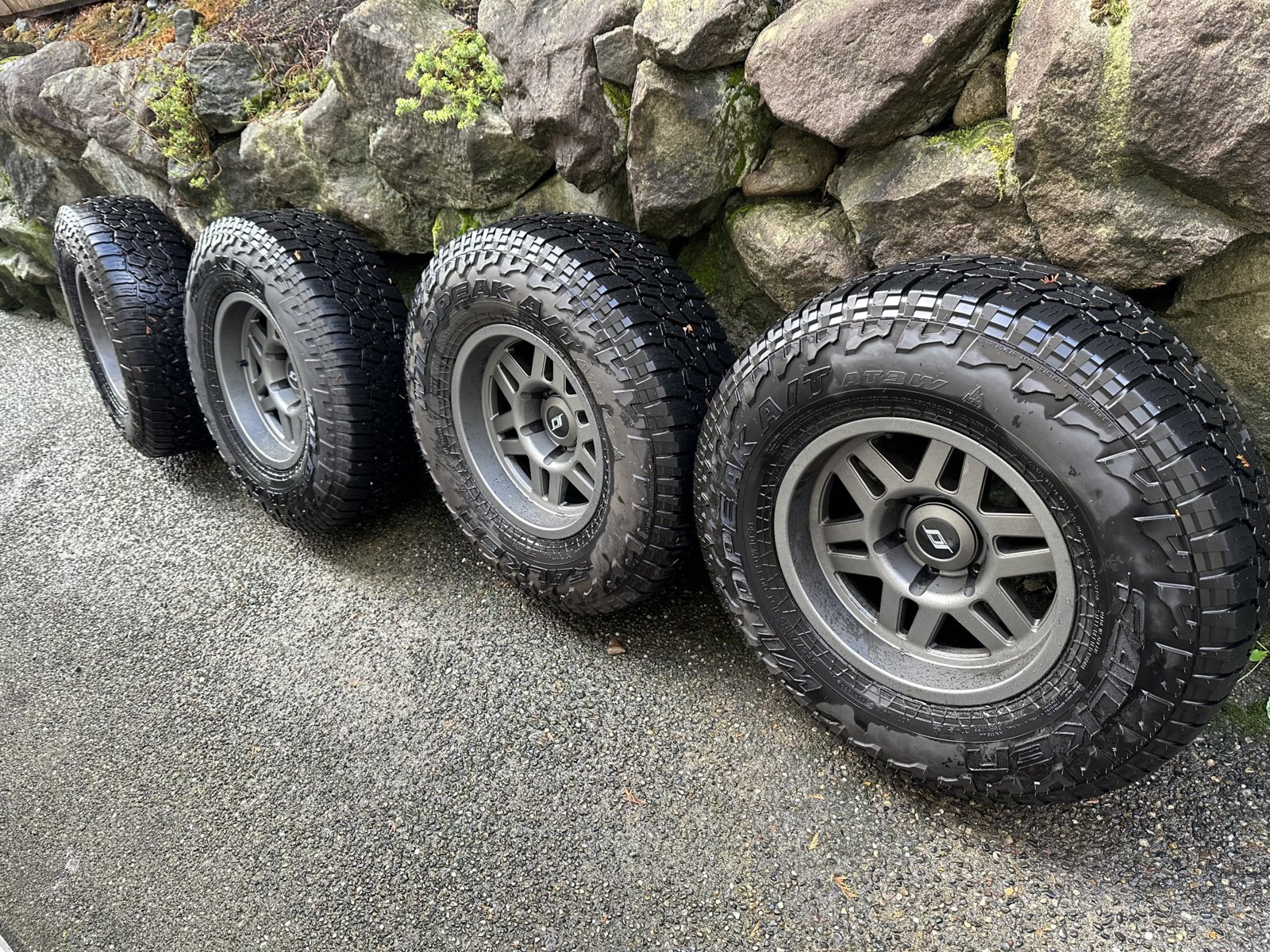

    AleHole
    AleHole PNW
    Dec 9, 2023
    #439175
    100
    Seattle
    2023 Tacoma TRD Sport
    First post and Tacoma NOOB!
    Coming over from a 1st Gen Tundra.
    I have some SCS Stealth 6 wheels. 16x8 -25 offset.
    The 265/75/16 Falken Wildpeaks rubbed so bad I had to take them off.
    Will 265/70/16 eliminate rubbing issues?
    I'd love to keep these wheels and stock suspension.

  18. Dec 10, 2023 at 12:59 PM
    #518
    Veet-88
    May 21, 2015
    #155792
    1,756
    Generally anything past -10 will require a cmc to fit without any rubbing.
    You have to think the stock sport wheel is a +33 and your going to -25 that's just over an additional 2 inches of offset
    AleHole[QUOTED] likes this.
  19. Dec 10, 2023 at 1:00 PM
    #519
    AleHole
    AleHole PNW
    Dec 9, 2023
    #439175
    100
    Seattle
    Bummer!
    I figured as much. I appreciate the reply!
    Looks like I have some wheels for sale.
