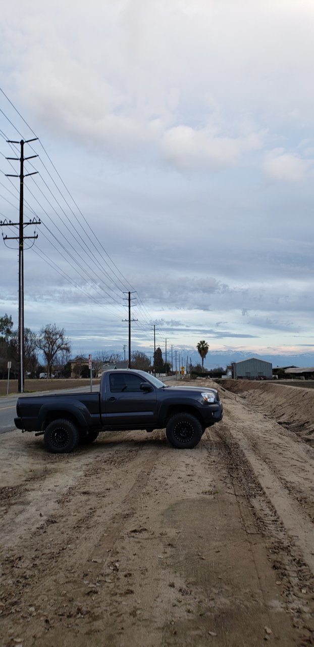

    2011 reg cab
    Toytec 3” bilsteins on 4 corners rear aal. 285/70/17 nitto trail grappler on venom Rex 17x9 -12 offset
    285 70 17 nitto trail grapps on venom Rex 17x9 with -12 offset. I think it is the offset that gives it “the look”. Even with the flares having an extra inch of coverage the tires are still a little proud of the flares. The lift is Toytec 3 front 2 inch aal in the rear.

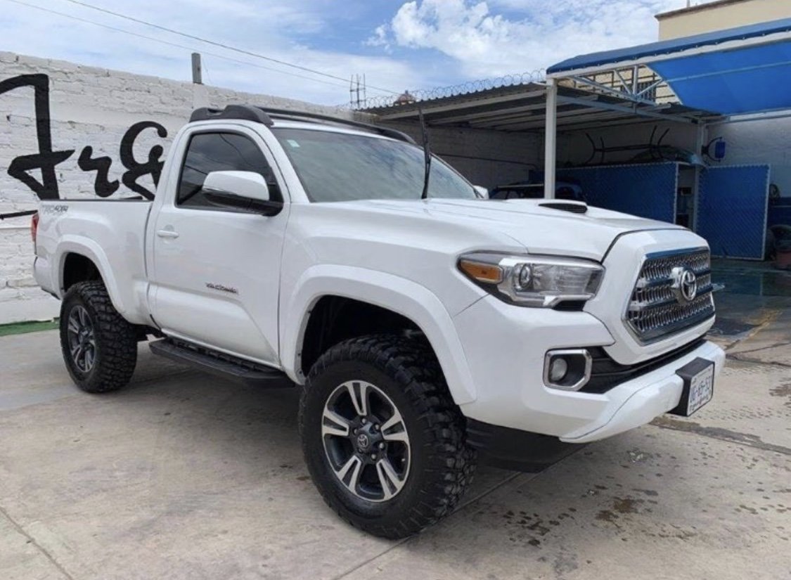

    2013 Regular Cab 4x4

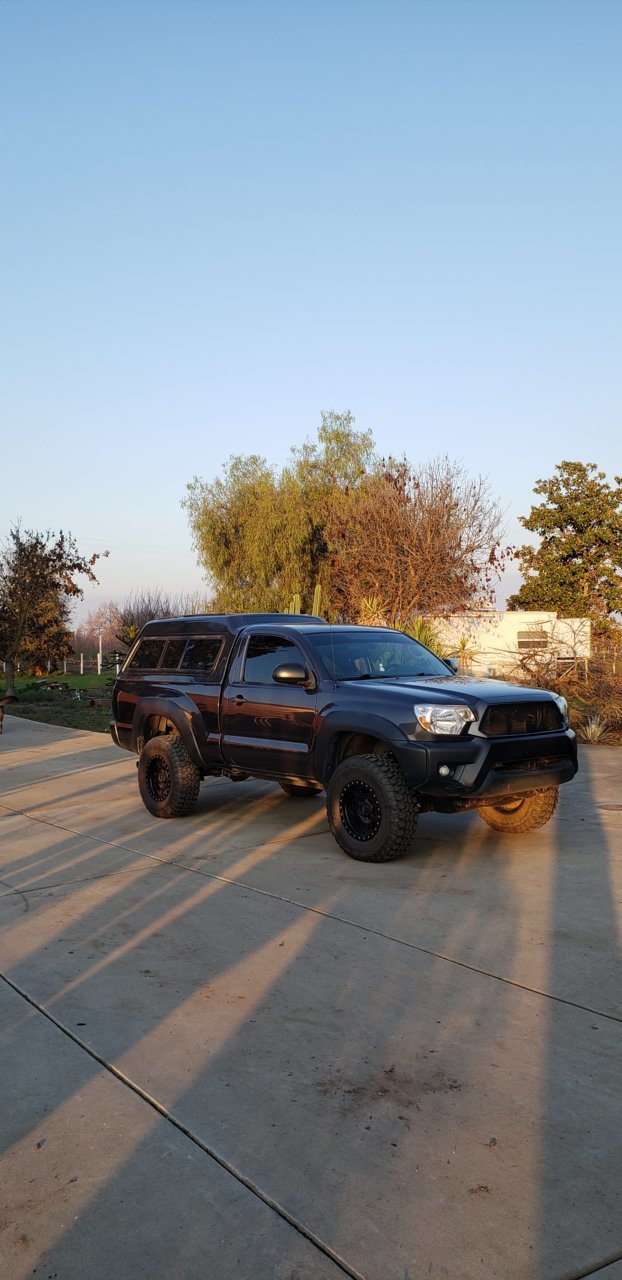

    Seattle
    2014 4x4 Regular Cab 5MT
    2" Lift & 32" tires w/ Camping Setup (see details) Suspension: Dobinson 2" Coils (PN: C59-316) 4x Bilstein 5100's (base setting) SPC Upper Control Arms Deaver J66 Leaf Springs Ride-Rite Airbags Archive Garage Hammer Hangers Poly Leaf Spring Bushing Camping: SnugTop Canopy ARB awning Built a Camping Shelf in the Bed Yakima Mega Warrior Roof Basket Interior: Bucket Seat Conversion Acoustically Insulated Interior Added Cruise Control Rear Storage Organizers Traction: Yellow Wire Mod Alloy's with 265/75/16 Towing: Aftermarket Class III Tow Hitch Trailer Wiring Brake Controller (wired, not installed) Misc: ECGS Bearing NH Oil Undercoating
    I had violent wheel hop in snow sometimes, it was awful. Ive never had my truck in sand before though so I can't comment on that. I will say however that I don't have the hopping issue now that I have a more compliant leaf pack, and I also noticed the difference on the road when taking off from a dead stop.. I feel the power transition to the wheels is more smooth than before. The garbage stock clutch plays a little nicer now.

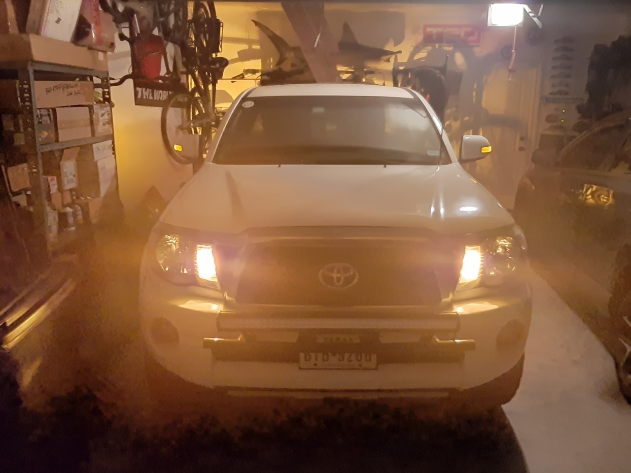

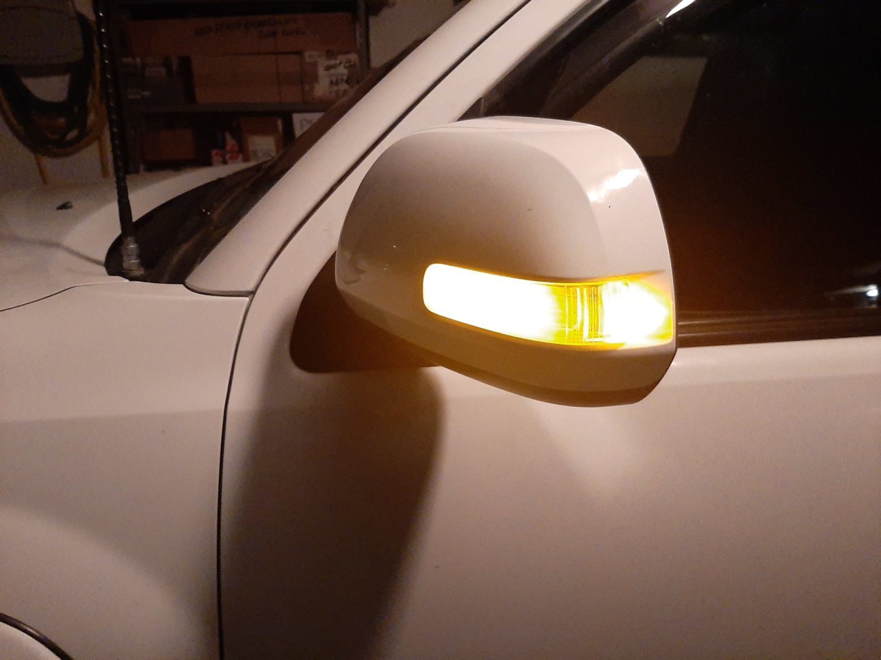

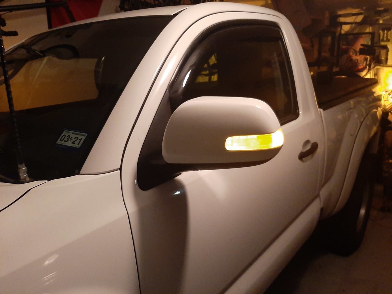

    After many years of complacency........took doors and mirrors apart and manually pigtailed and ran wiring to blinker wiring in kick panel so the blinkers on the 2012 sport side mirrors are now more than decoration. For my next trick have gone into full consideration mode to wire up the power function to the switch decorating the dash. No existing harnesses.....RC fun, lol.
