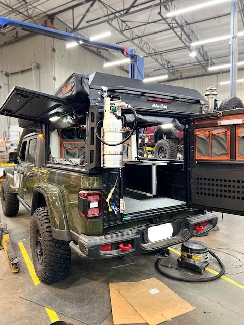

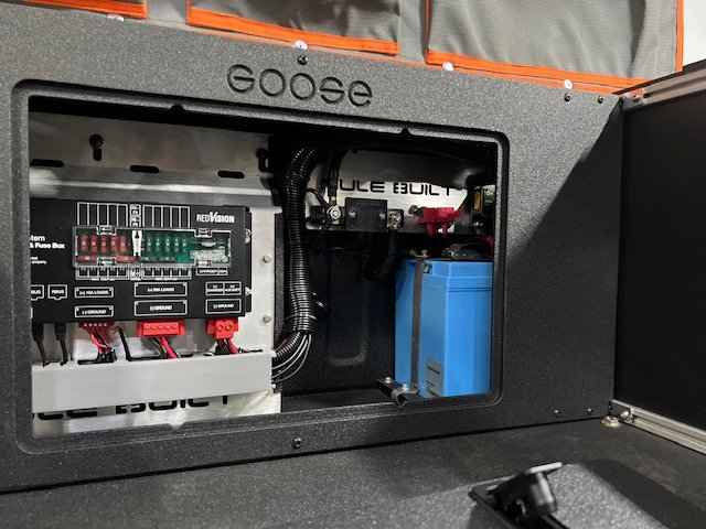

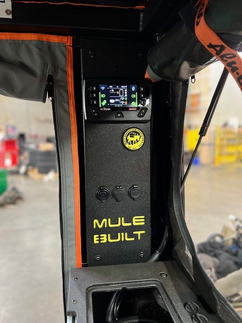

    Here Is a canopy camper we just finished up not a taco but still a nice build
    Electrical is full Redarc redvision with an inverter and a lithium battery
    Goose gear interior buildout with Dickinson heater

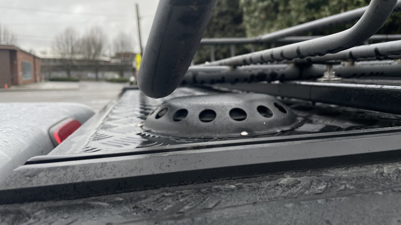

    CC6F9122-93BB-4971-9BD9-41CC33E1D917.jpg I put a marine vent in the roof of my explorer. I was wary about putting a 4” hole in the roof but no leaks and definitely helps with the heat. It does not generate positive pressure, I still have some minor dust intrusion from the usual spots.
    Overall, I’m happy with the vent and it’s close able so I can easily seal it up.
    https://www.fisheriessupply.com/vetus-denouden-ufo2-closeable-deck-ventilator/ufo2

    I LOVE THIS IDEA! the temp is always hotter towards the roof, i might be popping two of these bad boys in! one in front, one in back. Thank you
