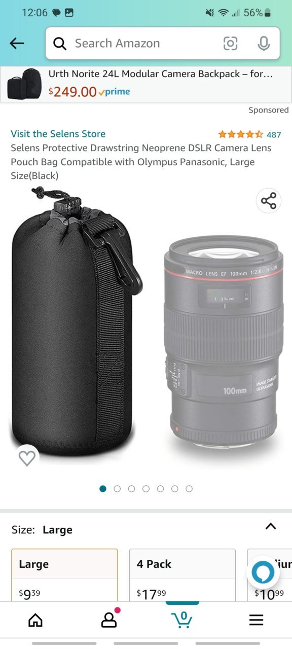

    Random tip I just discovered for anyone with a Dickerson fireplace in their canopy camper...
    A large neoprene camera lens pouch works perfectly as a cover over the fireplace exhaust to keep dust out. Game changer

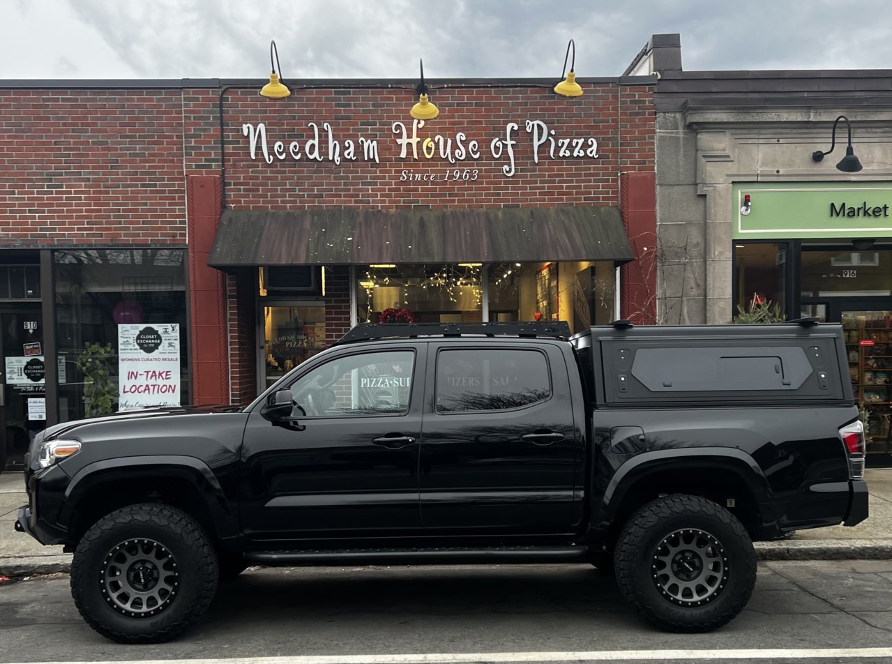

    Meso Bucket Tray
    Lovin mine so far

    @Dtax what load bars are you running on top of your Counter?

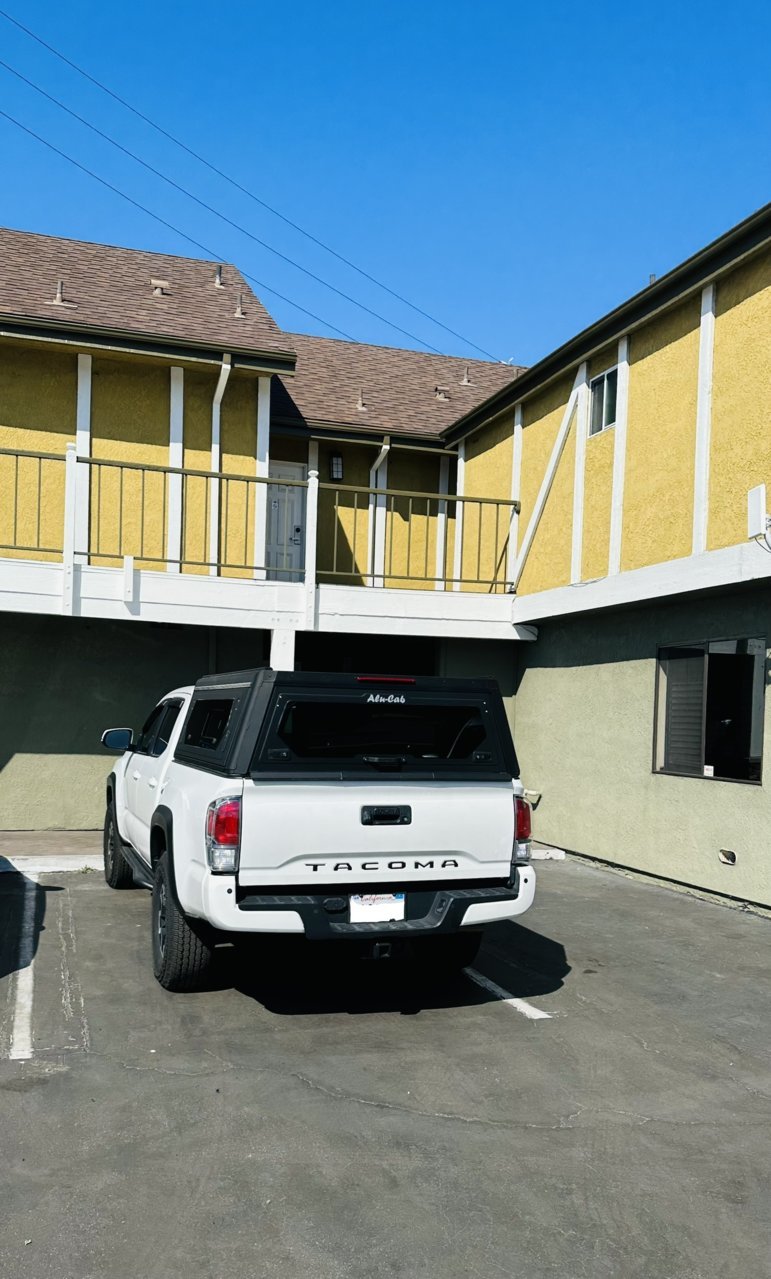

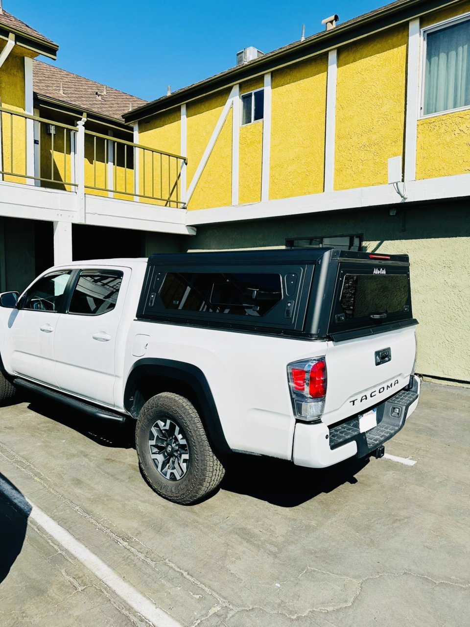

    Thanks to Tiny Rig I got mine on this past week! Can’t say enough good things about them.

    the alu cab ones, the i forget the width, but i am going to swap for the smallest ones they offer since these one overhang too much for me. I think i have the medium ones.

    You can cut the bars to size then put the plastic end caps back on. I trimmed mine to have zero overhang and there have not been any issues. Use a band saw and the coating will stay nice.

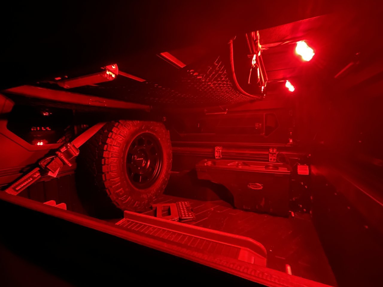

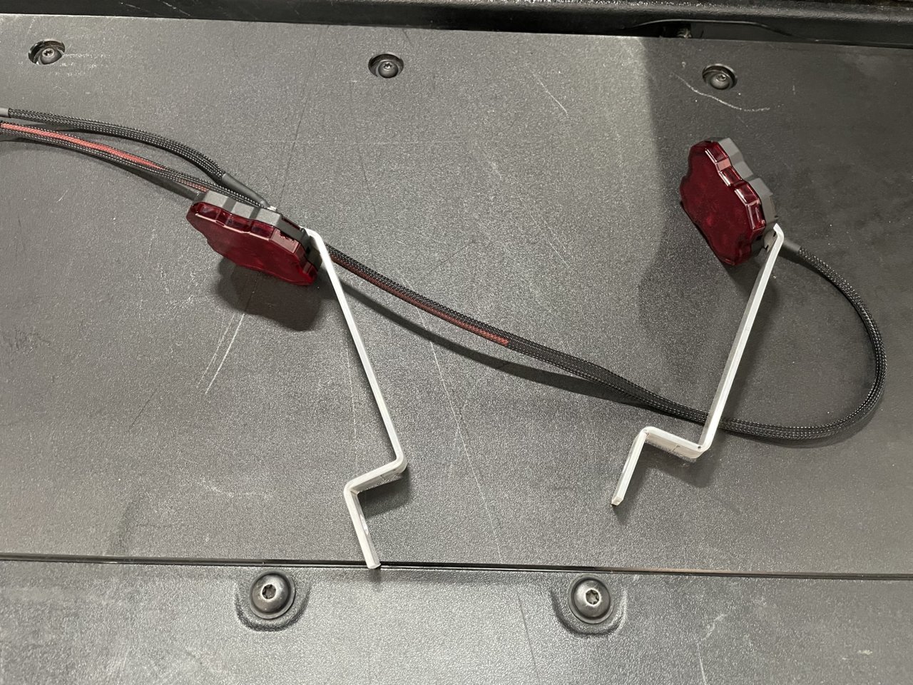

    Also, might as well cross post this. I wired all the stock Alu Cab led lights on a switch. Wanted to add some red lights for camping/night vision. Used the new Diode Dynamics rock lights as most of my truck has DD lights.
    Bent up some brackets and made the harness with shrinkflex heat shrink and techflex loom.

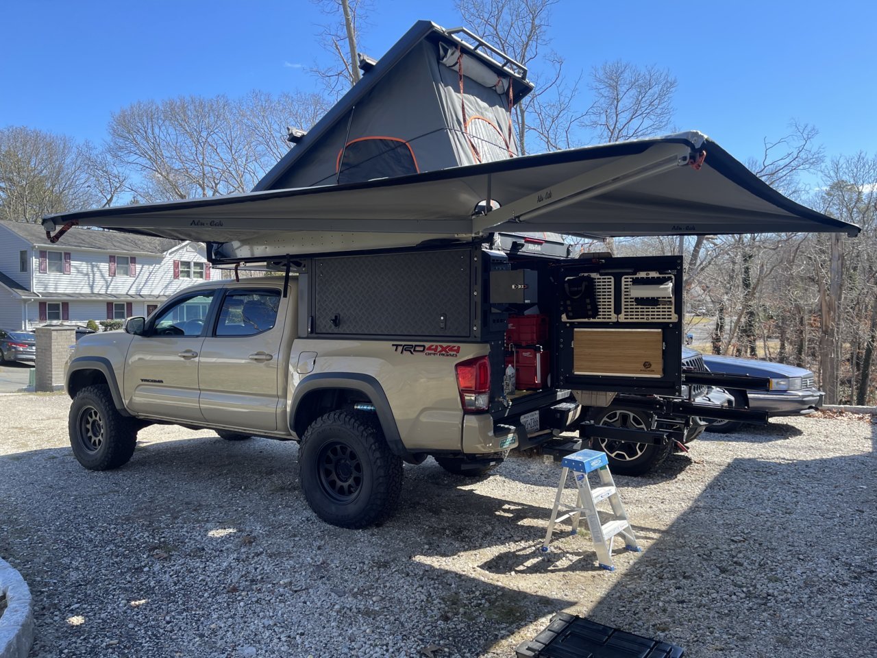

    Started some spring fine tuning today and prepping for the Dickinson install. Curious if/how anyone built out a bed/sleep platform for kids in the bottom half without going full goose gear3DE255CB-FC0F-4498-99F0-538BB893A9B8.jpg

    Nice setup.
    I didn't make a sleeping platform specifically for kids, but my storage/fridge setup could easily be used by someone who is less than 4 ft tall. Check out my build thread, linked in my sig, for ideas if you want.

    Did you swap out the standard 3rd gen bulkhead at the front of the bed with an earlier year (2dn gen?) bulkhead to have a mounting bedrail at the front of the bed? If so, where did you source that part?
