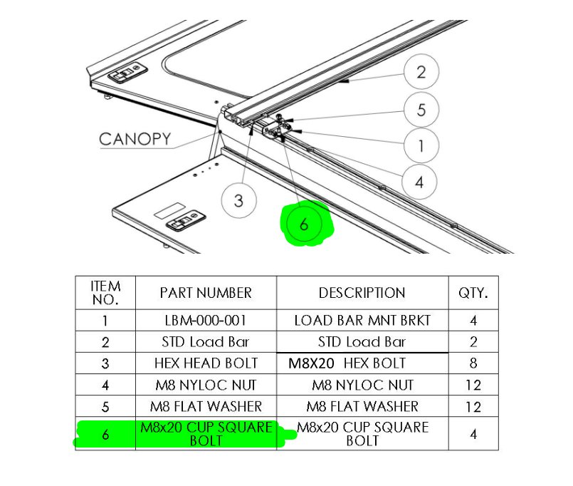

    wish I saw this yesterday. I was in alu-cabs manual where it said an M8x20 cup square bolt (its a carriage bolt with square shank) fits the rails. well I couldn't find M8x20 carriage bolts at home depot, so I bought some 1/4x20 bolts, and the carriage bolt head of those wouldn't fit. they were about 1-2mm too wide.
    also after researching. a 1/4x20 carriage bolt head is about .579in, or 14.7mm. Researching the M8x20 dimensions for the head, and all I'm getting is everything over 15.3mm. which is larger than the 1/4x20. maybe I'm stuck using hex head bolts? This is for adding load bars on top. but I think the rails are the same as inside, correct?upload_2023-3-20_15-15-3.jpg
    Not a fan of Alu-cabs instructions. AT ALL. lol

    8x20 is the length of the bolt. I'm talking about the head, like the socket size 13mm.
    Look for threads in 8x1.25, that's usually a 1/2 socket (13mm)

    M8 bolt with 13mm head (socket size) will fit the roof rails. Alu cab sends a slightly different style bolt out with their load bar feet.

    yeah I was just saying an M8x20 carriage bolt head is over 13mm. which alu-cab calls out to use in their rails, but the head is too big to fit, along with 1/4x20 carriage bolt heads, which are over 13mm too.

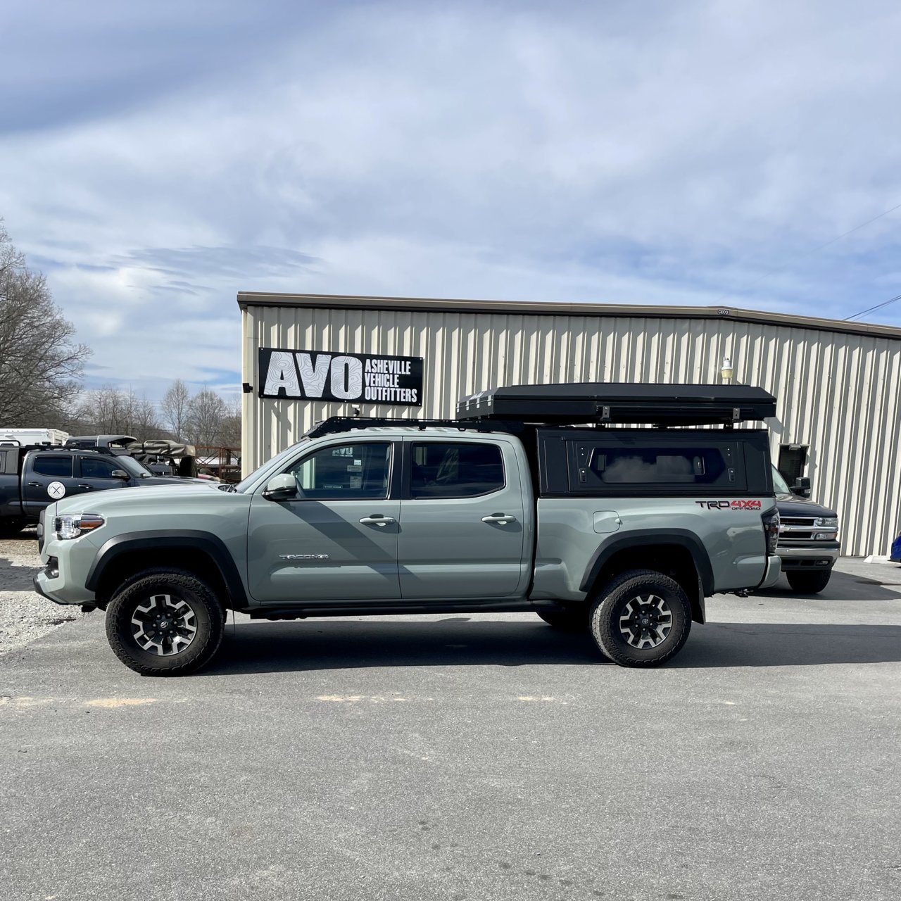

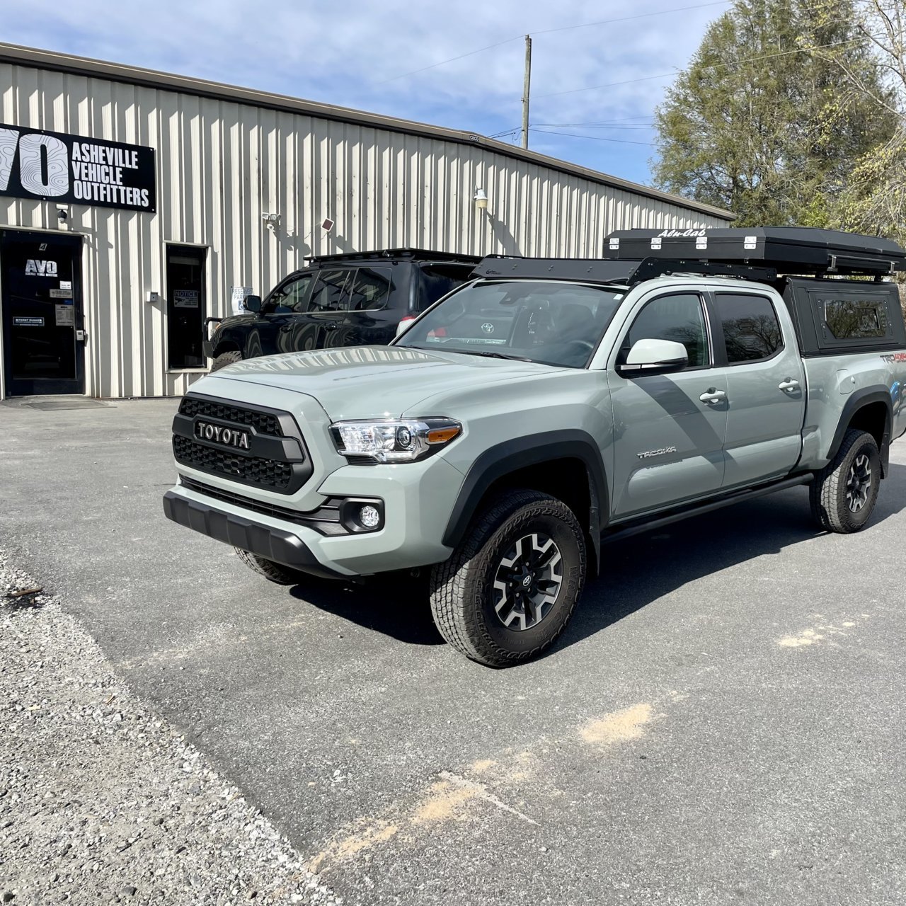

    Just picked my canopy and tent up yesterday from AVO, they did an awesome job and I’m excited to start building up and adding on to the rig.

    Well, it looks like this is the first LB Contour I've seen posted. It looks better with the window centered on the new version.

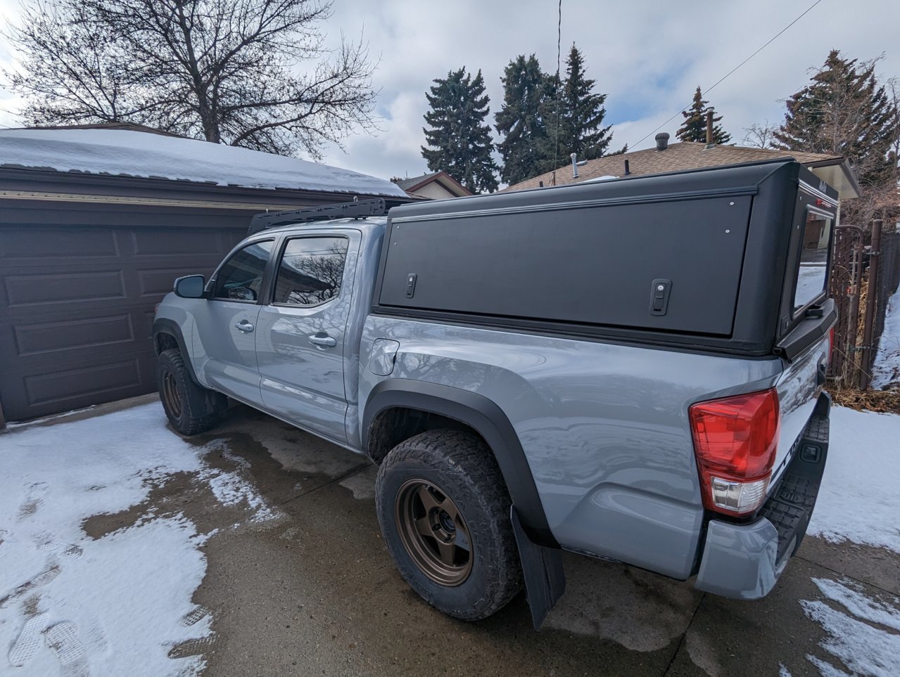

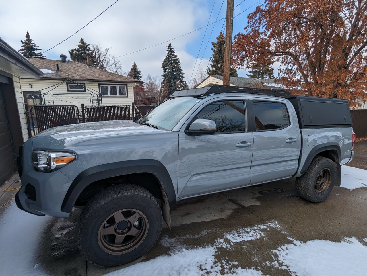

    She looks like a mobile BBQ/smoker now.....
    And I think that makes me like it even more.
