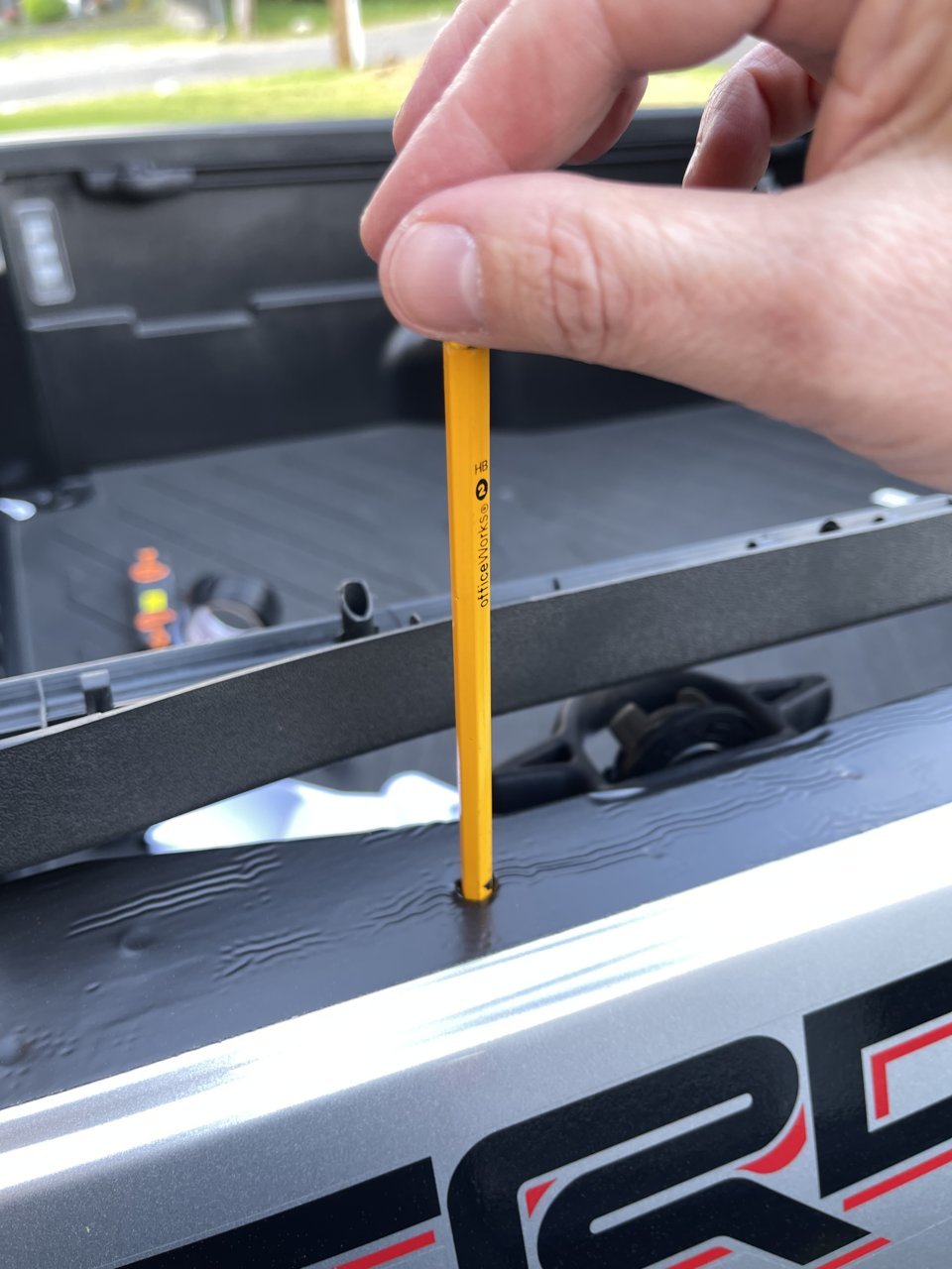

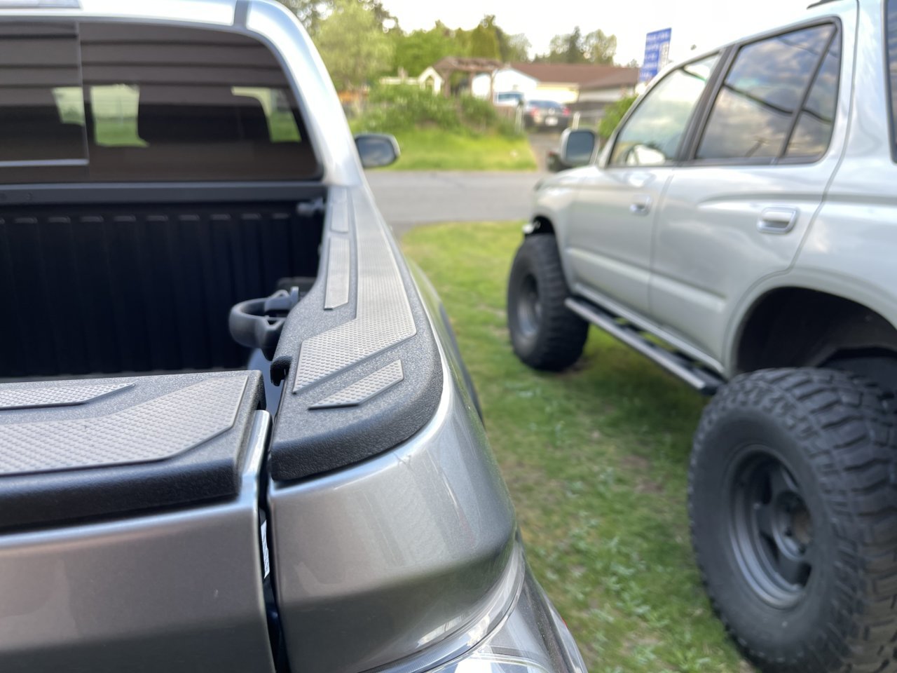

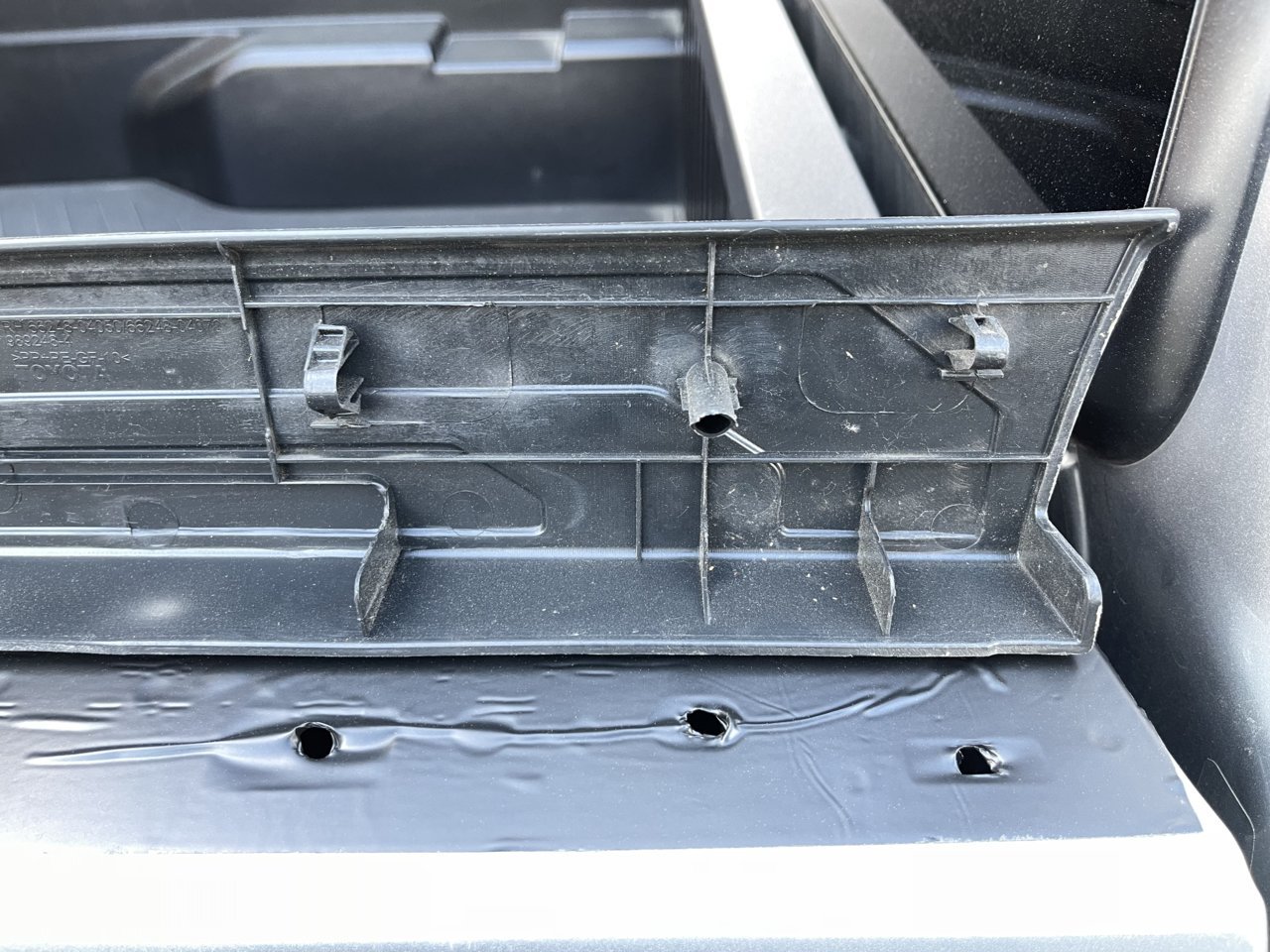

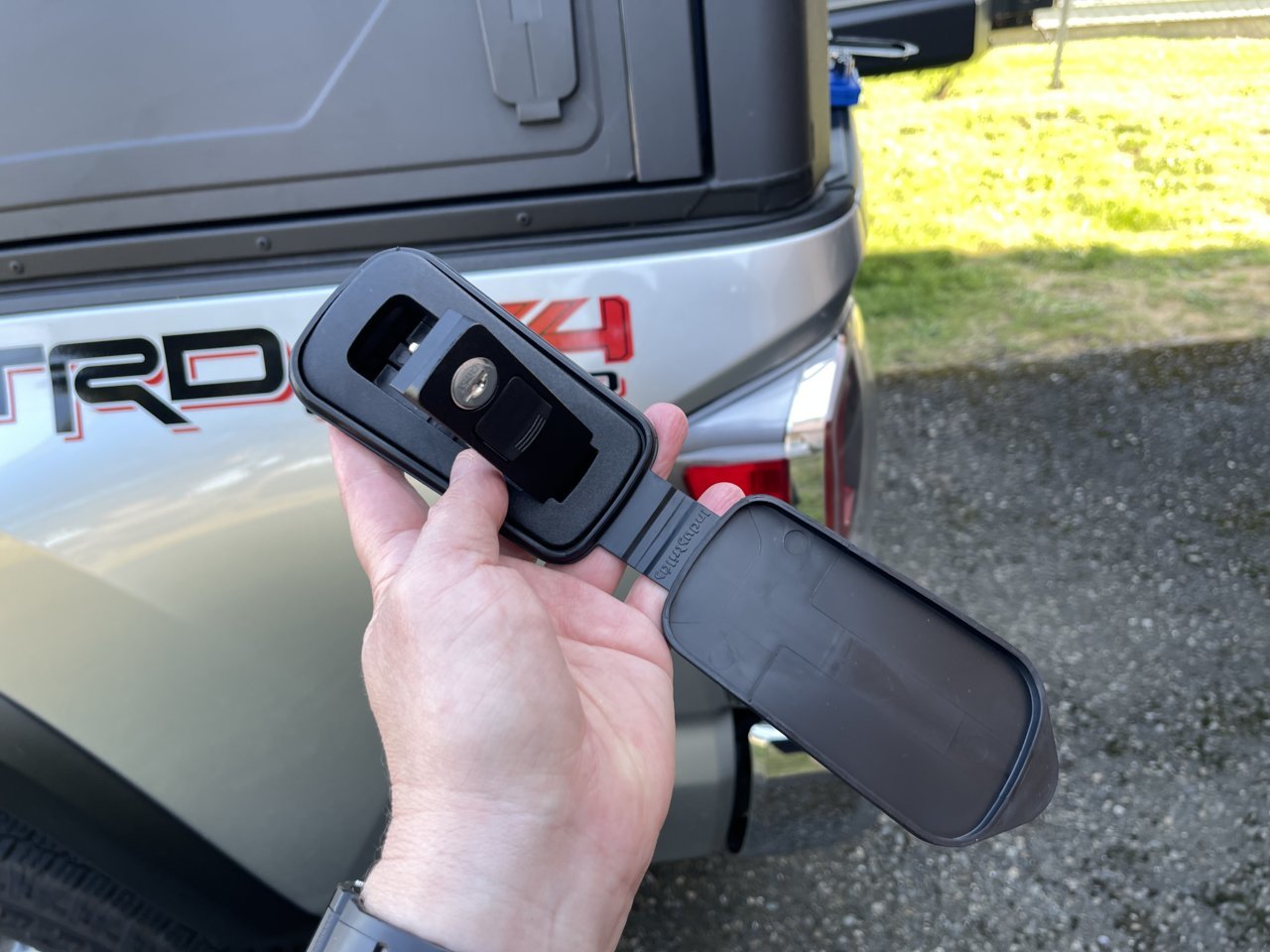

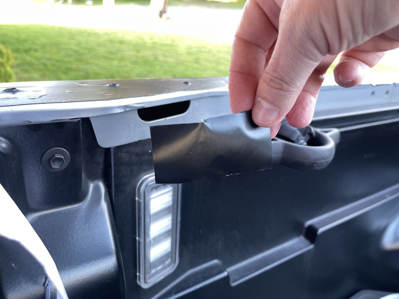

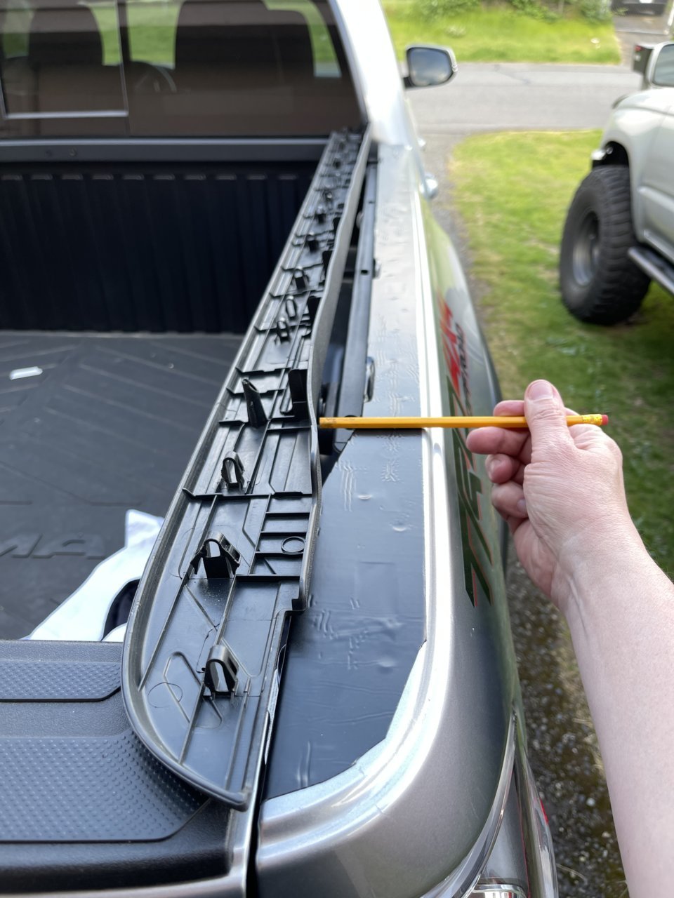

    Congrats on your selection! Realistically, I don’t plan to keep much in the back that would attract a lot of interest. I might revisit this a little bit down the road, depending upon if that changes or not. Thanks for the link!
    Congrats! I would have gone with self install if I knew I had another friend that could come down during a weekday to come pick it up. The place I purchased it through in Washington is not open on the weekends for some reason.
    I would say that prepping the top of the bed rails is dummy simple. Even I managed this one. LOL. The caps pop off with a little force. I then wiped down the surface a bit to clean it up. Then I ran some Nashua Aqua Tape (thin black rubber-type tape). I then used a pencil to make small pilot holes that were just big enough for the plastic tabs to seal around. Besides the holes on top of the rails, there are two large rectangular holes on the inside of the bed, facing the interior, that are located next to the tailgate. I sealed those up too. But that’s about it.
    I did attempt to seal up the leading bedside to bulkhead gaps with butyl tape. Ultimately, this interfered with installation and was removed/replaced with their sealant. It would be easy enough to fill whatever voids are left over post installation I would believe. I just wanted to focus on items that would be difficult to revisit once the canopy was installed. So far so good.
    One other thing. If you plan on traveling in cold snowy/freezing climates, pick up the optional silicone covers ($12/cover). IMG_1446.jpgIMG_1448.jpgIMG_1450.jpgIMG_1436.jpgIMG_1451.jpgIMG_1546.jpgIMG_1520.jpg

    Taking the bed side caps off doesn't seem too difficult. I'll try that myself since I have to remove the tonneau cover clip bolt things anyway.
    Those pictures are very helpful too, thanks

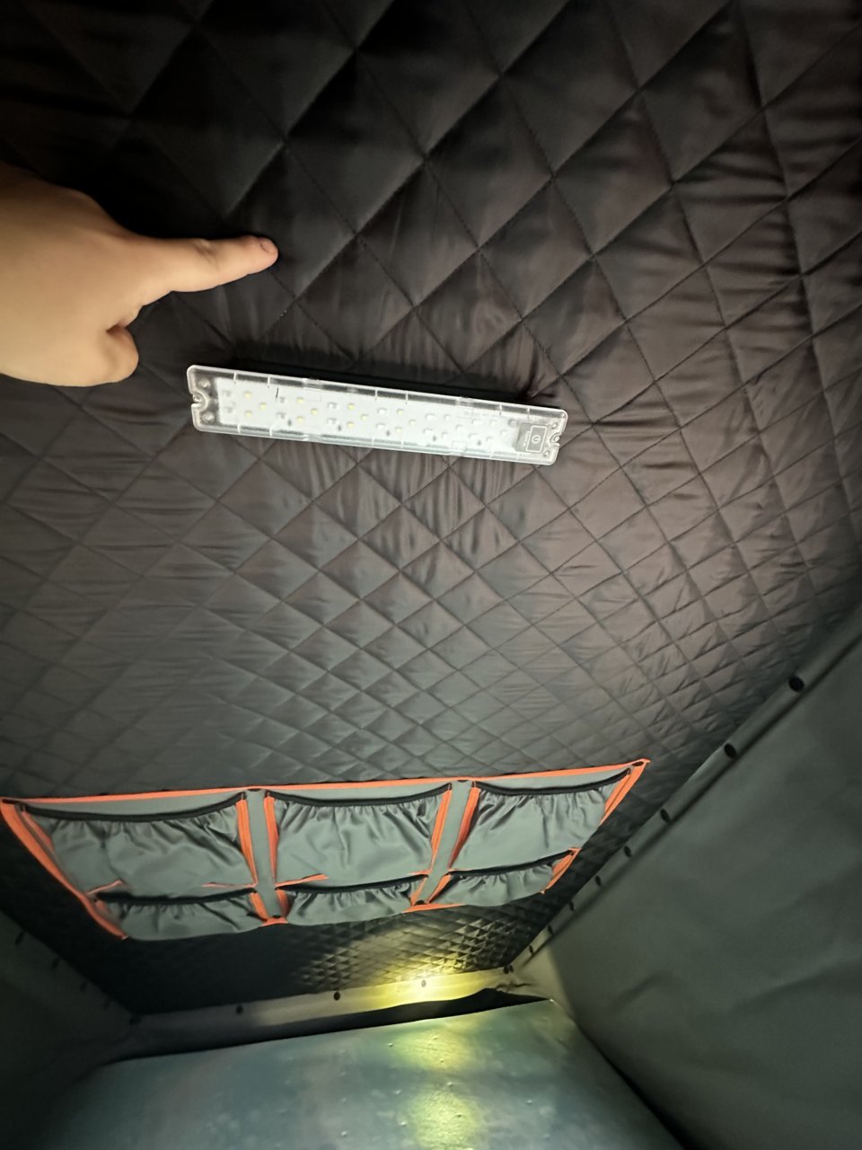

    Got a sirocco fan to install in the bed area. I wanna rivet it in like the light up here but can’t find concrete evidence if it’s double walled or not. Hoping someone here has experience before I start drilling. Planning on using my magnetic cable routing tool from my mountain bike to help run the wires to the side like the light is. Any input helps thanks in advance

    I don't have any input, but please relay back what you find out about the ceiling/roof of the tent. I haven't punctured mine yet, but it would be nice to know how it is constructed.

    Hate to be the first one haha. Im deep in google currently praying for an answer
