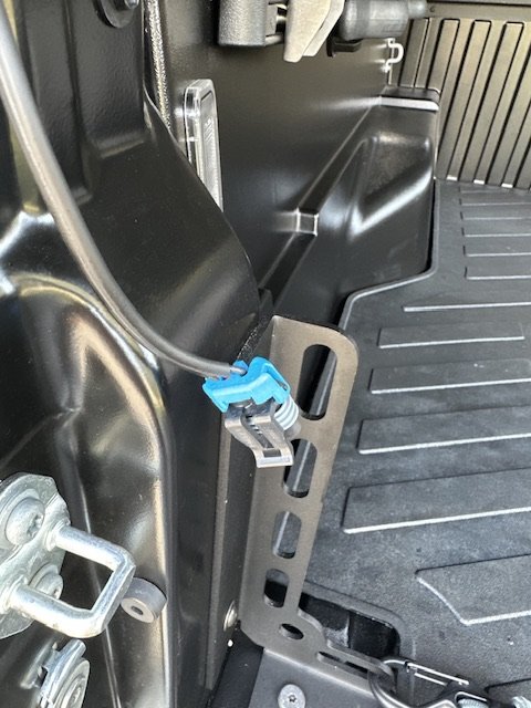

    1. I used a generic auxiliary light adapter harness off Amazon. Popped out the cubby, attached it to the back (inside the fender well) with a hole and some zip ties, grounded to the frame, and ran the power through the truck up to the battery.

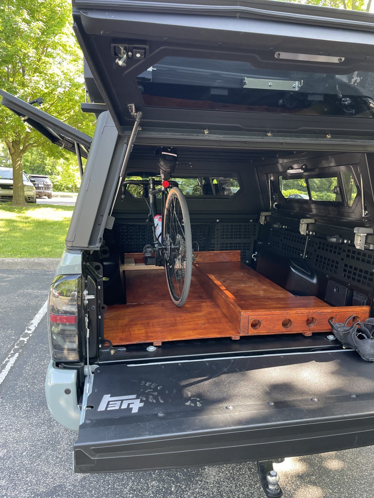

    Still planning on adding a solar setup, panels on the RRT and controller, inverter, and batteries in the bed. The wood setup is lightweight and 2 pieces, can be just the platform or both together or both taken out. Still trying to figure out how to open the contour canopy from inside if the bed and top are closed. But everything’s working great driving from Ohio to California with a total weight of 10700 trailer and truck…mpg leaves something to be desired in the Rockies and Sierra Nevad Mtns though
