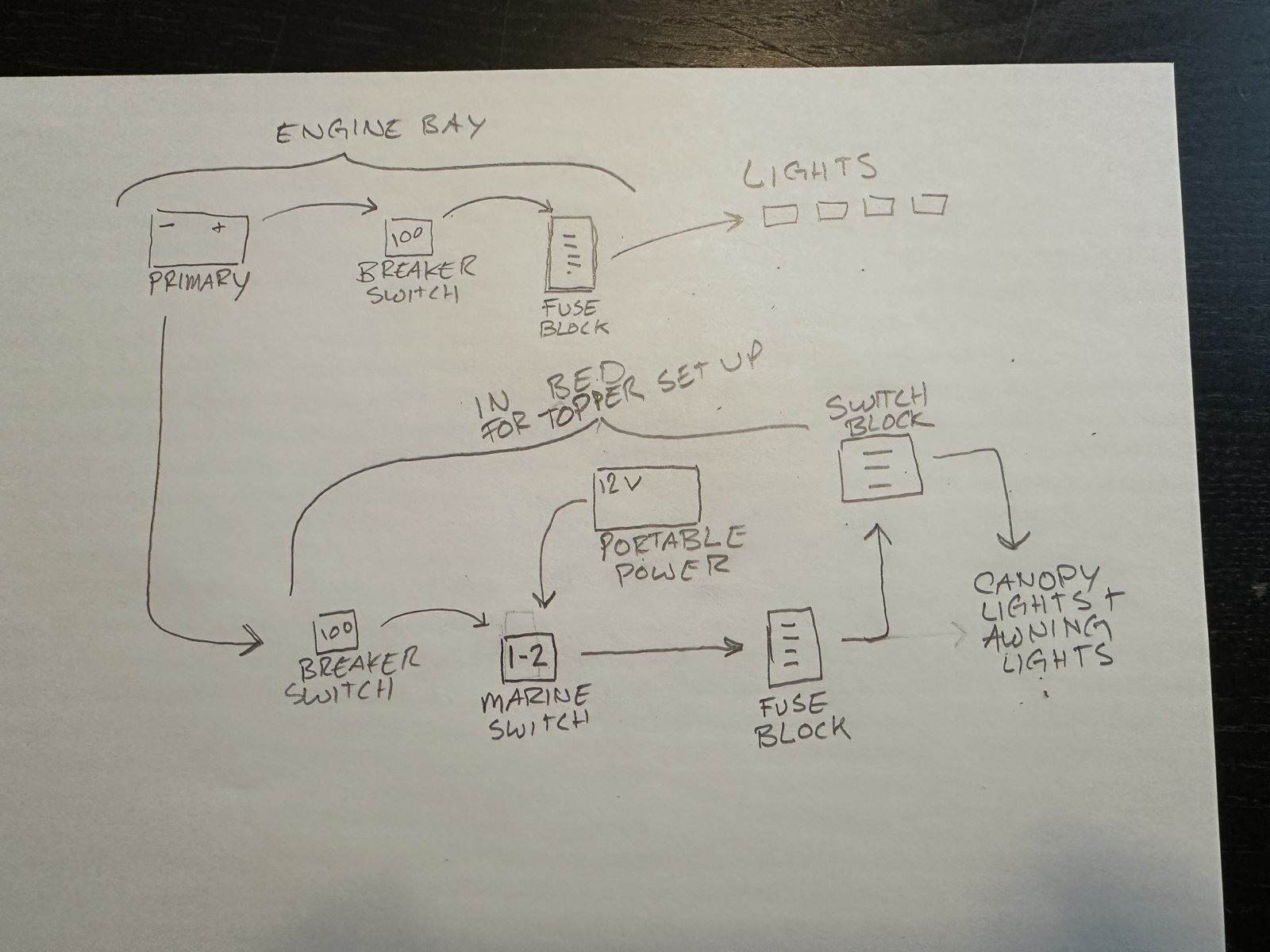

    In the meantime , I have also been looking at all the wiring people have done… and it impressive to say the least. I’ve done an amp switch , fuse block and such up front for clean wiring. im trying to figure out a way to send power back to the bed, and build a little set up so I can run the topper lights and awning lights off of the primary, OR off of a Jackery /portable power set up. Was curious if using a heavy duty three way switch like the marine 1 or 2 source switch would work .
    something like this quick sketch

    That's a good start, though without knowing where you want to go I can't speak more accurately.
    I would personally stress spending some time thinking about what you want to power currently, and then thinking about what you may want to add, and are likely to add, in the future. Take that and work to fine tune your desired setup.
    If you are simply trying to power things like a USB charger for phones, tablets, etc., the canopy lights (I am assuming they are the same as the Canopy Camper), and some awning lights, a portable device like Ecoflow or Jackary will do everything you need, without the need to tie into your starter battery. Also remember that your starter battery is designed to deliver loads of current really quickly, not to deliver low bits of current for a long time.
    If you want anything more than my guess above, you need to strongly consider a house battery and all that comes with that.

    Good point . I switching over from Leitner rack with RTT and my set up is pretty simple . But I’ll try to figure what down road may want to use
    Thanks again for the help !

    When I went from a bedrack and RTT to an enclosed space my electrical desires increased greatly. Being enclosed is a game changer.

    I cannot speak to living out of mine, but for wkd warrior type stuff, a 120AH house battery with Redarc charging while driving has been all we literally have ever needed. To the point where I honestly haven't splurged for a solar panel. Phone/device charging, large fridge, normal lighting...We can usually sit for 3 days straight and not even thinking about needing a charge up. We are not running inverters & laptops, etc. but for normal operation and camping needs, this simple set up has been great and we never tax the starter battery. If I had decent solar panel, I could sit in the same spot endlessly as long as there was sun.

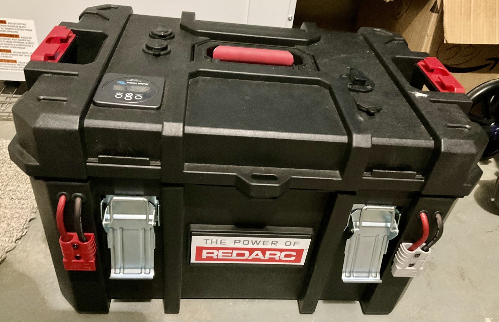

    2021 TacomaTRD Pro

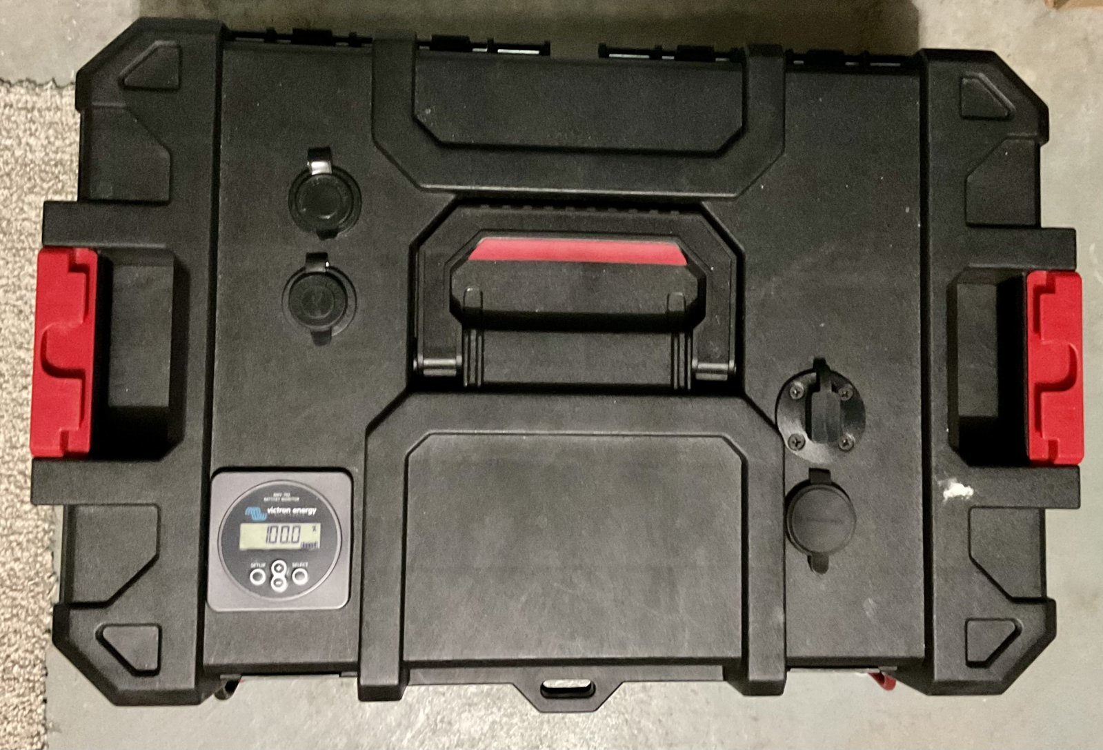

    Like this?
    cbouch001, jasonvt and TacoTrigger16 like this.

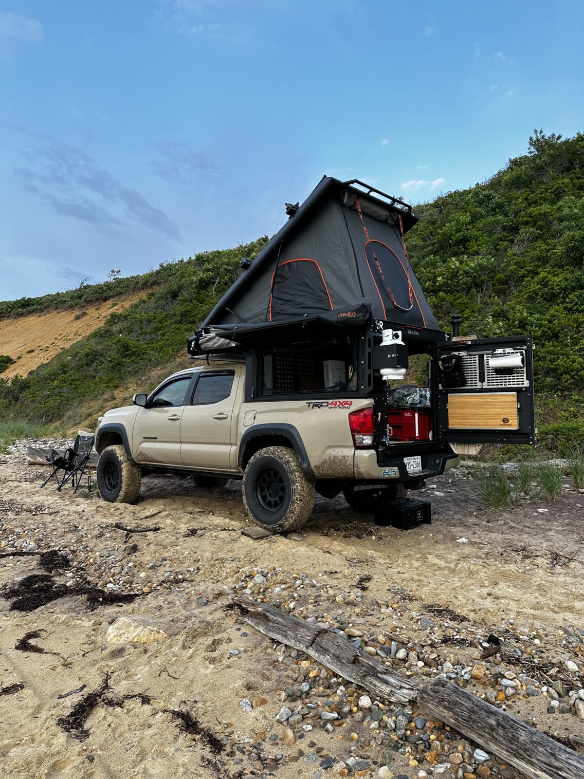

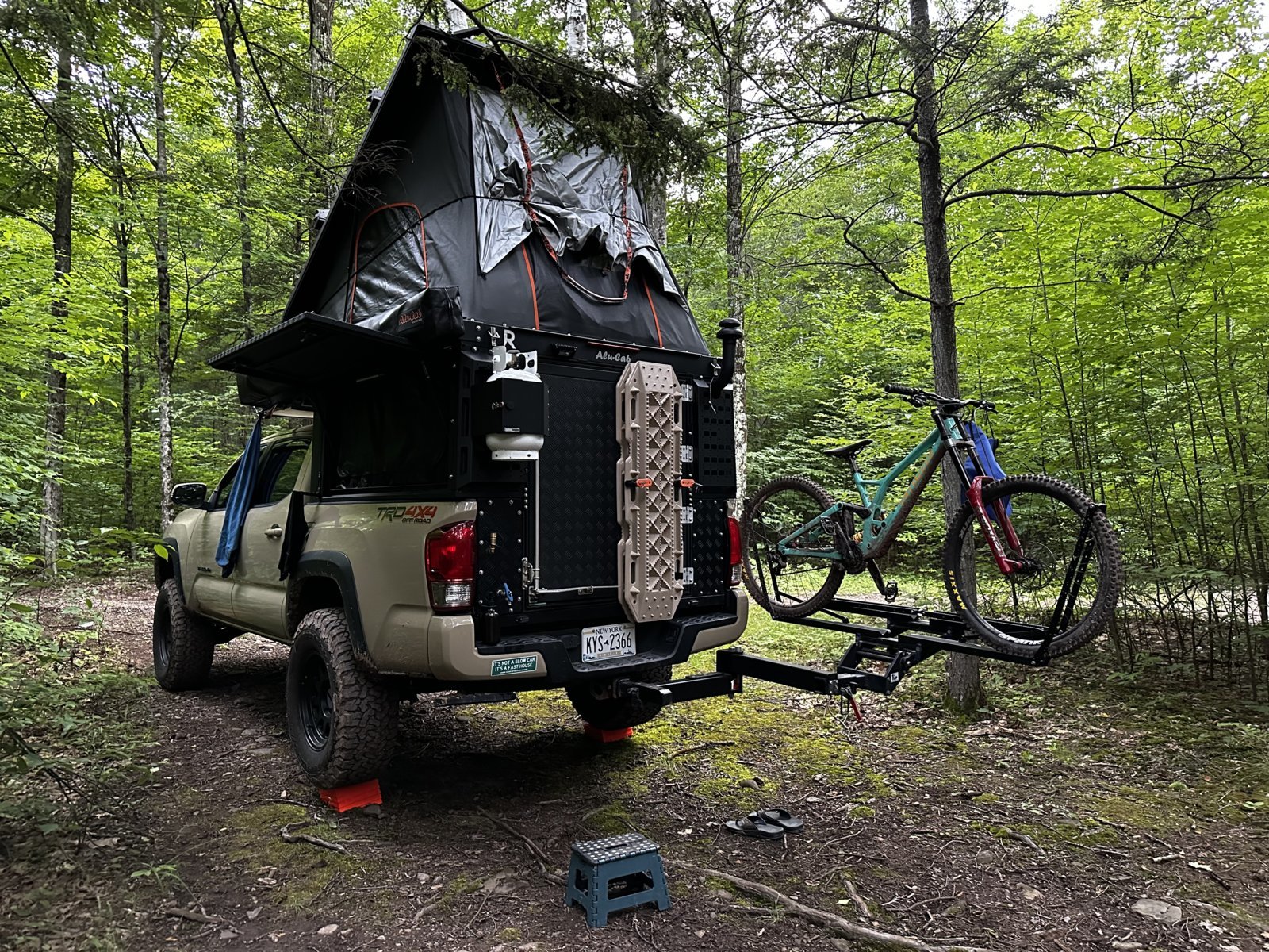

    2017 Double Cab TRD Off Road Quicksand
    just gotta squeeze a roam 95L on the roof and then I think finally finished
    Fipps, TS4x4, TacoTrigger16 and 4 others like this.

    ok, please tell how you got your chimney to be black. And then, why wouldn't you paint your gas bottle black too?
  14. Dec 6, 2023 at 7:04 PM
    #1014
    Tac0Joe
    Tac0Joe Well-Known Member
    May 27, 2017
    #220051
    251
    Joe
    Had them cerakoted before assembly. And with my luck I’ll run out of propane in the middle of nowhere with 1 place that fills tanks and they’ll tell me no because it’s painted lol
