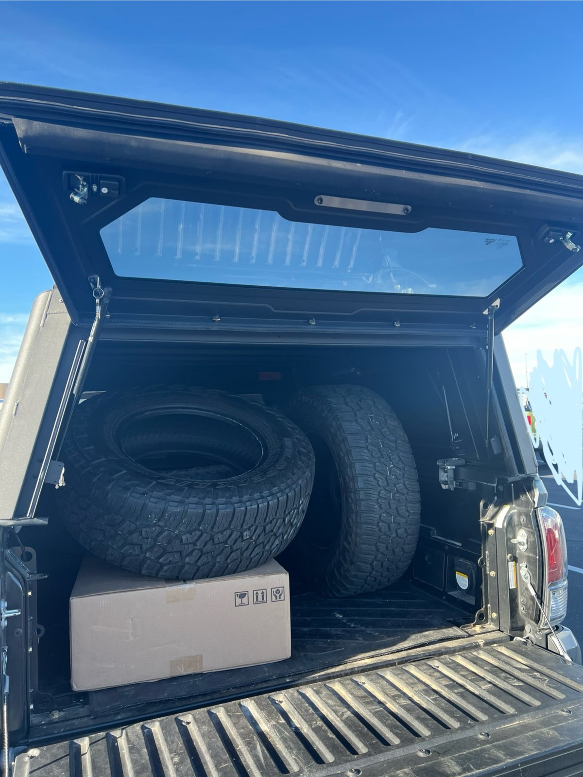

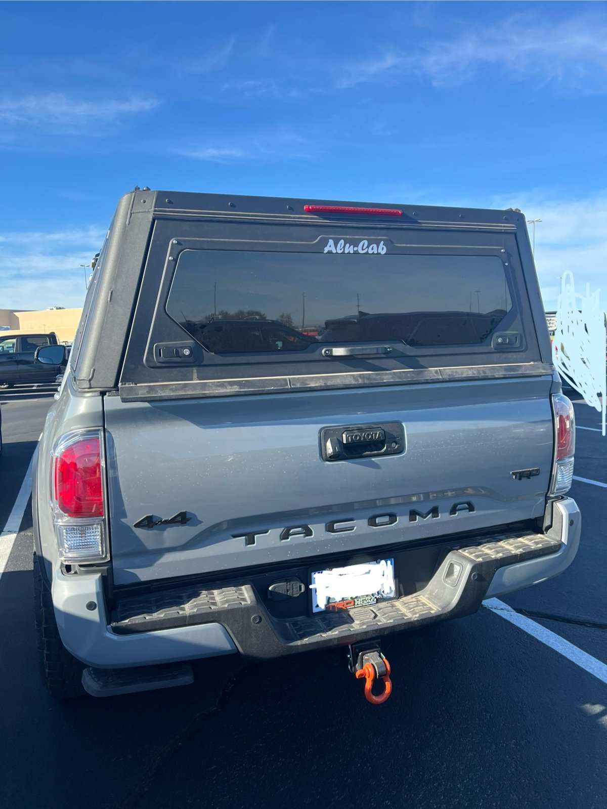

    Got it on last Wednesday, pretty easy getting the canopy on. Installing the brackets were a little confusing based on the unrevised instructions you are given.

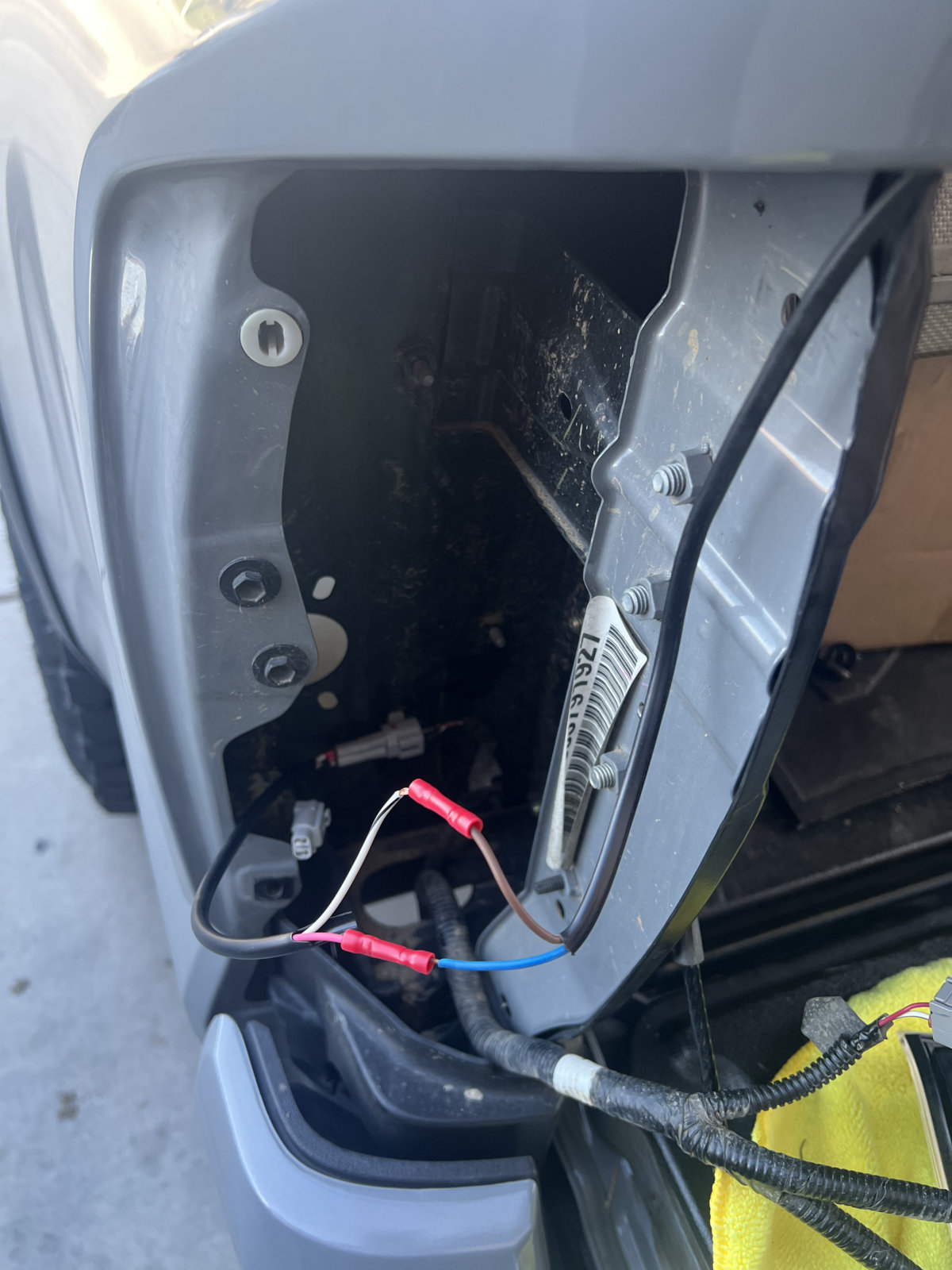

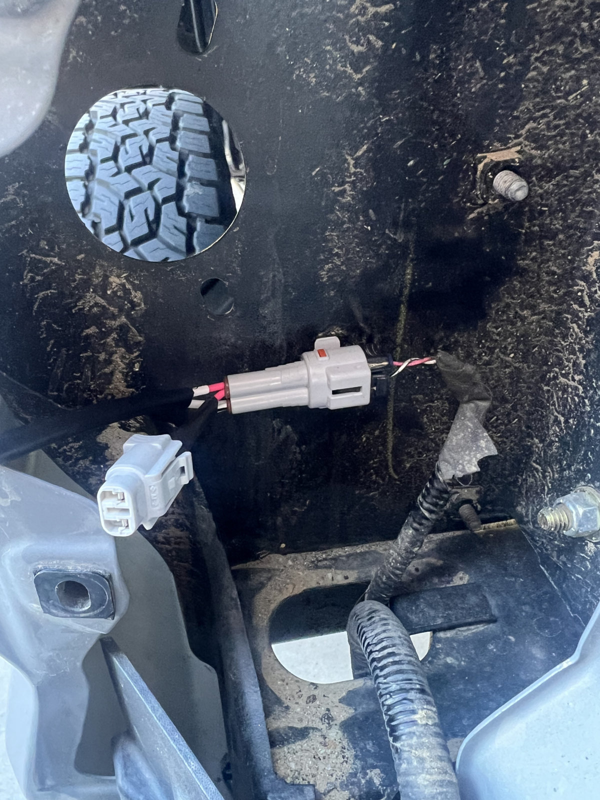

    installed the FBC 3rd brake light with parking light harness on the passenger side rear brake light and keep getting a “brake and gas depressed at same time” notification on the dash. . Tried splicing and using the 3 way connectors and its still shorting.
    I unplugged the harness and i’ll troubleshoot it later.
    Took it camping over the weekend but didn’t get any action shots, here it is at the parking lot at work.
    i’ll follow up with the troubleshooting and the installation of the add-ons i have waiting at home.

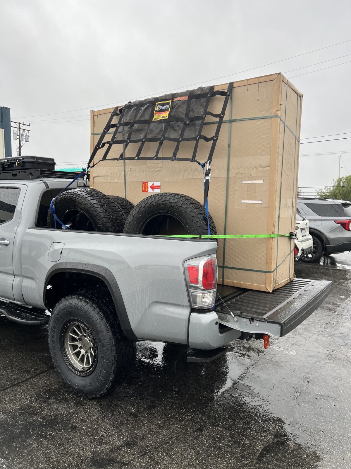

    no damage from your box falling apart during your drive?
  4. Feb 13, 2024 at 9:20 AM
    #1124
    Thunderball
    Thunderball Well-Known Member
    Jun 3, 2022
    #398636
    84
    Oh So Cal
    21 ORP LB SEMENT 06 PRENUTRUNNER
    Haha nope, no damage. i flipped it up and down on the grass to inspect and all struts, panels, welds, edges, and everything looked uniform.
    i will be power washing it this week to see how good of a job i did sealing the seams and bulkheads, see if any water intrudes

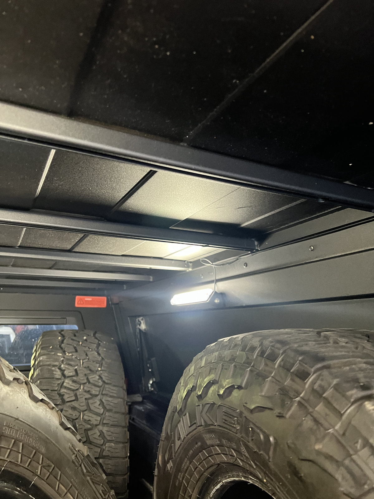

    I installed the FBC Bed Light T Harness. Easy installIMG_5618.HEIC.jpg IMG_5616.HEIC.jpg IMG_5631.HEIC.jpg

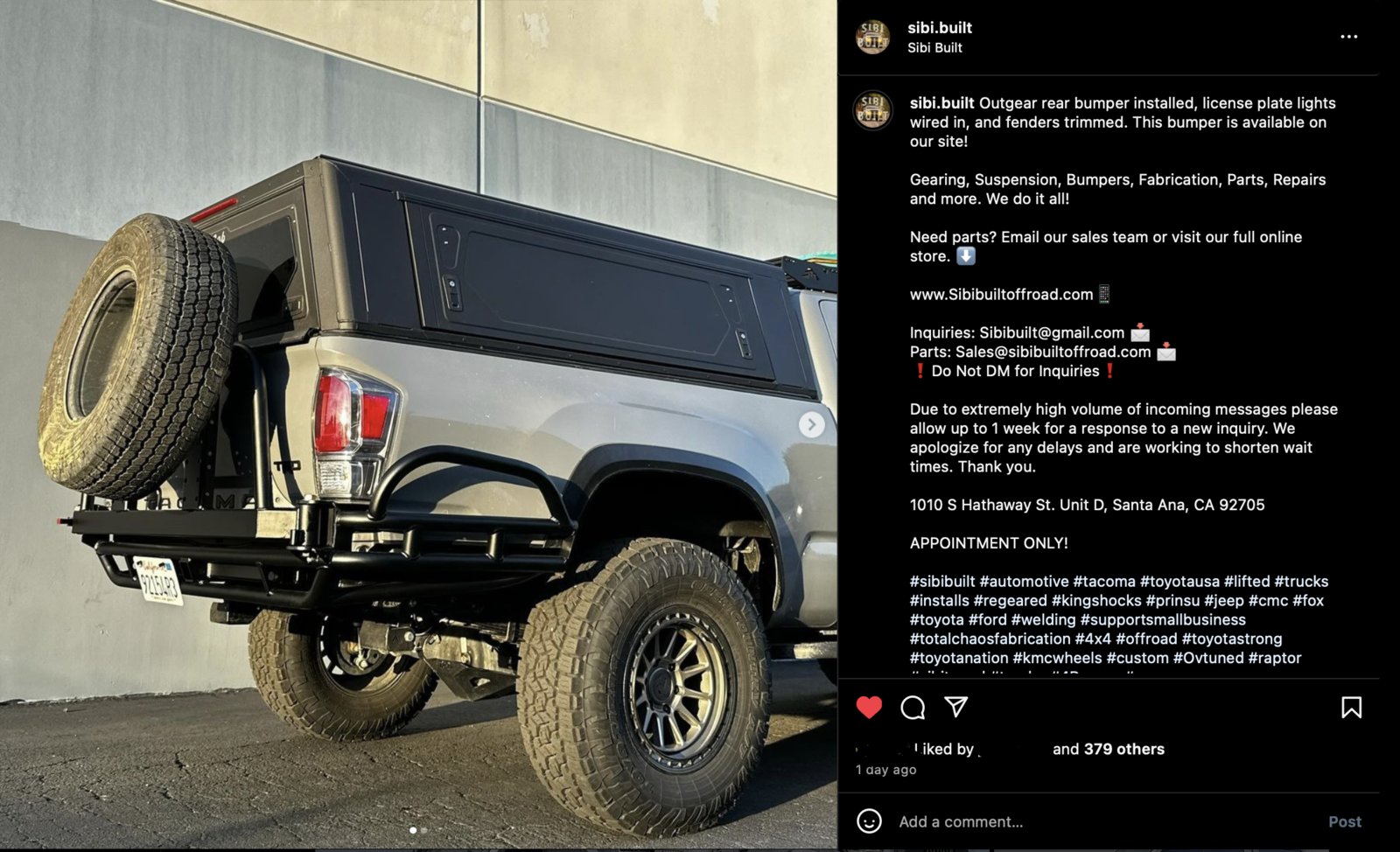

    Thank you! You're going to loves yours. Here's the truck featured on Sibi Built's instagram...
    Screenshot 2024-02-19 at 9.52.30 PM.png Screenshot 2024-02-19 at 9.52.43 PM.png
    Note that Sibi Built are not the vendor that allocated me the canopy.

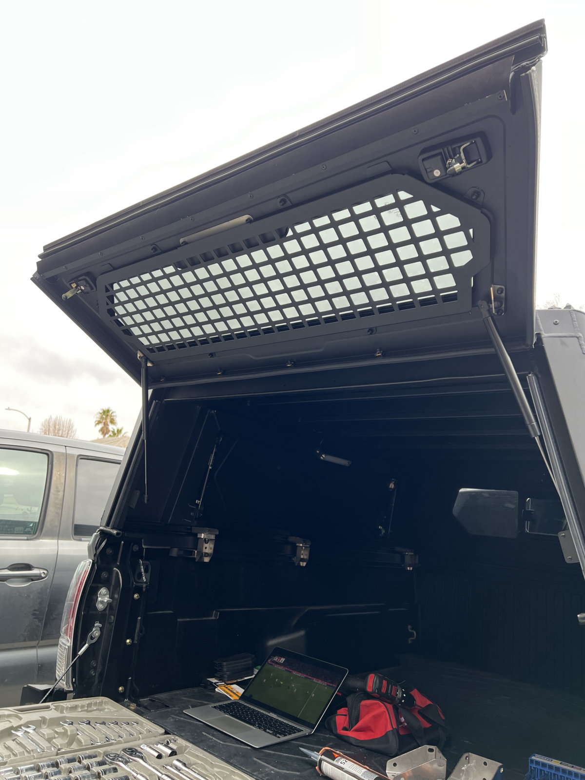

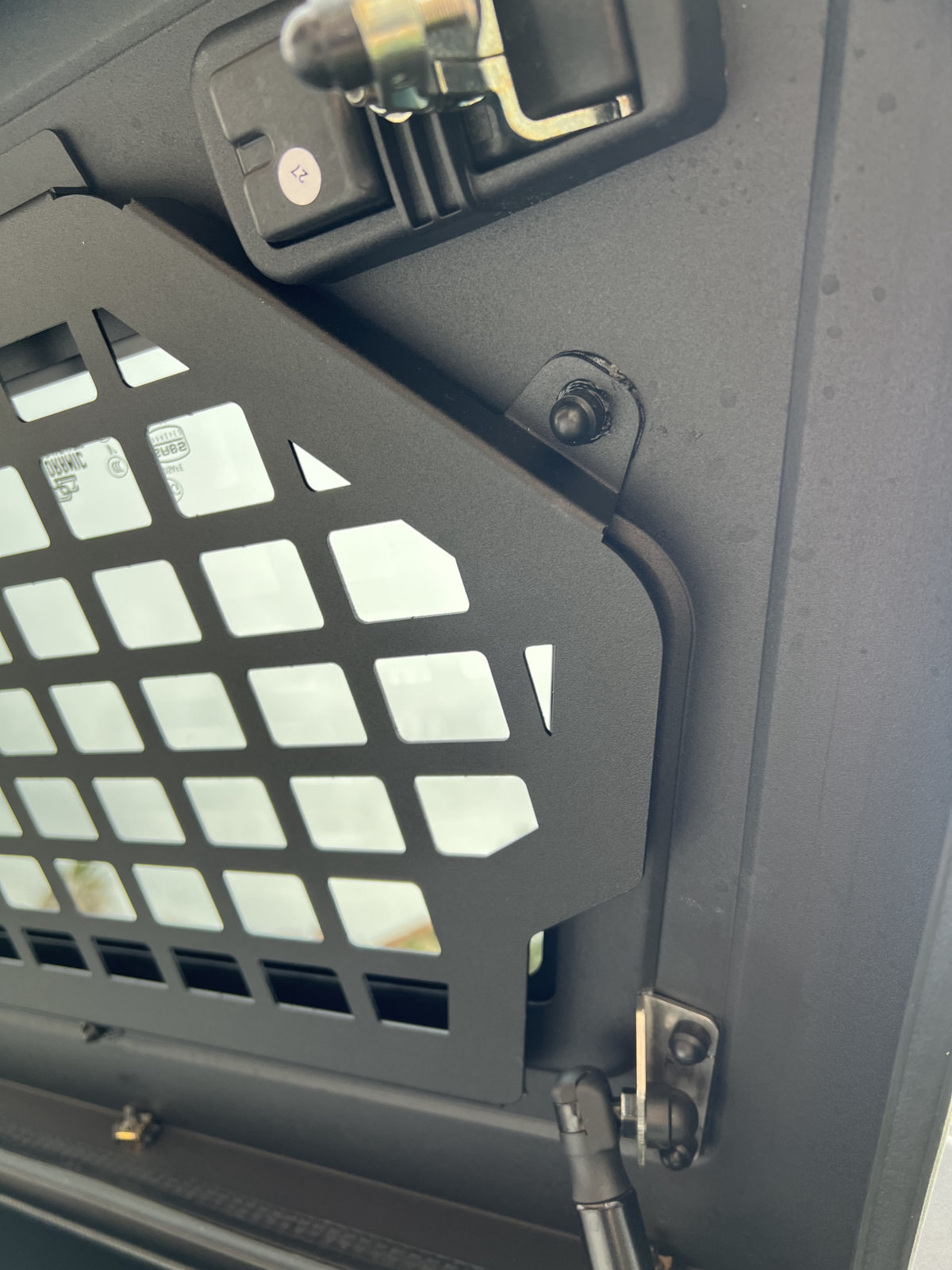

    I installed the rear Contour Security Window Grid and latch covers,
    The instructions aren't outdated like most of Alu-Cabs install instructions.

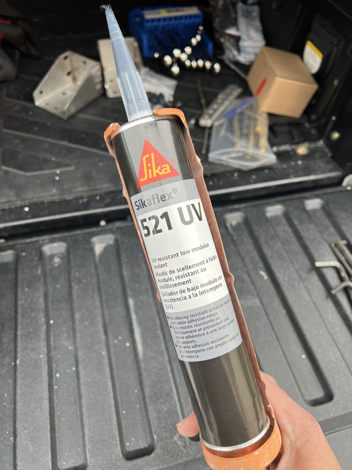

    They recommend SIKA 521UV to be used for sealing the fasteners.
    I will be installing the 270 Shadow Awning for the RHS as soon I get the mounting feet for the load bars.
    I'll upload some pics on how that goes!

    Did you adjust the locks at all after putting the covers on? Mine felt a little tighter, but honestly I haven't been back there since I installed the covers
  20. Feb 26, 2024 at 2:35 PM
    #1140
    Thunderball
    Jun 3, 2022
    #398636
    84
    Oh So Cal
    Nope, but they do feel tighter. It's probably the seal from the covers.
