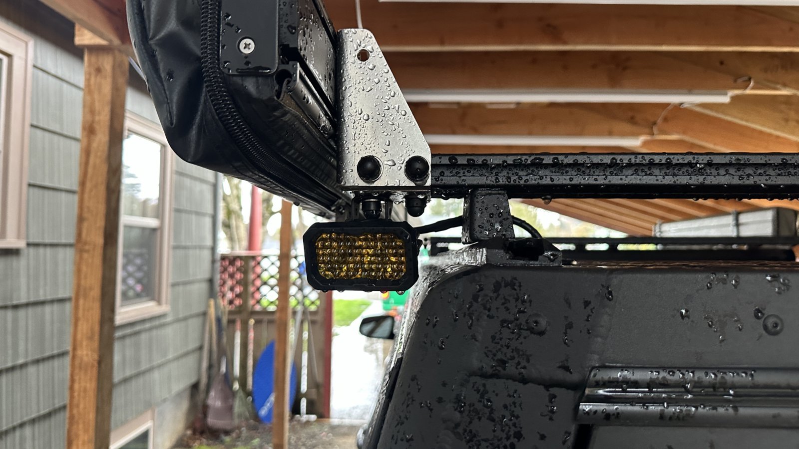

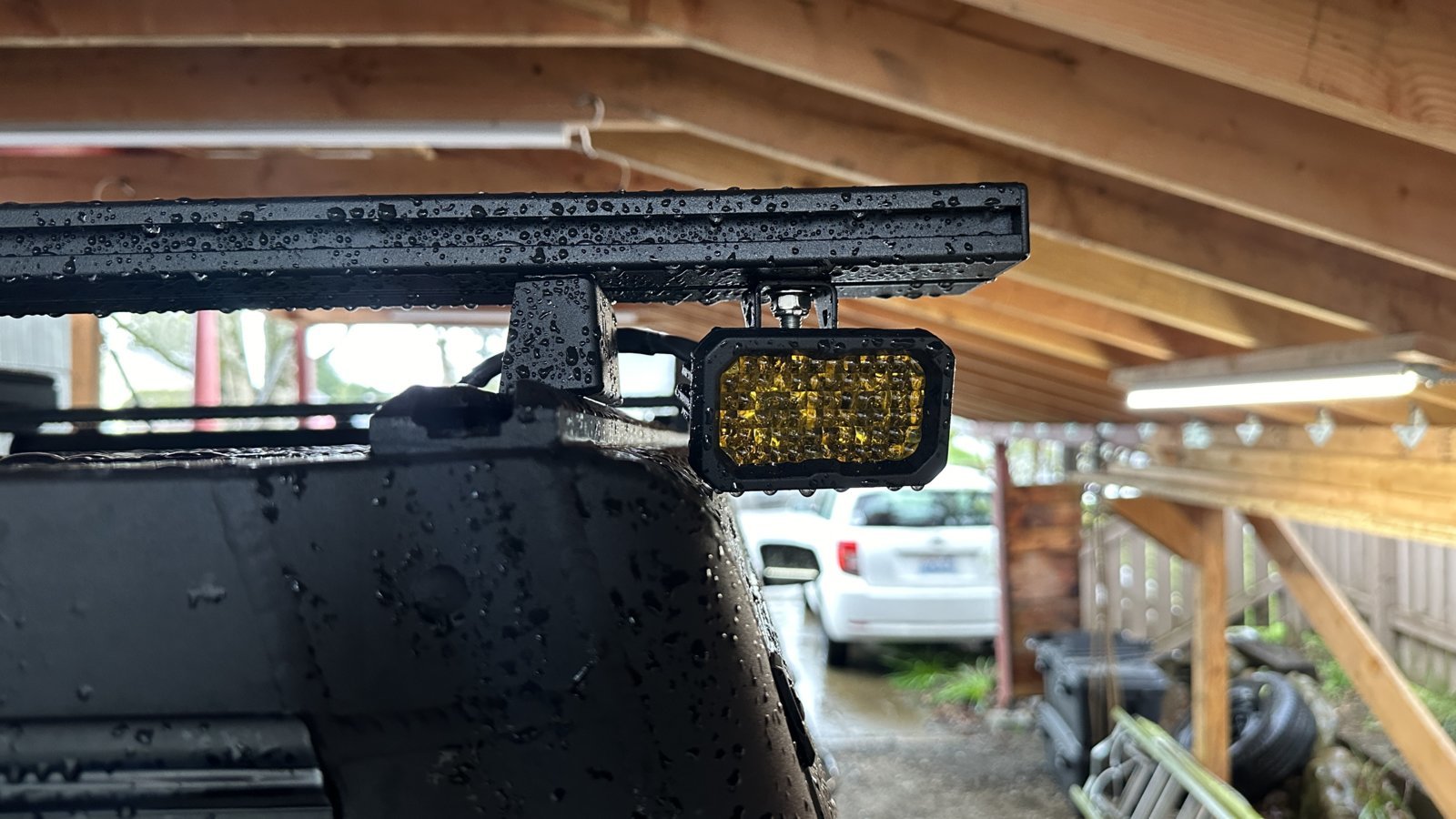

    I almost got the 1250 but ended up going with the 1450
    I’m glad I did . I have the awning mounts from alu cab and then put my chads lights under the small bit sticking out. I’ll get some pictures after work.

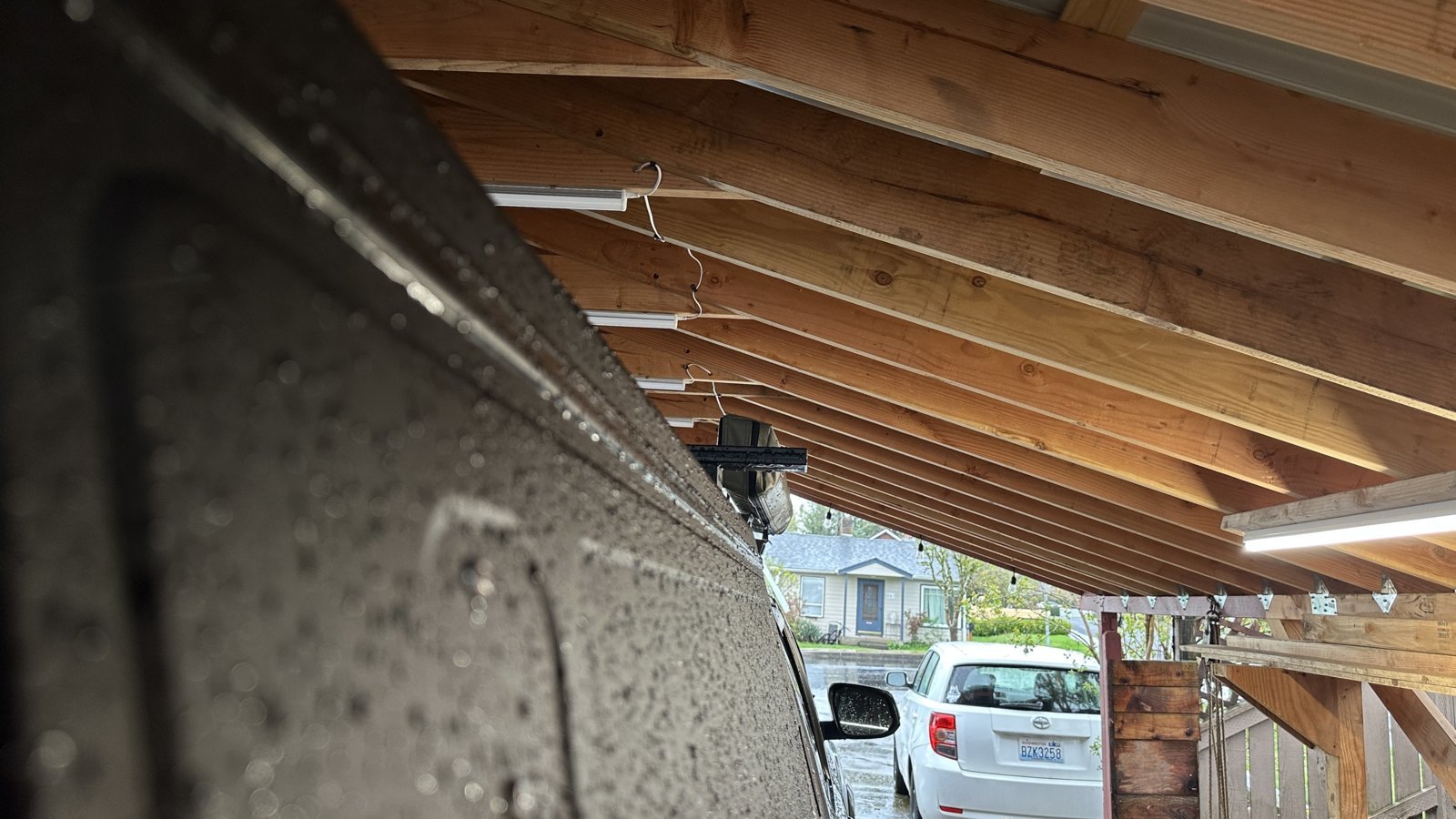

    i have the 1450 with the standard height feet too. they have over the side of the cap a couple inches on both sides, but dont touch the side door things when theyre open.

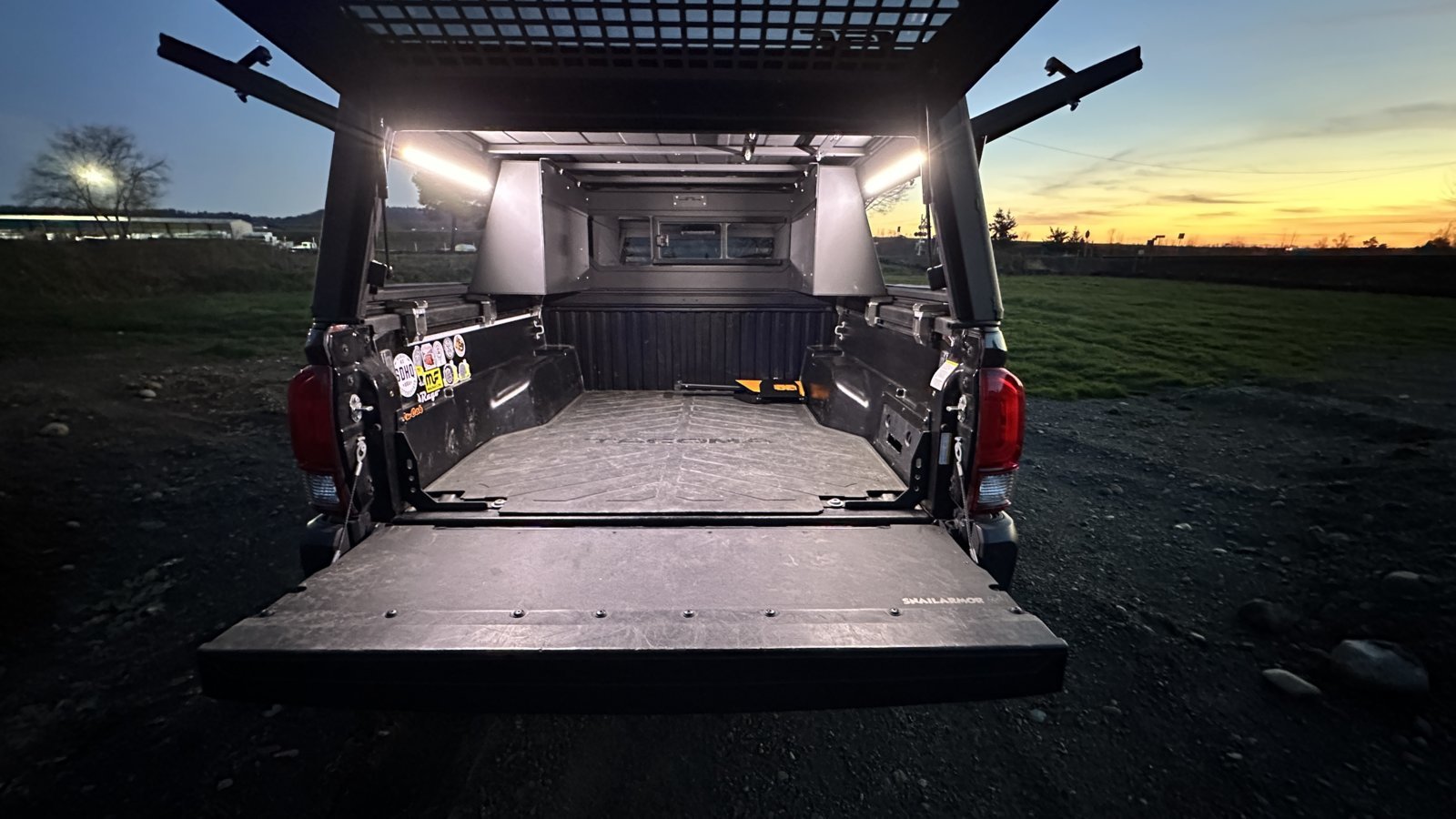

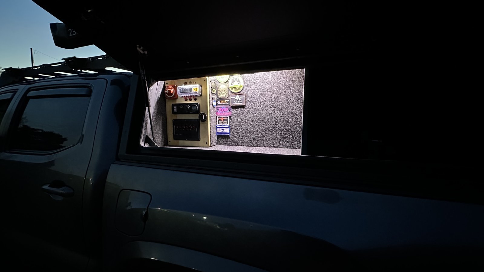

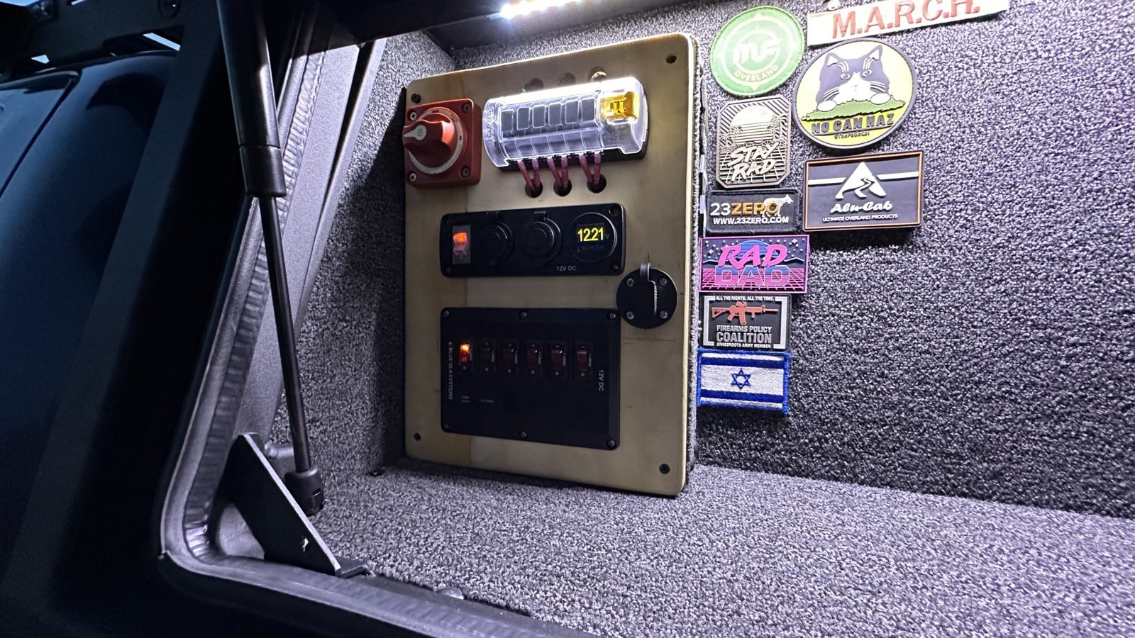

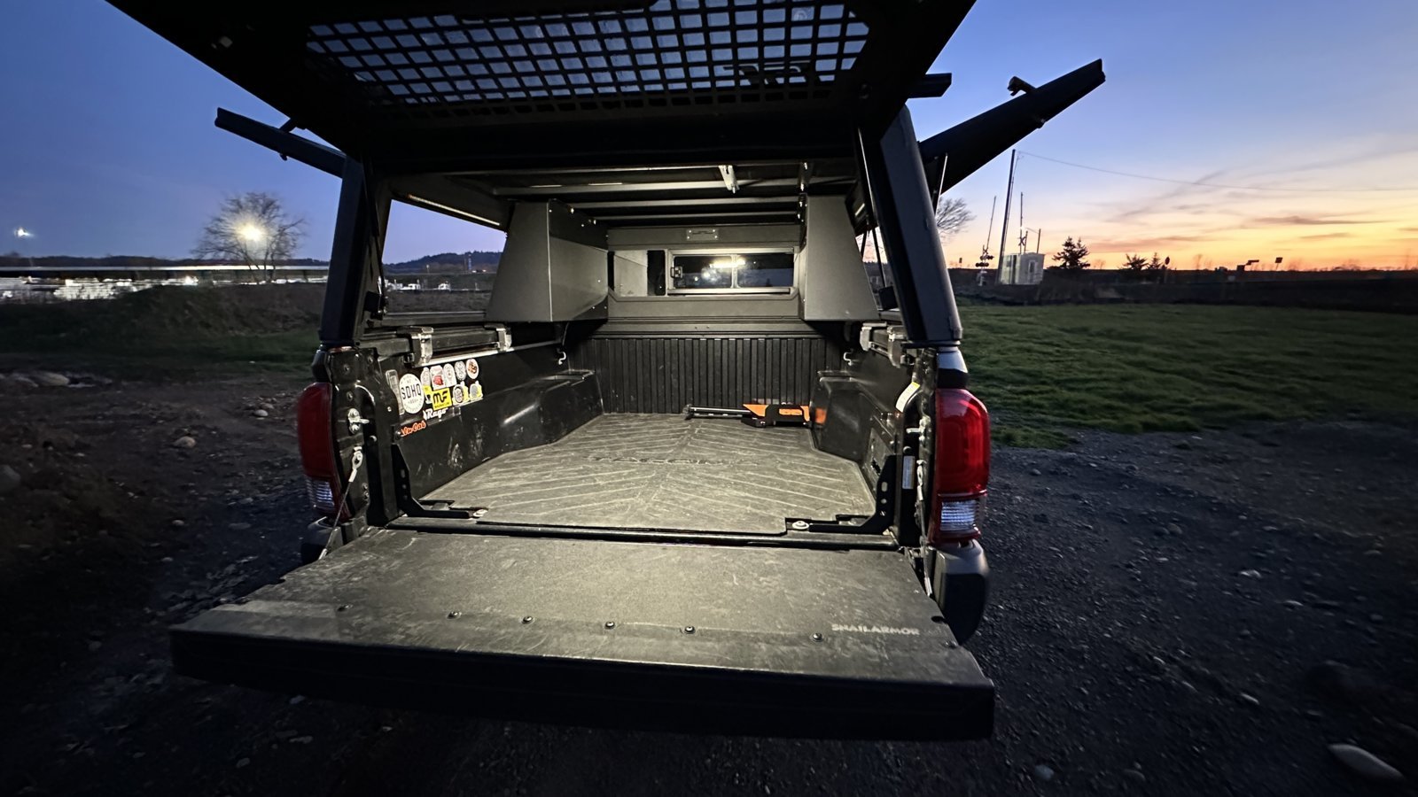

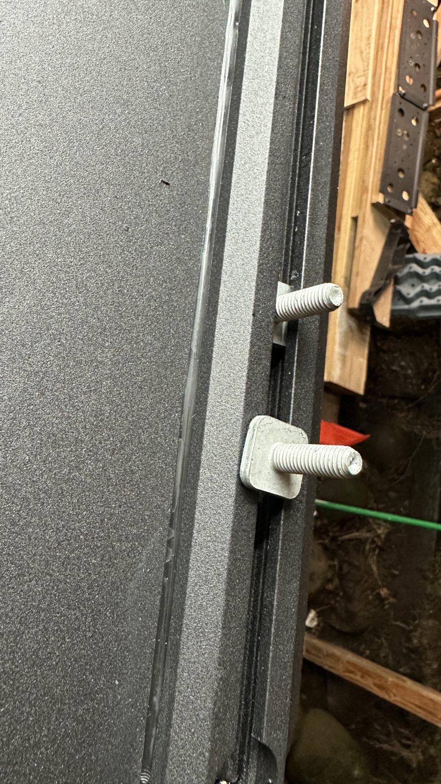

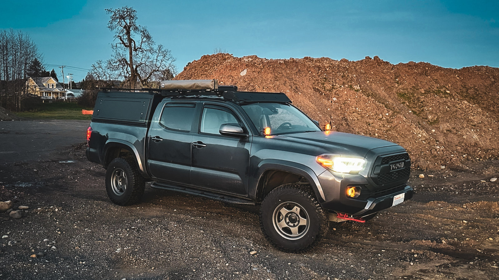

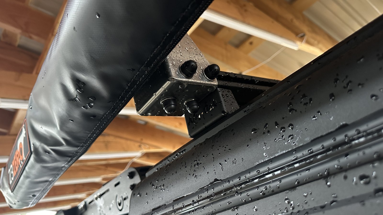

    Here’s a few photos incase anyone needs reference for the 1450 bars

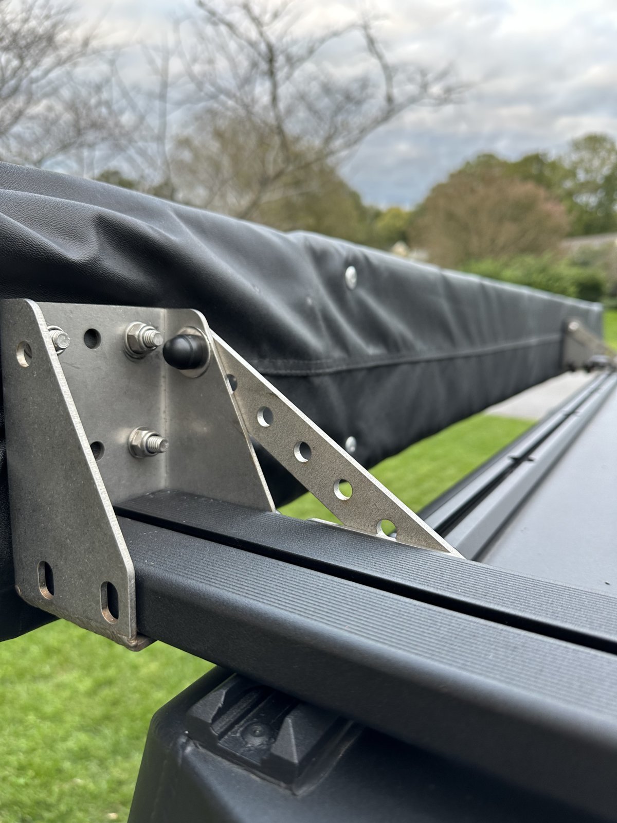

    I have the 1450mm with the low profile feet. The track tapers causing the rear bar to have more overhang than the front. I recently cut 3” off my rear bar, which makes them dead even overhang where mine are mounted front to back.
    Any reason you are not running the diagonal support included with the awning mount? I ended up modifying mine slightly to Mount tighter so I wouldn't have a large gap between my awning and top. During windy days at the beach, the load bar visibly deflects.
    My awning is still off for winter but I'll be putting it back on with painted brackets in a few weeks and I'll post some updated pictures.

    I thought they were a little overkill for my awning. This thing is built like a tank... If I had a 270 awning Id put them on.. but with a standard awning, its not very heavy.

    man this looks so good. i've got a very similar looking build to you and i've been waiting a month and a half for my contour with windows. i'm so stoked and this makes me even more excited i chose alu cab over RSI.

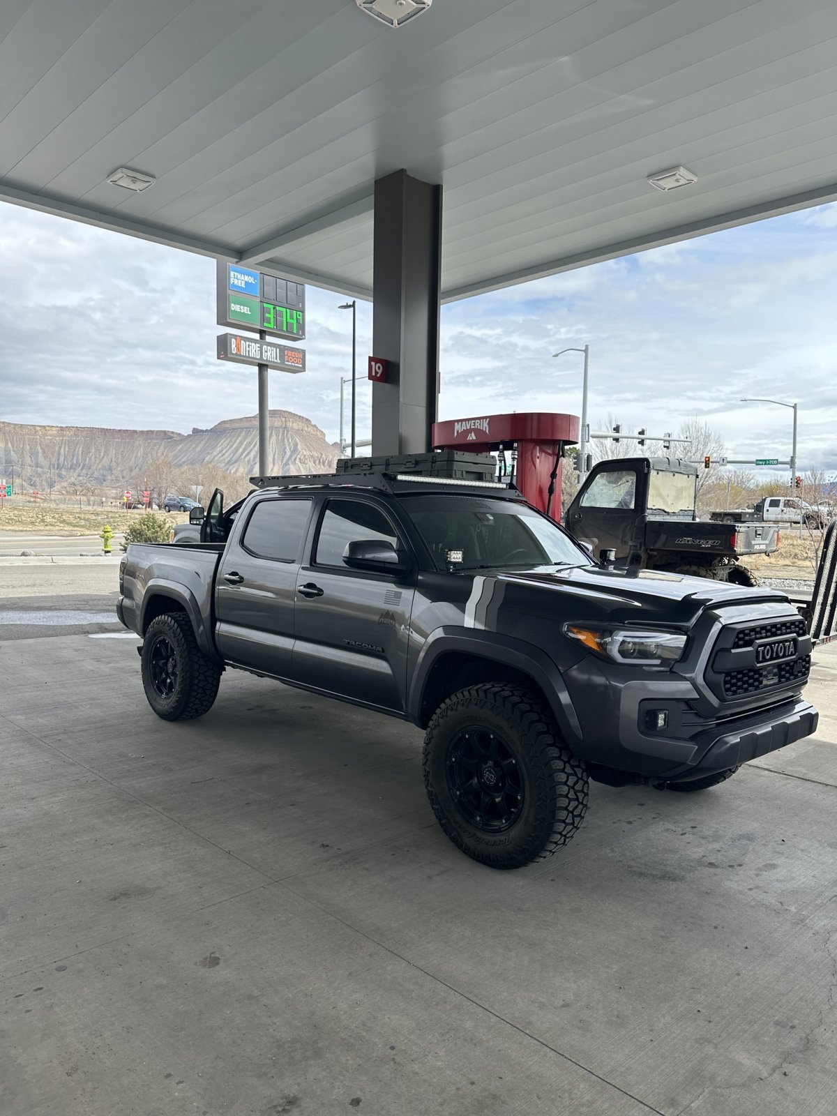

    haha, i initially saw a "dealer" for them on marketplace selling them and was going to get one before doing any research. sold my leer at top dollar and then did all the research. was on my way to pick up an RSI from a local place but found alu cab at the last minute and switched my directions on maps to go order. haven't found anything bad about the contour and i think it's going to be awesome. RSI has done a good job hitting all the appearance factors but the alu cab is a tried and true option plus the look grows on you more and more. here's my truck as of now waiting for the contour to arrive

    Oh yep very similar set up :) looks great.
