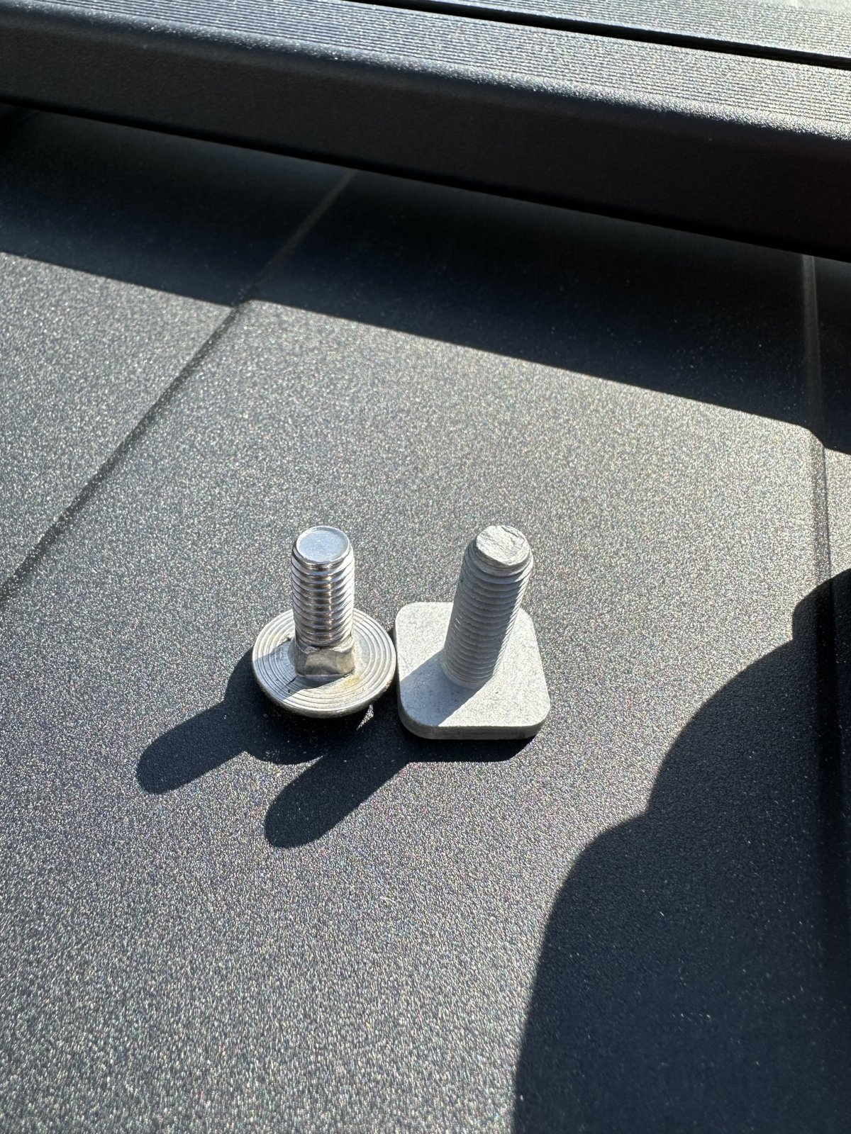

    Swapped my load bar feet hardware out - these are much more solid and engage the rail fully. Only down side is if you want to add additional hardware you need to start them at the beginning of the tracks and can't just drop in through the cut outs.
    Would definitely recommend these Leitner bolts. Well see how they hold up to corrosion after a few beach trips.

    Yeah that’s the trade off, not being able
    To add though the hole . But I figured I’d rather have super solid connection

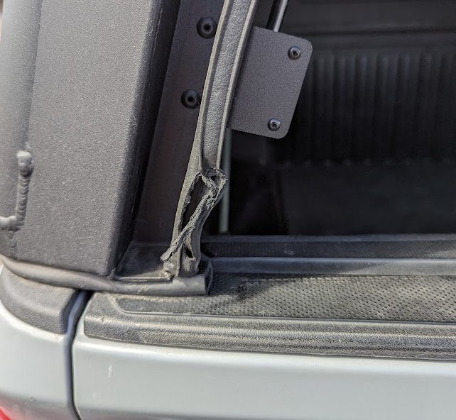

    on a somewhat related note, does anyone have a part number or something for the weather stripping that goes on the side of the rear window on a contour? mine got ripped somehow. it looks like it just gets pressed onto the vertical tab to sit on there.

    Mine is torn there as well. Feel on your window side where it presses in, mine has a rough piece of aluminum exposed that gradually tears it over time.

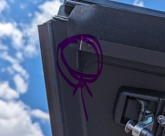

    This is the stripping thats ripped on mine.
    Looks like there is a little metal tab on the rear window that is bent
    I'll give straightening it out a shot. its not a huge deal either way for me

    yup same spot as mine, I flipped the seal 180 and ground the metal down.

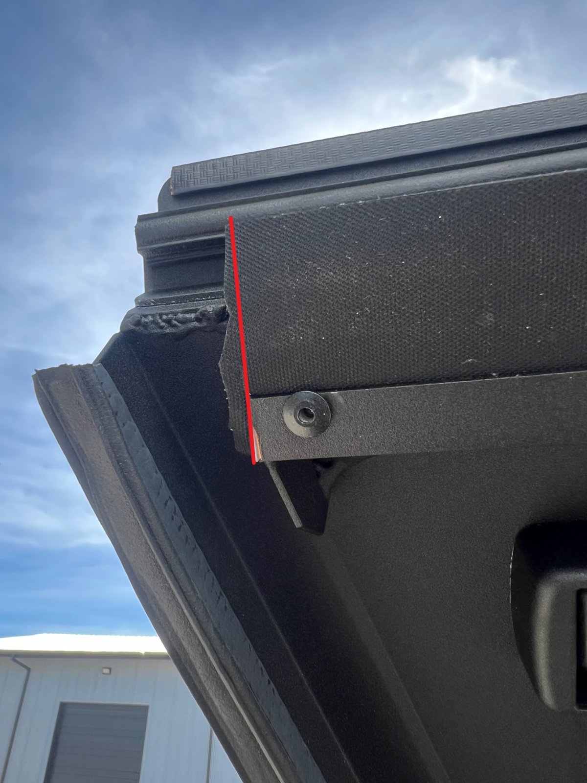

    For those with the vertical weatherstripping that has been cut/torn from left over flashing/sharp edges, Alu Cab will replace it. They are also going to replace my rear window struts.
    I reached out to the contact us page on the Alu Cab site, and I received a reply from jonvw@ok4wd.com in the US. Just need a serial number, and some pics of the damage.
    He attached this picture from trim purposes.

    mine did that too, I tapped that part very lightly with a rubber mallet to give the door some clearance and it worked perfectly. now I guess I should replace the weather stripping somehow
