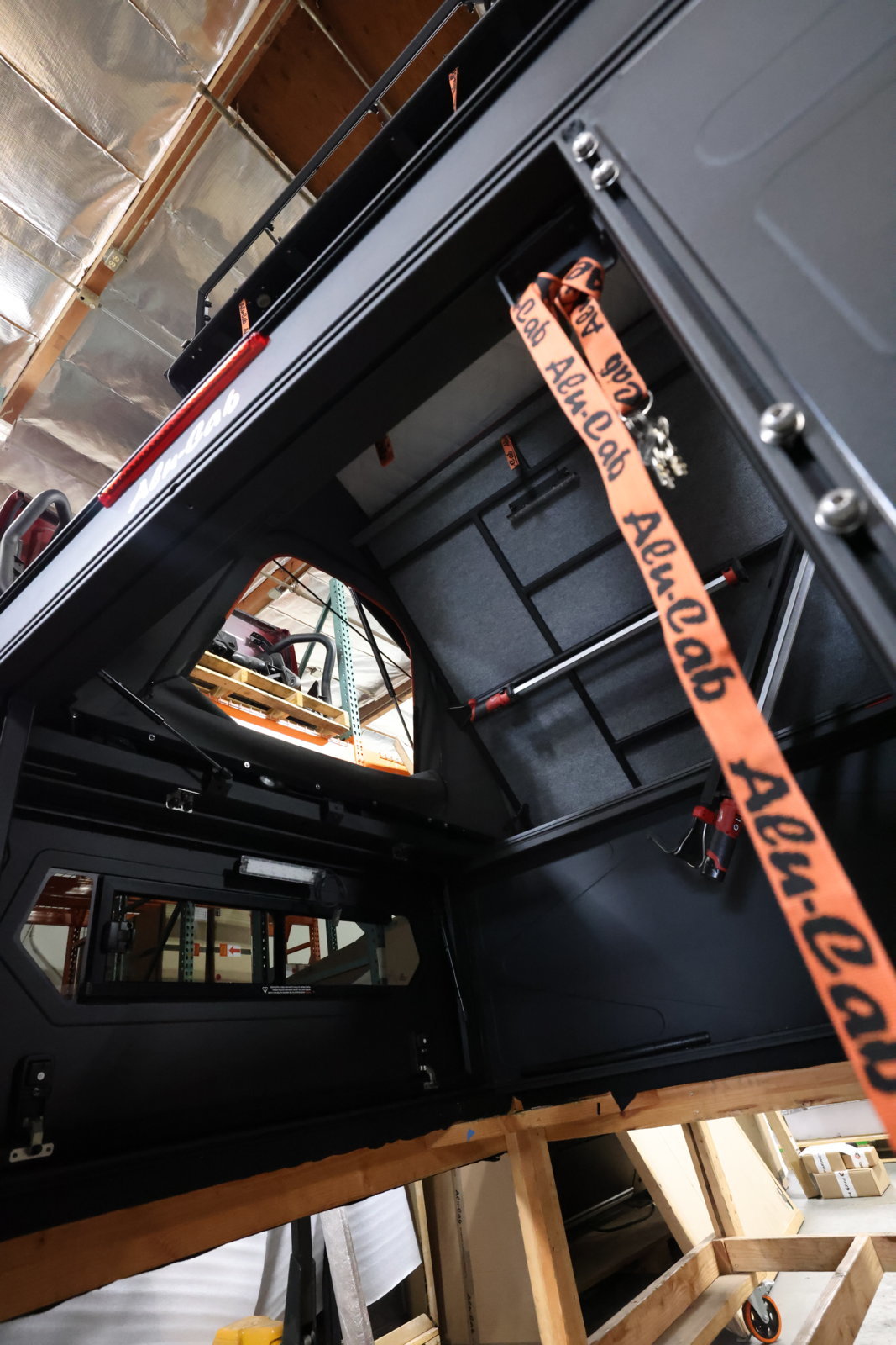

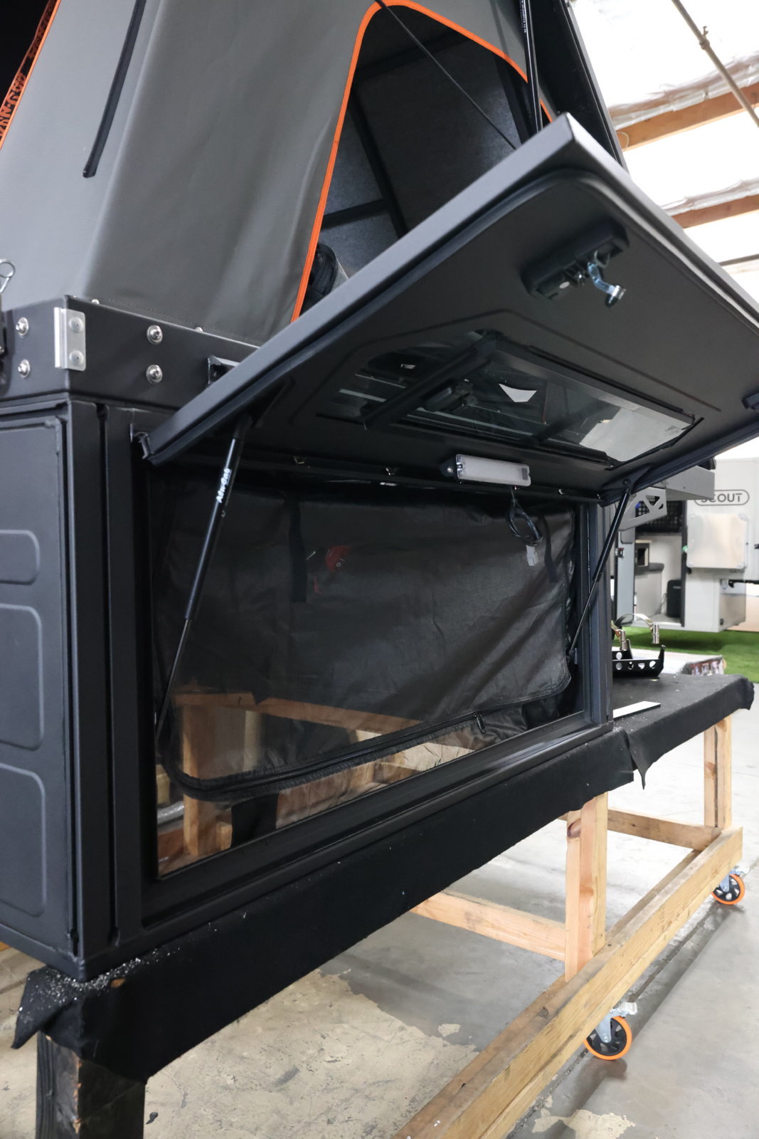

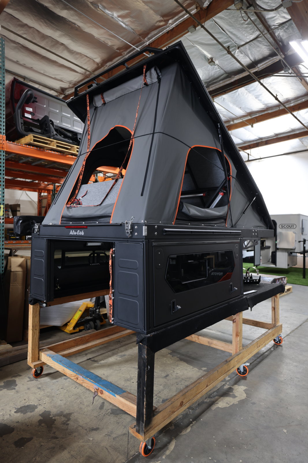

    Hi Friends,
    Our Modcap is currently being prepped and will be showcased at the Overland Expo in Flagstaff Arizona.
    A few of the options we're going with are:
    Alu-Cab 13 gallon water tank with Canvas Bags, Dickenson Fire Place, Mozzie Nets, Rear Molle Plates, Powertank Propane Tank, Full Redarc Electrical, Spare Wheel Bracket, Full Goose Gear Interior, Table and Table Slide, Kitchen Pantry and a few more add ons.
    We will continue to post progress photos for you guys. Feel free to reach out if you guys have any questions as well! We're happy to assist.

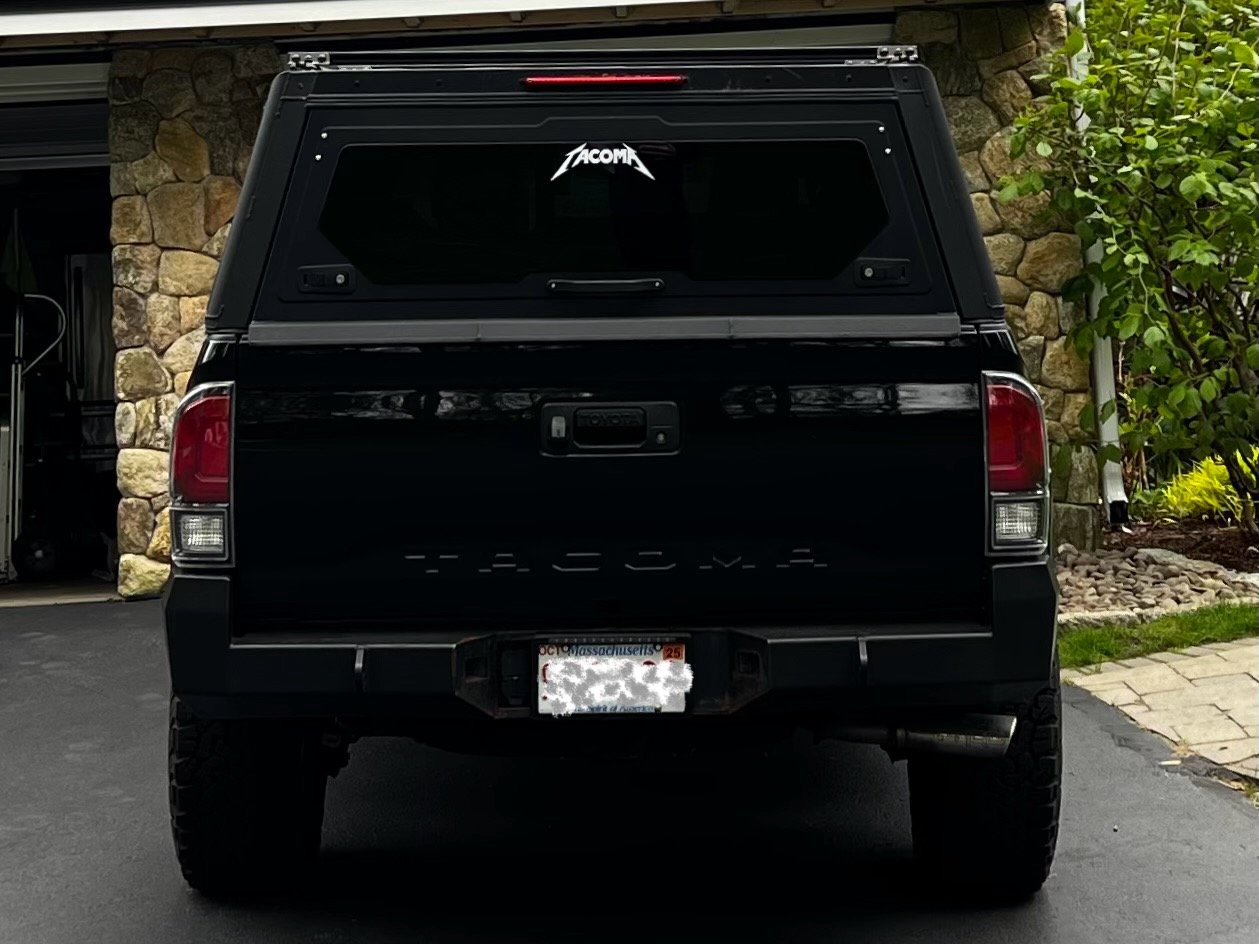

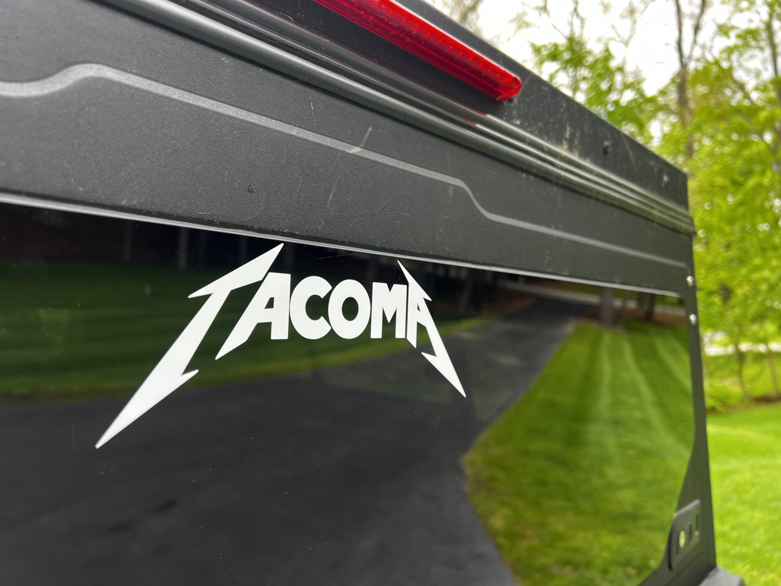

    Meso Bucket Tray
    I don’t understand why this is not standard but none the less added the only sticker to my debadge and no decals rig - getting ready for their summer tour. Wooooooooooooooo!

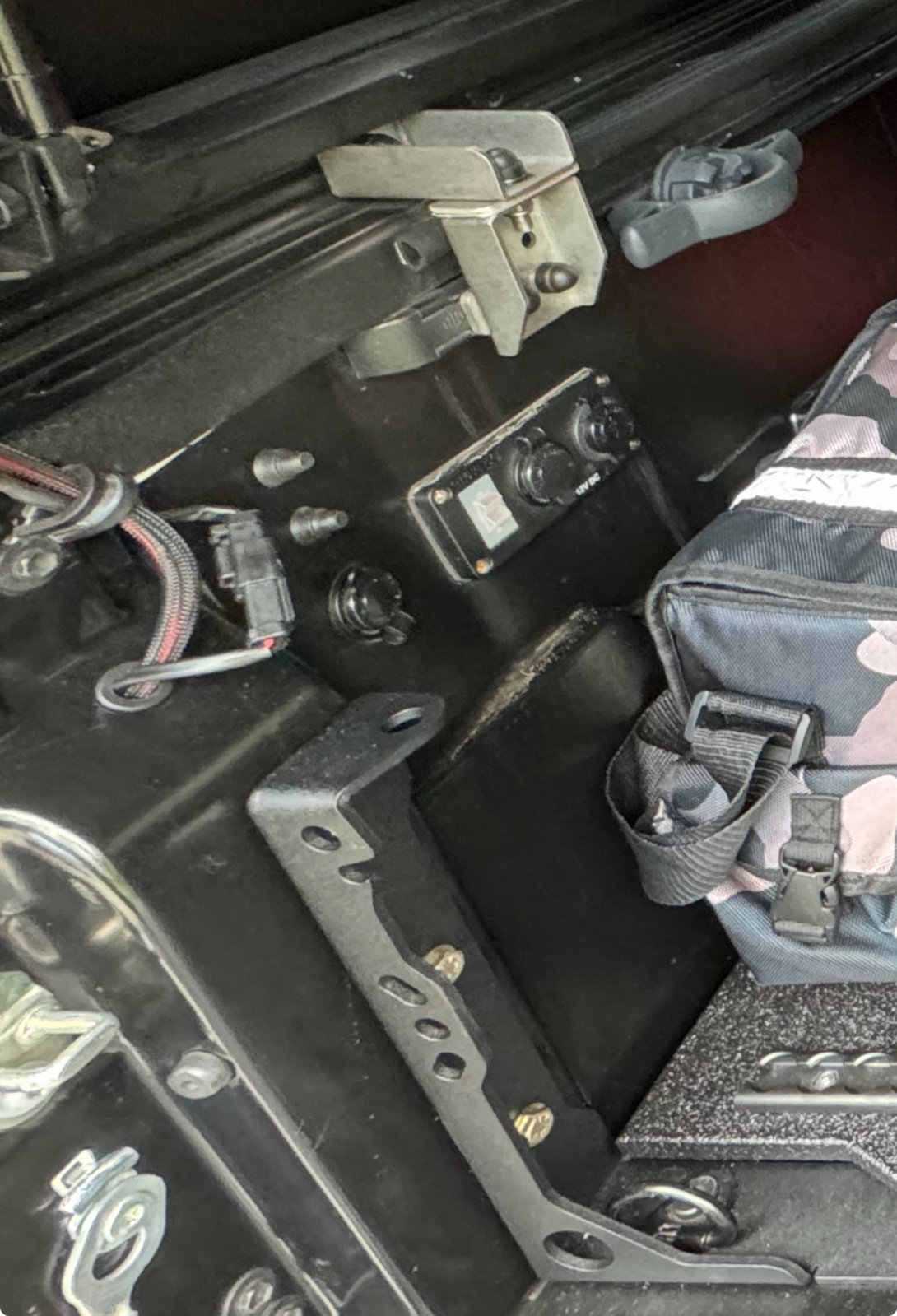

    aturk
    aturk Well-Known Member
    Jul 24, 2019
    #300138
    1,684
    Tony
    Charlotte, NC

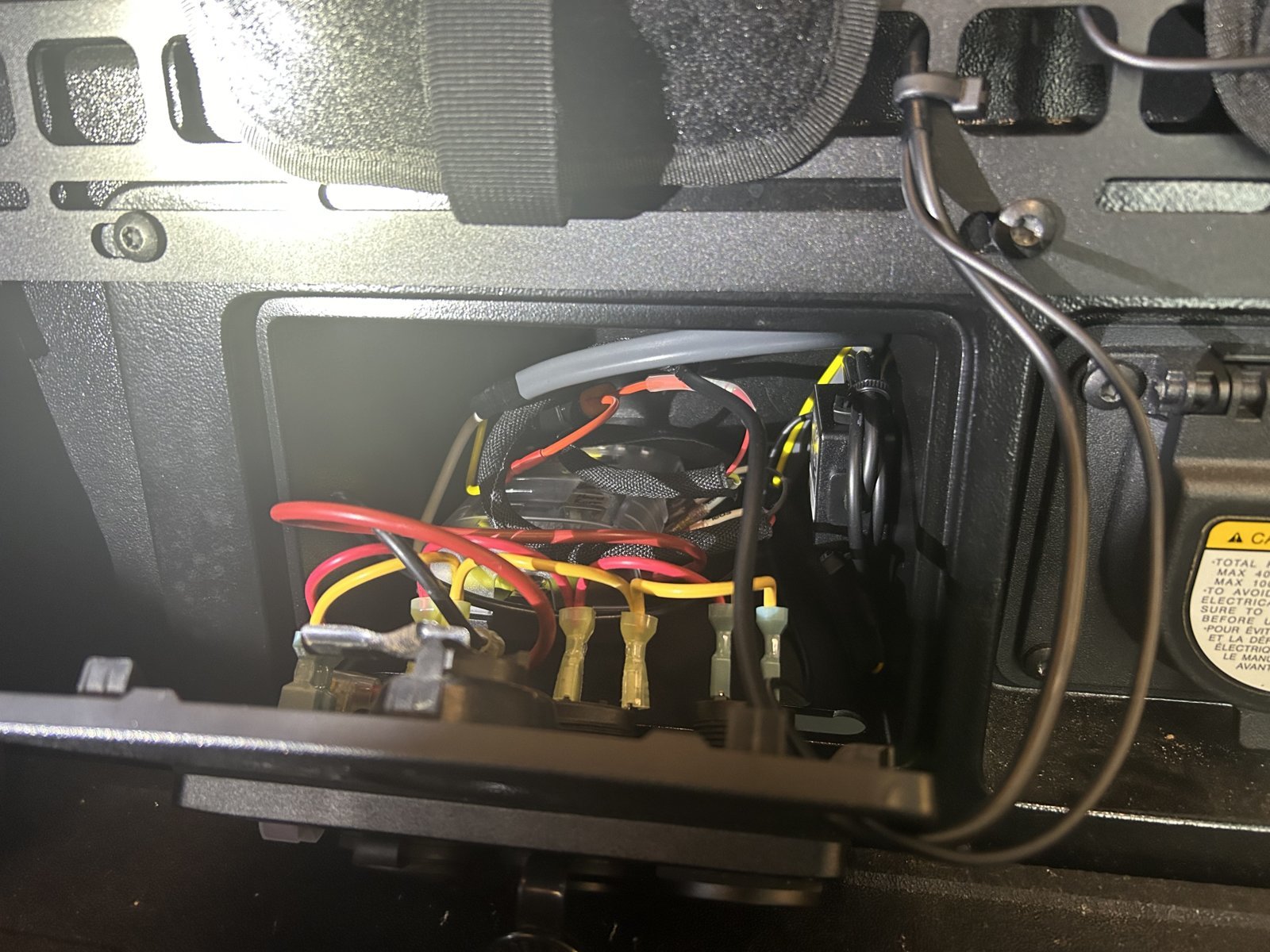

    I have had some issues with bad grounds for whatever reason back there using the factory frame ground inside the drivers rear tire on top of the frame rail.
    Once I ran a power/ground combo wire (which is actually easier to run because it's quite stiff) to the battery all of my issues went away.
    My 10gauge/4port fuse box runs 2 12v outlets, 1 USB 2.0 outlet, and 2 switches that control factory Alu-Cab lighting as well as 2 Diode Dynamics Rock lights in red color back there on magnetic mounts.
    It does get a little wet back there behind the tail light at times, but I have not had any issues in a year of running the blue seas fuse box back there. I had some cheaper fuse boxes from Amazon that would last a month or two. FWIW.

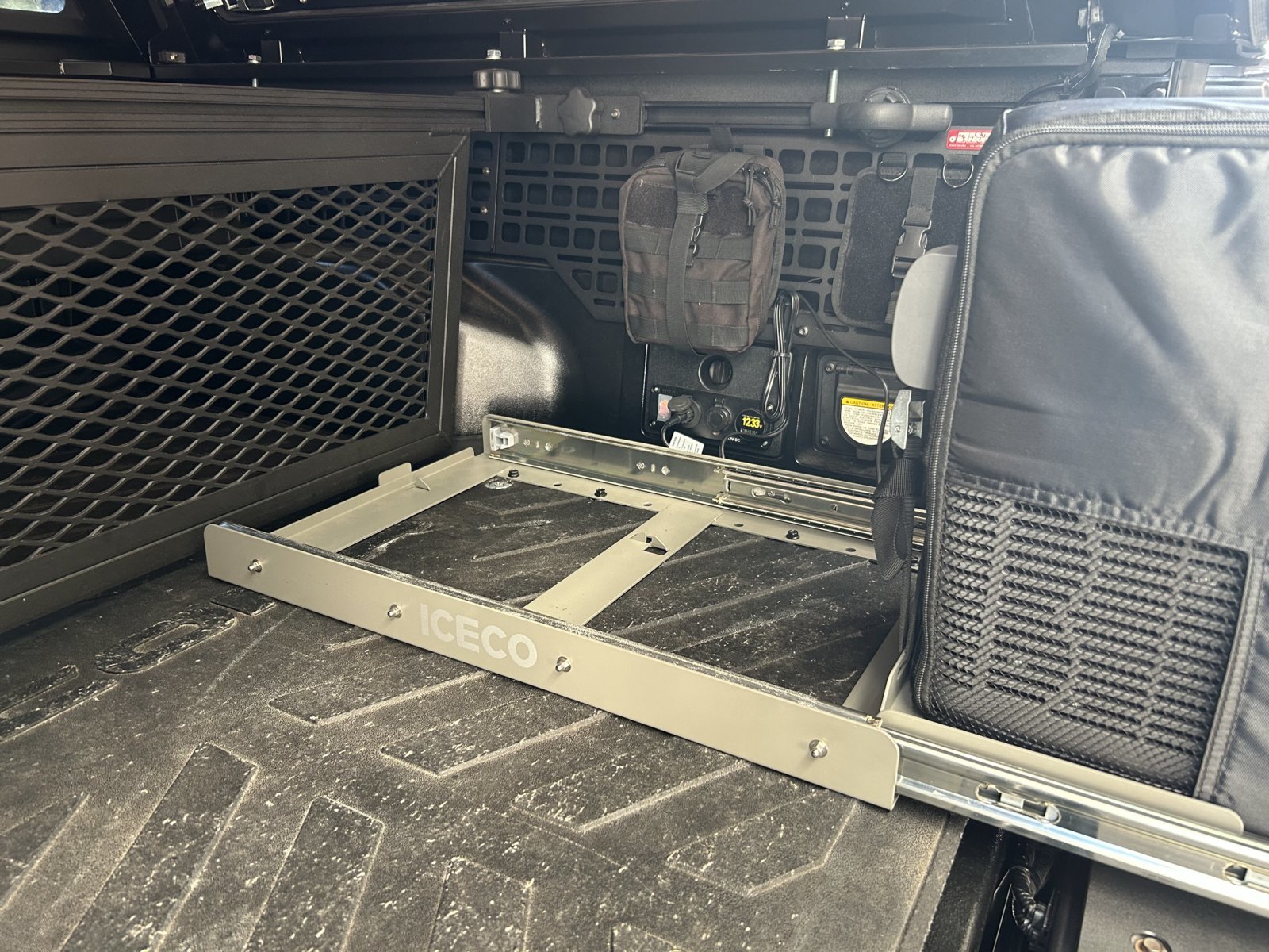

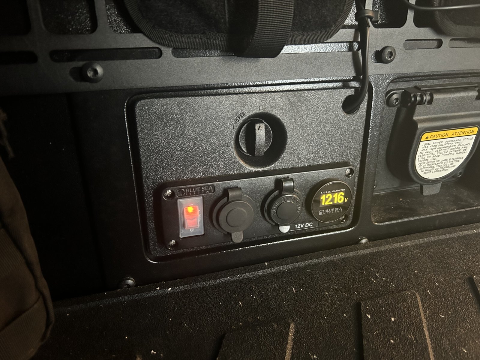

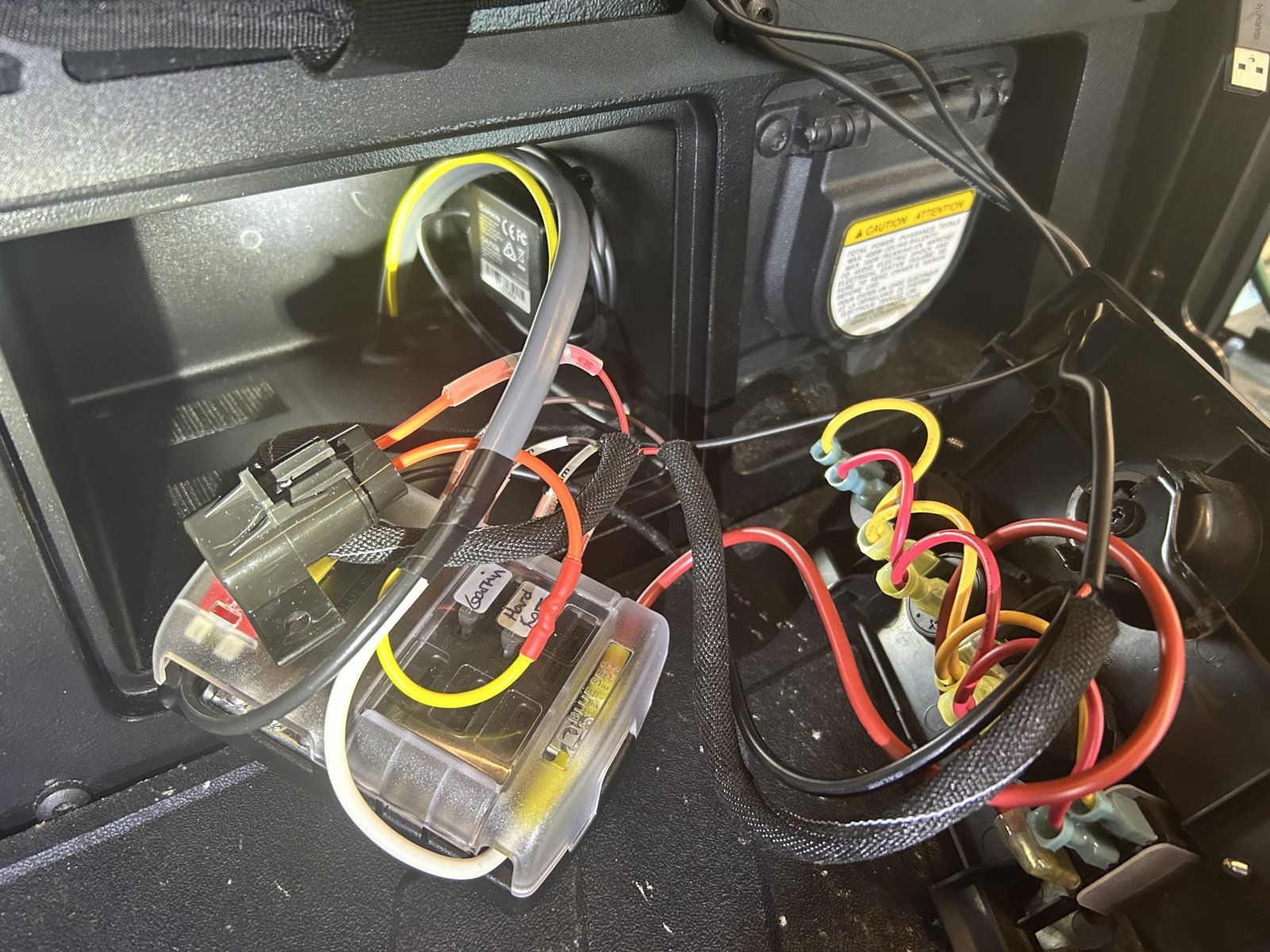

    I didn’t read back to the start of this conversation but figured I’d share what I did for power for my use.
    I added a blue seas fuse block w/ negative bus and stuffed it in the cubby on the passenger side. I used the arb wiring kit which is similar to yours I believe but since I ran it where I did the length was about 4-5’ short. I drilled a hole bottom corner of cubby for the wires. I have the blue seas panel too that’s mounted on the cubby door- added voltage, fridge plug and cig outlet. The wires going through the cubby door are the dash cam and led lights. I’m only running the frig on family trips, led canopy lights, garmin mini for rear dash cam (I wired this with ignition from the 7wY trailer plug).
    the long frig power cord makes it look messy, had to leave enough slack to slide in/out and then wrap the rest and tied it up near the door so it wouldn’t get pinched

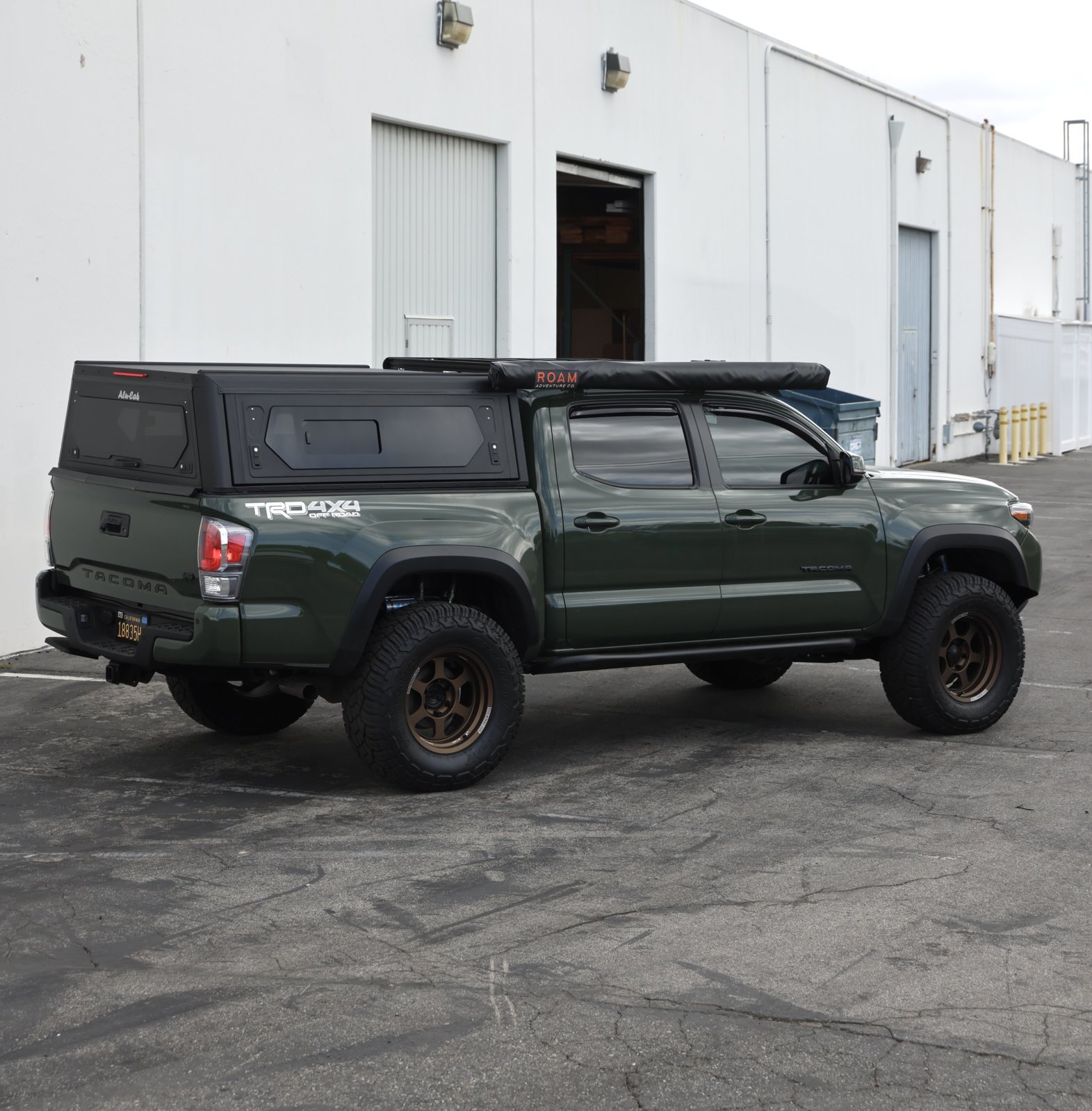

    Contour Canopies just landed at Tinyrigco! Available with side windows and without and ready to be installed.
    Mention this post for $150 off. Thank me later!
