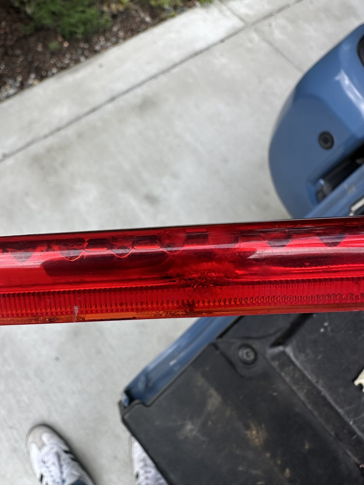

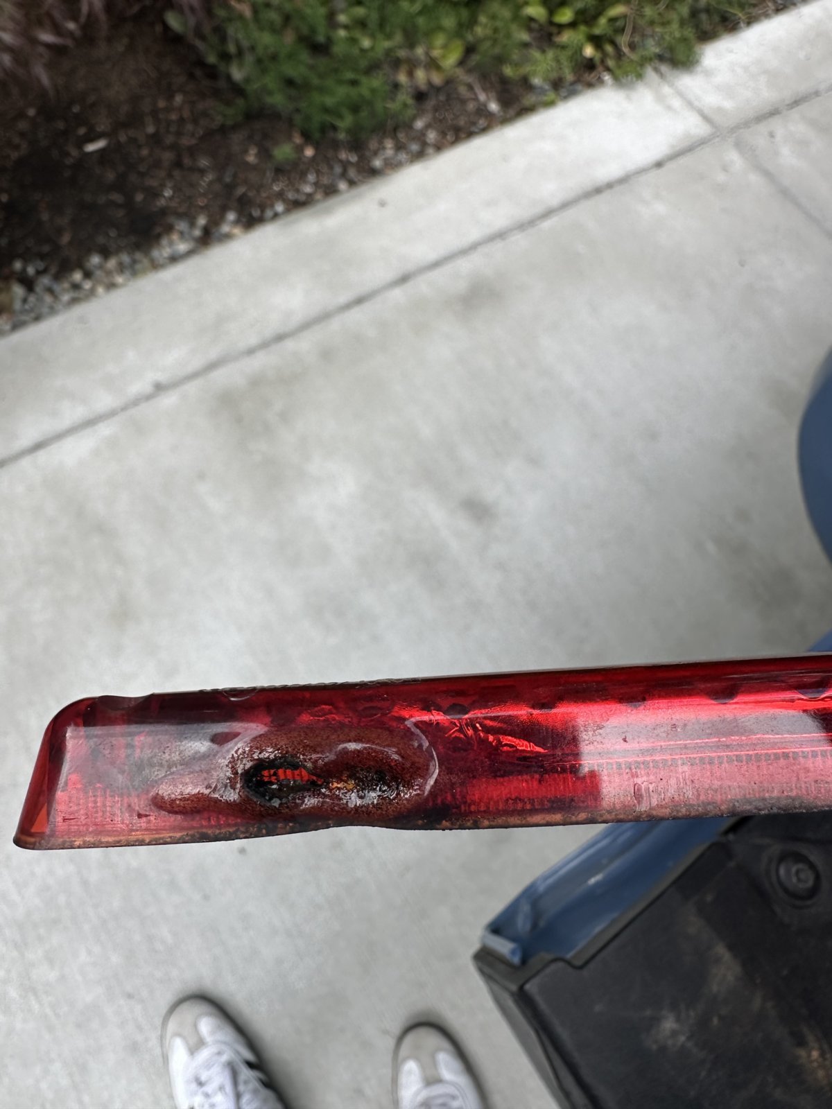

    3rd brake light started smoking tonight at a stop sign. Truck next to me let me know it was letting the smoke out.

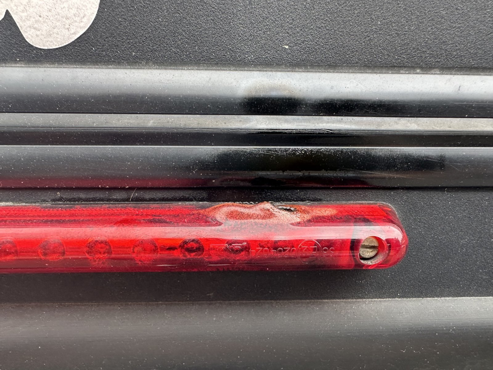

    This was connected to the right tail light with a t-harness from fbc. Tail lights are led meso tails but the cap and tail lights have been on the truck for quite a while now with no changes. Pulled over and unplugged the deusche connector that I have in the bed to disconnect the light temporarily. I called Mule where I bought the cap and they had never heard or seen this happen before. They pulled a light for me off a unit they had on hand and I just picked it up about 45 minutes ago. I plan on dissecting the light to see if I can figure out what caused the failure, clearly it shorted out but would be nice to know the cause.

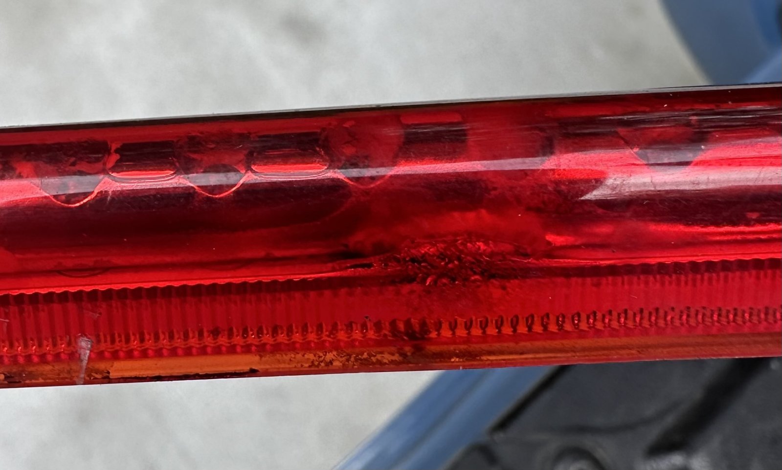

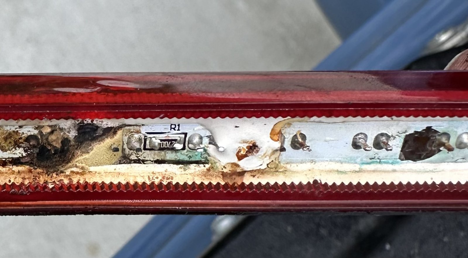

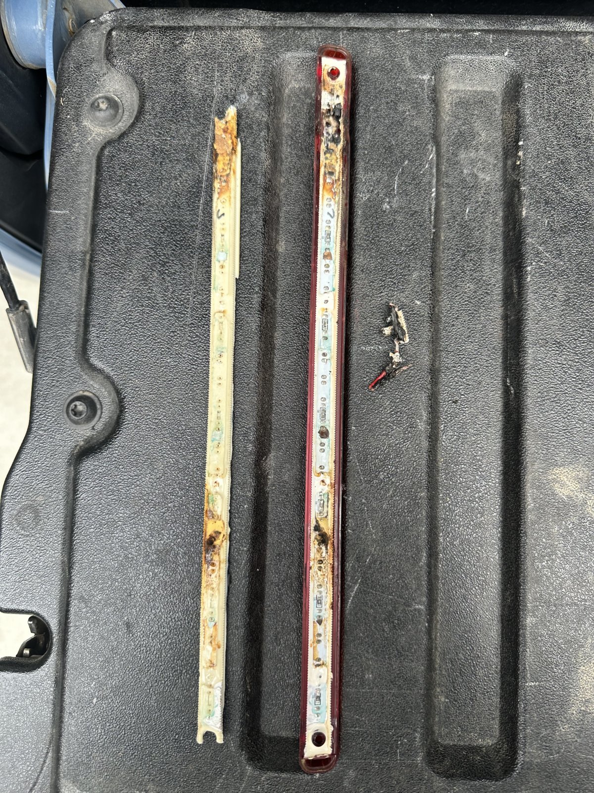

    It’s an internal short in the light assembly itself. You can see some corrosion on both the board and the back portion of the light that stayed attached to the canopy upon removal.

    nothing visible. Not sure if it was because of the heat but when I pulled off the original damaged light off the canopy the white sealing material stayed glued to the canopy.

    I meant the heat from smoke/fire not outside temperatures. We get lots of rain so I’m not surprised that water would find its way in. You can clearly see the green discoloration on the circuit board on this pic. This was on the second burn area towards the drivers side of the light. The main damage was all at the other end but the light and chrome plastic was clearly distorted under the red cover.

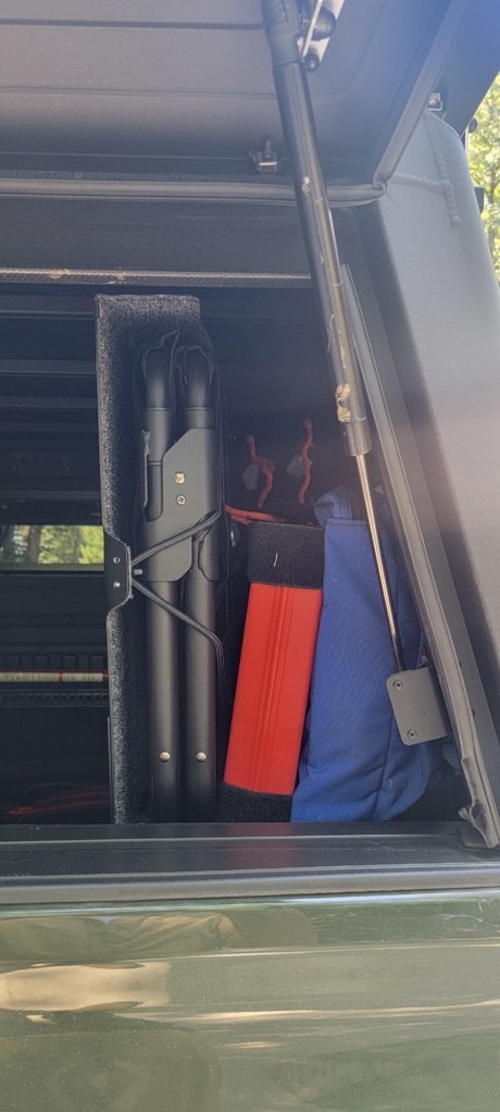

    Figured I'd post pictures of the chair carrier for the contour since I couldn't find any to help me decide on buying it. Overall I like for what it does. Have the ammo slide ill be installing today as well
