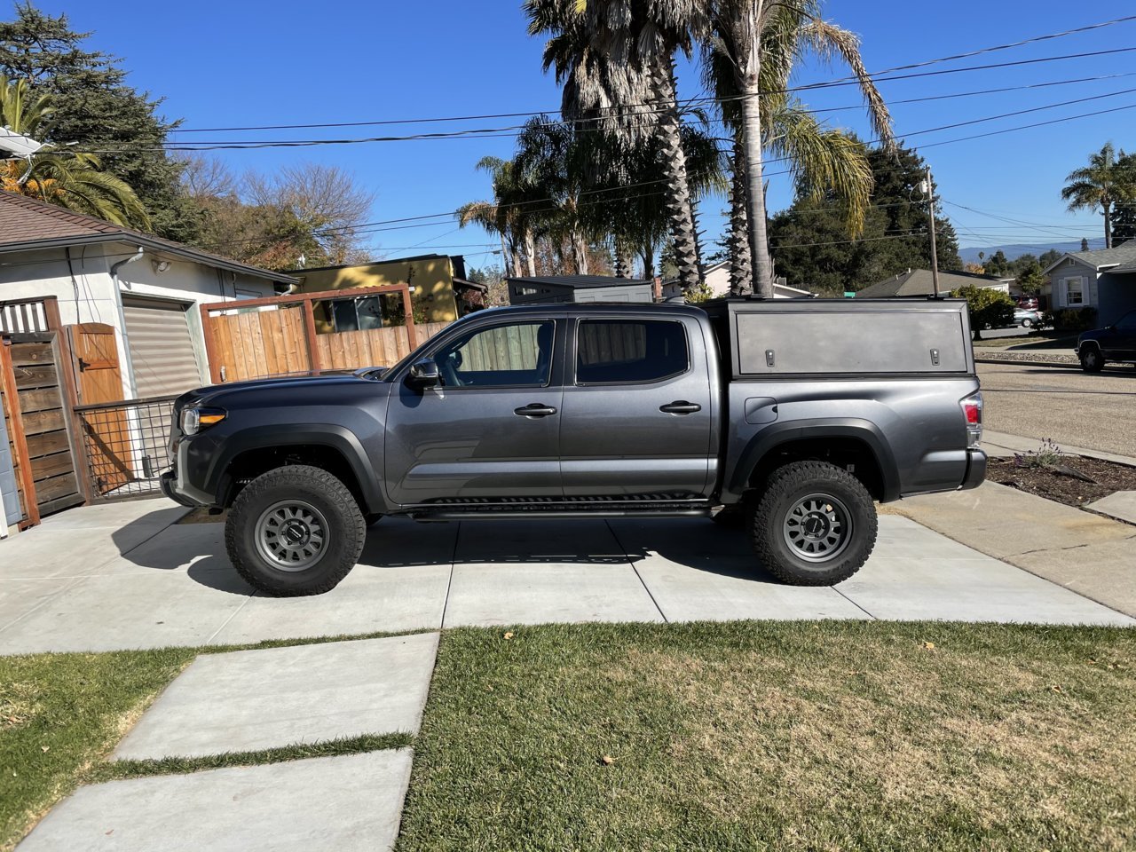

    Swapped the tonneau for an Alu-Cab Explorer, thanks to OK4WD

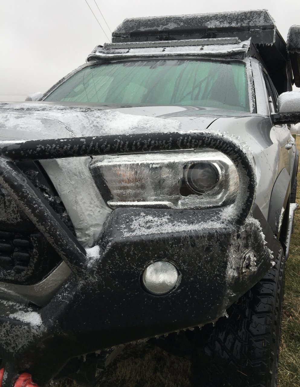

    Nice weather for January for the trip this weekend but the 4 hour drive home was rain to freezing rain to snow. Bone dry inside. Gotta love it.
