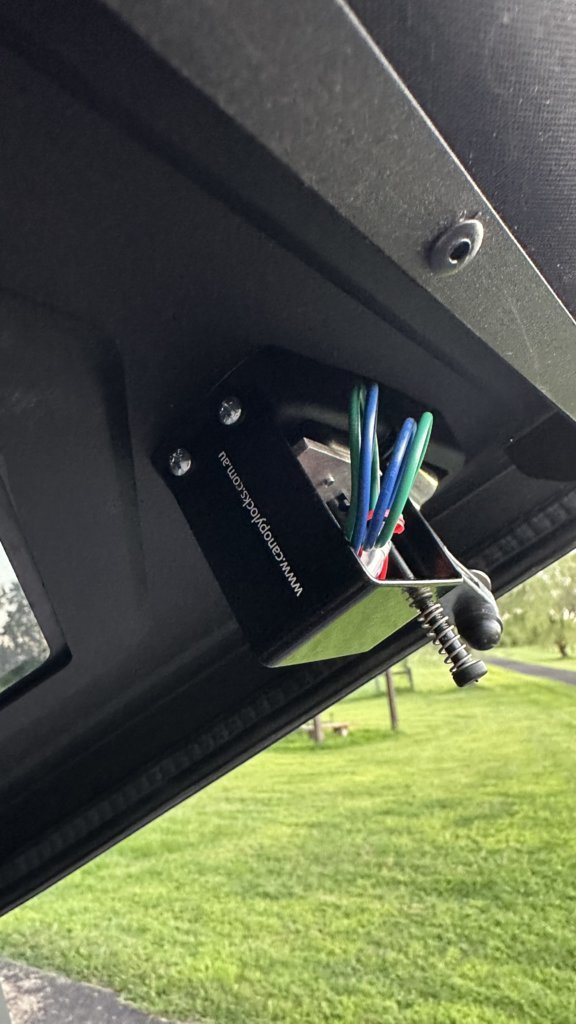

    I installed these central lock adapters wired into the tailgate pop lock. They also have a spring plunger that opens the latches from the inside.

    You have to close the latch the actuators lock them with your oem keyfob. I did not use their controller. I only bought the set for the rear and wired them into the tailgate pop lock.

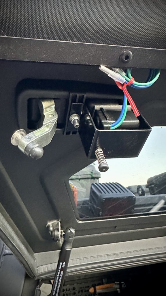

    ExploreBackcountry— so if you’re inside the topper and you pull it closed, how do you latch it?

    I push on the plastic nut cap and latch them. I ordered some m6 coupling nuts to to extend them to make it easier. Should know in a few days if it pans out to be easier.
    This DID NOT work. The gas strut on the rear is at an angle limiting the space needed.

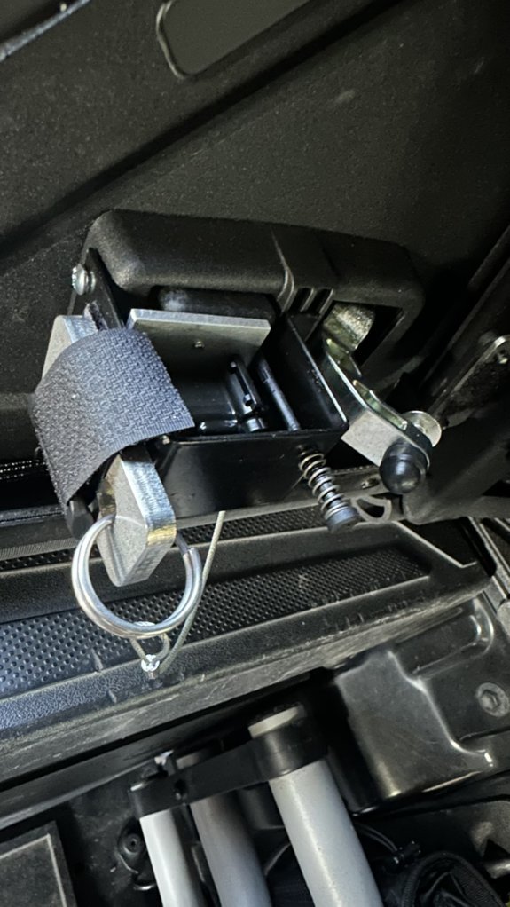

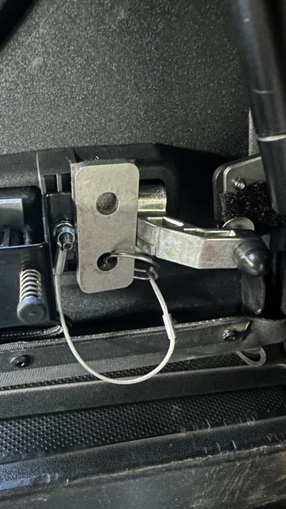

    As it turns out the large Alucab large spacers are the perfect size to “latch” the rear hatch from the inside.

    Perfect! And quick release.
