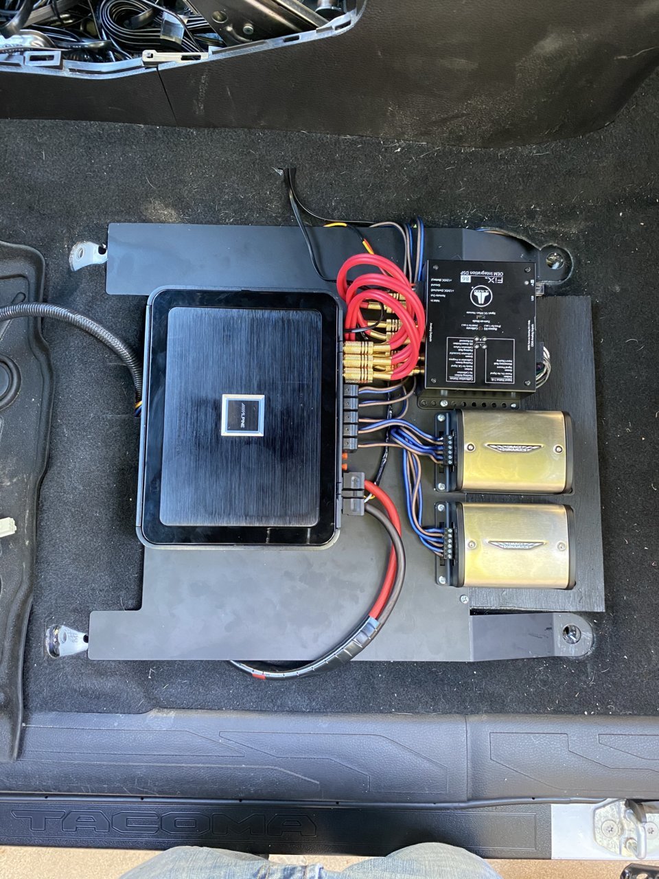

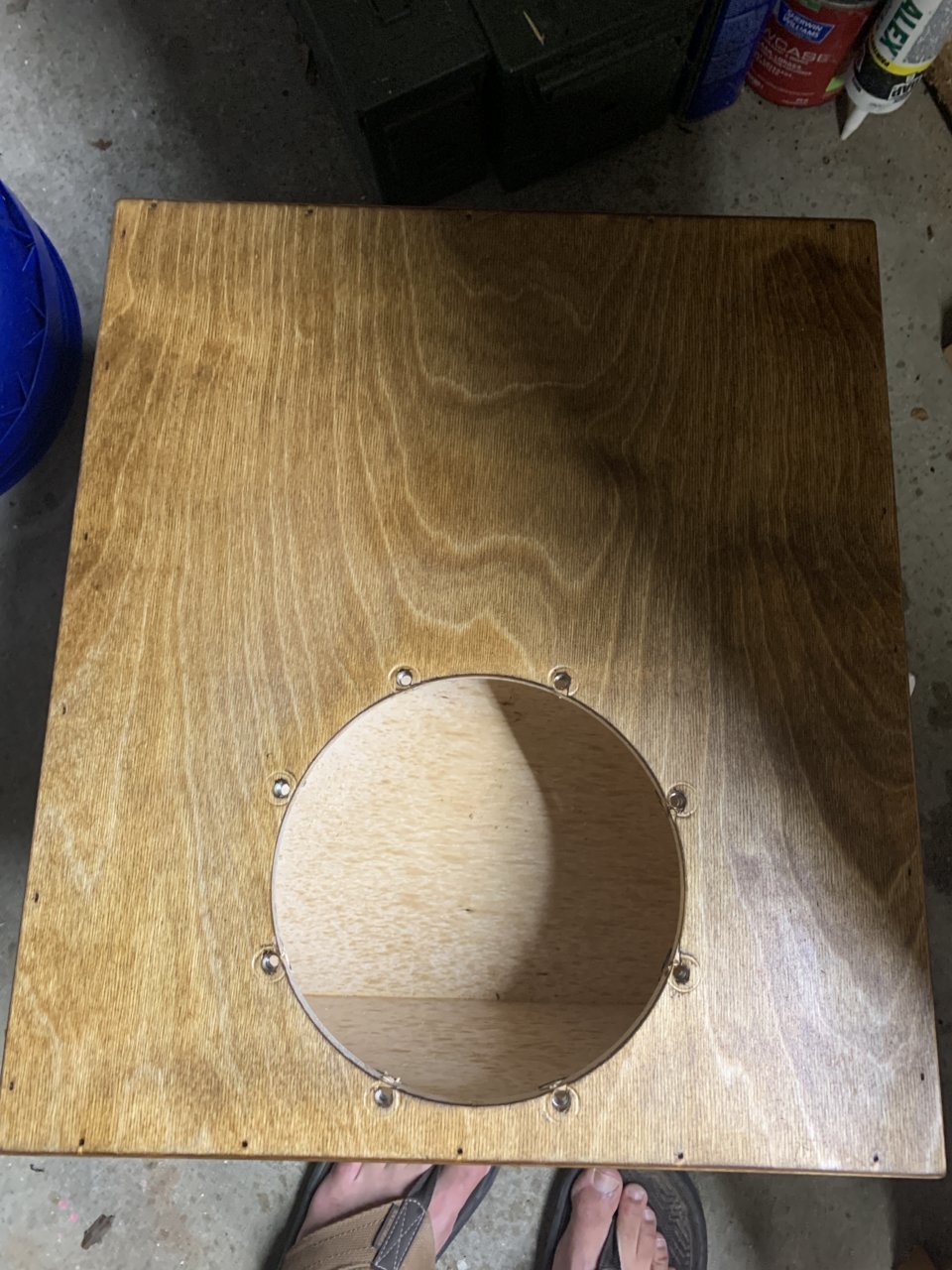

    Couple more layers of urethane and some sanding, and I hope to have this dropped in by the weekend.

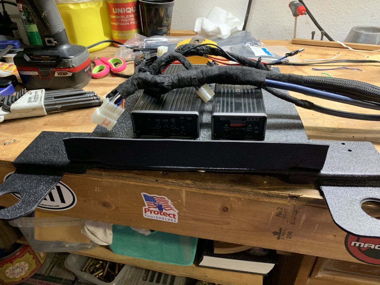

    @Mr Marv box and amp rack in my 2017.

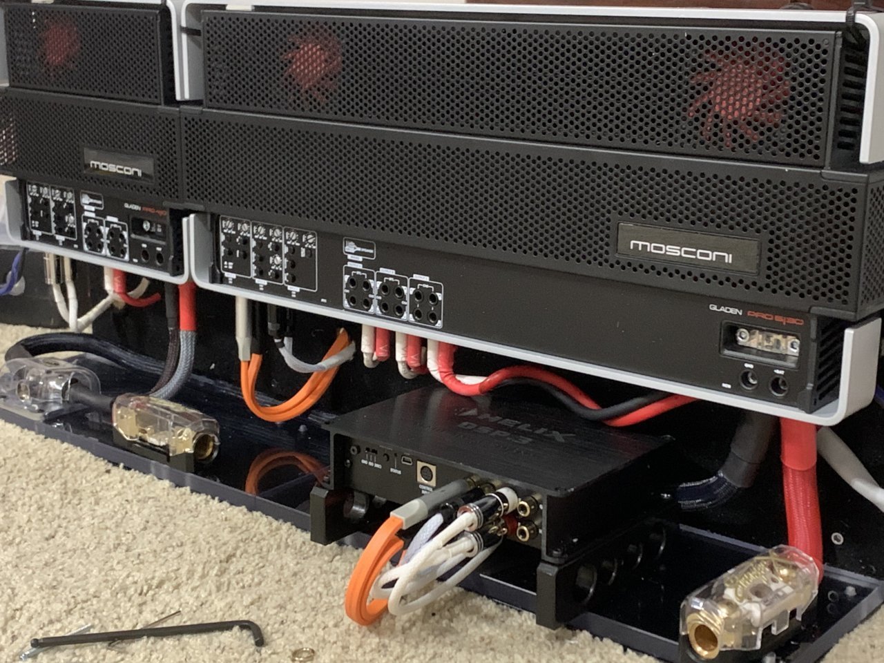

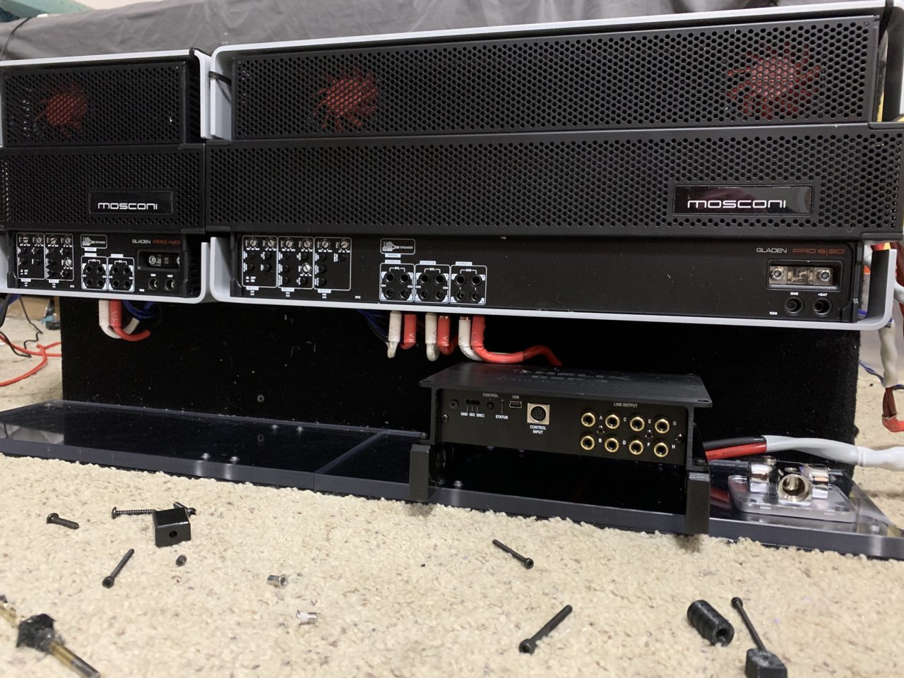

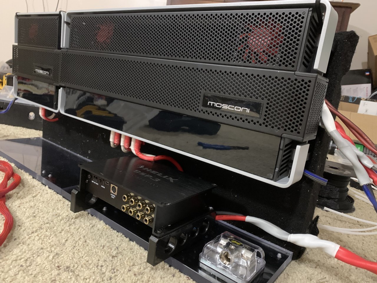

    Bilstein 8112/8100 ICON RXT Stage 2 JBA UCAs Archive Garage HH w Shackles Archive Garage U Bolt Flip kit Nitto Ridge Grapplers 255/80/R17 TRD Front Skid and RCI Transmission Skid Kenwood DMX 1057XR Head Unit Focal Utopia WM 3 way plus WM10 Sub Mosconi 5/30 and Genesis Dual Mono Amp

    Too much.
    Damn that's hot

    Damn dude that ABS Amp mount is beautiful. How difficult was it to make?

    In person, I thought it was a little rough. My first time working with ABS. I used a jigsaw to make the rough cuts, but you have to keep some pressure on it to move the blade along. Otherwise, friction will melt the ABS back together right behind the blade. I then used a dremel and sanding drum to knock the edges off and clean it up.
    Recommend putting some bends into the rear legs to lift the back of the mount up and let your floor vent breathe. My amps and wiring are all connected with zip ties through 1/8” holes I drilled through the ABS, and the rear seat bolts secure the whole thing.
    To get the shape, grab a sheet of cardboard and cut the shape you want, including the bends in the rear legs. Transfer to cardboard and cut.
    Then to bend it, grab a heat gun. You’ll need to hold the bends to shape for a minute or so till the plastic cools, and heat it till it starts to drop before you bend it to get sharp, clean bends.

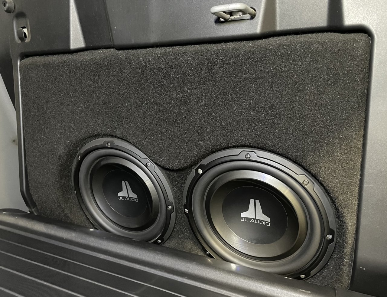

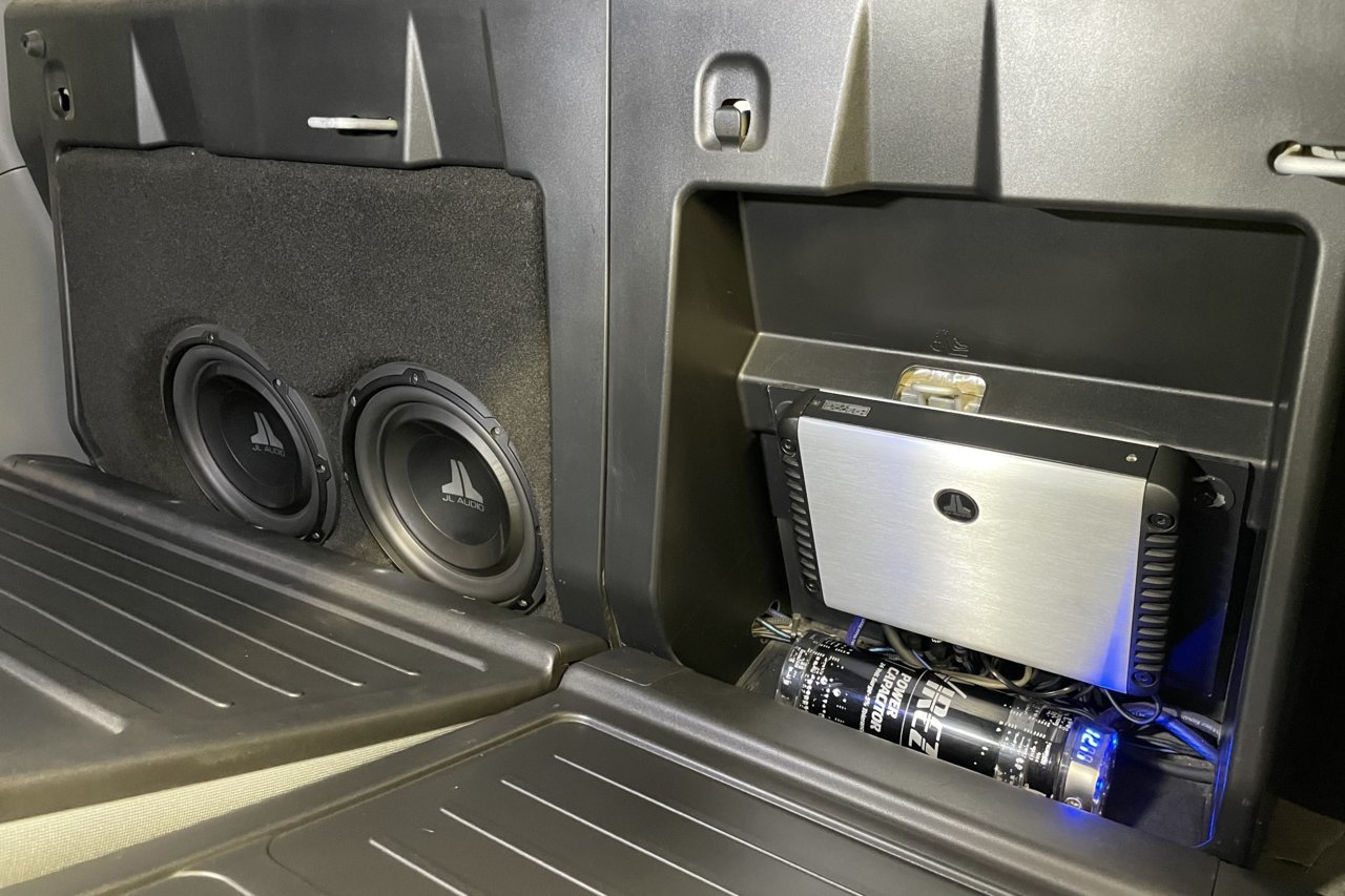

    CFDA20A2-375E-4A3D-A133-A3E842F395AD.jpg DD25BA12-8D3A-4601-A3D5-418AFEA166BB.jpg D65BF096-11DF-4174-BEC9-FA7C76ECCB56.jpg
    900/5 JL amp which sends 100x4w to JL C5-650s in the doors and 500w to the 2 10” JL W1v3 subs. It does the trick in my 08 taco

    Did you make the box? It looks great and is probably what I'm aiming to do.

    No it’s a JL Stealth Box and I’m not sure if you can still get them. They’re also pretty expensive but def has a factory type look to it. You have to cut up the plastic behind the seat but that’s pretty easy
