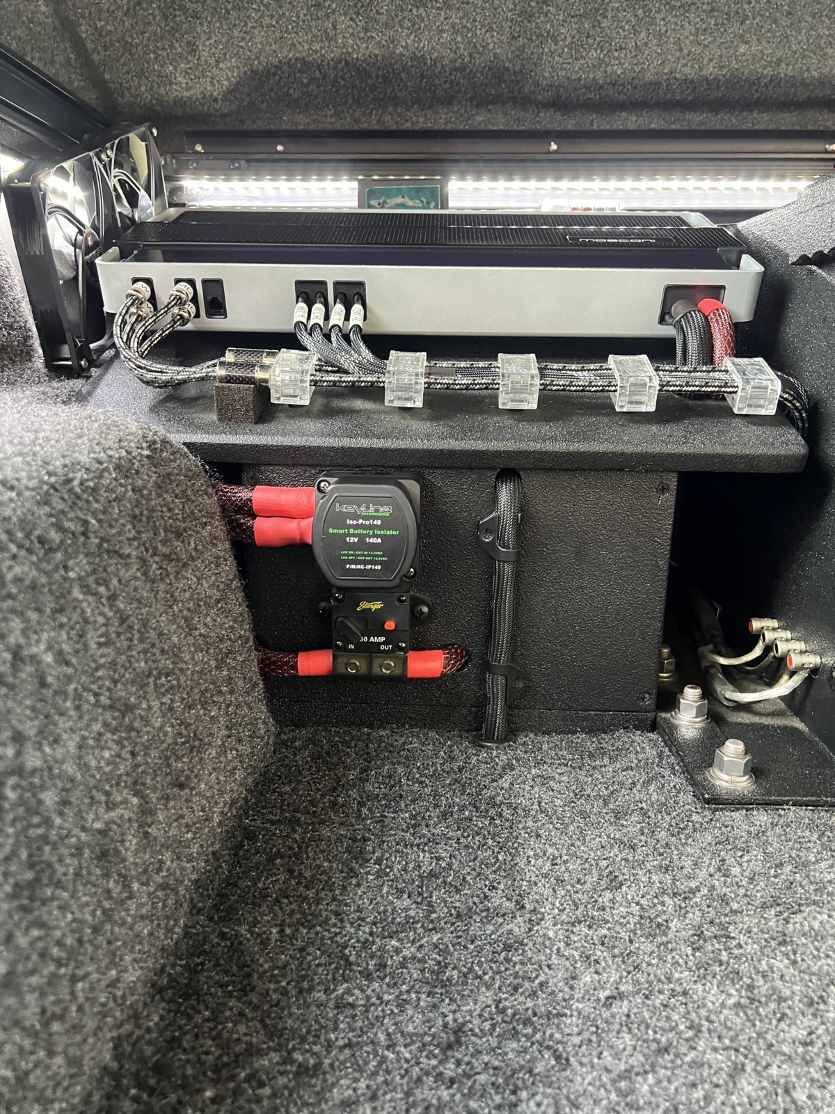

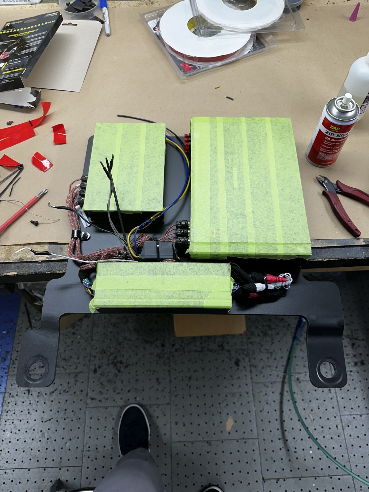

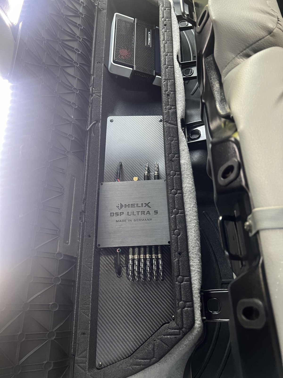

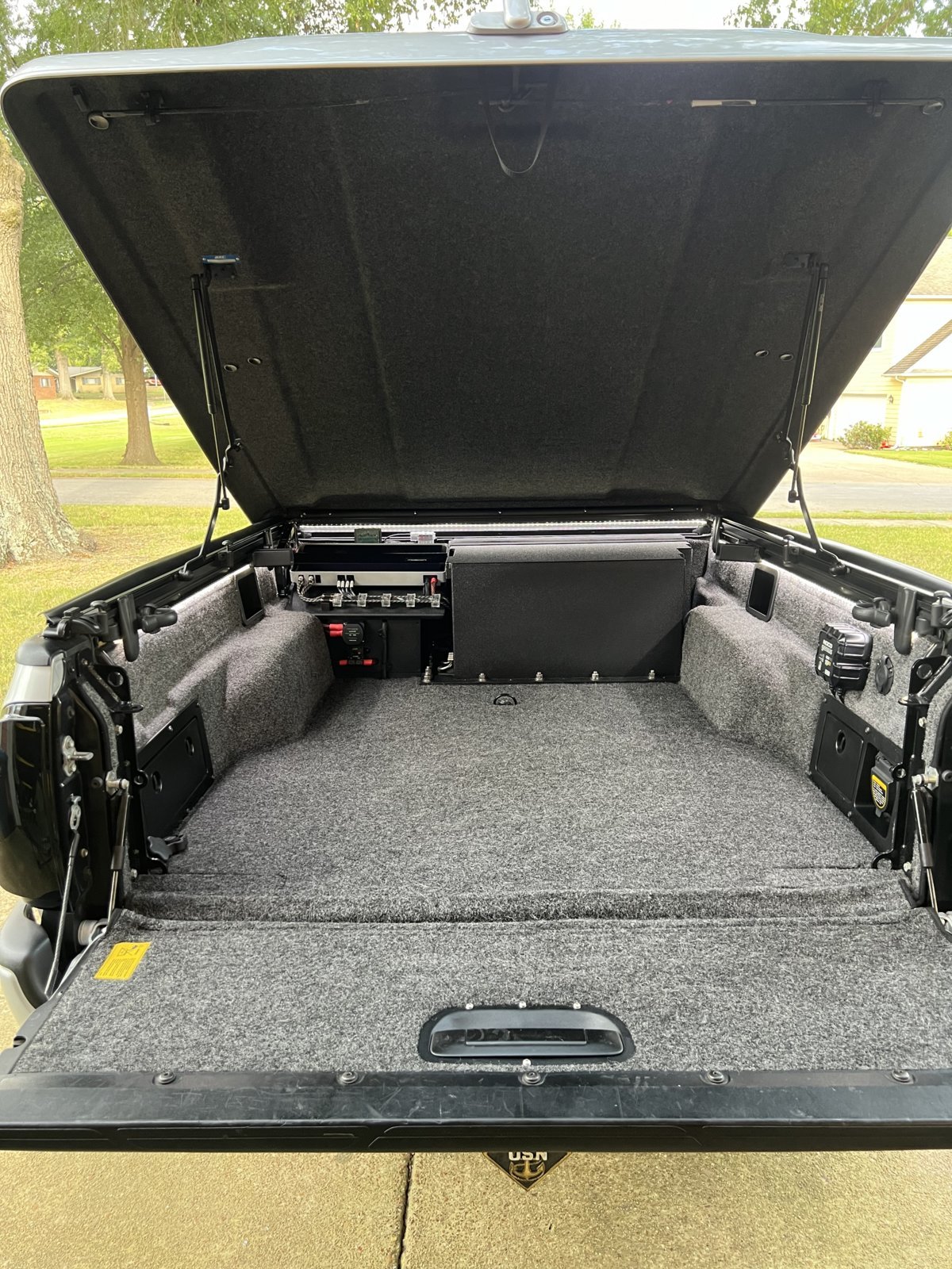

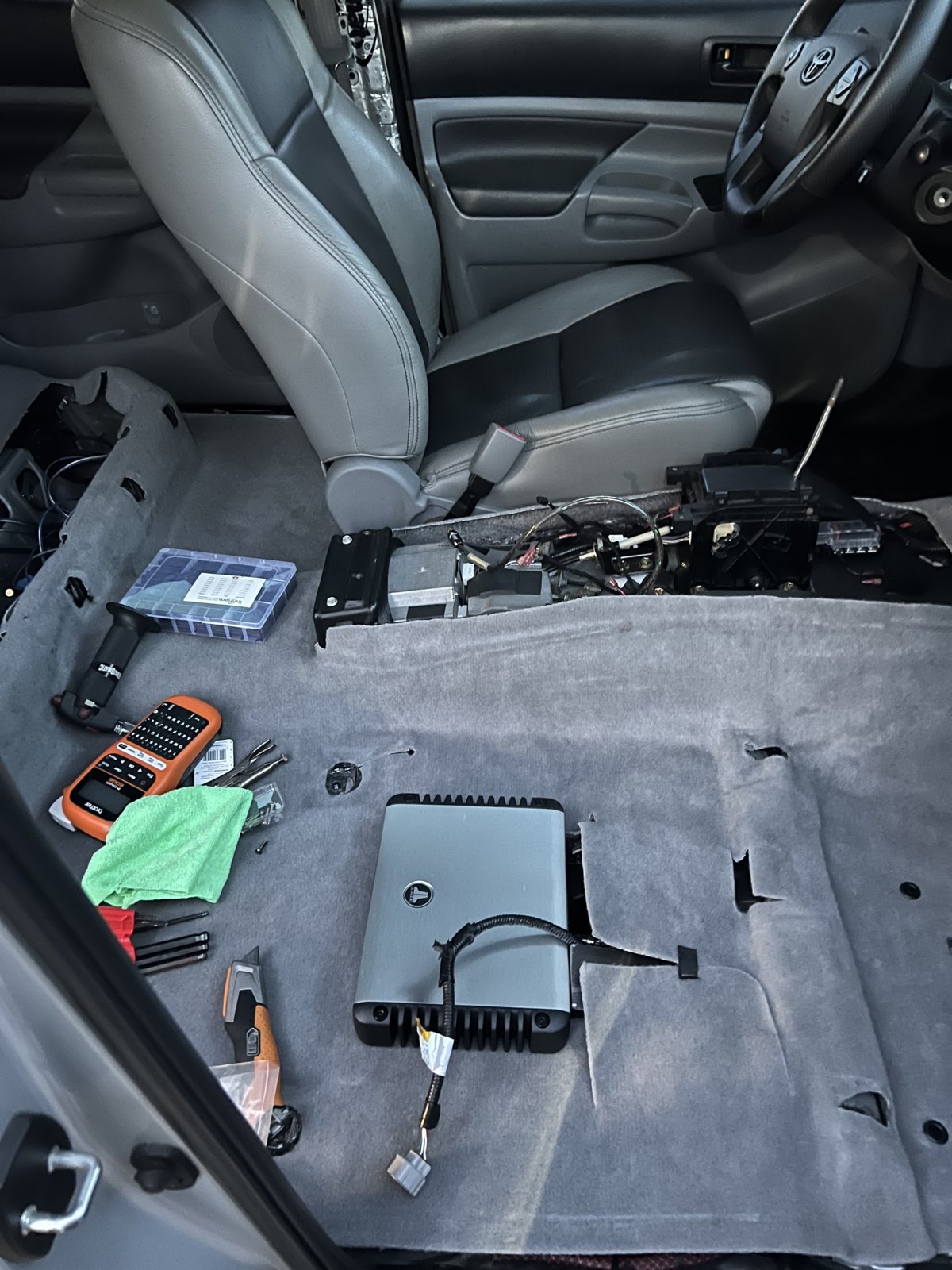

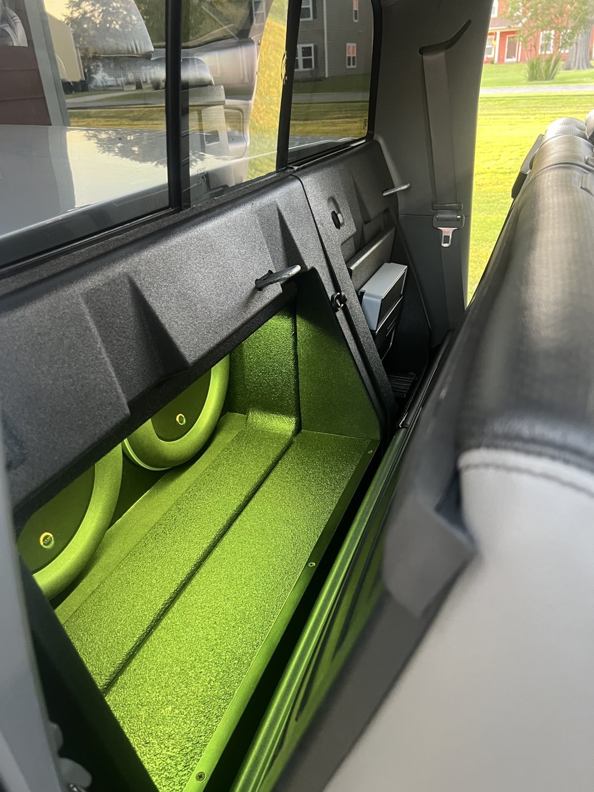

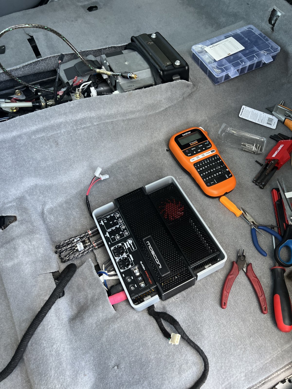

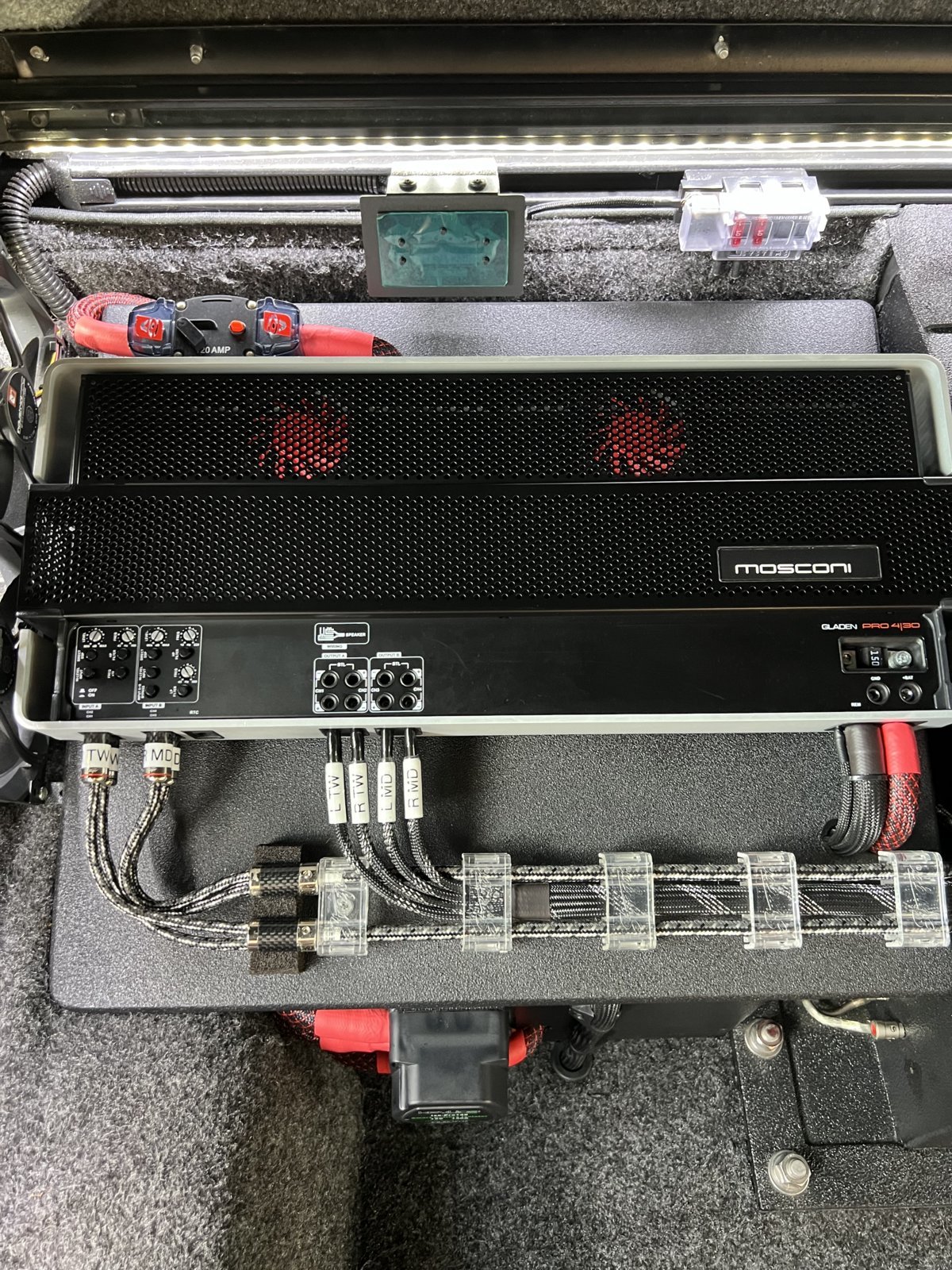

    IMG_8131.jpg IMG_8134.jpg IMG_8136.jpg IMG_8137.jpg IMG_7772.jpg IMG_7770.jpg

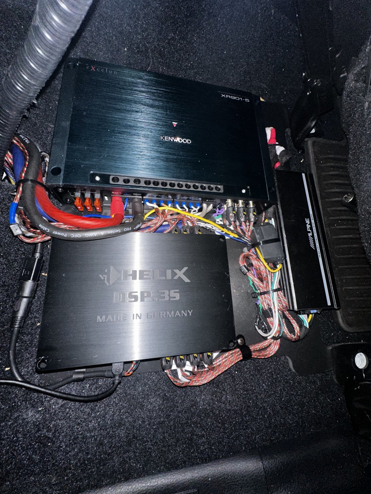

    Thanks!
    It's not the prettiest thing, but it was originally setup as a "temporary" setup. Ended up jumping the 4 gauge to power the DSP and the mini amp, used 9 wire for the factory speaker locations AND had to run an additional pair of speaker wires for the tweeter. EVERY speaker wire is harnessed at original amp location behind passenger rear. ZERO splicing/cutting into any OEM wires!
    I may buy a pair of seat jackers for additional clearance. seat harness does rub and now has some scratched up electrical tape.

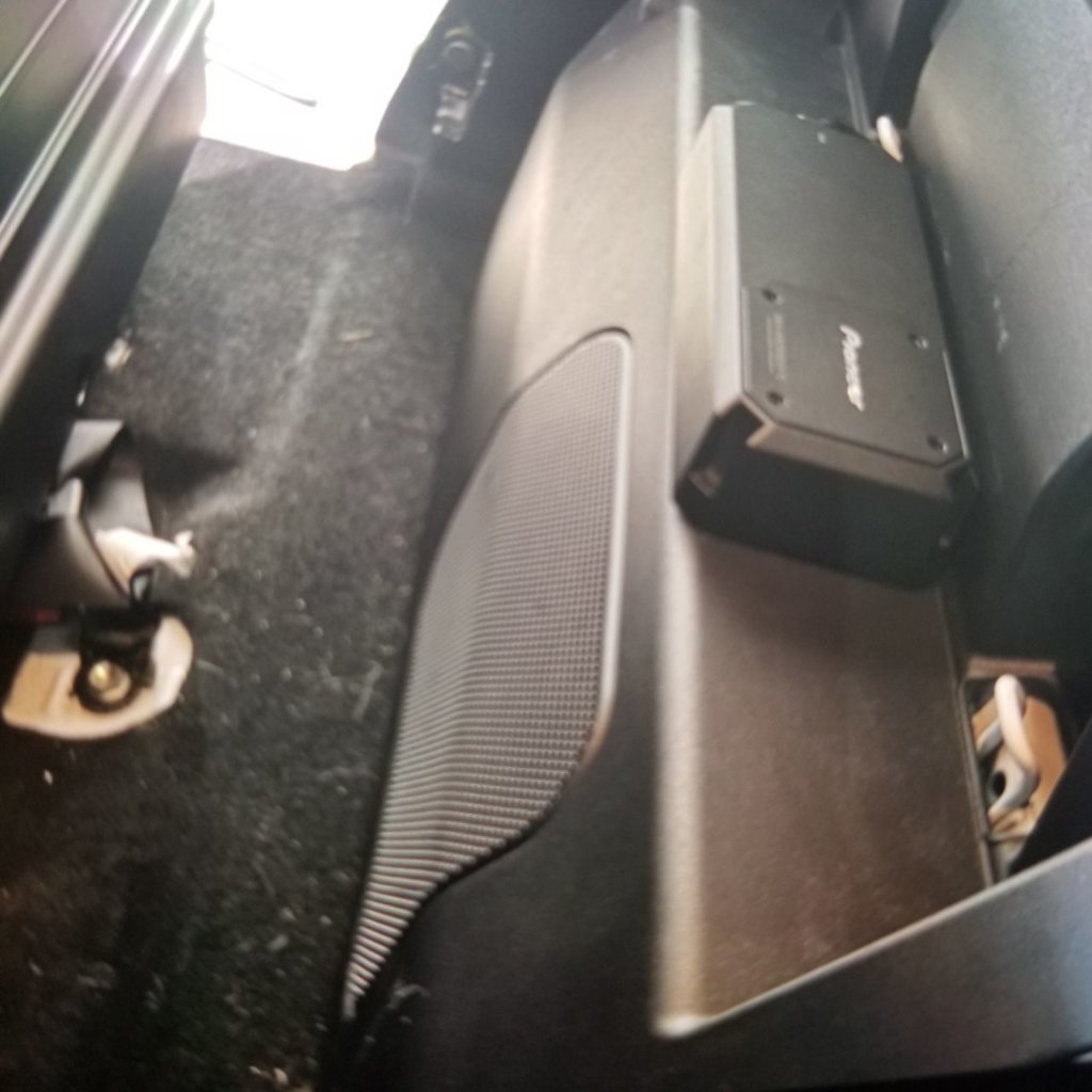

    Small amp is small. Want to get the 4 channel version and put them both there but the thing is $250 bucks and I ain't about that.

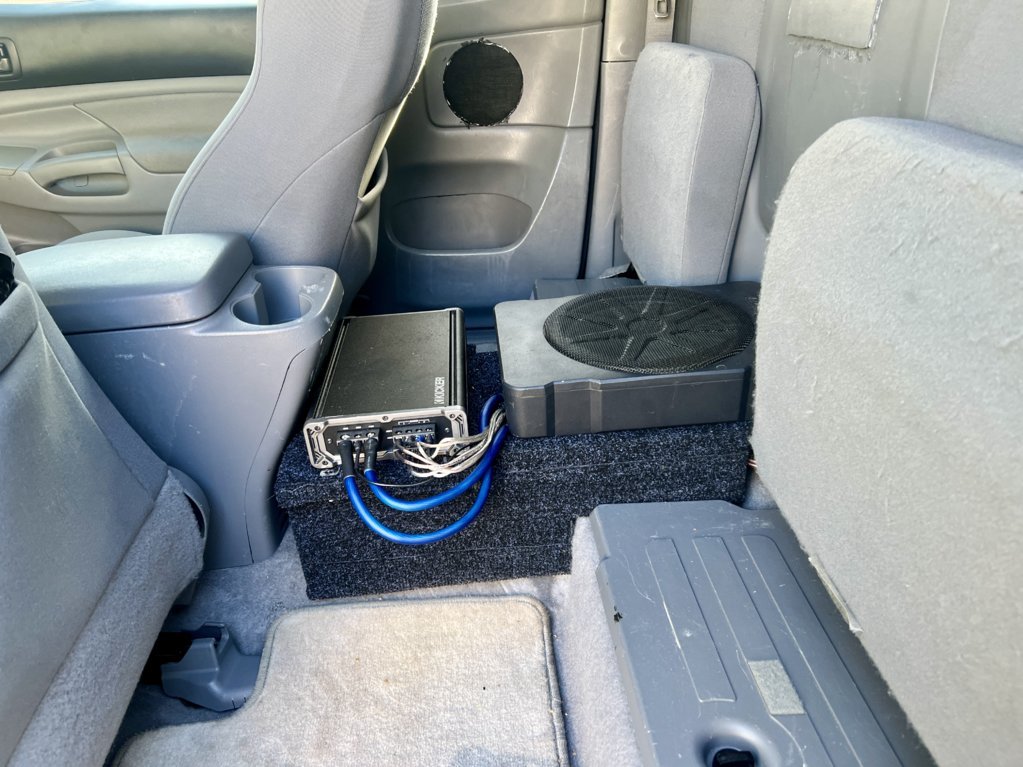

    I made this lil guy for my access cab. It’s definitely not art, but it’s my first time doing all this myself!
