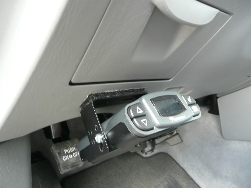

    I used screws, but I just used my own since I got the unit used off of Craigslist.
    When I don't tow, I take the controller out, and leave the wiring harness in the holding bracket. I use the same velcrow that you use to wrap your computer wires to hold the wiring harness in there.

    I really like the spot still have my leg room

    That is the same controller I picked up...I looked at that spot but wasn't sure I could figure out a way to get it level. Did you use the short screws that came with the controller?

    My buddy installed it i beleive what he did was offset the controller in the mount one peg higher than the other

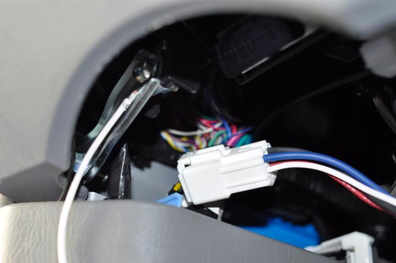

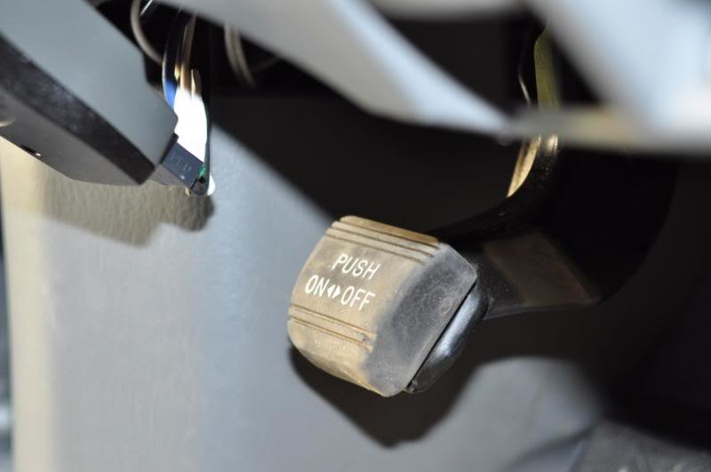

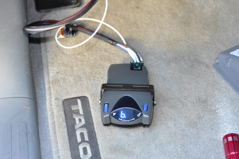

    Here is my Prodigy P2 install
    Connect wires, truly Plug and play:) White wire is ground
    All systems Go!!!

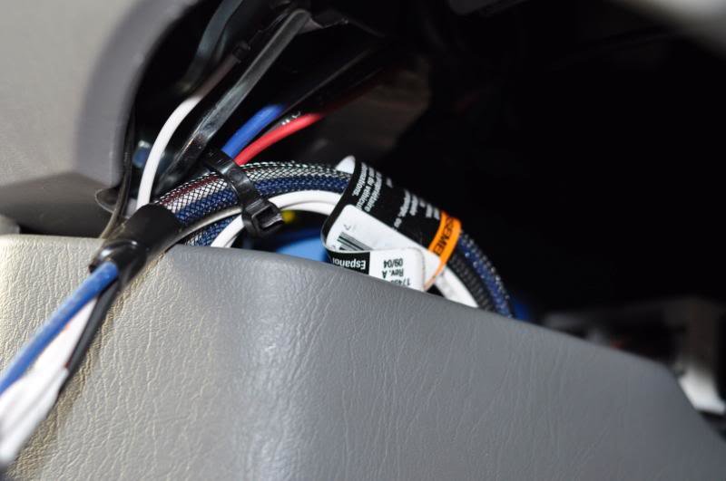

    Tuck in the extra wire

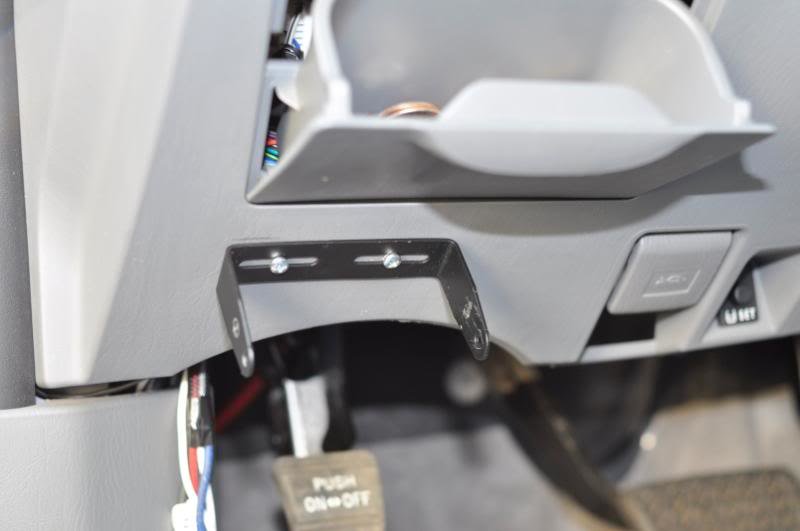

    Mount bracket. I still have the use of the coin tray
    Mount unit. to bracket
    I like the location, It is out of the way when I don't need it and it is easy to reach when I need to adjust it. You may think I would kick it all the time but that is not the case. I hit it with my foot very rarely.

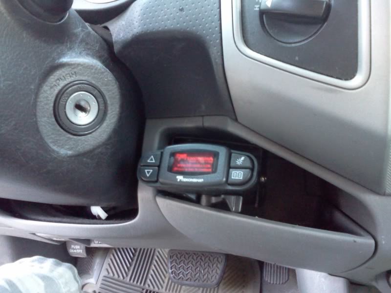

    Pics:
    It's a Hayes G2, works real good. Sooo much better than the timer style I used to use.

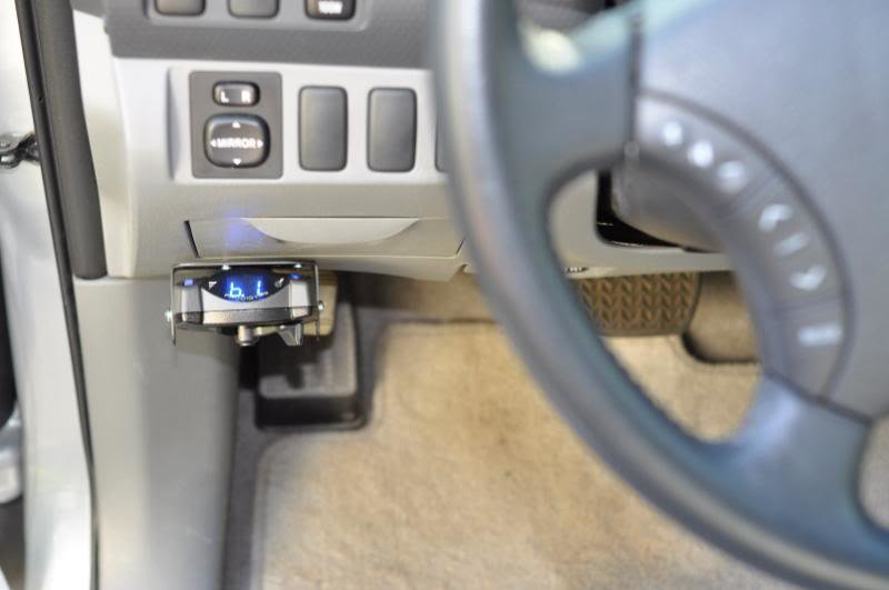

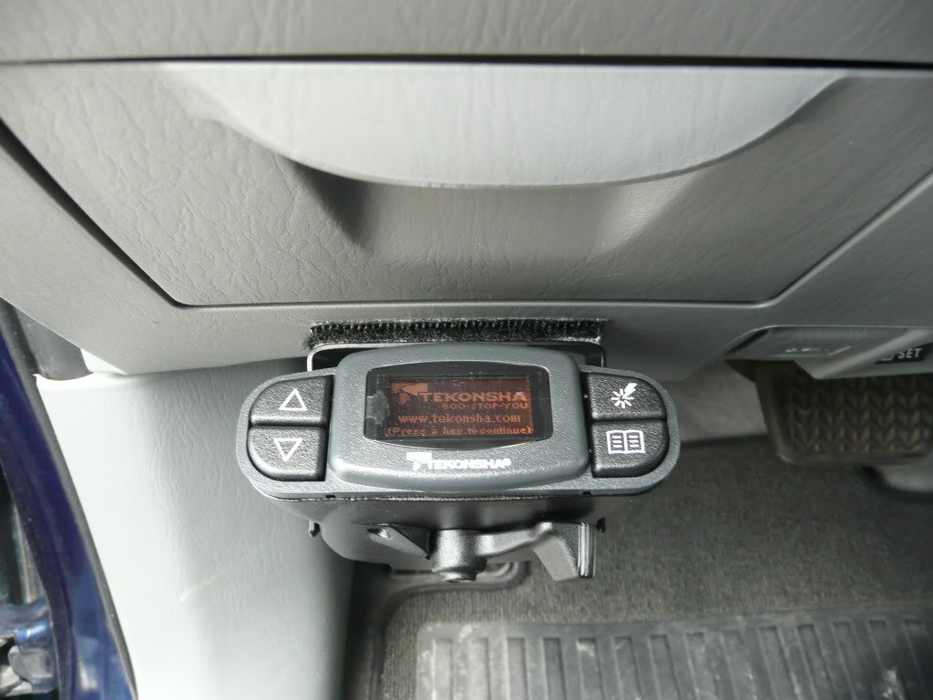

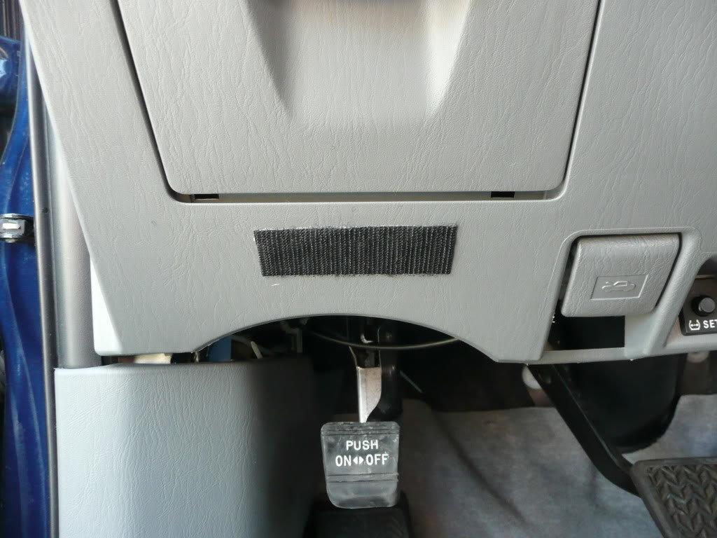

    Well, I installed my brake controller after much debate on the location. I went the easiest route, I mounted mine down on the left side by the parking brake pedal. I am not a huge fan of drilling holes so I used some velcro my father in law brought home from his work to mount the controller. It is called "earthquake" or something like that...it is some good stuff (even tho it looks like it is peeling off the dash panel, I assure you it isn't). Now I can just unplug the controller and take it out of the truck when I am not using it.
    Installed
    Controller removed and the plug tucked behind the dash panel.

    ^ I just hope the velcro holds up and it doesn't fall (heat might weaken the adhesive)
    If I didn't have a clutch, I woulda put it under the coin tray also :(

    It seems to do okay when the cab is at "operating temp" (not so bloody hot), I just threw it on for the pictures when the truck was hot inside. If the velcro doesn't work out I will just end up screwing it to the dash right there.
