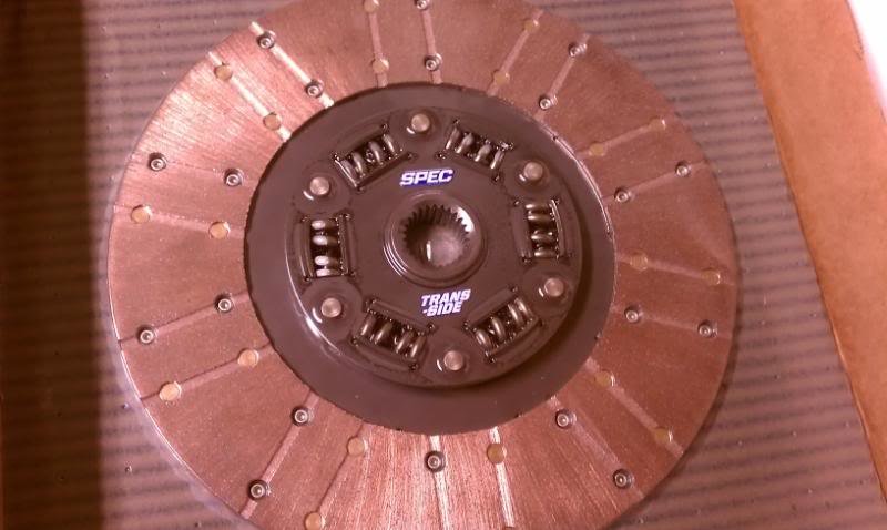

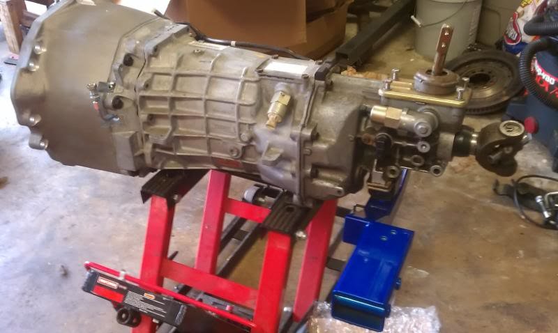

    My new upgraded transmission, getting ready to installed. Woot!

    Its a T56

    Its says in his signature that he has T56 waiting to go in :eek:

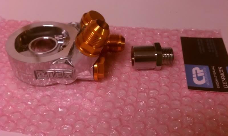

    Greddy Thermostatically controlled oil cooler sandwich plate. Already have the Setrab Oil Cooler. Just need to get lines and AN fittings.
    www.240sxmotoring.com Thread adapter is 3/4 x 16 UNF

    umm.... the 1GRFE already has oil cooler from the factory...

    Not all of them and its not air cooled, it uses a method called thermal siphoning where warm engine coolant cools hot engine oil, its alright but its not the best method in this situation. Its most favorable situation is cold starts.

    Correct. Thank you.

    I pulled the factory one off and sold it. Let me ask you a simple question. Have you ever seen a race car with a oil cooler like the ones on our motors?
    Nope. They are not as efficient as an air to air oil cooler. As a matter of fact, my Setrab cooler is off of a Ferrari race car. :cool:
    They simply transfer heat back and forth between the two. I don't want that heat transfer going back and forth on my performance build because it will just keep things hot.
    Thus the upgrade to remove that saturation/soak between the hot engine coolant and hot oil, by installing an air to air cooler.
    Upgraded with this.
    http://www.frsport.com/Setrab-619-Oil-Cooler-6-Series-19-Row-M22-Threaded-Ports_p_26104.html

    Not a problem my friend. Another way to look at it since you are turbocharged cooling engine oil is top priority for prolonged turbo life (and engine life) meaning protecting the seals, shaft, turbo wheel, oil lines, etc from high egt's and hot oil.

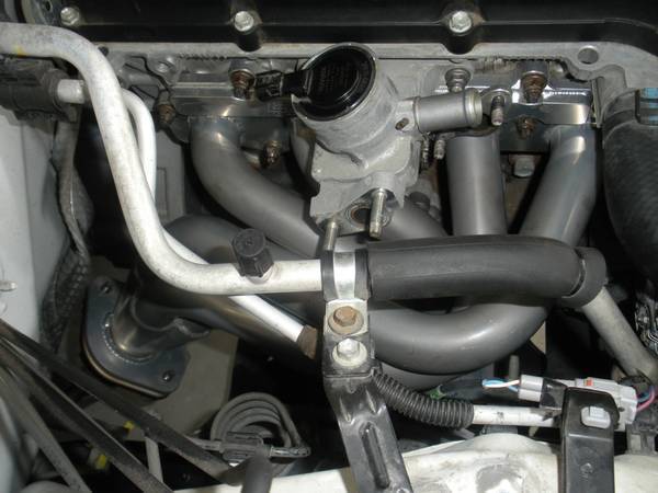

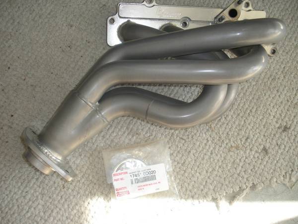

    Actually the long tubes give more low end torque than the shortys but but mostly if used with the cats for the back-pressure. The shortys are better for top end horsepower.
    I havent had either but I prefer the TRD SC because its more compact and gives better low end power. One day I plan to go single or twin turbo with the TRD SC unit. And a built bottom end of course.. soon as my brother returns my truck ill post pics of current mods..

    I regretfully inform you that you are incorrect... Long tubes dyno:

    Ummm....both improve scavenging over the oem manifolds but at different points due to limits of there design.
