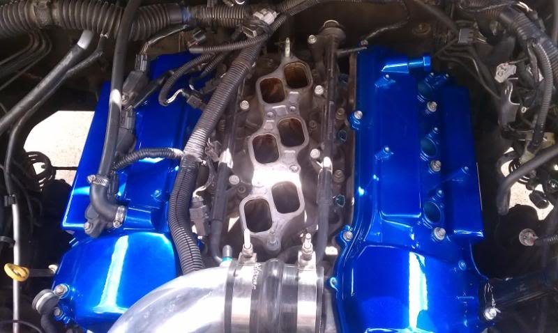

    Not performance, but makes everything look faster.... Got to be worth at least 2 point.:rasta:

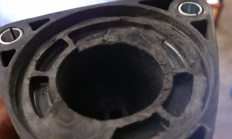

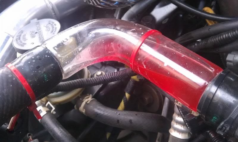

    Here are two more....
    And Customized housing to fit 160*Mr.Gasket T-stat.

    I want :(
    (looks great:cool:)

    Jollipop Blue. Non metallic. Usually $75. Get it done son!

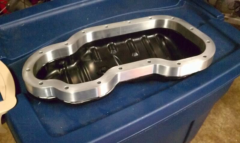

    This is the oil pan spacer. I went to Coupe after a motor rebuild of mine. I have a 4x4 oil pan since my truck is 4x4. However the motor that I received had the PreRunner/Xrunner shallow oil pan. Not good for doing any high speed turns with transitions. The factory depth will create a low oil or cavitation problem that will starve the crank and rod bearings.
    Happened to a few people I know, that had this style pan. So I convinced him to make this. He also took it a step farther, and created the deep oil pan with baffles. Beautiful piece, I must say. :D
    This piece is prior to going on my girl's XR. Added about 1 1/2 quarts.

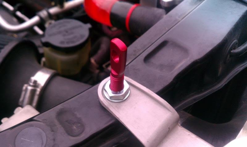

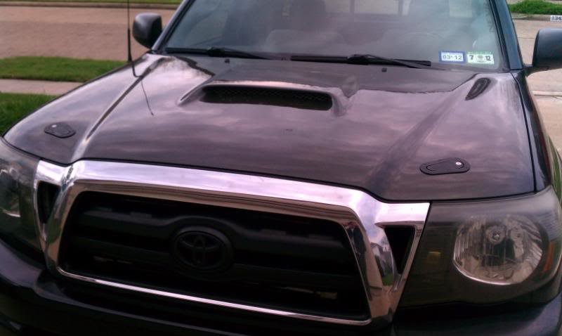

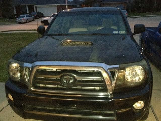

    My newest mod, Aerocatch hood latches.
    Edit, here is a better picture:

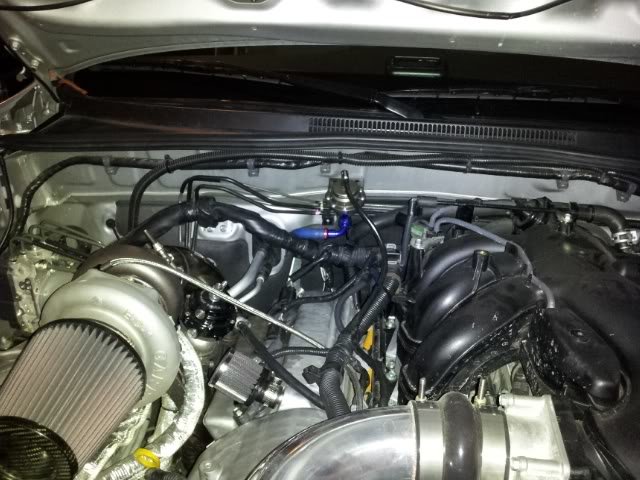

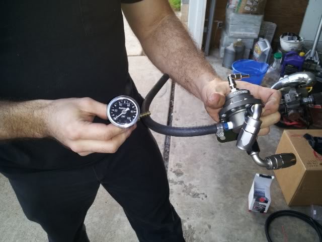

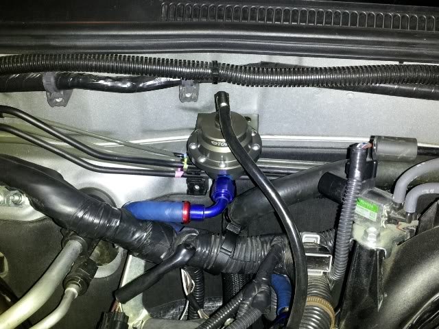

    Something we did to Toon's truck this past weekend. Ended up needing one more fitting, so we had to make it work with one of my spare hoses and blue fitting. It will be the silver is one once we get the fitting in though.
