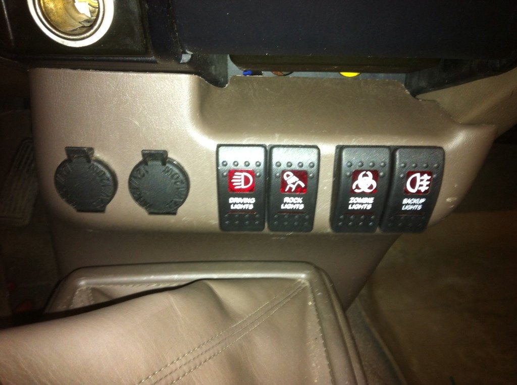

    This is very similar to mine. I have the same driving lights switch and a differant reverse light switch. The other two switches on mine are an ABS kill switch and a switch for my inverter. I'll post some pics in a few days.

    I have the same ones as the first set. The only thing I would say I don't like about them is that you can't see the label at night. I have 4 switches and just installed them so their new to me. I'm sure I'll have them memorized in not time. However, my concern is more for my girlfriend who doesn't drive the truck as often as I do but she does share the driving when we take it on road trips.

    Does the lower light on, mean that the switch is on?
    Yeaaaah, that's a problem. I think I'd wanna go with something I can see at night (especially for your reason) if someone were to drive my truck at night. So I'm thinking Rockers 2's now

    So on the switches I put in, the lower independent light is wired to my dash light circuit. The upper light comes on when the switch is on (dependent). I have my switches separated by the steering wheel so its easy for me to know what switch controls what.
