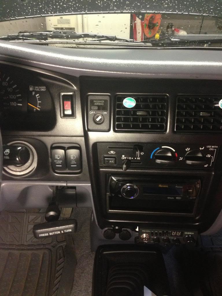

    Forgot to post here. Updated the switch install with some Carling switch panels:
    Have a spare slot now if I ever need it. Thinking about ripping it back apart and installing a 3 panel where the locker switches are. Then I'd have 2 spares.

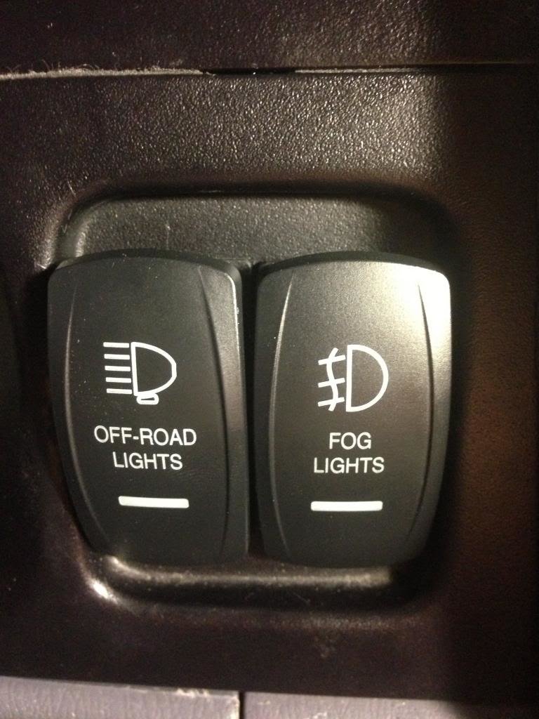

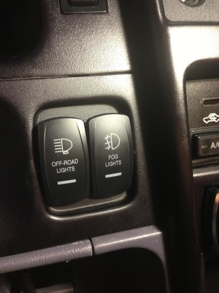

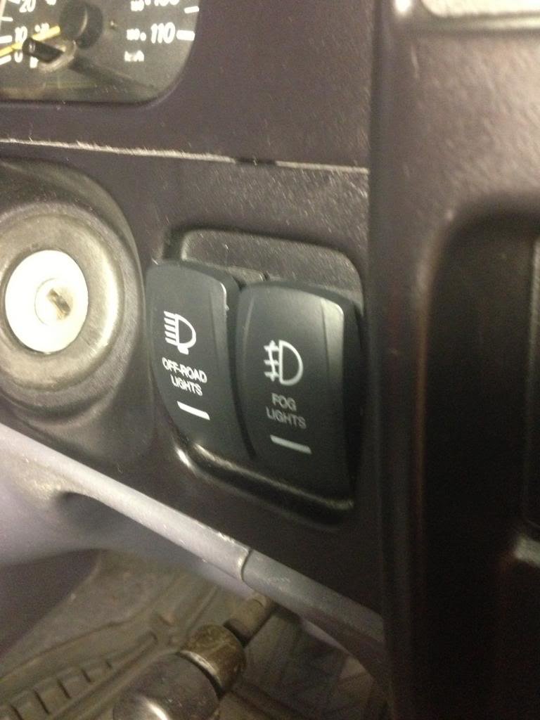

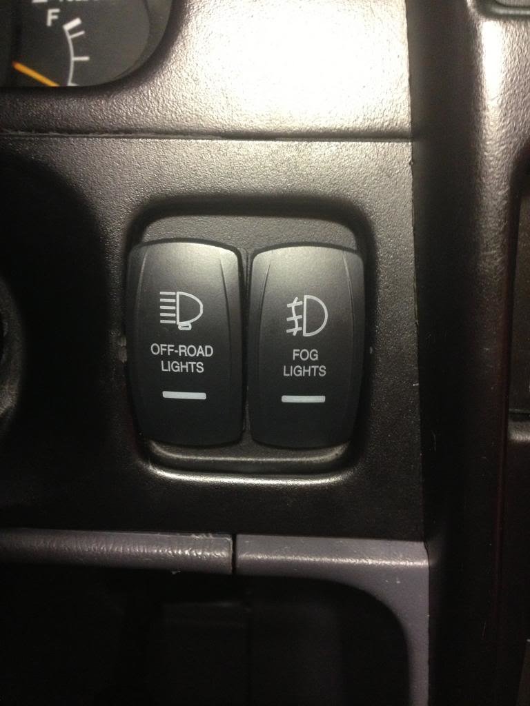

  7. Sep 16, 2013 at 8:21 PM
    #87
    SeattleCoug
    SeattleCoug Washington State University
    Jul 25, 2012
    #83444
    3,708
    Mark
    San Clemente, CA
    2015 TRD Off-Road

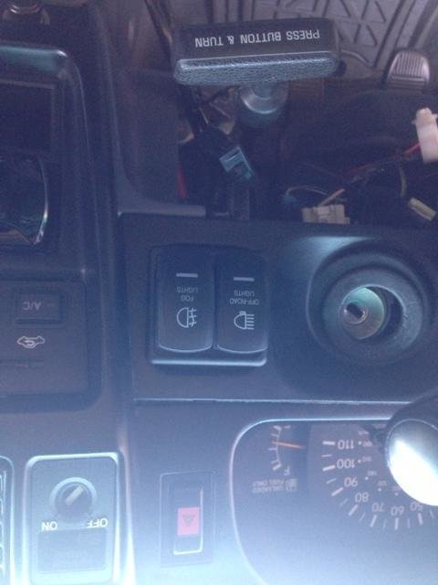

    OTRATTW Rocker Switches
    Far Away View:
    Up Close:
    Up Close Side View:
    Up Close Other Side View:
    Up Close Straight On:
    Wired up to my LightForce 240 Blitz's and Rigid D2's

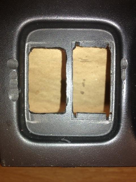

  12. Sep 16, 2013 at 9:29 PM
    #92
    SeattleCoug
    Jul 25, 2012
    #83444
    3,708
    Mark
    San Clemente, CA
    2015 TRD Off-Road

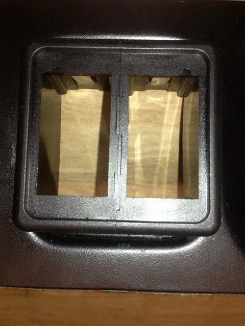

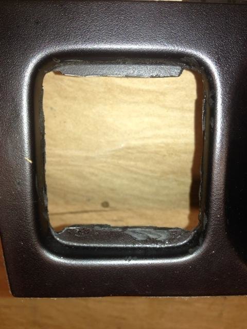

    This would be a perfect cutout -- except I messed up on the sides with the dremel:
    You want it to be as close to the sides as you can get it, but make sure you leave a little bit of room as the front of the switch is a bit wider than the backside of the rocker switch. The left cutout doesn't look as clean, but the rocker covers that up with the front width. I keep harping on it and I'll say it again especially if you only get one chance to do it, IT'S A TIGHT FIT. I luckily had a few so the first time didn't matter as much.
    My first try I really messed up so I just did this:
    So I could insert the panel:
    But I ended up not liking it when I compared the two looks:
    As opposed to this:
    Hope that helped :thumbsup:
