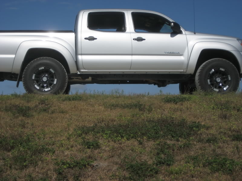

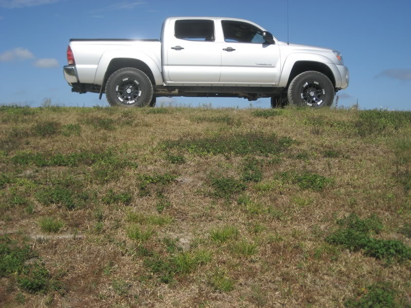

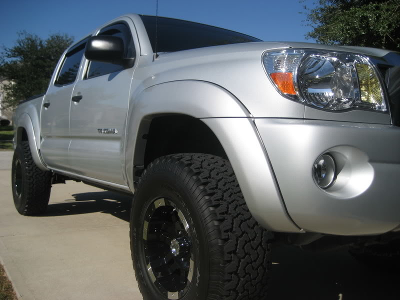

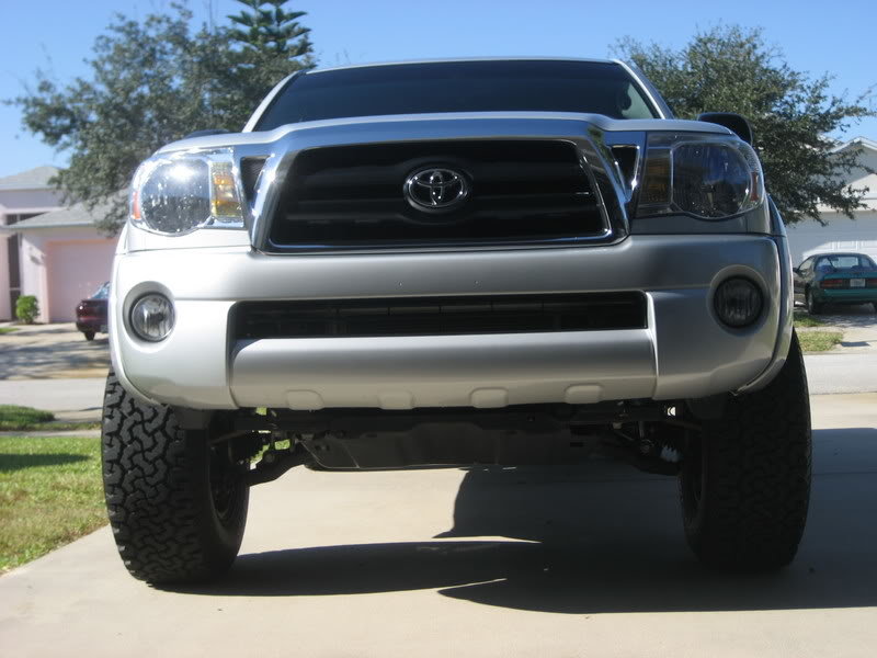

    5100 at all 4 corners
    fronts at 2.5
    rear leaf tsb - its starting to sag now, im gonna throw a 1" block back there
    wheels = 16x9 moto metal 951b
    tires = bfg at ko 285/75/16

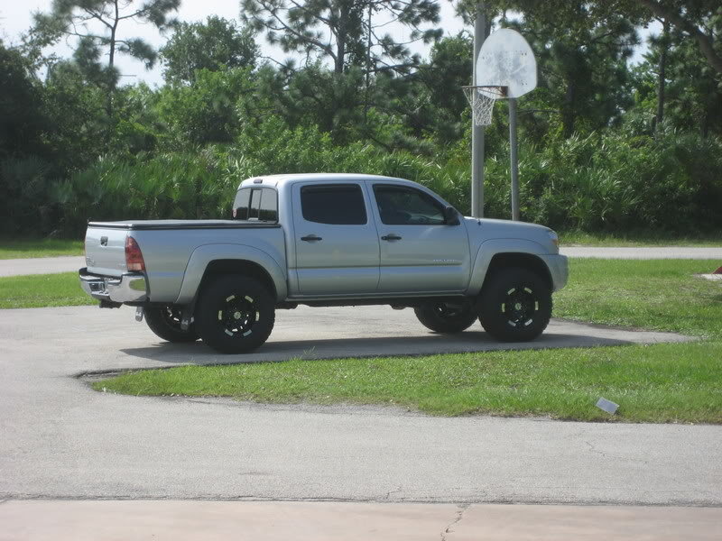

    heres mine. (4) 5100s, front at 2.5. rear w/ tsb and 1"block.
    wheels are 285/70/17s (33s)

    ^sexy man.
    does she sit about level with the 1" block?

    ya its pretty damn close.

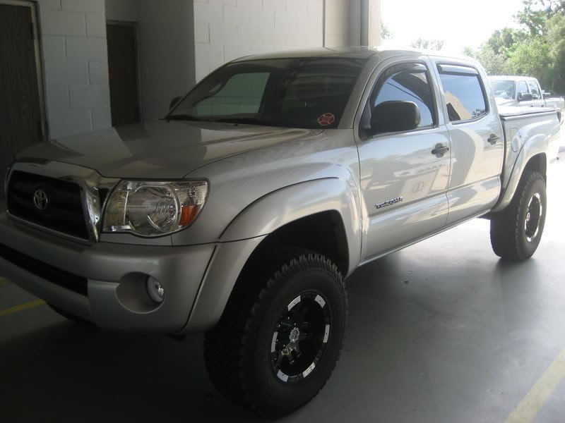

    BLHM, Grillcraft grill, painted grill and eyelids. 285/70/17 BFG's on 17x9 Pro Comps 5100's all corners
    5100's on 4 corners...front on 2.5

    i rubbed at full lock. i trimmed some of the inner fender well with a dremmel and it hasn't rubbed since.
