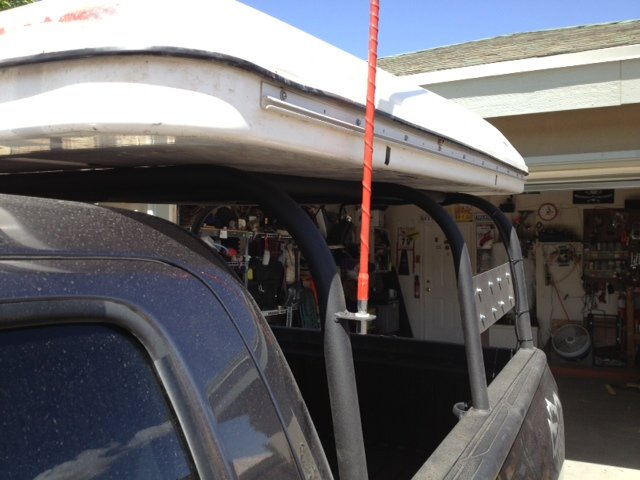

    Here is where mine in now with super high SWR.
    My SWR is through the roof. I just ordered my own SWR Meter and a BAMF tailgate mount. I am hoping this helps to fix my issues. After swapping out a bunch of different pieces the issue seems to be with my antenna, mount & or Location.

    When you put it on the back of the bed just tune it and you'll get a much better swr. I had mine in your location, even a 4' firestik.
    I relocated it to the back of the bed and now I have a perfect swr.
    I found the problem with the bed rails is they don't provide a ground. If you wanna keep it there it'll need a grounding cable.

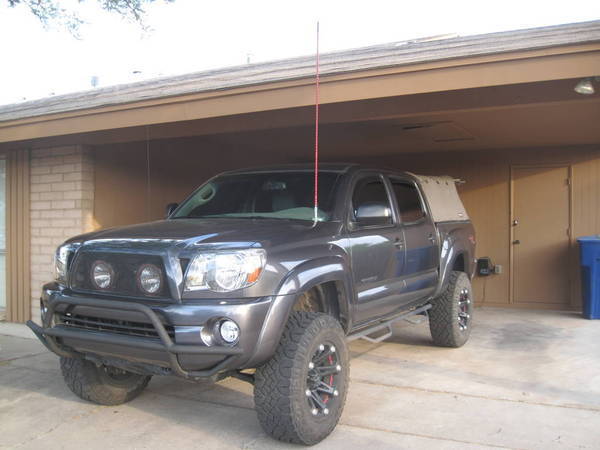

    I use the Relentless Fab hood mount and love it. Wouldn't dream of mounting it in any other location.

    I have it grounded already and the continuity is right everywhere. I also put it on a SWR meter. It was still through the roof. I am going to go ahead and relocate it to a tailgate bracket. Should be much better once I do that. If Not I am going to swap out the Coax. If that still doesn't work. I will make a thread about it and sick all the Tacoma World Geniuses and smart a$$e$ at it.

    Hmm wierd. only other thing could be the short antenna isn't getting high enough over the cab.:confused: I bet moving it back to the tailgate will fix it.:)

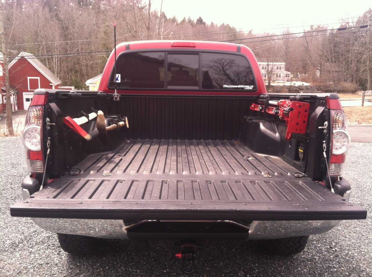

    its a 2 foot firestik. Works well! I have reached out approx. 8 miles, normal NH terrain with hills and mountains and shit. I was also under a parking portico when i tested it. i really only care about how it work when on the trail though, and for that, its perfect, and not too obnoxious, can barely notice it.
    i havent had mine tested with an SWR meter, but i will tell you that it wasnt easy getting mine to work correctly. I have a cobra 75WXST, and hooked the antenna mount up all wrong like twice before i got it right. Then, because im not sure what our bedrails are made out of, and thats what its attached to, i ran a wire from the mount, to a ground on the truck, and that made it a lot better. I just use it on trails, and it works well for that.
