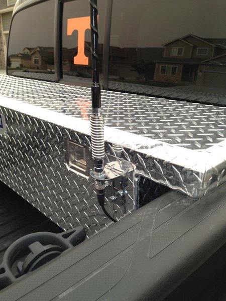

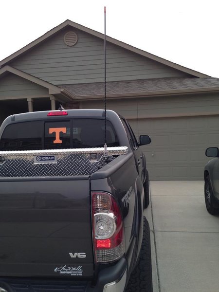

    Newly installed...hope the toolbox holds up! lol

    Nice, good spot for it. Grounded ok there?

    It is now. I grounded the mount since I took the pic. At first I wanted to hold out (until my SWR meter arrives) to see if the aluminum will provide ground conductivity. I got bored, so I ran to Lowe's, got some wire, and slapped it on. It was highly likely I'd need to do it anyway.
