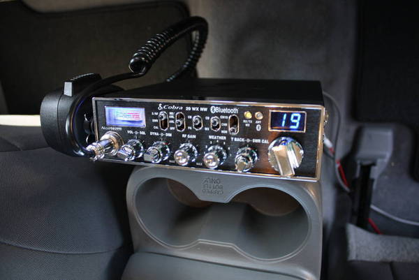

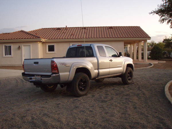

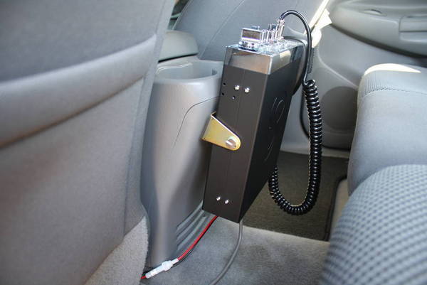

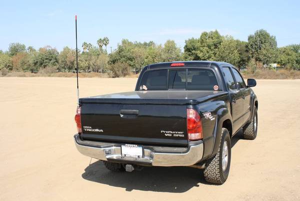

    Just installed mine last week.

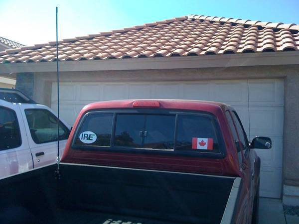

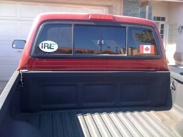

    Here's where mine was...
    I'm about to buy a new mount, coax, and whip and mount it on the front.

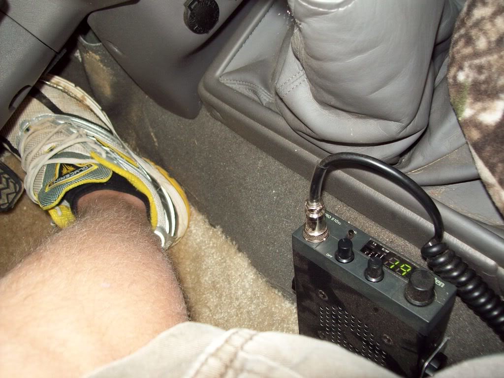

    i did mine a bit different than other people do. i mounted mine on the tranny hump on the drivers side. i found that i can look straight down and see the channel and change whatever i have to without trying to read upside down and the speaker is pointed out so its not speaking into the tranny

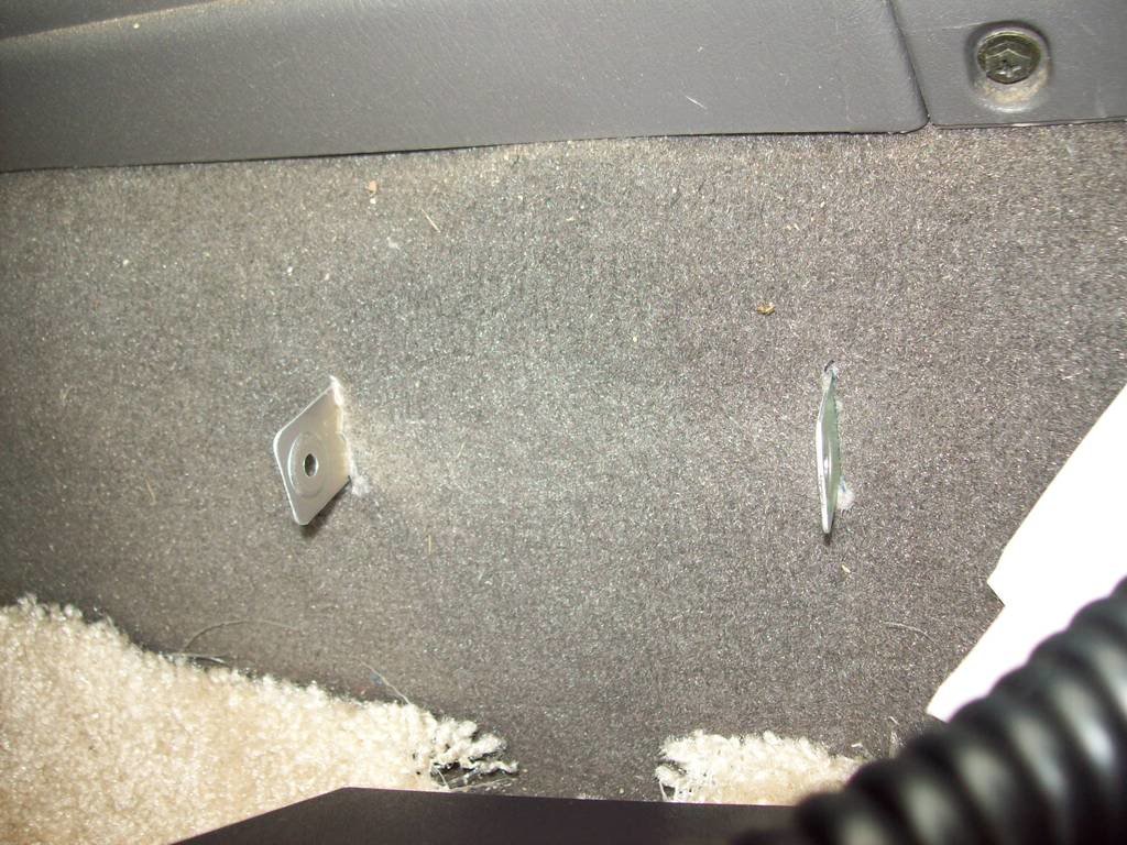

    here is how i mounted it. just cut a slit into the carpet/foam and then use the u shaped bracket and slide it under there. no wiggle and it is nice and low and out of the way

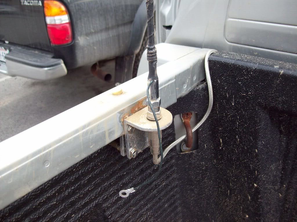

    and here is how i used to have my antenna. i got a tool box so i sanded it down where it rusted and repainted it. i would not recommend doing it like this because the bed there is very flimsy and its not a real good ground. its much better on the side of my toolbox

    I have the same exact CB. I'd love to mount it there, but I have the stock 2000 radio/tape/CD unit which is very big....:( That CB with my K40 antenna really puts out. A great combo.

    Basicly we have the same CB, so far, looks like a good spot. I'm going to tinker with it today.
    I know once I mount this thing, I'll find a better spot, so keep the pics comming...:D

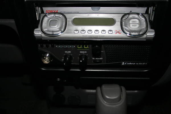

    Connor what'd you use for a filler plate on your CB? I had mine mounted where the ashtray was, but whenever I remount mine I'm thinking about mounting it how yours is (single din CD with CB and places for switches under it)

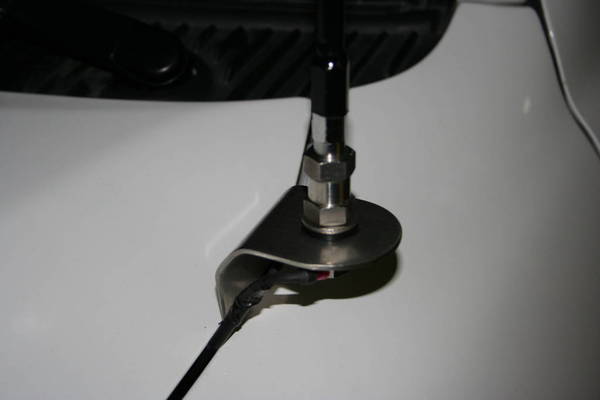

    I would really read up on that. From what I can gather, it will really reduce your reception. I know its clean, and it WILL work, but from what I have read, if you want good performance you need to mount the antenna seperately from the AM/FM. Just my $0.02...
  13. Sep 30, 2009 at 1:30 PM
    pittim
    pittim mittip backwards
    May 28, 2008
    #6939
    17,131
    Pink slider.
    the only info i can find on it is from this thread:
    http://forum.ih8mud.com/electronic-...enna-splitter-firestik-ar-1a-match-maker.html
    i'll be mating it to a 5' whip so I'm guessing it'll work out fine for me.

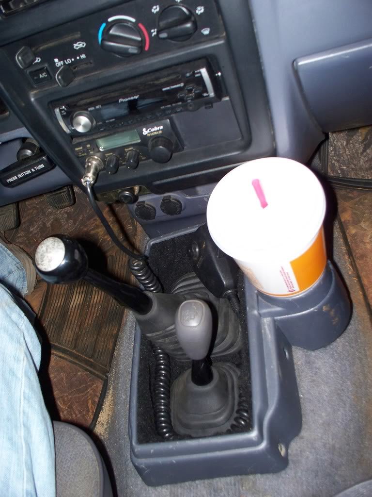

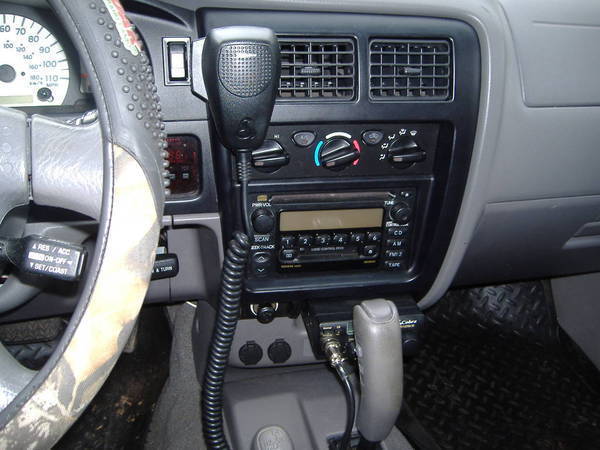

    here is how/where i mounted my cb...
    and the antenna i mounted on my tool box(will have to get a pic of it later).

    Which cobra is that? I like how it fits where the ash tray goes.

    its a cobra 19 ultra 111
    mine came with a clip that its just kinda sits into.
