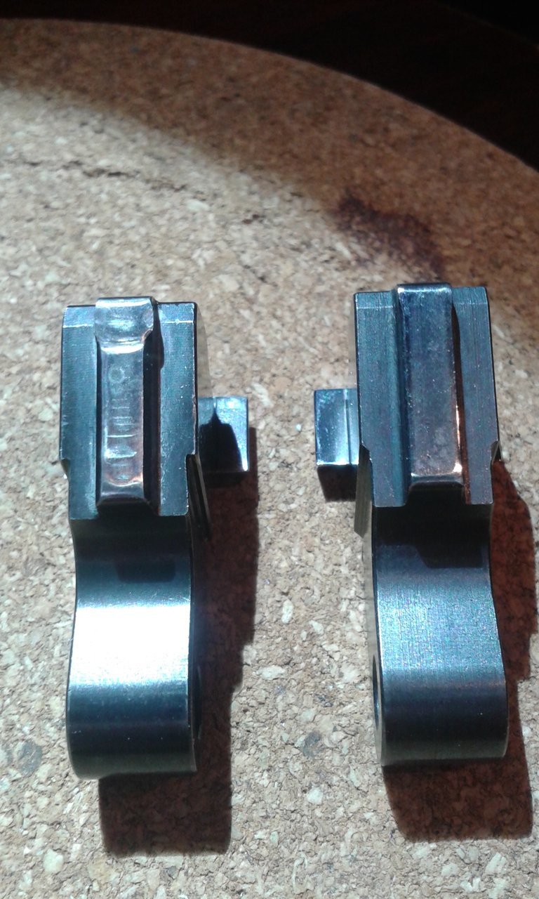

    New hammer on right. "Old" hammer on left after <500 rounds. Old hammer also has a crack on the back side where the disconnect hooks.

    What model did this happen with?

    Scorpion Evo 3 S1

    Is that common?

    The damage to the face is common, CZ says it is normal wear. The round dent at the top is from the pin, the checking below that is from the bolt. I put a radius on the edge of my bolt so it operates smoother.
    The crack on the back is not normal.

    They send you a new hammer?

    Yep. I sent them pictures, they had me fill out the warranty page (about 30 seconds), then they sent out a new one. Thankfully I got it done before they suspended operation for their year end training/inventory or whatever they are doing.

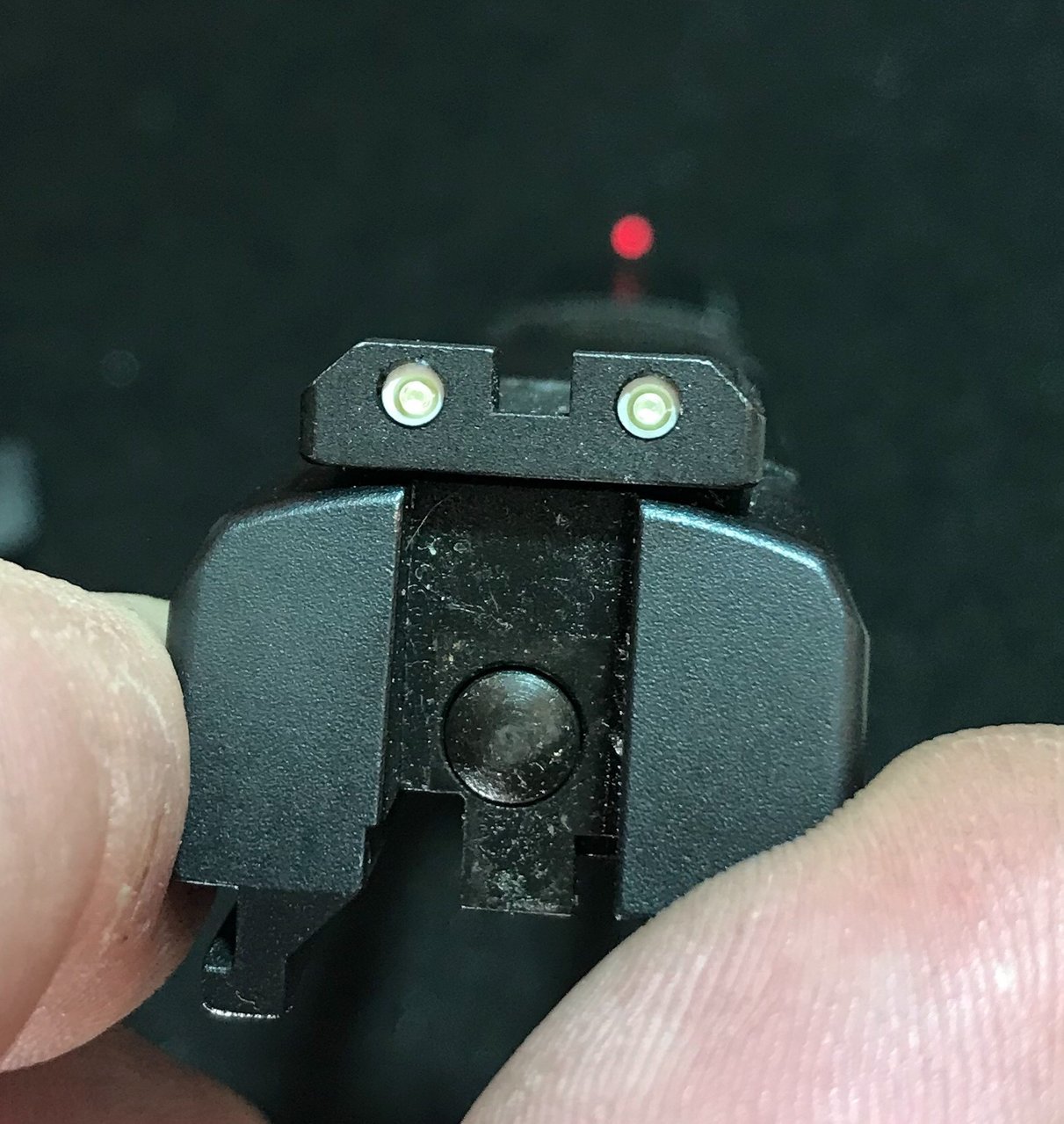

    Swapped out the front sight on the P-07 this am. Looks good, easy swap. Have to go shoot it now
