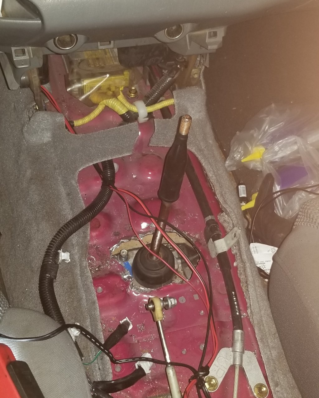

    Forgot a cutting wheel so a stepper bit and side cutters had to do..don't worry gonna clean it all up tomorrow. But it's in. Test drive without front driveshaft and everything is good so far. Now just gotta do the wiring and this turd should have 4lo again :D

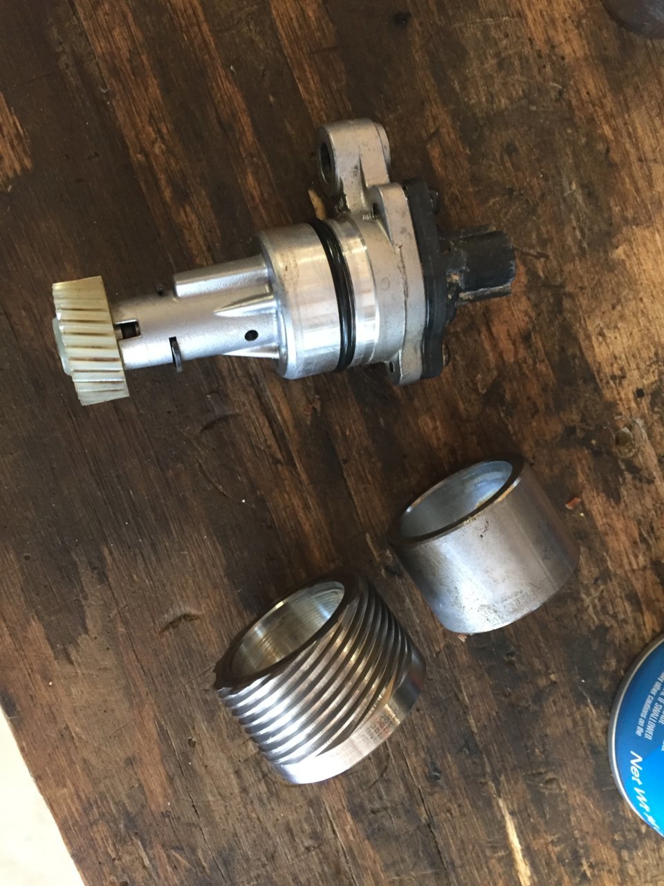

    This time around I used a new 4Runner case instead of an FJ case. The new trail editions us the same j-shift transfer case as the FJ's if anyone is looking for one.
    If you have a manual transmission you'll have to swap the output gear from your tcase to the 4Runner case. The FJ cases have the gear in place even though it's not used.

    What is that bottom picture of? I used a 4runner case and saw nothing of the sort when I broke it apart? Why did you swap from the fj to the 4runner?

    worm gear for speedometer, used by the guys that still shift gears like men.

    That's the speed pickup for the manual transmission trucks.
    I goofed on my first twinstick install and that ended up with the syncro keys landing in the chain and causing issues. I pulled the new case fully apart the second time around instead of trying to do it the "easy" way.

    You should not have to swap the worm gear, just the sensor. The worm drive is already in the automatic FJ cruiser transfer cases.

    The worm gear is in all of the FJ cases, but it's not in the 4Runner cases.
    The 4Runner was an auto, like all of them. My case is behind a crawlbox so I didn't have to swap out the planetary to make the FJ case work. I only had to put the worm gear into the 4Runner case so I could use my speed sensor from my manual transmission taco.
