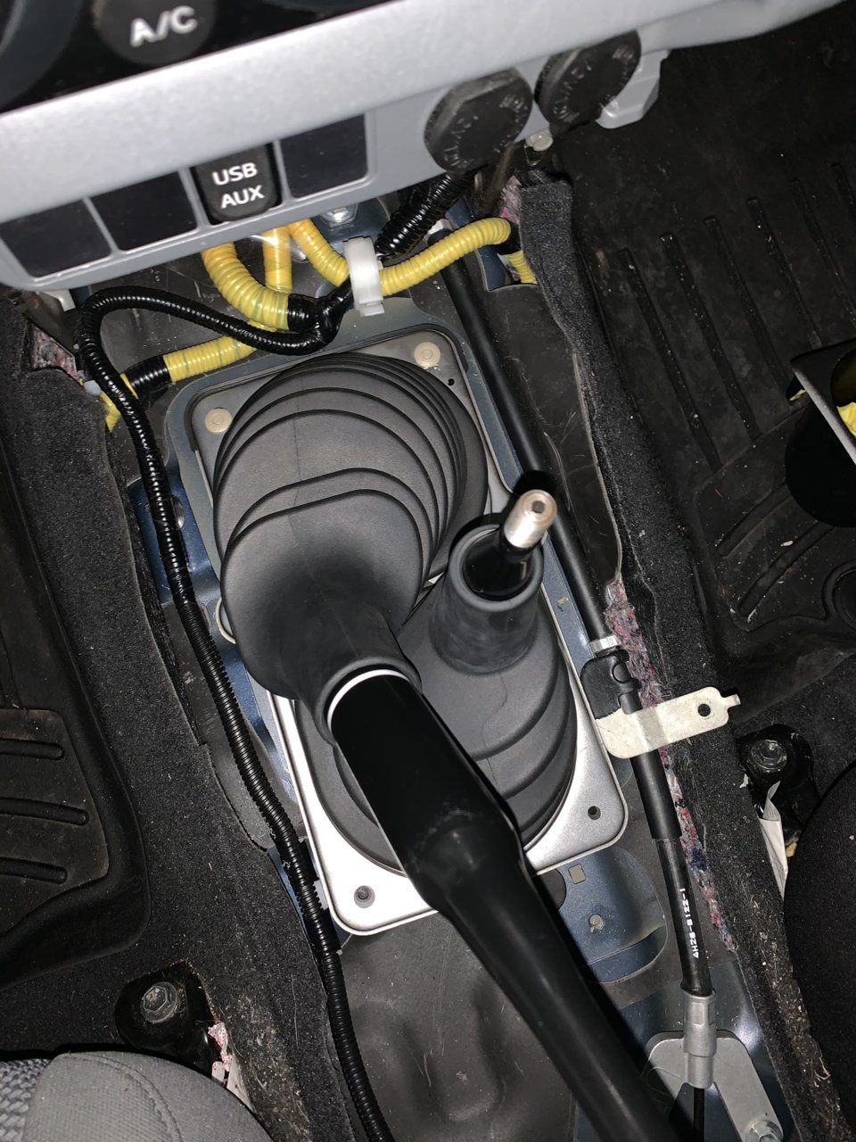

    Sealed the floor today. My original hole was a bit large but it ended up working in my favor. I was able to remove the shifter very easily while making it.
    I couldn’t find any shift boot that would work for me so I bought this smaller boot and used some 14 gauge to cover the gaps. Sealed it up with rtv and used self tapping screws to secure it to the truck. Then covered with sound deadener.
    Spectre Performance 6285... https://www.amazon.com/dp/B00062ZI1S?ref=ppx_pop_mob_ap_share
    I also wrapped the shift lever in sound deadener, as well as some gorilla tape. I’m hoping that’ll act similar to oem and keep some noise out of the cabin.

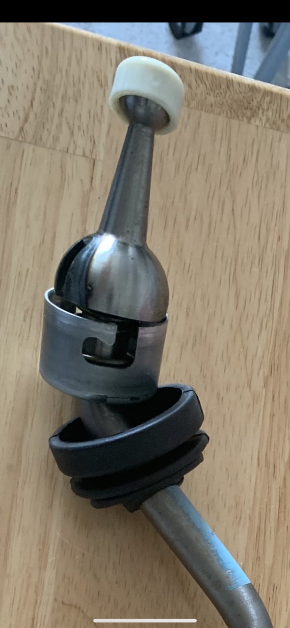

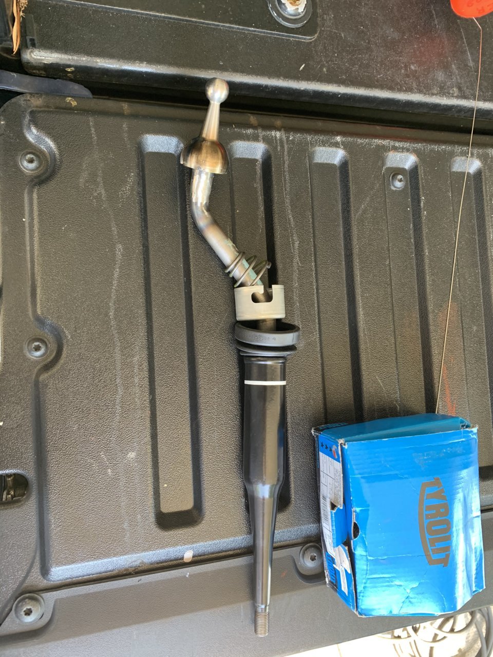

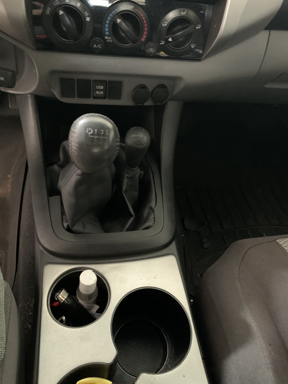

    So I remembered I have a good friend who’s a commercial metal fabricator so instead of waiting for the FJ part we just combined the Tacoma and FJ shifter. It required us making a new shift boot wire thingy, because to go in reverse it required moving further towards the driver side than originally intended for the shroud that connects to the console. But all in all I think it came out pretty clean and factory looking!
    0383FC99-5B1C-4B0D-B5D9-CFD90208F7C3.jpg0383FC99-5B1C-4B0D-B5D9-CFD90208F7C3.jpg3B8A18E2-C65D-46D3-9A74-147363E548E5.jpg
    Below is 6th gear in 2hi
    314DD6DE-10BC-4A86-9A49-CF08214A0571.jpgAnd the finished product

    I used the MT FJ boots. I took the metal brace from the Tacoma boot (square metal piece that secured the pleather shift boot to the plastic, I don’t know what it’s called) and used it to hold the FJ one in place if that makes sense. It filled out the hole nicely.

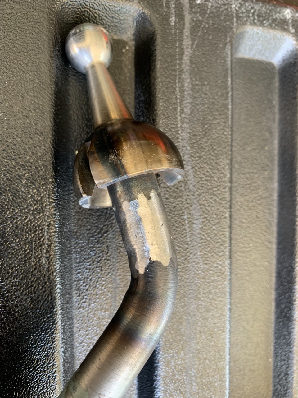

    The only difference I could see, other than the obvious dog leg bend, was the part that goes into the top of the transmission, that has that bushing on it, is longer on the FJ shifter than the Tacoma. It would plug in just fine, but it wouldn’t let me shift into reverse. So we welded the bottom of the Tacoma shifter on the FJ shifter and it solved that problem.

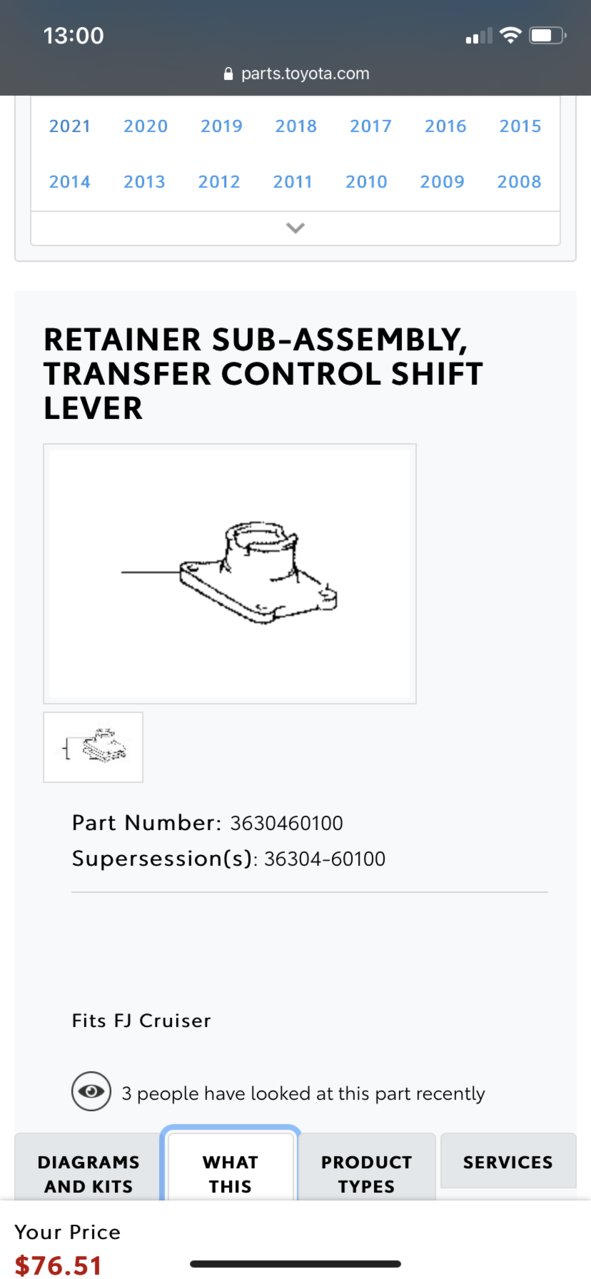

    For all I know they used the same transmission, however this part number is different for FJs and Tacoma’s. See the attached pic

    The end with the ball that goes 8nto the trans is a little longer on the fj. I can see that now with the side by side picks. That is why the base was needed. So for all who what to do the fj shifter you will need the complete assembly.
