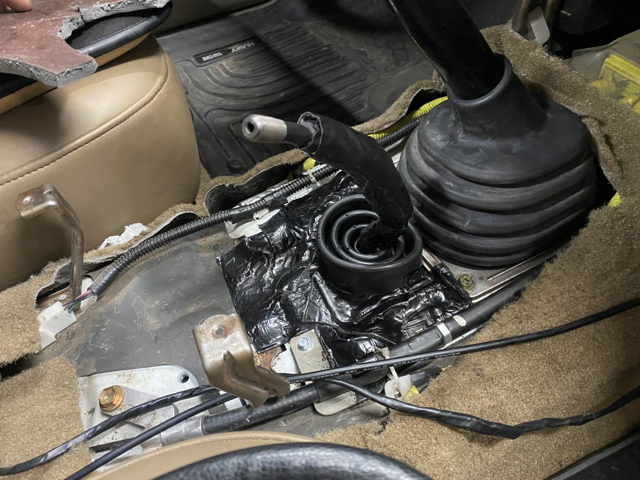

  14. May 6, 2021 at 9:41 PM
    #2014
    Mech1txs
    Mech1txs Well-Known Member
    Feb 17, 2021
    #356479
    293
    Troy
    Nor-Cal
    06 single cab manual FJ swapped add delete

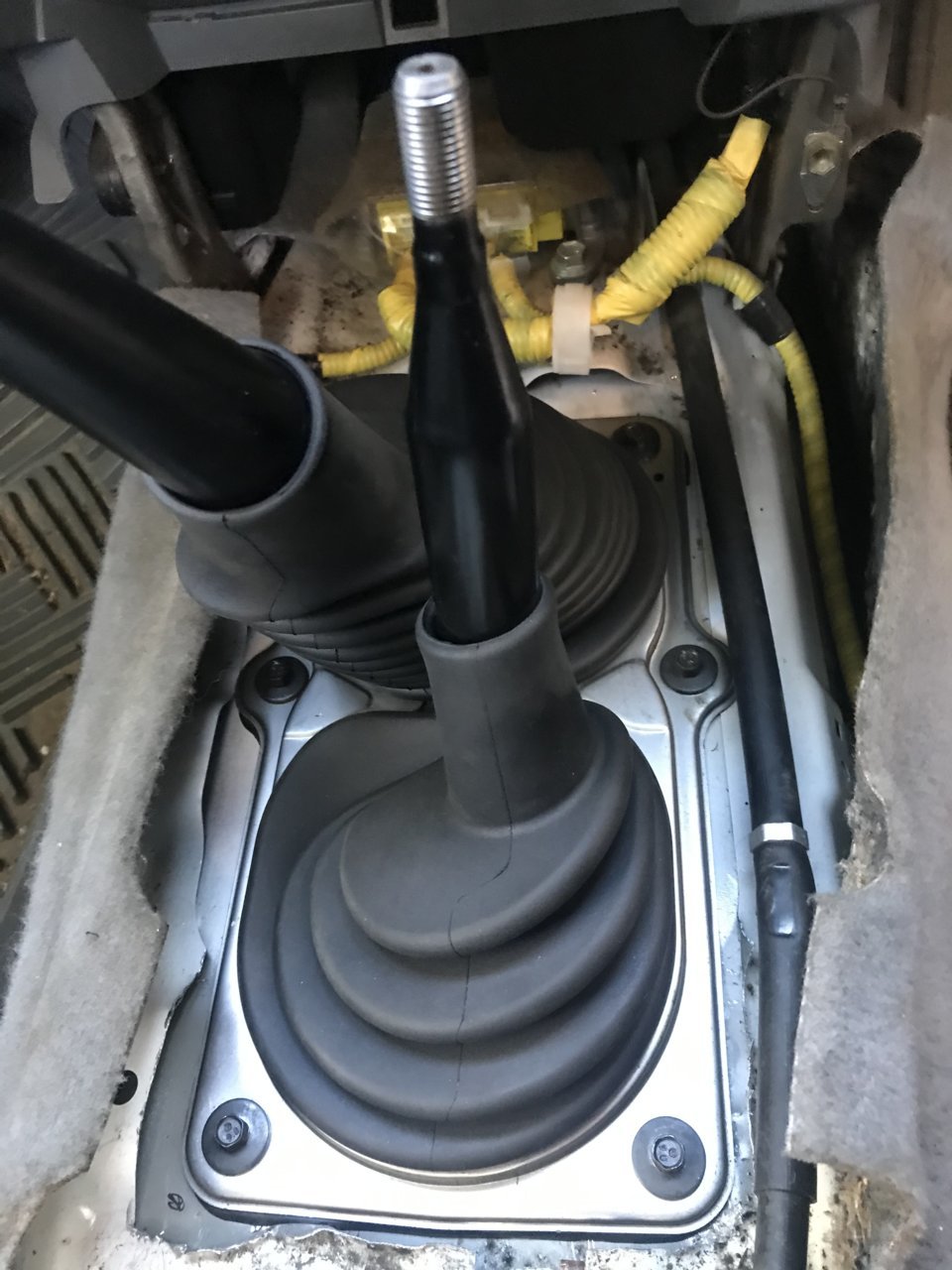

    Been driving mine for a few months now and it’s the best upgrade I could have done for my stock taco , thanks again to everyone that helped in this thread .

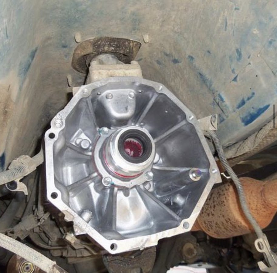

    Crap, so I with a RA60F putting an automatic FJ case in need to buy the FJ Automatic transmission extension housing/seal holder? Anything else? This is a new discovery to me, part number(s)?
